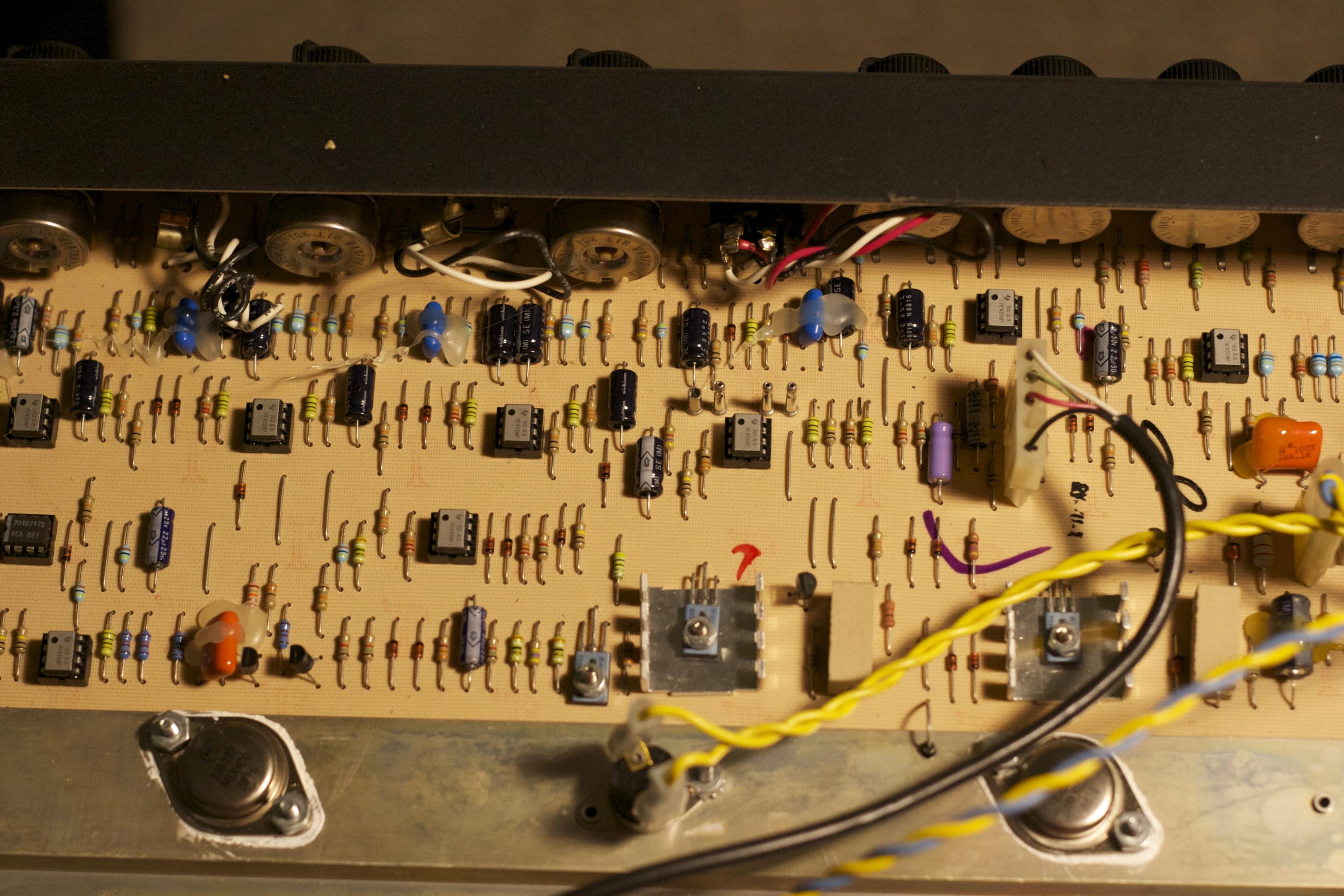

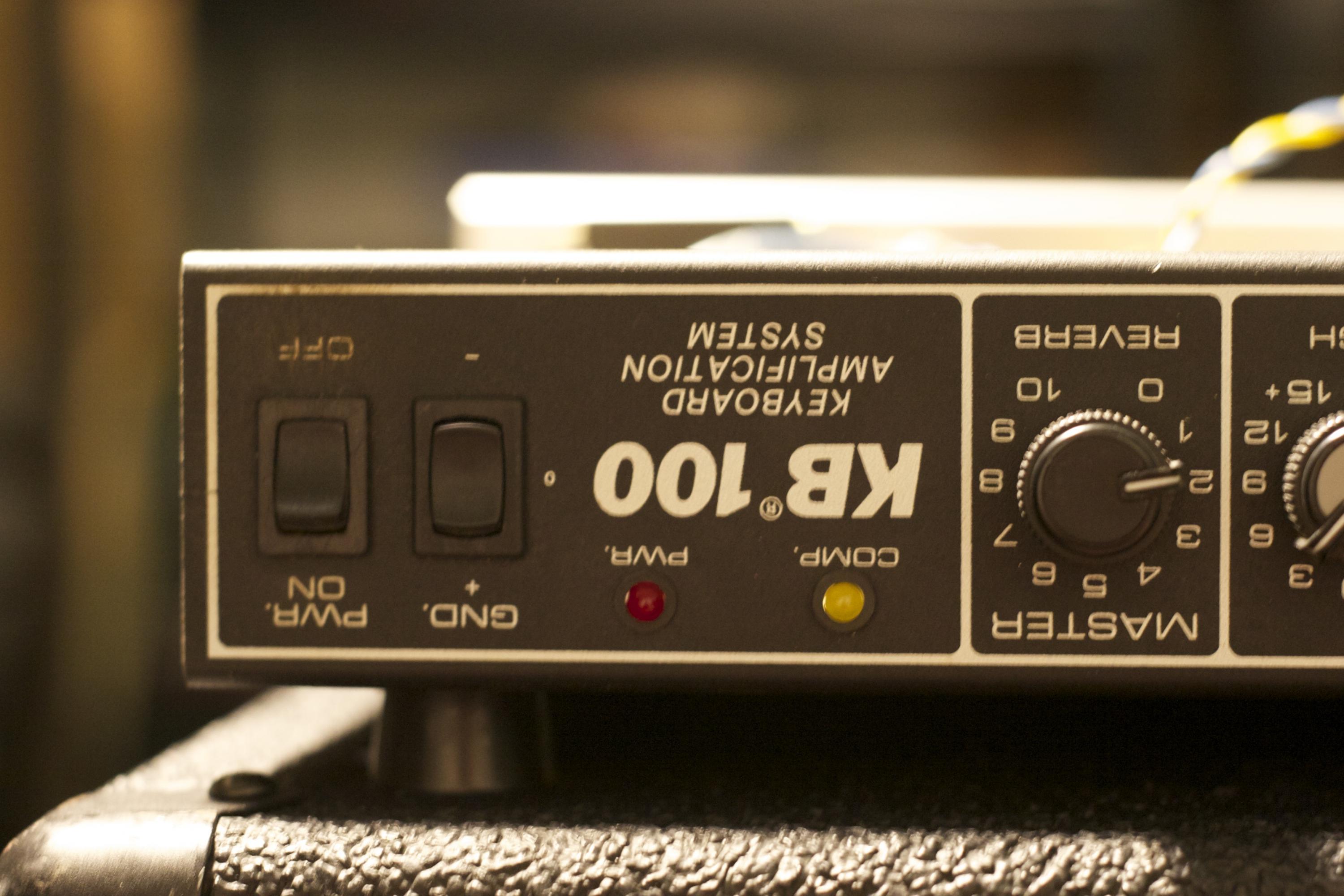

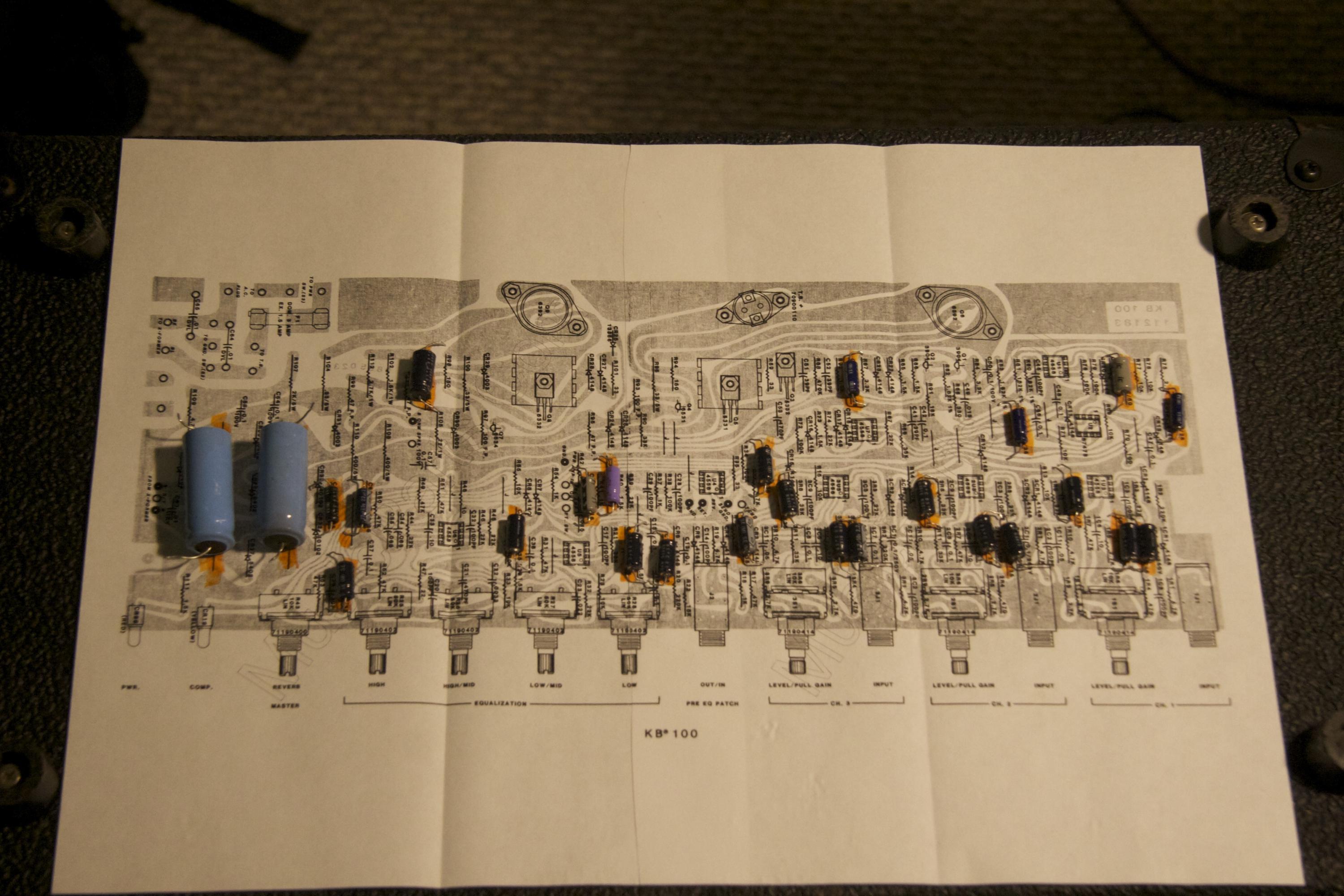

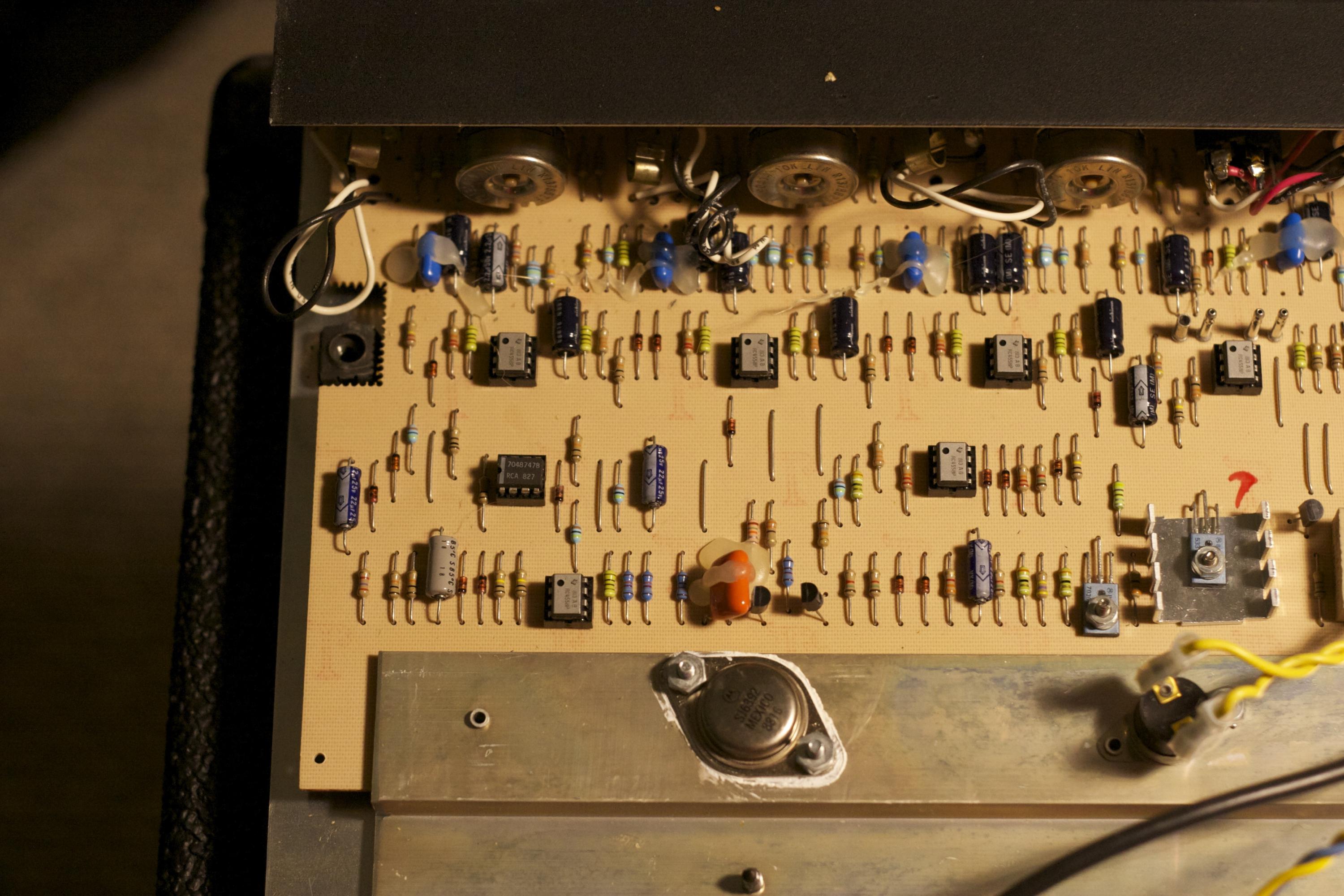

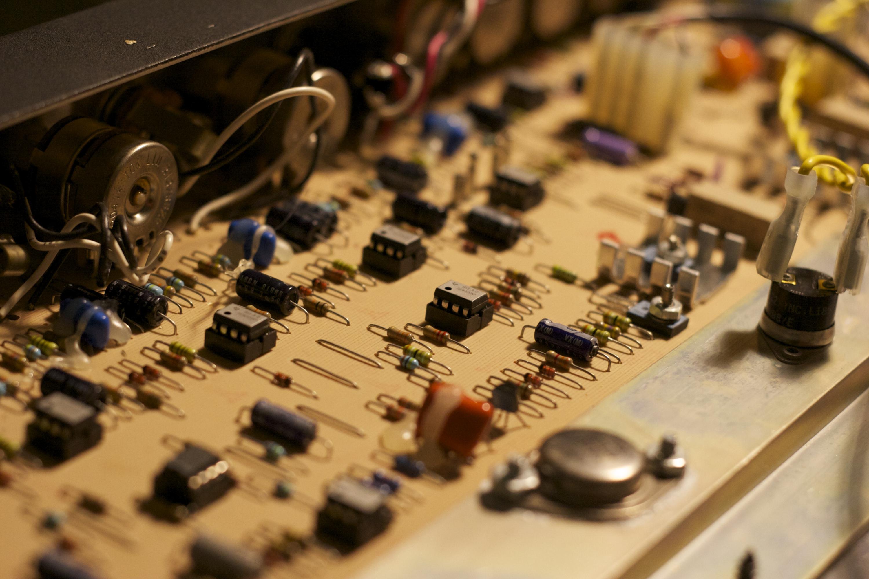

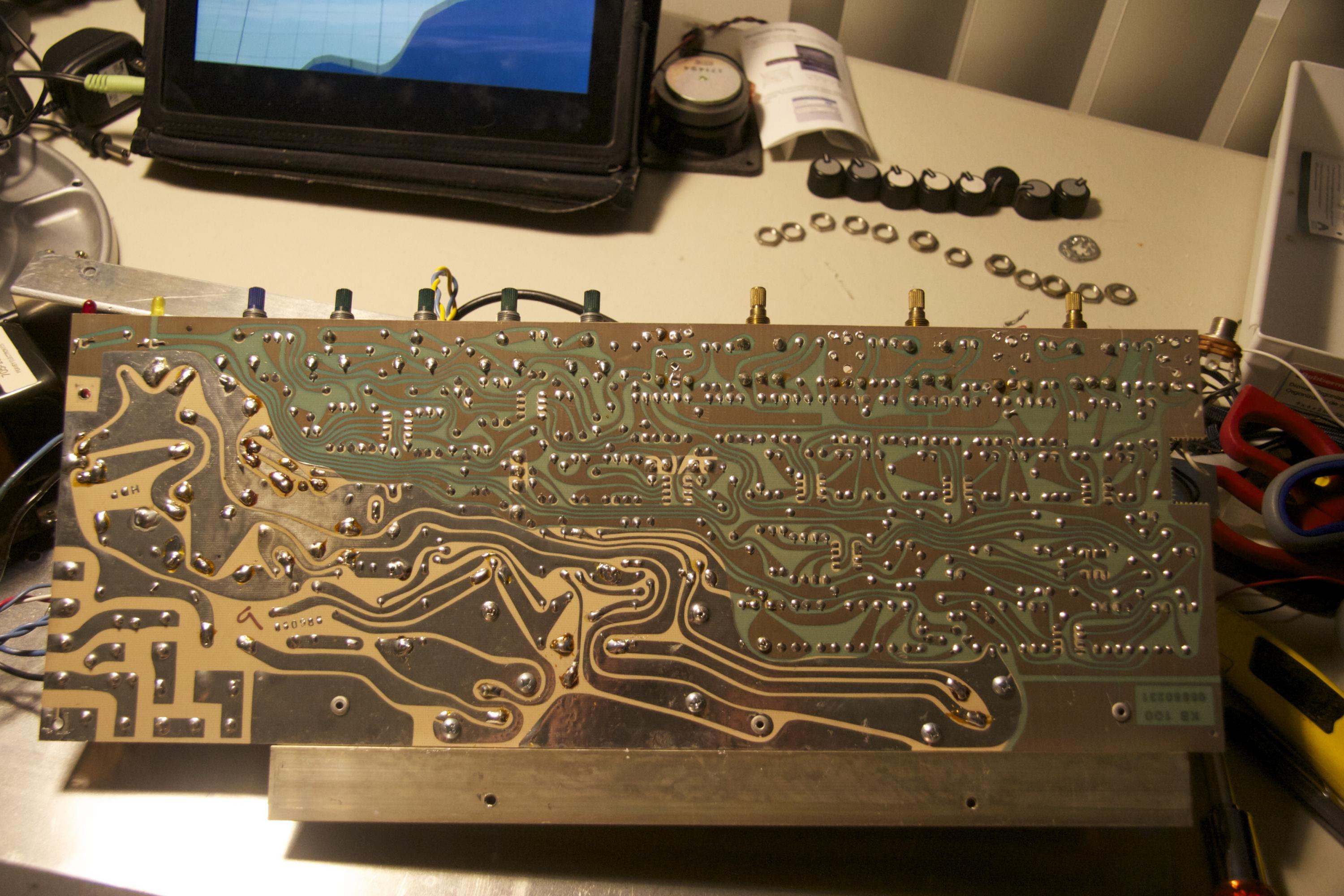

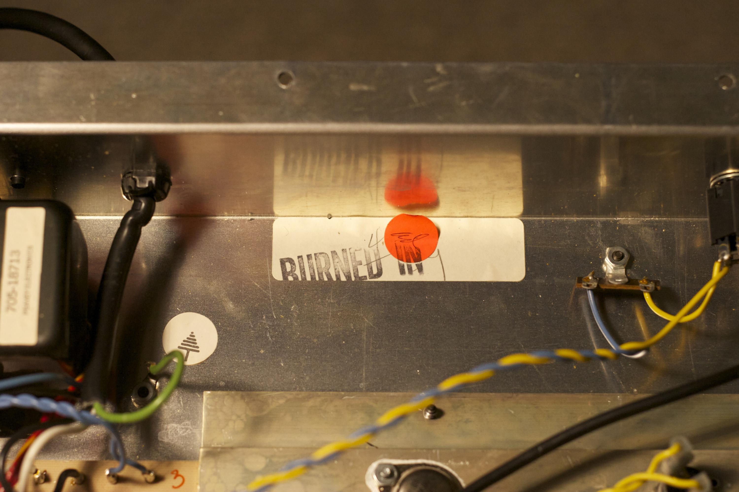

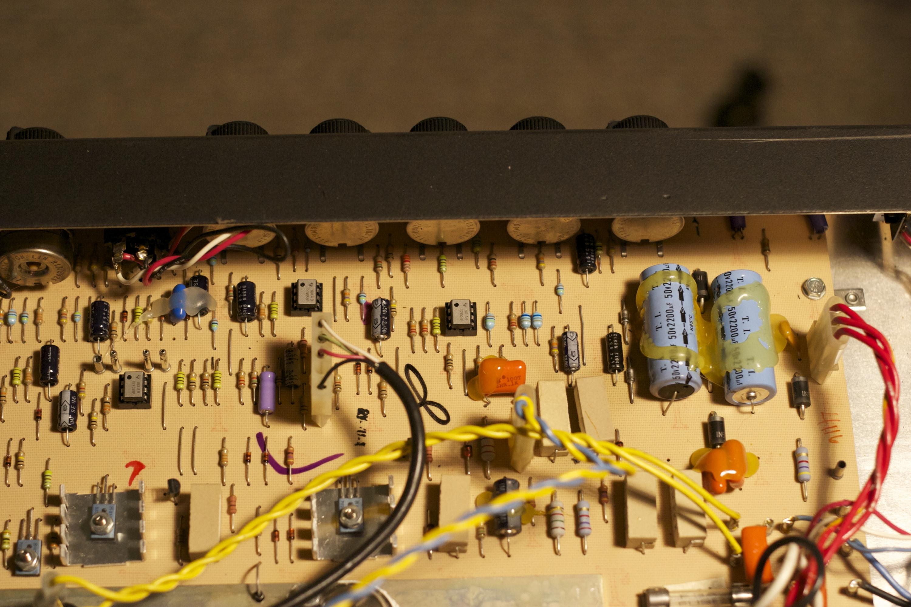

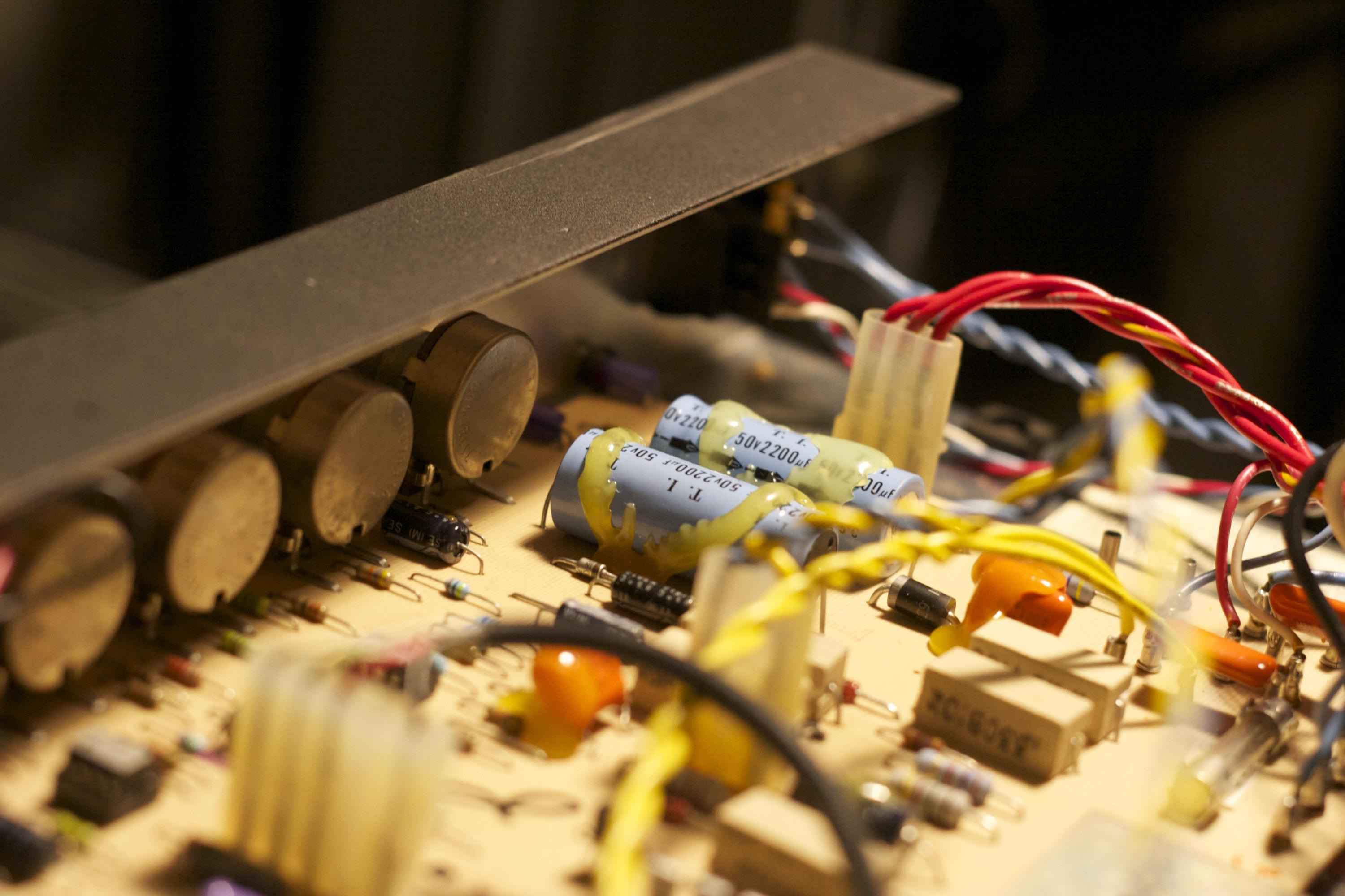

I've finally got it and taken it apart. I've gone ahead and pulled all the electrolytic caps. I'm going to start with replacing them and I plan on inspecting the solder joints while I put them in.
Some observations:
- The COMP. light is always very faintly lit.
- The power light isn't particularly bright.
- It thumps when turned on the first time.
- The PCB is a very cool design.
Pictures attached. Any other questions or recommendations welcome.Attached Filesif you find these attachements useful please consider making a small donation to the site
Re: Peavey KB100 popping and thumping with humidity
number 5 looks like it could be a wallpaper, what camera are you using?Things I've fixed: anything from semis to crappy Chinese $2 radios, and now an IoT Dildo....
Follow the white rabbit.Comment
Could be indicative of a fault, like a leaky component. What is that LED connected to? I can't see it on the schematic.
The LED might just be old and worn, R198 might have increased in resistance, or there's a poor connection somewhere.
That might not be a fault. Some amps do not have de-thump circuitry (especially old ones) and all amps thump at power up to some extent. If it's not very loud it might be normal.
That would have been 'taped out' by hand."Tantalum for the brave, Solid Aluminium for the wise, Wet Electrolytic for the adventurous"

The attached PDF is the closest I could fine to my version of the amp. The COMP LED is connected to a 4558 amp on the lower left of the schematic.Could be indicative of a fault, like a leaky component. What is that LED connected to? I can't see it on the schematic.
Right. I think on this one it would be R111. I'll check it out tonight.The LED might just be old and worn, R198 might have increased in resistance, or there's a poor connection somewhere.
Thanks!Attached Filesif you find these attachements useful please consider making a small donation to the site
That one makes more sense. R111 would be it.
What does the 'COMP' LED actually indicate?"Tantalum for the brave, Solid Aluminium for the wise, Wet Electrolytic for the adventurous"
-David VanHornComment
I think the COMP led is "Compression" it lights up whenever it thumps on power on, or when it pops/thumps due to whatever is causing it to do that. I can't find a manual for this particular version. The one in the Peavey archive is for the newer version that has the XLR jack on channel 1, and no COMP light.Comment
