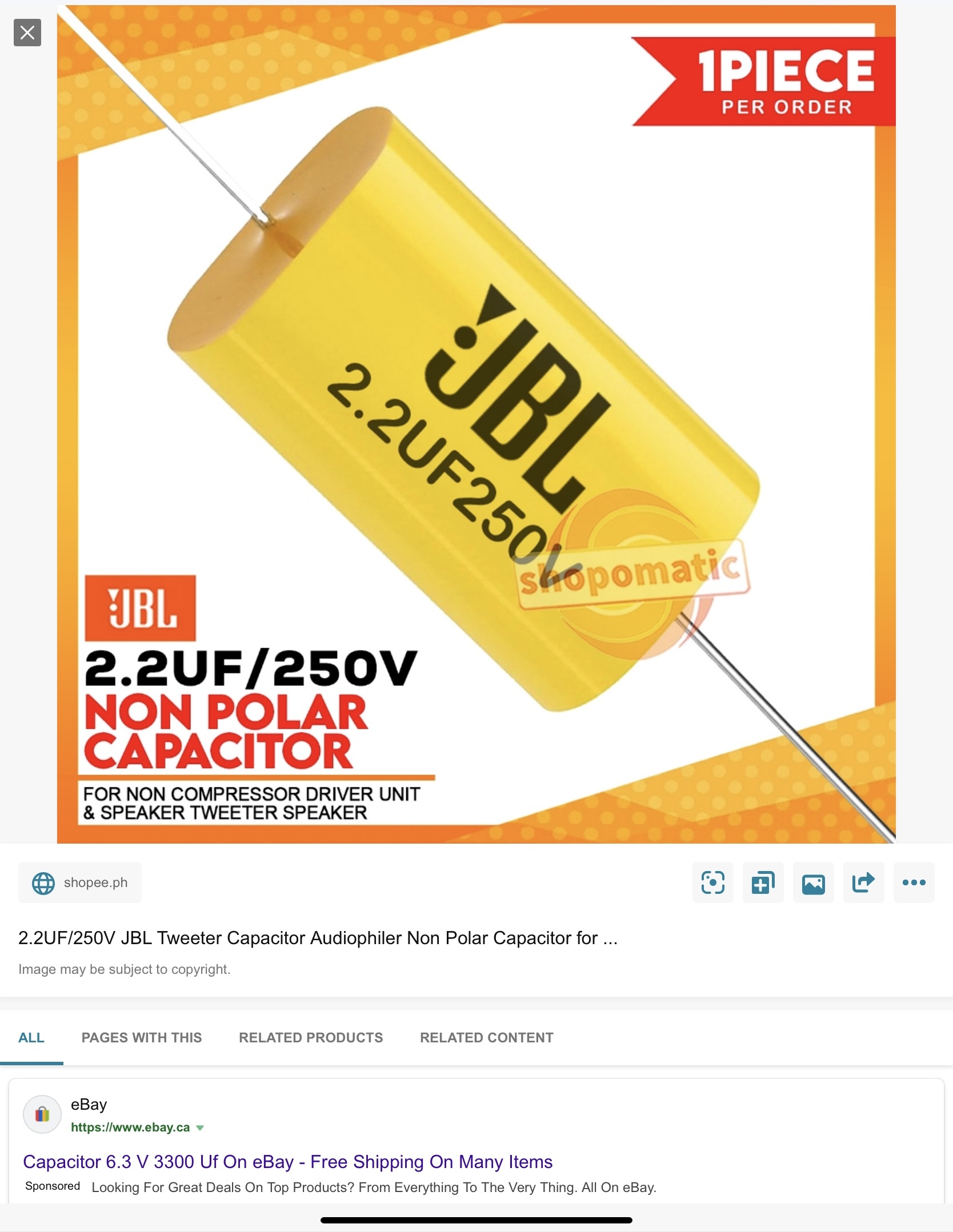

    Greetings. Having an issue with extremely low output to tweeter. Replaced driver and fuze. As far as I can tell every component has relatively low ohms and no opens. I only use the speakon connection. Woofer operation is OK. Tried tweeter on woofer connection and sounded fine. Jumped the resetting fuze, no difference.

    *UPDATE: Started jumping and the one cap gave me back my tweeter, so I guess slightly bad cap?
    Can someone help me with the correct nomenclature for a replacement please?

      Yep, it’s the cap. These aren’t regular caps, these are non polarized audio capacitors. 250V, 2uF. Like this

        Thank you for the response.
        Would this be the ticket?
        https://www.daytonaudio.com/product/...lene-capacitor

          Yes that would work.
