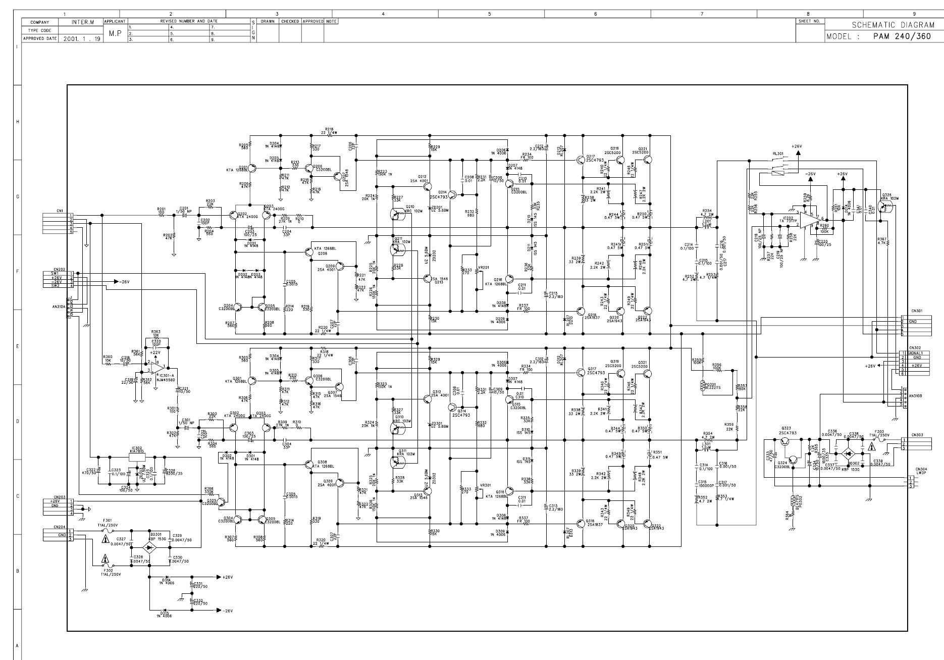

      The protection circuit can trip for a few reasons:
      1. DC voltage at either channel amp's output (measure at L201, L301) - (most likely, as one channel was blown)
      2. Overtemp circuit (thermistor PO301)
      I would guess your power amp still has a problem, resulting in too much DC at one channel's output. Measure the voltages at the inductors or output relays.

              On the protection IC TA7317P, if there is any DC on pin 2 or pin 3, above around +/-1V it will trip the protect latch. You should measure close to 0V on those pins.

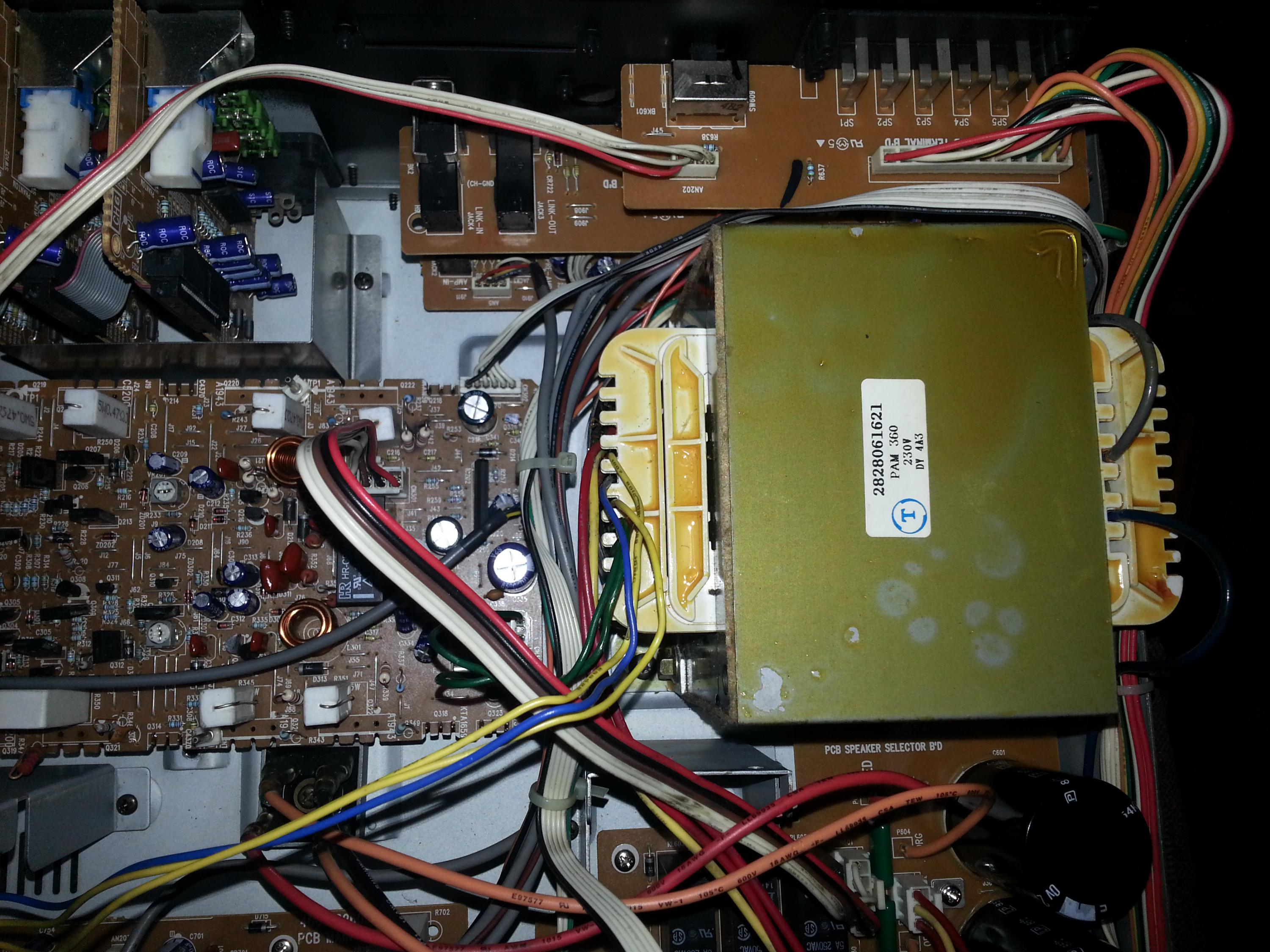

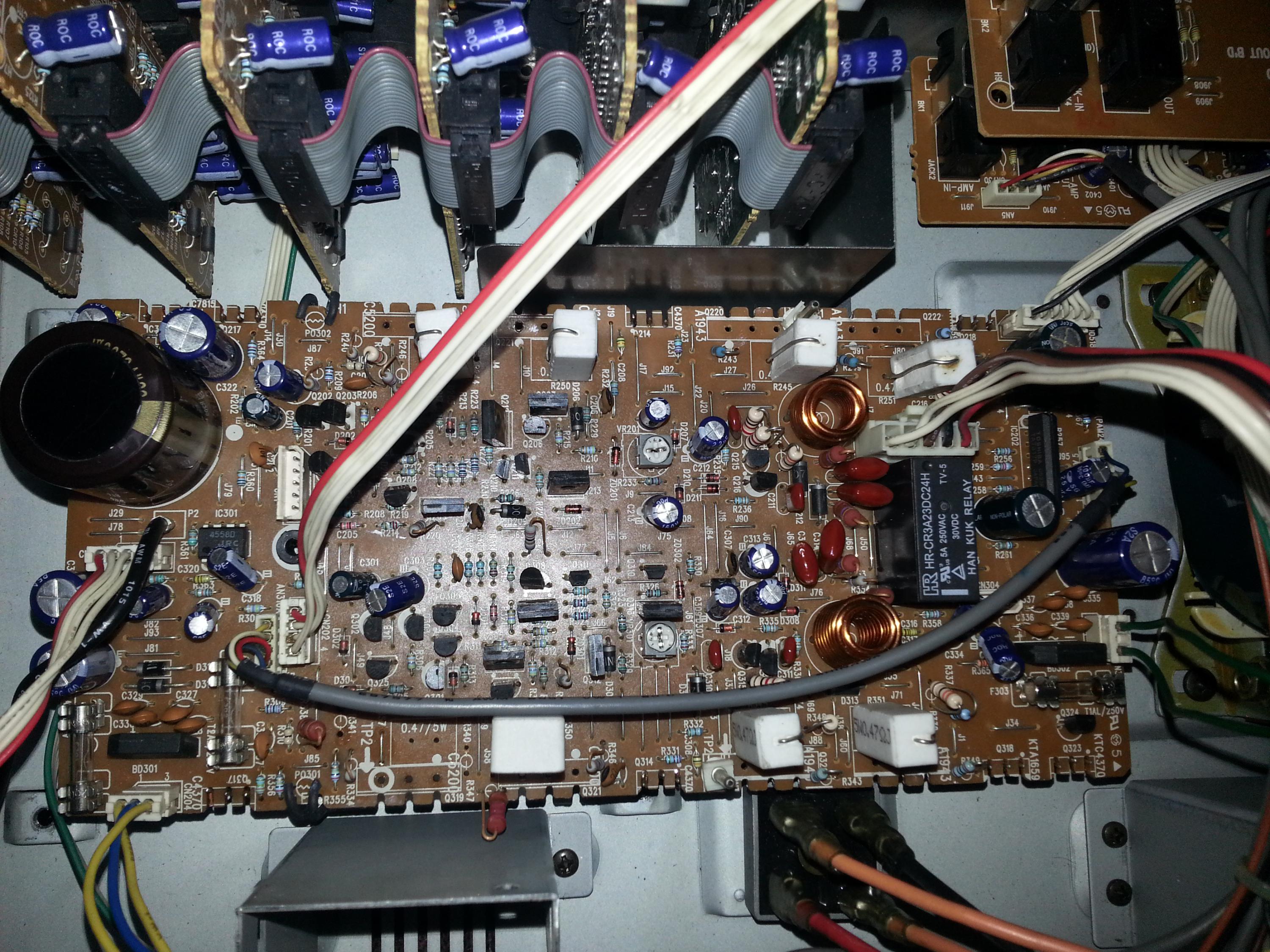

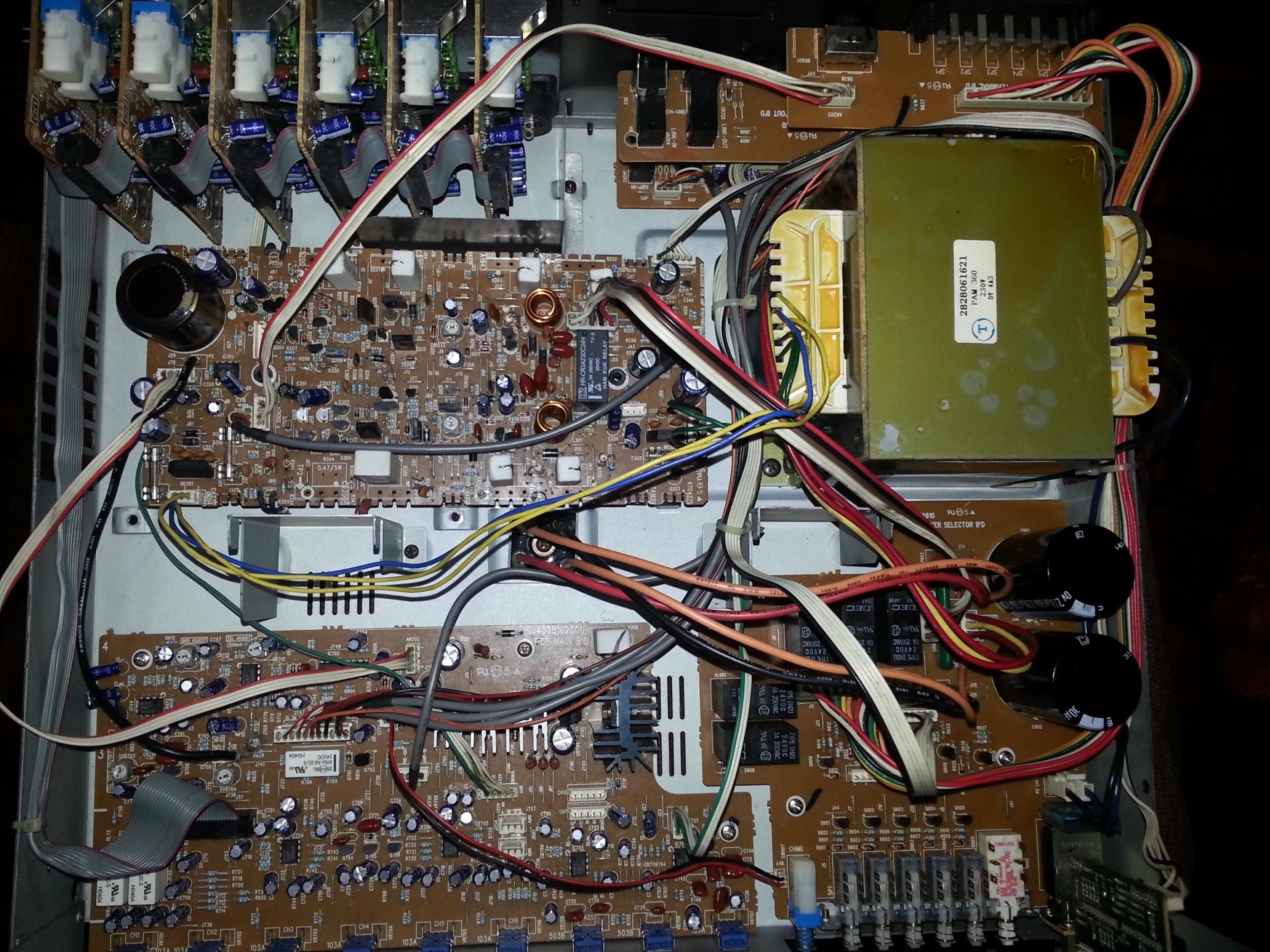

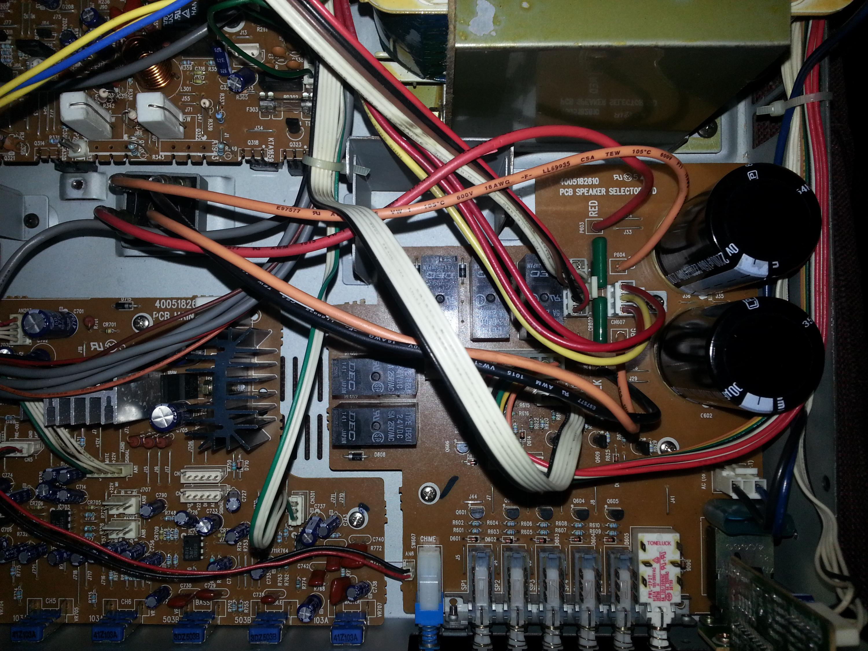

                  Pictures of the unit

                    Ok, replaced all the caps, output transistors, bias transistors and resistors. Amp board is as good as new now. Luckily i plugged it via the light bulb limiter, turned on, its dim but not very and not bright either. The protection light is still ON. The relay on the amp pcb is not working either. Only the relay on the power pcb and the relay on the main pcb is working when turn on. Amp pcb relay seems to be off. Checked the relay with 30v power supply, its working fine and clicking. Where else should i be checking? Please help meeeeeeeeeeeeeeeeeeeeeeeeeeeee ............................

                              Re: InterM PA Amp PAM-360 Protection Problem
                              "Current drive" refers to the power amp output stage i.e Q217/218, Q219/220, Q221/222 and "Voltage drive" refers the voltage gain stage before.
                              The protection circuit is doing the right thing because it is seeing DC voltage on the amp's output, which should be 0V.
                              Did you check the eight 0.47R emitter resistors for open circuit.
                              Measure your power supply rails and the output voltage.
                                  New progress : Now i know why the relay didn't click on the amp pcb. I popped it out, short with 24vdc psu, it still didnt click either. Opened up the relay, noticed its burned. And also c4001 transistor is short. Gonna change this both today and see how it goes and make more measurement and update in here.

                                    Now the voltage is absolutely zero on all the speaker outputs. The relay is working perfectly fine on the amp board. It clicks after turning on the power immediately. No DC voltages on pin 2 and 3 on the protection IC TA7317P. So i guess im getting closer to solving the issue. Where else should i be checking now? I appreciate everyone's help in here. Very informative and helpful.
                                        There is 2 piece of 260 Ohms resistors near both variable resistors. One resistor shows around 74ohms and another shows near 98ohms. I find this too low for the original value.
                                        R233 and R333 on the amp circuit.
