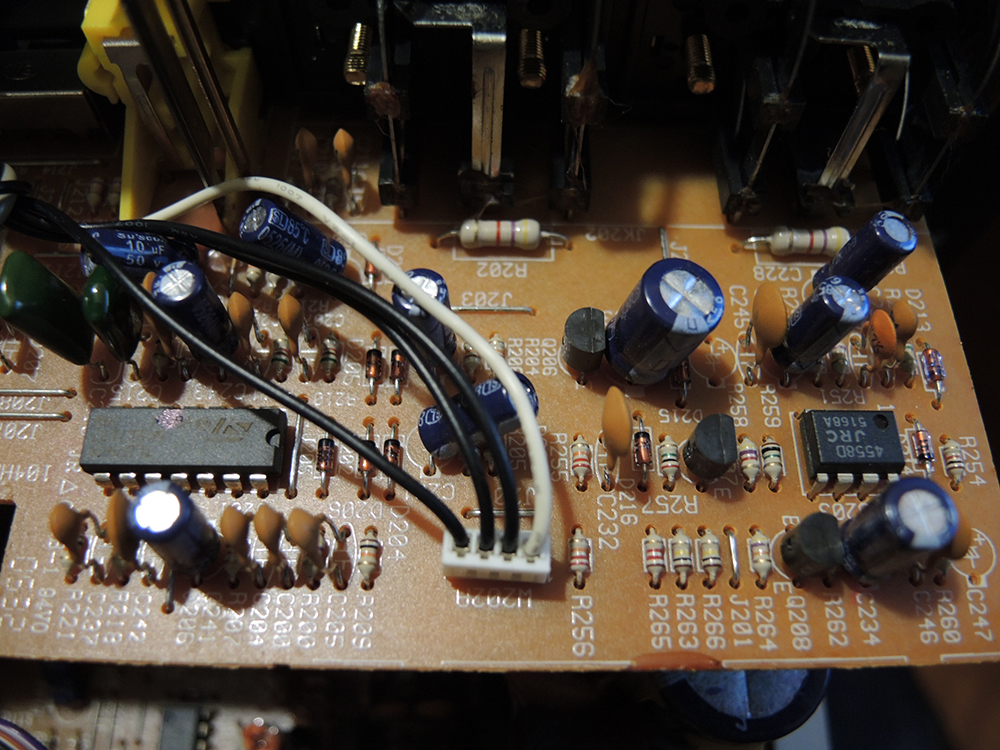

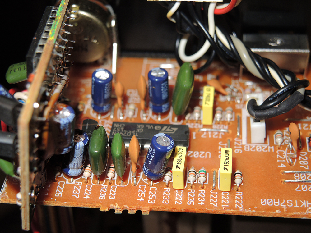

    Hi I am new to the forum and looking for some help with a Harman Kardon TS-8 Subwoofer. Initially the issue was an intermittent fault but has recently become a permanent fixture of the Sub.
    The issue I am having is when the sub is switched on it make a thumping noise randomly every few seconds regardless of the mode (i.e. AUTO/ON, Reverse/Normal, Filter on or off) and also regardless of whether there is an audio source connected or not. When it thumps the light will switch to ON (blue) when back to standby (amber). I know these amps have issues with bad caps so have disassembled the sub and looked it over but can't see any obviously bad caps. There is some darkening on the PCB but given its proximity to the heat sink I suspect this is pretty normal.
    I am happy to replace all the caps is necessary but just wanted some thoughts on which caps might be the likely culprit for the fault.

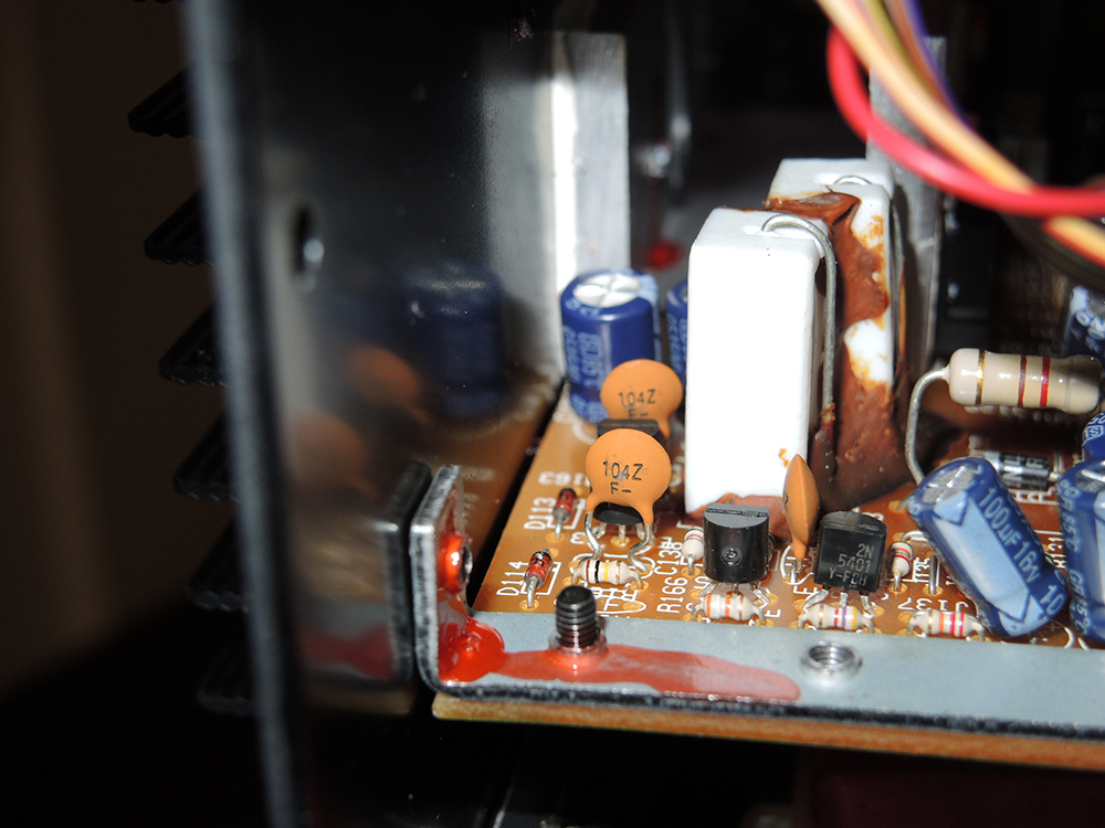

    You could try replacing the small caps near those hot discolored areas.
    Of course, check for bad resistors too.

      Remove the glue. It looks like the glue that becomes conductive.
      The caps in the discolored areas are probably bad. You might end up replacing most of the caps.

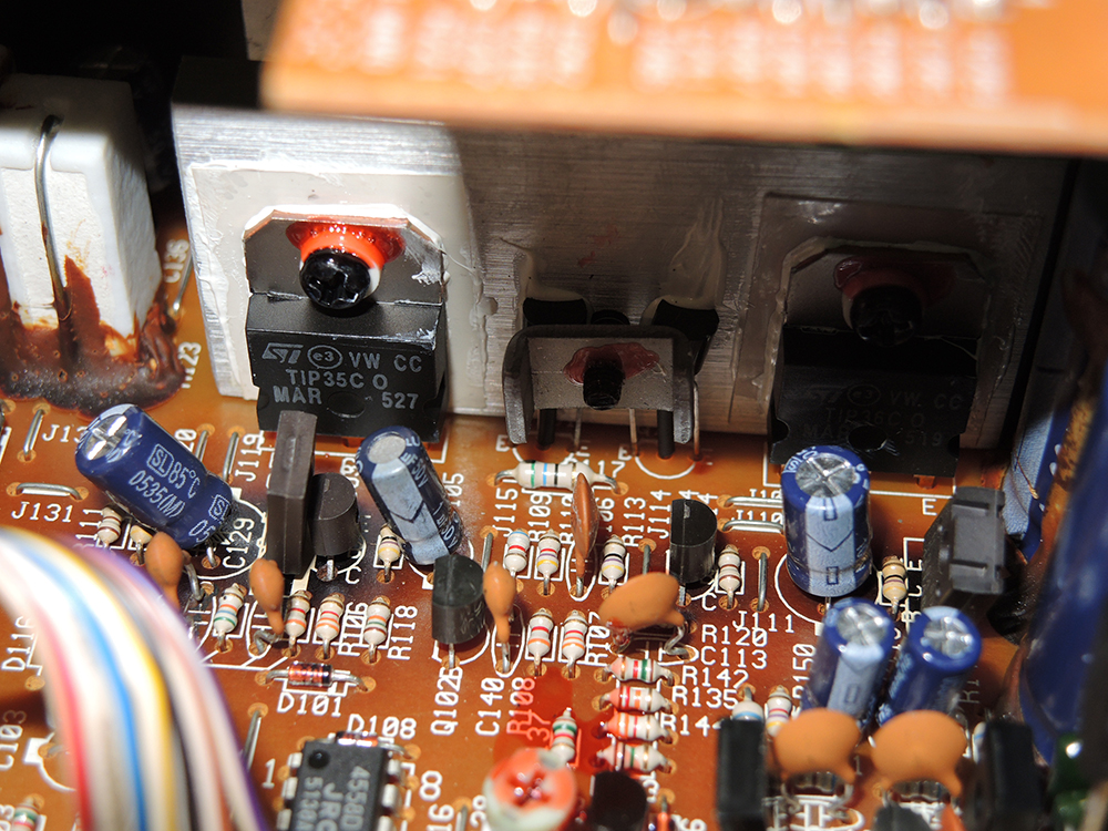

          I have swapped out all the caps and removed all the glue but have the same problem. Still getting the sub popping every 30 odd seconds then I can here what sounds like something clicking on the PCB (the same sort of click which you first get when the amp turns on or it come out of auto mode).
          Any ideas would be appreciated.

                Something clicking on the PCB like when you turn it on? That is very likely the protection relay that is making that clicking sound.

                        resolder the relay & bridge rectifiers.
                        and whatever is under that very overheated part of the board in one of the foto's

                          I've got one of these myself. Dear oh dear. Those power transistors look like they get bloody hot and should really have had a heatsink on them, don't they?

                            dry joints on relay or relay shot

                                30 seconds is a long time for problems.
                                Because subwoofer vibration can be hard on the electronics, I usually take a (plastic) pen and tap parts to check for broken leads or bad solder joints. Or a wack with a hand on the cabinet, to rule out a bad connection.
                                I'd watch for DC voltage on the amp's output and see if it is moving around.
                                It should be close to zero and stay there- unless there is a leaky cap in the signal chain. Anything beyond +/-1V would trip the protection relay.
                                There is a high-temperature trip (55°C EU/65°C USA) U101 with an adjust trimpot R138 and Q115 temp sensor on the main heatsink. It would activate the protection relay which then activates the mute circuit. Maybe this circuit drifts with age.

                                  Sorry all, I know this thread is old, but I was reading it for info, lo and be hold, I fixed my Harmon Kardon TS7 today, two Op amps with really bad solder joints and removed all the heated running glue that was shorting connections.
                                  also changed a Cap, I need to change a few resistors as they have changed colour from heat, but do not have any of the correct size, will change later.....
                                  Working great now with no popping or crackling.

                                        You need to start with removing all the glue on picture 7 and then reflow most parts with fresh solder and see if it changes anything.
