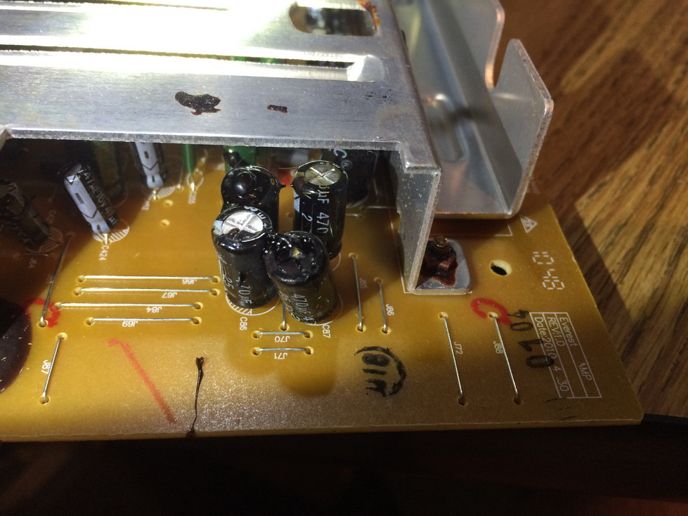

          Hopefully it's OK to tag into this thread, I think my issue is related.
          My z506 will present sounds for a few minutes at best. Then nothing. Power light is solid and stable. To get sound back, I must turn the volume dial to max. Oddly, with the volume at max, it never cuts out. However, there is quite a bit of background hum so if I turn down the input volume, that hum is too much.
          I have tested different power sources, different audio sources (stereo and surround) and every case exhibits the same problem.
          Does this sound like a power supply issue or something else?
          Thank you for the help!

                      #70
                      Re: Logitech Z506 power supply
                      Originally posted by stromm View Post
                      No luck with headphones. The system presents sound till it seems like something warms up, then cuts out unless the volume is up all the way. Even with headphones connected.
                      Once it starts cutting out, if I remove power (cord) for five minutes or so, then plug it back in, I'll get sound as normal for a few minutes.
                      Does this seem like the power supply board?
                      I don't know. Others in this thread have certainly had problems with the power supply.
                      When you disconnect it from power for five minutes, do you disconnect the mains power from the wall or just the power supply from the amp?
                      If you have been disconnecting it from the mains, try just unplugging the power supply from the amplifier, and see if again it works after 5 minutes. You could also try measuring the power supply voltage and see if it changes between when the amplifier works OK and when the problem occurs.
                      It may also be something overheating or such in the amplifier itself. Can you post photos of the amplifier board so we can see?
                      If the amplifier section is bad, you might have to trace the audio signal through the amplifier and see where it goes wrong.
                      -David VanHorn

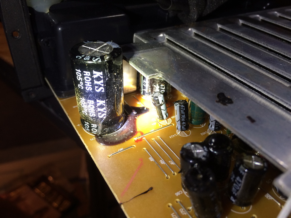

                          #72
                          I'm assuming these are not in good shape?
                            #73
                            That black stuff is glue, and as long as it's only on the outside of the capacitor and not stuck to the leads, it's probably OK.
                            If it's on the leads of any components you should probably remove it, it can turn conductive over time and cause problems. Scrape it off with something, heating it with a hairdryer or similar (not too hot!) may help in removing it (can soften it a bit).
                            -David VanHorn

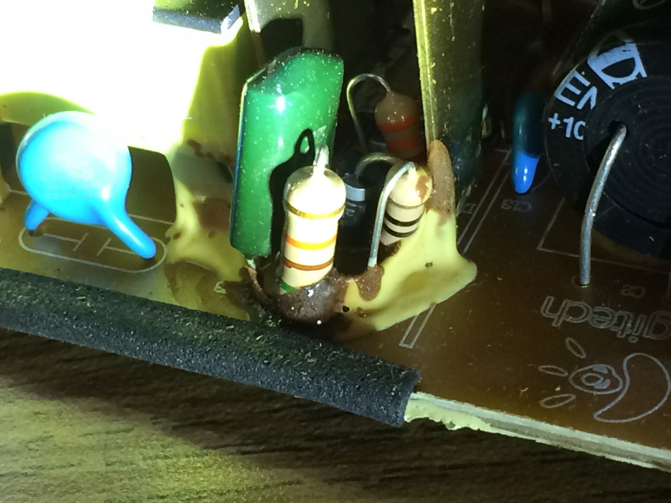

                              #74
                              Ah, good to know. Thank you for your patience. Even though I'm 45, I let my father (electrician by profession) fix all my electronics. Since he passed 4 years ago, I'm learning as I go now.
                              So I removed the power supply board and don't see any swollen caps, but I did find this brown stuff on these resistors. Is that more glue or should I remove and test them?
                                #75
                                Yes that's more of the glue. As you can see, the yellow part is more the original colour and where it has come into contact with the warm components it's turned brown and started to corrode their leads.
                                Those resistors are probably still OK aside from the corrosion (though removing and checking them would not be a bad idea) but in any case, you should definitely remove the glue from them as it goes conductive and in a power supply this can lead to significant damage if the glue is somewhere in the primary side\high voltage section.
                                In lower voltage areas the glue does not usually cause catastrophic failure, but can upset circuit operation and cause a fault condition anyway.
                                -David VanHorn
                                  #76
                                  That pix in post 74, that section looks like the RCD snubber circuit in the primary side so there will be high Voltage in that section.

                                        #79
                                        It is recommended to scrape all the brown glue away. Also replace that little diode in the snubber circuit with a 3A 1000V fast or ultrafast recovery. That diode is the main point of failure in that power supply. A FR307 or HER307 will work, these can be scavenged from dead PC power supplies.
                                        The diode is the black/grey component sandwiched between the two resistors and the green capacitor.
