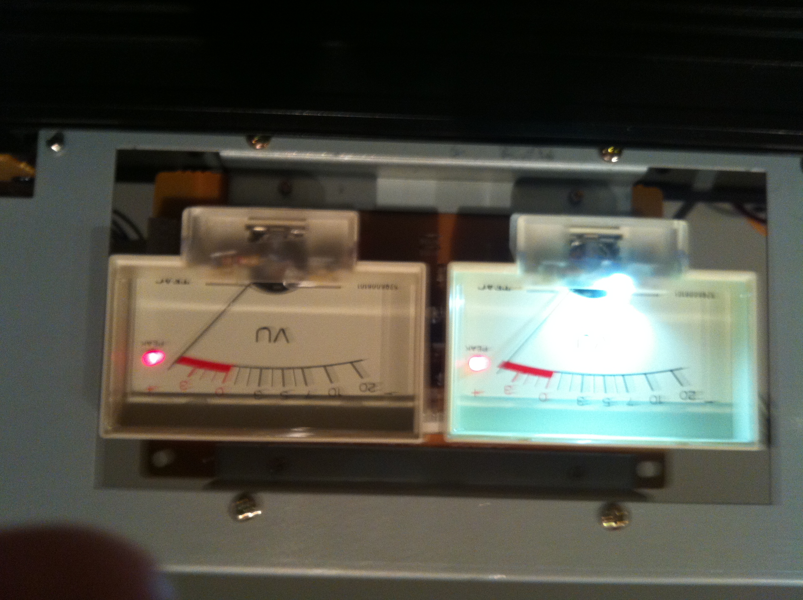

    So I decided to finally fixed the burnt out bulb in my Tascam M-3700's VU meters. I happened to have some nice white LEDs from some dead solar lights and thought that would be a nice change from the aged yellow of the tube bulbs that were in there. Dropped a 1k resistor in front and everything meters out fine. However, the meter that had the burnt out bulb still doesn't light up. I double checked the bulb itself and it is in fact popped. Quadruple checked everything on the PCB and everything is good. It lights up when I put the diode setting on my MM to it from various locations on the board but still no light when I plug in the PCB. Popped the hood on the master section of the board itself and checked all the connects are good and seated to no avail.
    Ideas?

    Is the old lamp being fed by AC or DC, and what is the Voltage feeding the old lamp?

      Fuse-style VU meter lamps are fed from AC, around 6VAC (DC gives shorter lifetime and you need bigger filter caps $). So I would expect a white LED to fail. They can't take any reverse voltage. I'd put a 1N914 across them.

        Well there was a + and a - on the board so I had assumed it DC. And I metered the bulbs at about 7VDC but if they are AC, I'll look in to the semi conductors. Thanks!

          If it is DC, max you current with White LED will be about 4mA (@7V, 3V drop for LED vF, 4V drops on 1K = 4mA) through the LED, which will barely conduct. Also do you have Positive o the Anode of the LED? You should drive the LED with 15~20mA range to get the brightness as spec by the LED manufacturer or what ever the spec is for this LED. Most TASCAM use AC for lamp. popular lamps are rated at 6v, 8v, and 12V.

            When I looked at the PCB again, the +/- was at the terminal posts for the needle not the light. Everything meters correct so has to be AC. For 10¢ a piece, worth it to try the SCs.

              Unless you use full-wave rectifier (will flicker at 120Hz) or half-wave (will flicker at 60Hz) you will need small filter cap to reduce the flicker.
                Most modern white LEDs are fairly bright even at 1 mA. 4 to 6 mA should be plenty. Depending on the LED, 15 to 20 mA may be too much, and if not cooled very well will make the LED have a very short life.
                Also, technically speaking, LEDs can take reverse voltage, as long as you don't exceed the reverse current. However, the reverse current is usually very small and easy to exceed - hence why having an LED in reverse is not a good idea.
                  Re: VU meter woes
                  The reverse voltage break down is only about 5V, I will not run 7V reverse voltage on it. I can never run at 1mA to get usable brightness, I run then at 20mA (that is only 3.3v x 0.02A = .066W) in the products I designed with good reliability history, typical white LED is rated at 30mA easily. He needs to check out his circuit connection and the spec of the LED he is using.
