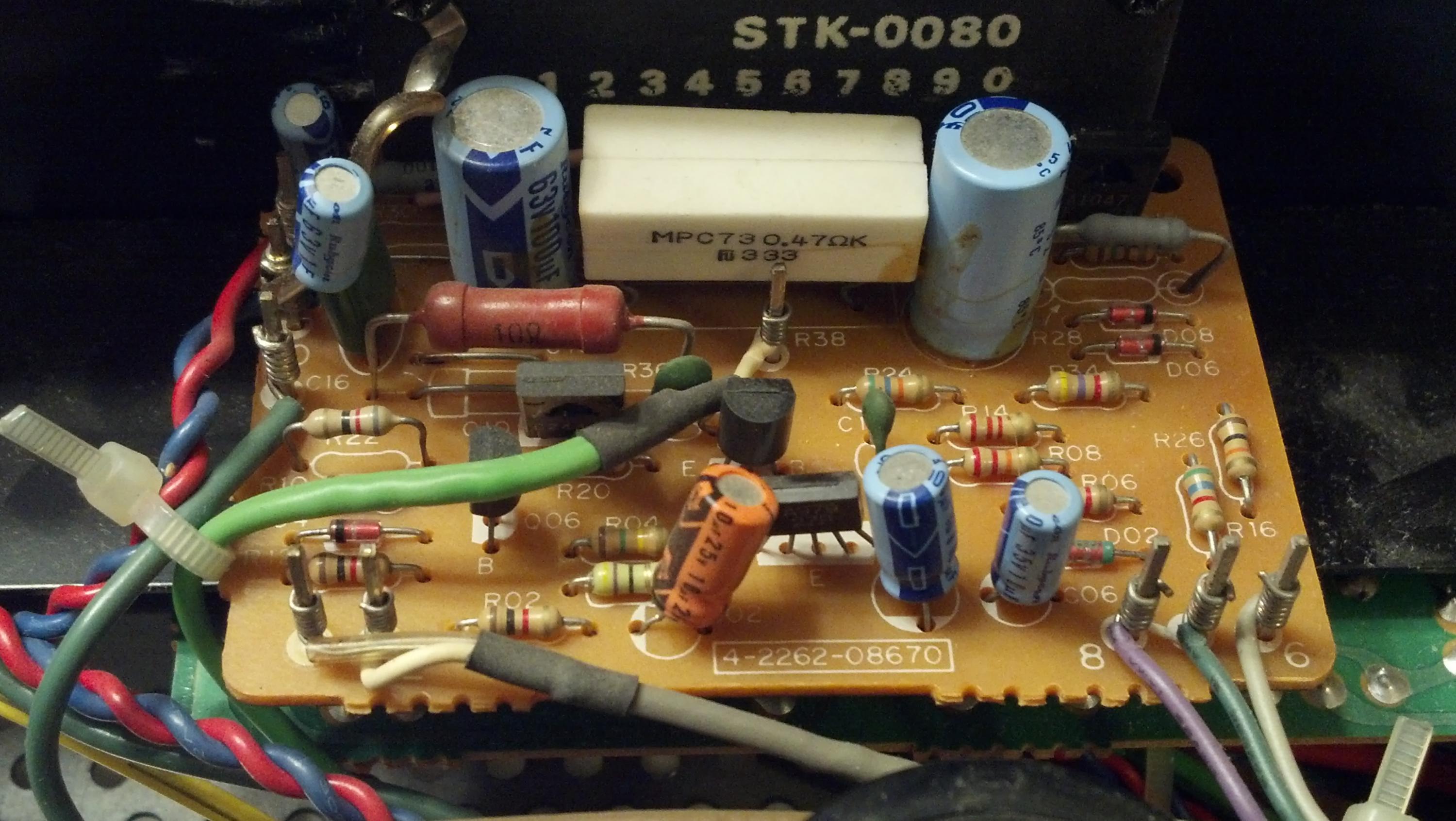

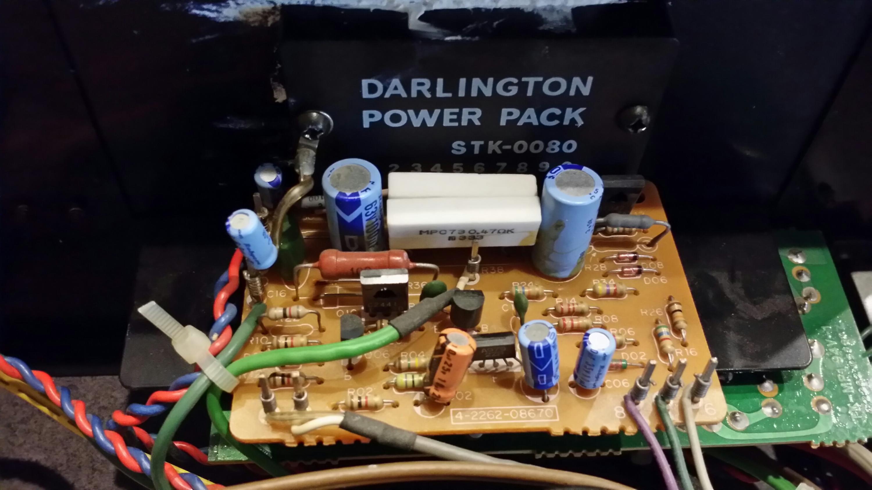

        Ok so I swapped the two STK-0080 and both chips are good. I found that the signal that feeds the amp one is much louder than the other. does anyone have a schematic that would show me the pre-amp?

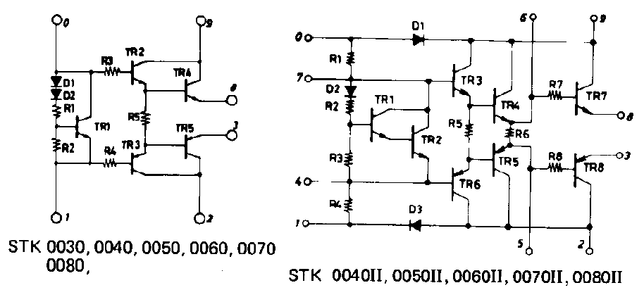

                  With the STK's, I find internal transistors go bad or the IC bonding wires get loose and tapping them with a screwdriver can flush that out.
                  Does this amp use a voltage amp (i.e. STK3042, STK3082)? It's usually one module that drives two channels, and it can fail. The venerable 4558 is usually in the protection circuit.
                  Here is the internal circuit of the STK0080 and STK0080II family:

                    Re: Fisher CA-880 Stereo Amp from 80's sound from only one channel
                    I have tested by removing the stk-0080 and swaping the chips around. I get the same results. I have tested the audio that is fed to the input on the amp board one is significantly lower than the other that is why I think it has something to do with the pre amp. I have tested the VR Main volume pot and It test out perfect on both sides. The one thing I found that has me thinking I need to dig into the circuit that is just before the volume is that two wires on the volume board were touching each other.

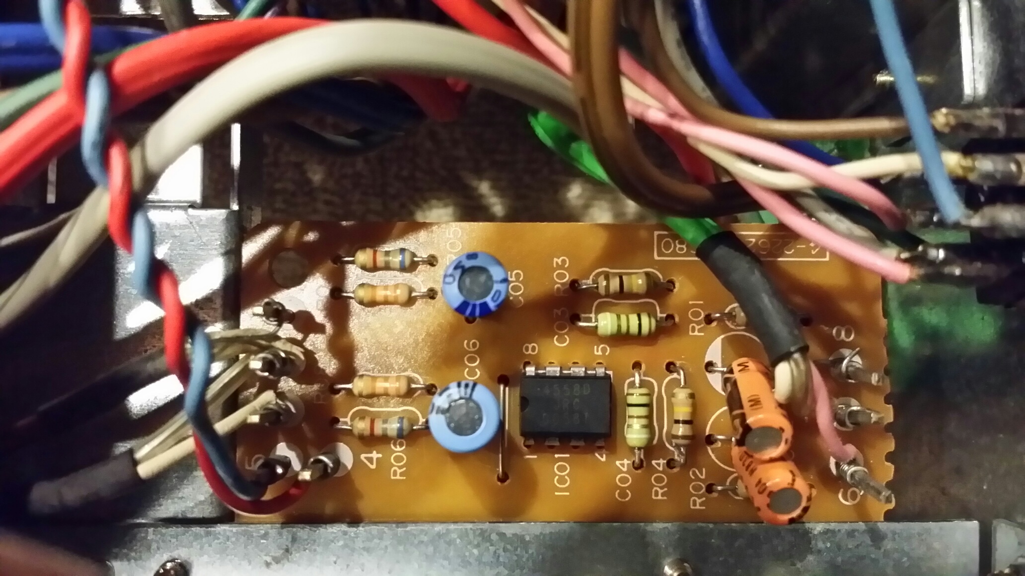

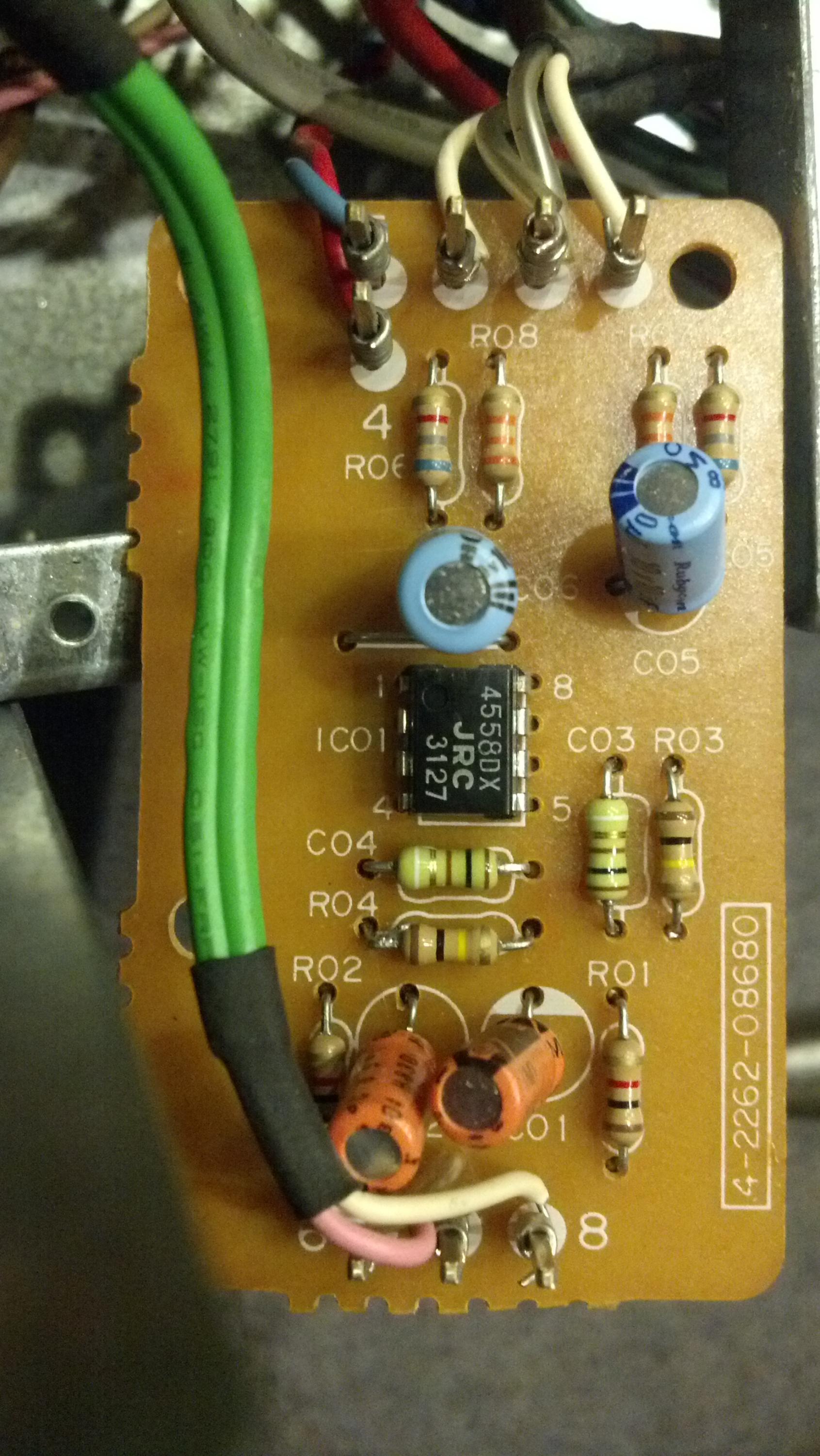

                              so I started working on this project again. I went through and cleaned the switches and pots. I was testing the main volume control and did get some weird readings. on left channel the pot is normal 0 - 170k but on the right channel I get 0 - 56k. so I removed the pot from the circuit and tested it and it test good 170 on both. so I must have something that is pulling down the circuit. not sure where to start testing. I have included a picture of the pot. as well as the board that the pot wires goto.
                              when I test c03 and r03 in circuit I get 96k when I test c04 and r04 in circuit I get 98k not sure of that would be far enough off.

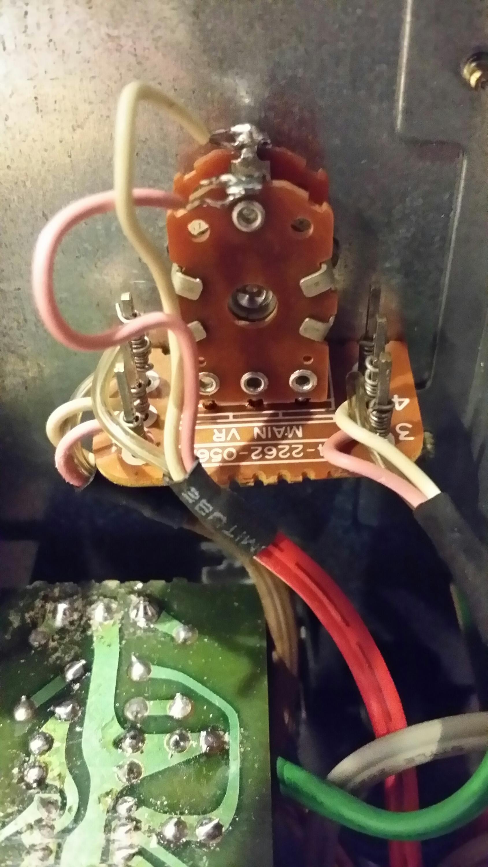

                                Is there anything in parallel with the pot?
                                    Doesn't really help though since it's for a different model...

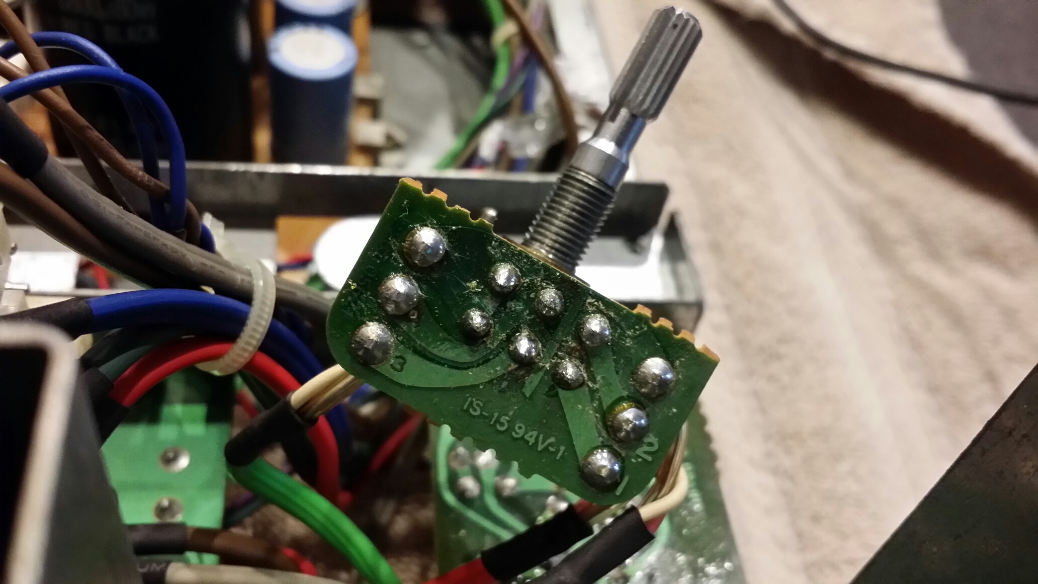

                                    Can you post a clear photo of bottom and top side of the board your volume pot connects to and show where it connects?

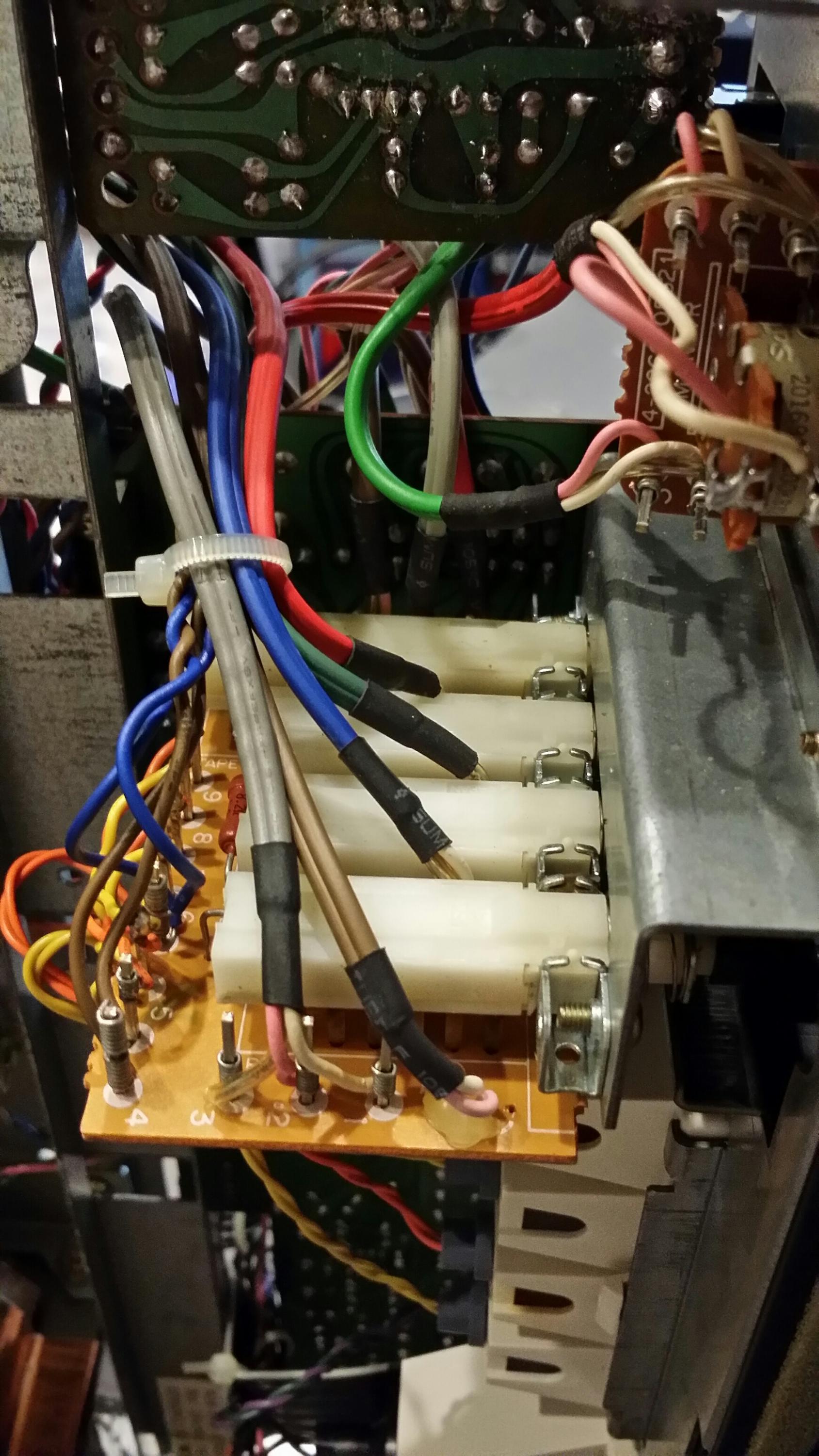

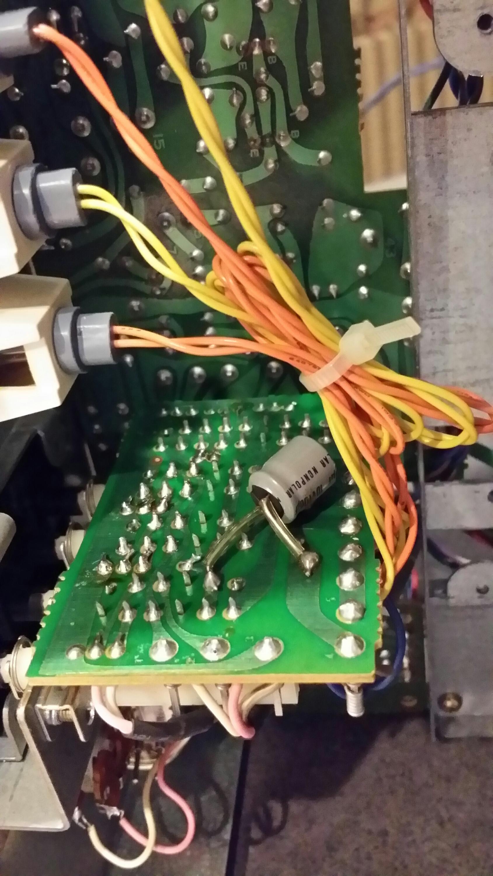

                                      ok here is some top and bottom pictures.
                                        In regard to your schematic notes - What about the board you said goes between the pot board and the tone control board? If that is where the pot connects to then something there is more likely to be affecting the resistance reading.
                                        Did you check back through the tone board and other board to the pot board to find out where the signal becomes lower?
