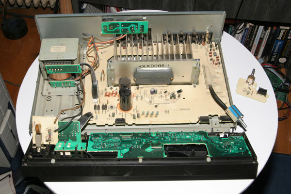

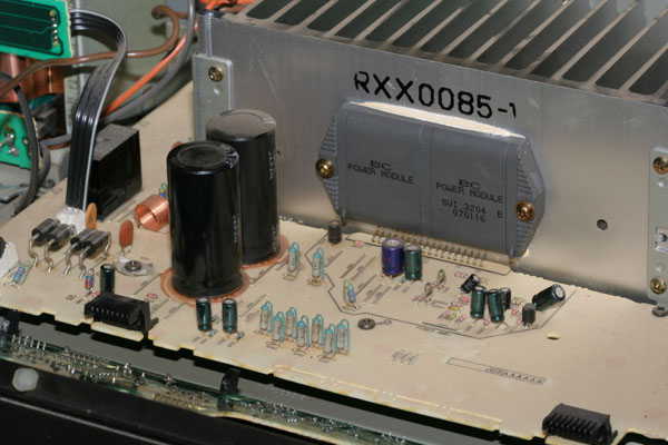

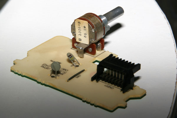

              Re: Technics SU-VZ320 amp
              here's some pics. threads are boring without pics
              so i will try to find a replacement pot on monday and i am renewing the soldering today.
                The layout is lean, mean and clean - even by Matsushita's usually superb standards. My only quibble is that I dislike integrated power-amp modules - I prefer discrete bipolar O/P stages any day. This just can't be modded meaningfully at all.
                    i couldnt find a 100kohm pot, they only had a 50. anyway i got some philips degreaser cleaner. its extrememly flammable which i guess is a good sign.. i opened the pot and then sprayed it and worked the pot. the crackling is gone but there is a point where one speaker goes off and the pot clicks at that point i believe. anyway no biggie. i resoldered the secondary board. i will do the rest this long greek easter holiday (4 day weekend yeah! )
                    is a 50 ohm pot going to be too insensitive?
                                just watch out for that output IC. them things are a bitch. WAY expensive to replace. I know from experiance, i lost one IC from a technics SV-GU90 or something like that. I cant remember now.
