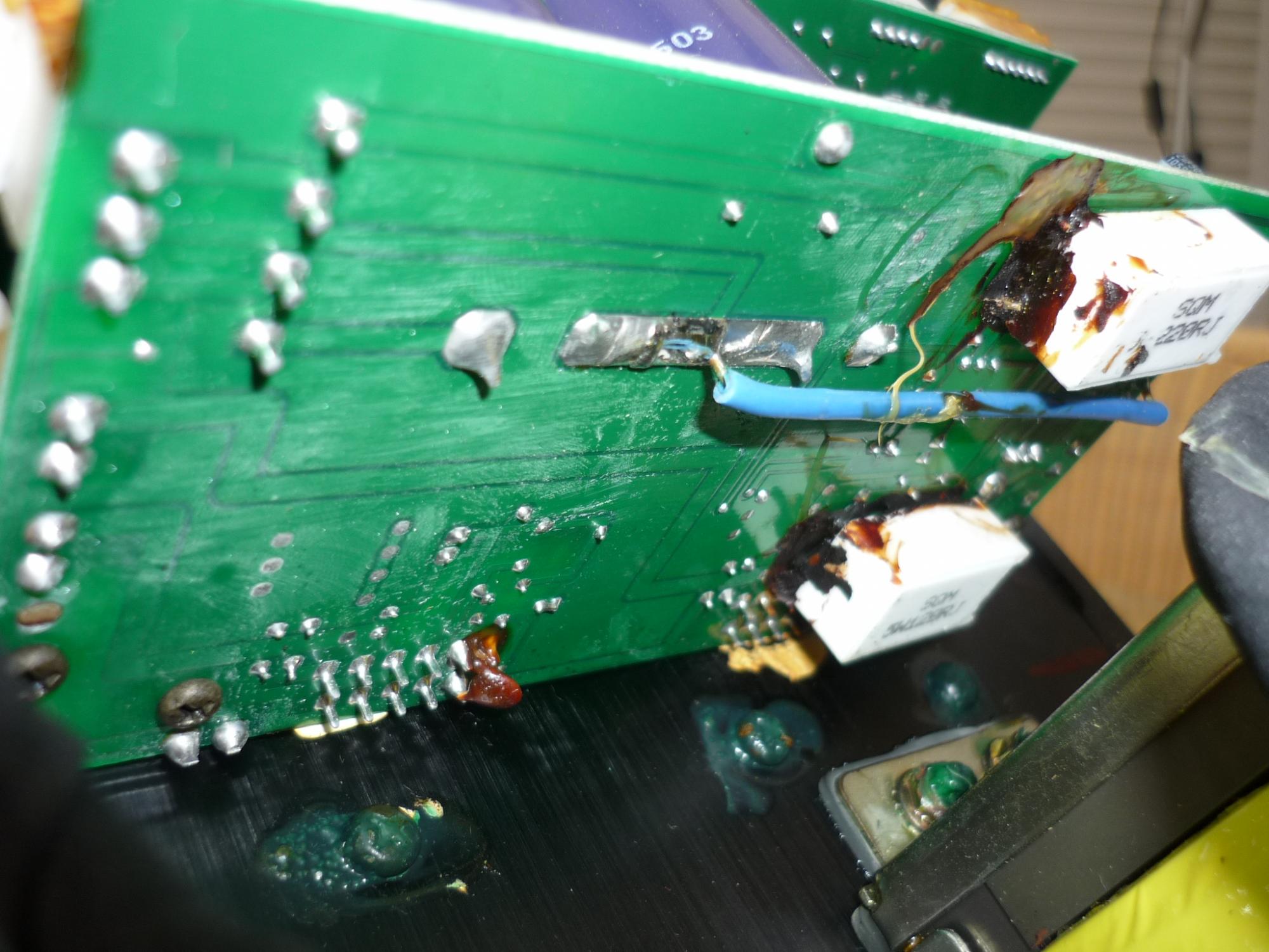

    Well hows about Su'scon!!!! Oh dear. It looks like they'll all have to come out anyway.

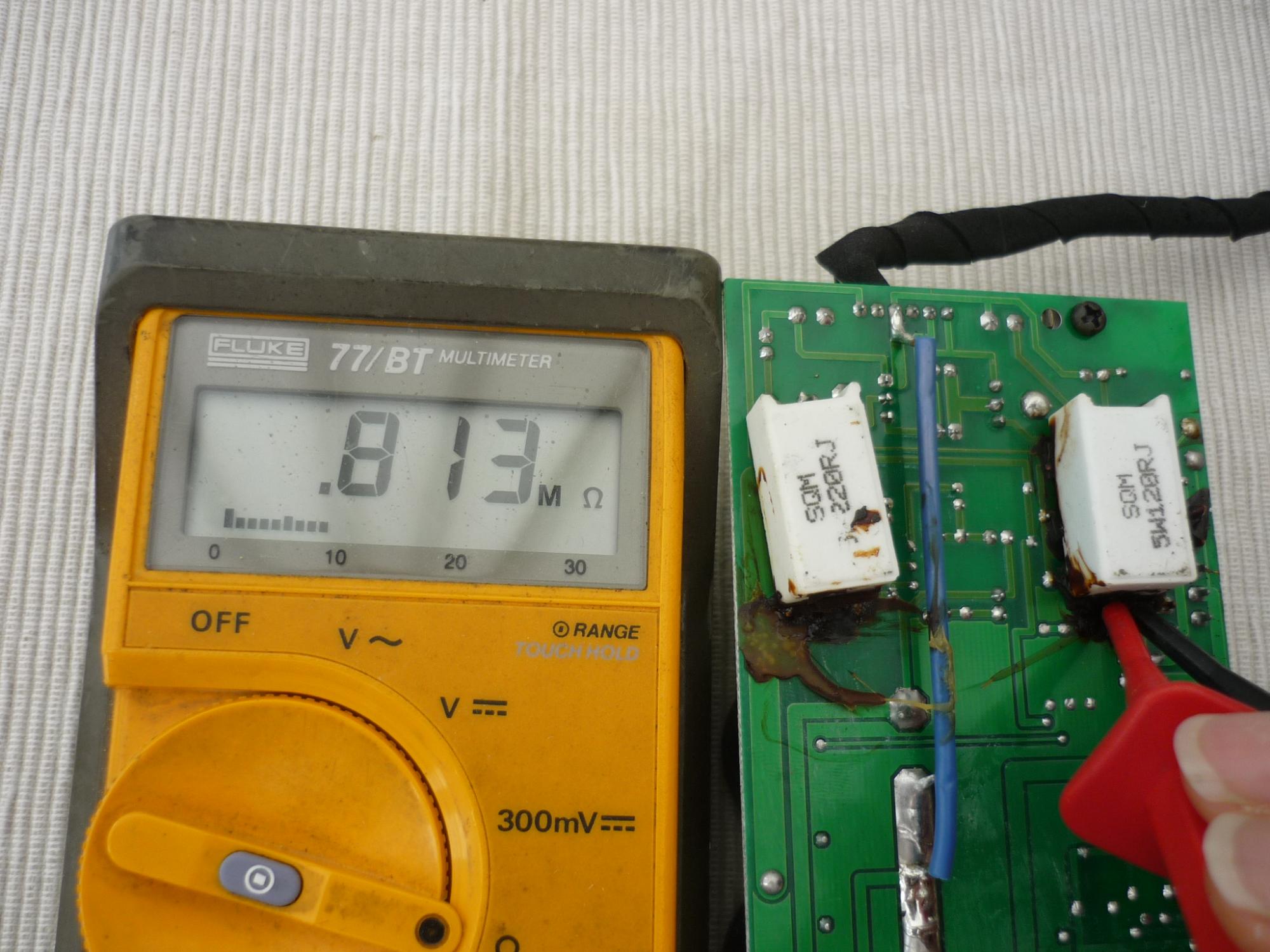

      Well, it looks like all the caps might be OK. Certainly out of cct testing shows that to be the case although the main supply filter caps will be investigated under working conditions later.
      So far R18 on the amp board has gone open cct as has L1 ( 120 Ohm 5W ceramic resistor?). This feeds the 15v regulator so there could be a problem on one of the other boards as the reg tests OK.
      I've managed to get most of the hardened gunk off but where it's been squirted all over the connectors and wires it almost impossible to get rid of it.
      Anyone know any chemicals that will just attack the gunk and not anything else? Tried various alcohols and carbon tet but it doesn't shift it, hard or in it's elastic state.
      Looking in the spares drawers and I don't have a 120 Ohm 5W, damm! Ebay here we come.

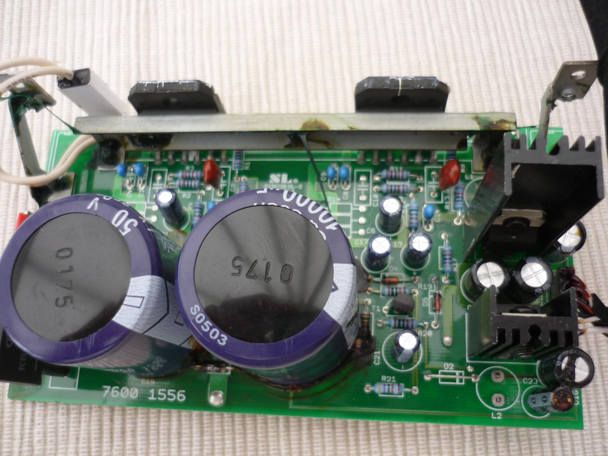

          The -15v reg (7915) had gone through cct which is unusual as they normally short, protecting the rest of the circuitry.
          Once replaced I noted something else was dragging down the - 15v rail.
          Traced this to 1xLM837 ans 1xLM833 on the preamp crossover board. Don't have any of these in stock either (groan)!
          Once removed and also with the digital input board disconnected both rails were now OK.
          When the digital board was reconnected both the rails dropped to around 6v. A few SMD devices on this board so not looking too good although I won't be using a digital connection so all is not lost. Removed a load of gunk from this board too!!
          The only device on this board that uses the -15v is another LM833 (SMD this time) but it appears OK or at least all the i/p o/p's are sitting at 0v. Might have to remove it anyway just to be sure.
          Happy days!

            All now fixed. It was only the resistor and regulator after all!
            I had put a variac in the mains lead whilst testing and of course it dropped the main voltage enough to drop the input to the regulators, doh!
            No IC's needed, hurrah, and no bad caps either for a change.

                Spoke a bit too soon. Output went distorted and then disappeared completely.
                Found R18 had burnt. I originally thought it was a 1K5 but realised it couldn't be as it was getting really hot.
                Next step was to phone Tannoy and ask what the value was. The nice man in the service department said he'd mail me the schematic, which he duly did.
                Now that's what I call service.
                Other manufacturers take note!
                It turns out it should be 7K5 and once replaced the sweet sounds of the speaker returned.

                  ...So far R18 on the amp board has gone open cct as has L1 ( 120 Ohm 5W ceramic resistor?)...
                  Sometimes inductors are packaged & colour coded similar to resistors. That component could well be a 120uH inductor (otherwise it would have an "R" designation).

                    Most definitely resistors. The types you're talking about are the same size as .25 or .5W resistors. These are ceramic blocks as can be seen from the pictures.
                    The board is strangely marked L1 which is why I put a question mark by it.
                    The schematic does have them listed as R however.
                    There was never any doubt in my mind that they were resistors as they feed the 15v power regulators.

                      Ahh...sorry. I didn't realise that those 2 power resistors were L1 & L2. I only looked at the photo of the top side of the board, & L1 was hidden behind the heatsink.
                      I take it that L2 is also a resistor (220 Ohms)?
