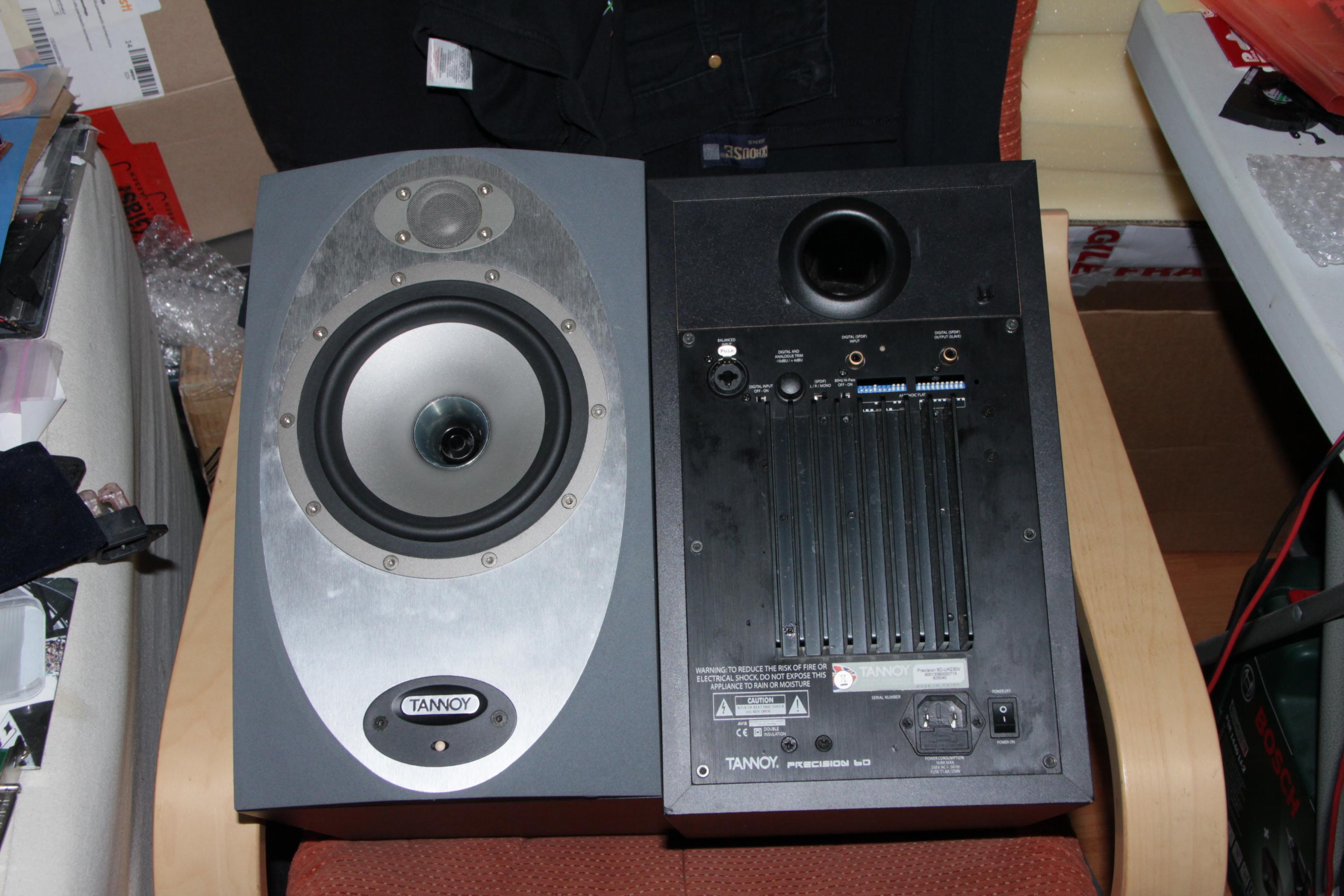

            Could someone please kindly ask a moderator to "update" the title of this thread to "Tannoy Reveal 6D / Precision 6D"?
            I finally took hold of a pair of Precision 6D's i grabbed off ebay the other week. Same cabinet & electroncs as the Reveal 6D, just with a coax woofer / tweeter. To my surprise, it turns out this latter couple actually has an additional passive(!) crossover inside the woofer enclosure.
            Seller said one's fine, but the other one only sometimes chirps or something, after several power cycles. In the words of Youtube's AvE, ye shall follow the teaching of our patron saint of teardowns, Dave Jones (EEVblog) and "don't turn it on - take it apaaaaaaa't!..", and so i did.
            Further updates coming later

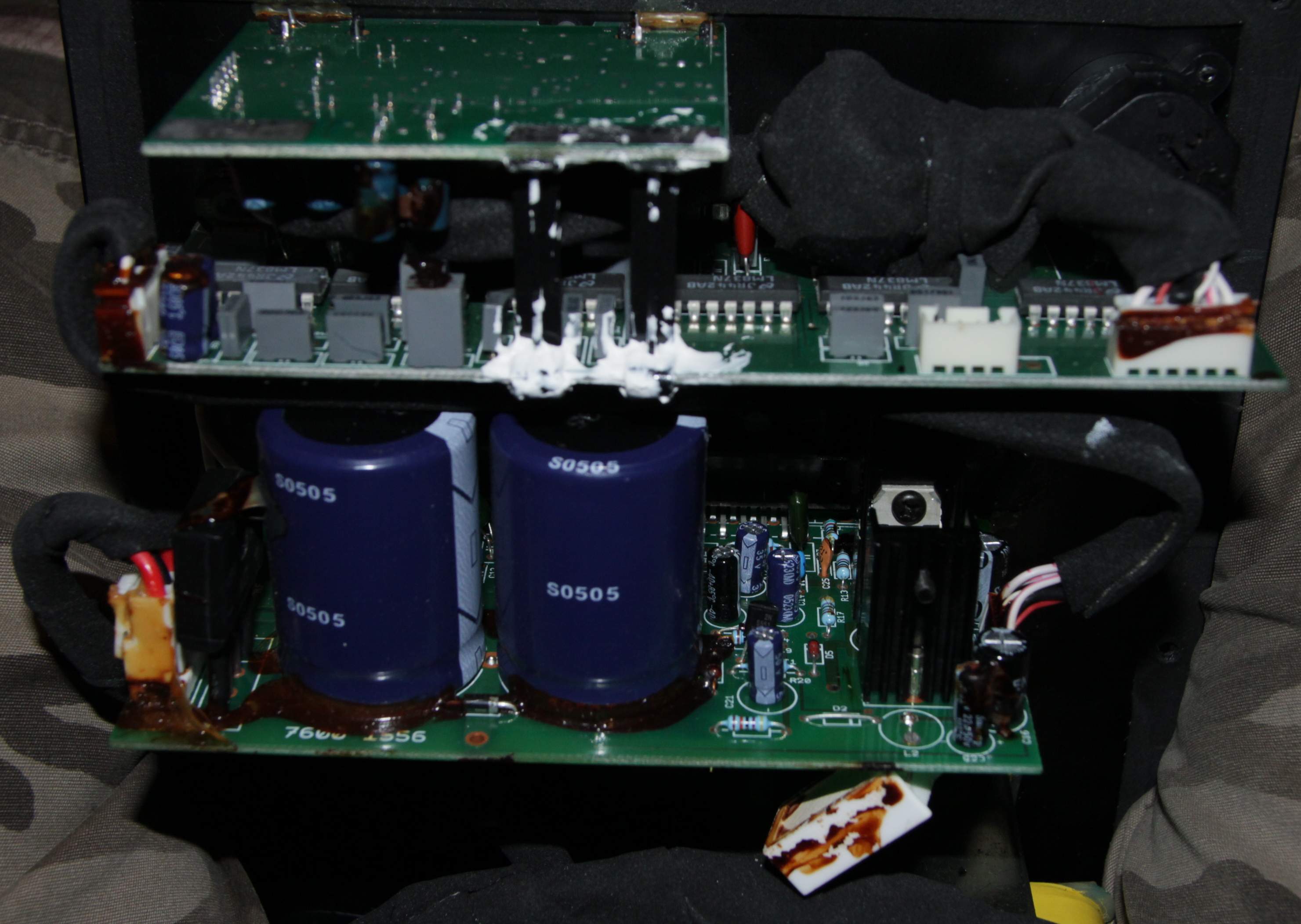

              #86
              Re: Tannoy Reveal 6D
              All i've got to report is that the 120 ohm resistor ahead of the 7815 had failed open. For the time being, i tacked on a series pair of 68+56ohm, and she's back to life
              This one was absolutely DRENCHED in that crap brown glue...
              I'll see where i can get some 7-10W resistors to replace both, in both speakers, for peace of mind. One of these days...
              Oh yeah, that passive crossover thing - even though i could see "W+ / W- / T+ / T-" on the pcb, that was "only" for the coax tweeter and the "supertweeter" up top.
              Real stubborn screws, so i couldn't be bothered to remove the pcb to see exactly how the LCR filter was hooked up.
              The coax tweeter goes through a huge 6.8uF film cap, and the "supertweeter" goes through the rest.
              My hunch is, the signal to the ST goes through the other film cap (0.68uF, if memory serves), and that inductor might be going to ground, to form a 2nd order high-pass, and maybe some padding with the resistor(?).

                  I've found some 10W ones on ebay from Germany, and i think i'll order both 120R ones and 220R ones, one of these days. I'll snap some photos when i crack'em open again.
                  http://www.ebay.co.uk/itm/Hochlast-W...Lmh73eE2N5nygQ
                  Yeah, they're axial, but i'll just bend one leg back down around the body, maybe tack on an extra piece of resistor leg (like what i'd need to chop off the other end), and that's that
                  And maaaaaaaaaaaaaybe, if i'm in the mood to "chisel" through some of the glue, i might even recap'em (small caps at least), but we'll see...
                  Currently waiting for some news from Lockwood Audio, about replacement supertweeters - one of them was well "caved in".
                  The thing is, when i found the listing for these Precisions on ebay, and after reading the description of the issue the dud speaker had, i quickly googled for some photos of the rear of the Reveal 6D's, because i remembered this thread. And as suspected, the backs looked identical, so i figured, what're the odds they just used the same electronics, just different drivers? And my hunch turned out to be correct
                  EDIT: At least for now, you'll have to settle for an external shot (only)

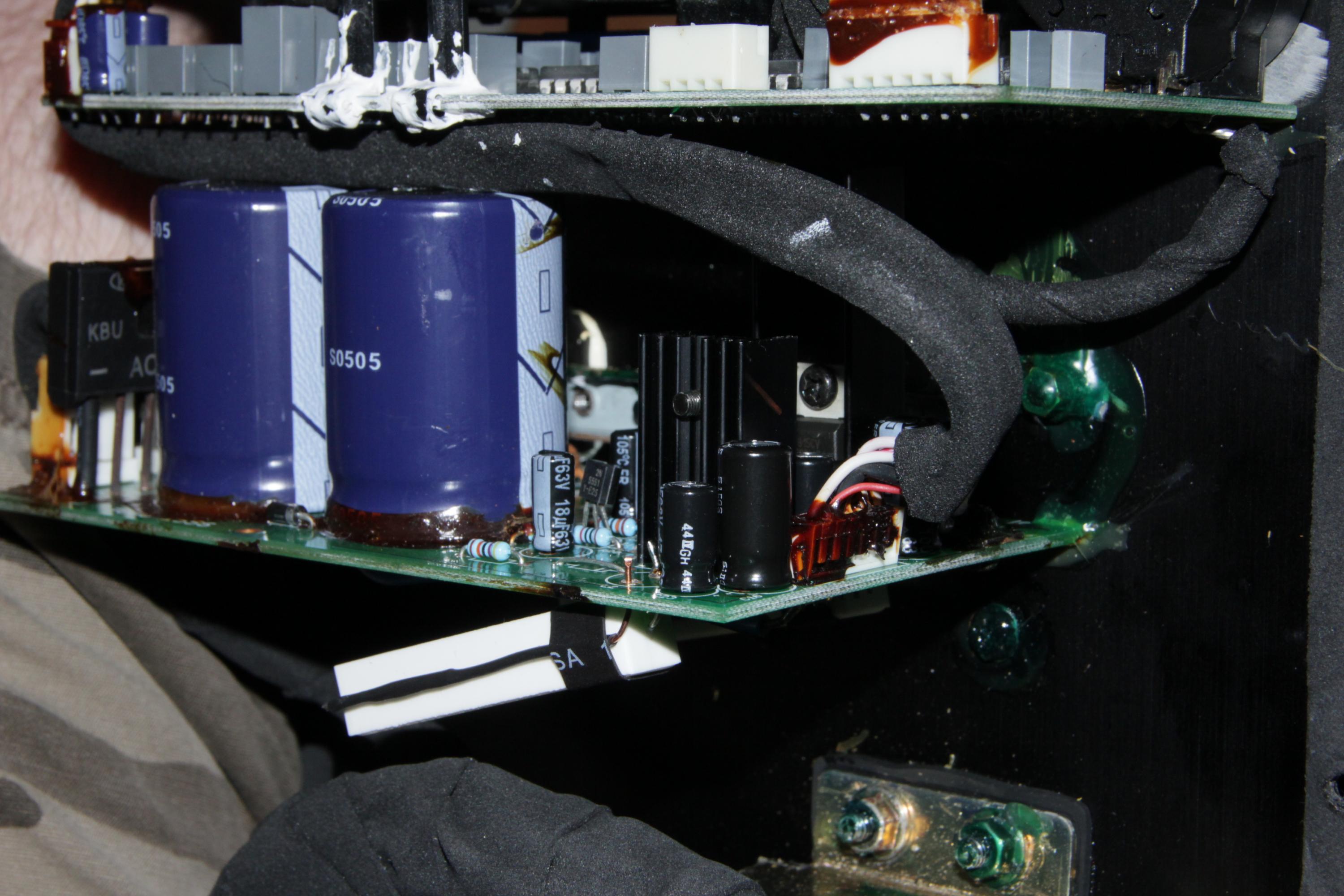

                  • Khron
                    • Sep 2006
                    • 1350
                    • Finland
                    #89
                    I've just started moving today - "fun"...
                    Either way, the 10W resistors arrived today, so after finishing two hauling trips, and dinner, i decided i had earned some "me-time", and got to work on re-res-ing ( ) and recapping these Precision 6D's.
                    First speaker (blue Su'Scon bulk filter caps) - first three pics are "before", the rest are "after".
                    Second speaker (black SamXon's, last two pics attached) - only two "after" pics. This was the one with more brown crap slathered on it, as can be seen on the big caps.
                    I didn't bother with replacing the two little electrolytics on the filter board (couldn't be arsed - it's been a LONG day), or the big caps (didn't have any 50-63v snap-ins).

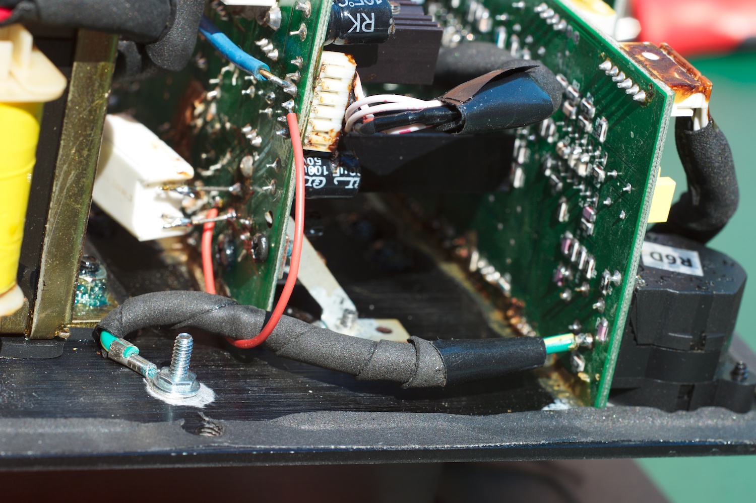

                                    As mentioned above, my son and I have repaired our Tannoy Reveal 6D studio monitors. The job became easier once we found the schematics linked above in this thread. Thanks for those!
                                    Background: In 2008 I purchased a pair of Tannoy Reveal 6Ds for mixing/mastering in our home studio and a pair of Tannoy Reveal 8Ds for listening to the results in our family room. Both pairs have had faults. A few years ago I pulled a working digital card out of one of the 8Ds and installed it into one of the 6Ds (they're the same), to keep that pair working. At the moment the other 8D has a fault in the analog signal path - I'll get to that one day.
                                    The latest problem with the 6Ds was almost complete loss of main driver output in one of the monitors. Actions taken in attempting repair were:
                                    - swapping main drivers between the two 6Ds to check performance. The driver was OK. Pulling the drivers out of the cabinets is tricky. I used a heavy duty paperclip with a right angle tip about 3mm long, with a chisel point made with a Dremel, to insert behind the speaker surround inside each screw hole, to gradually ease the driver out. The rear surface of the driver's magnet housing is goop-glued to a cross brace inside the cabinet. It doesn't just fall out. Prising with a screwdriver would damage the front surface of the cabinet and the plastic speaker surround, so progressively pulling with the bent wire was safe and eventually worked. No damage done.
                                    - Inside we eventually found that the white 120 ohm resistor on the power board had cracked solder joints. Wiggling it lifted a track from the board; a result of heat damage. We reinstalled the resistor using 15mm lengths of paperclip to move it away from the board. Unfortunately this first repair did not make the music come back.
                                    - Next we found what looked like corrosion under the chassis ground screw, with the lead coming from the analog input connector. In trying to disassemble that we found that it had no effect. The screw ended up stripped, so we made a new ground connection, seen in the pics.
                                    - My son and I watched this video by Billm and made the probe pictured below with an old guitar cable. With this and my son's old Roland amp we hunted around and discovered that while the low frequency audio was making it off the filter board to pin 3 on connector 1 of the power board, it was significantly attenuated at input pin 10 of the low frequency amplifier chip, with very low output at pin 3 of the chip. We checked resistor 9, the only component between the two points and it was OK at 510 ohms. By holding the board in the sunlight every which way and looking closely at the track coming from pin 3 we saw that it was corroded, probably from the goop applied to stop the connector from moving. We tried a quick jumper cable and the tunes came back! The jumper cable is now properly soldered in place, between pin 3 of connector 1 and the soldered junction of resistors 9 and 13. I'm listening to the Eagles greatest hits now - us dudes born in the sixties are allowed to do that.
                                    Thank you to TJC on this thread for his Reveal 6D repair site we found before this thread, and his link there to the amplifier chip data.
                                    Now let's see if I can post some pics.
                                    Here's the audio probe. We played a familiar song into the analog input and traced high and low frequencies on the filter board. The highs go to pin 5 of connector 4 on the filter board. The lows go to pin 3.
                                    The next two pics show the jumper cable that replaces the dodgy track from pin 3 of connector 1 on the power board to the junction of resistors 9 and 13.
                                    Here's the fix to the 120 ohm resistor.
                                    Here's the re-routed ground from the analog input jack.
