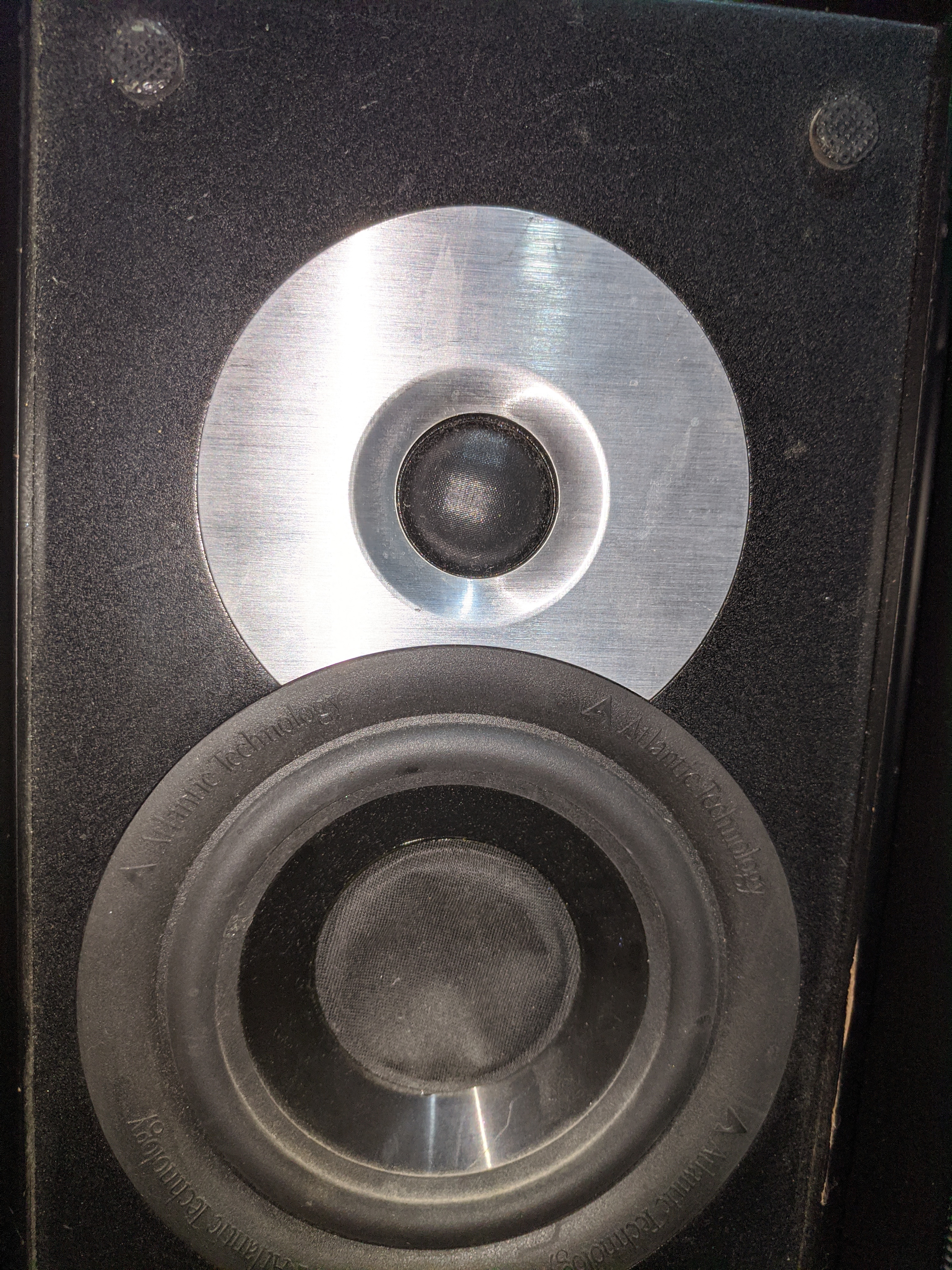

Speakers damaged from children. Can this tweeter be repaired?
  • goodpsusearch
    • Oct 2009
    • 2850
    • Greece
    Speakers damaged from children. Can this tweeter be repaired?
    I got these speakers that seem to be damaged from the previous owners small children.
    As you can see on the first pic, the tweeter's outer membrane has been totally ripped.
    I also post another pic with the other speaker that survived...
    Is this beyond repair?
    I have no clue about soft dome tweeters.
    • Jul 2011
    • 6040
    How distorted does this speaker sound because I have a pair of speakers that this happened to from being stored with out the covers for the speakers they were misplaced but as long as you do not play it really loud they sound decent
    If the looks of it bothers you , you can take a sowing needle and very carefully pick it back out but it will not look perfect but you can make it look a lot better than it does now but you have to be careful and patience to not damage it to the point where the sound will be worse than it is now
    Now the one tweeter is damaged to the point of no return unfortunately and it might be almost impossible to find a exact replacement for it so you might need to replace both of them
    Last edited by sam_sam_sam; 12-26-2023, 08:06 PM.
    • redwire
      • Dec 2010
      • 3910
      What we did in the repair shop was use a vacuum cleaner WITH BIG AIR LEAK like the attachment for cleaning drapes which has a hole on the side, to suck out the domes gently without ripping the cone out.
      I don't like the pin-poke and making a hole, the air leak is a problem.
      • goodpsusearch
        • Oct 2009
        • 2850
        • Greece
        I created this thread mainly about the tweeter but let me take the chance to ask a question about the dust cover of the woofers.
        When the dust cover is poked in like this :
        https://www.badcaps.net/filedata/fetch?photoid=3168509
        does this affect the sound? Because I was under the impression that people try to fix this just for aesthetics and not because it impacts the sound.
        Yeap, the tweeter is open circuit to multimeter and as expected totally silent when connected to an amp.
        I carefully removed it, posting pics of the operation:
        • petehall347
          • Jan 2015
          • 4426
          • United Kingdom
          if expensive enough there might be a rebuild kit . failing that is replace it .
          • goodpsusearch
            • Oct 2009
            • 2850
            • Greece
            At last I found some time and tried to repair the dust cover of the woofers that had that issue. I used super strong duct tape to pull the dust cover out.
            On one of the woofers, the glue that is supposed to keep the dust cover attached and sealed on the speaker cone has been gone.
            What type of glue should I use to seal the hole shown in the pic bellow?
            Is epoxy glue 2 component suitable for this type of application?
            • petehall347
              • Jan 2015
              • 4426
              • United Kingdom
              Originally posted by goodpsusearch
              At last I found some time and tried to repair the dust cover of the woofers that had that issue. I used super strong duct tape to pull the dust cover out.
              On one of the woofers, the glue that is supposed to keep the dust cover attached and sealed on the speaker cone has been gone.
              What type of glue should I use to seal the hole shown in the pic bellow?
              Is epoxy glue 2 component suitable for this type of application?
              tsa blacken 99 is the stuff if you can find it
              • goodpsusearch
                • Oct 2009
                • 2850
                • Greece
                Thanks a lot but it seems it is not available in my country (Greece)
                • прямо
                  • Sep 2022
                  • 261
                  • Indonesia
                  I used T-7000 glue (both transparent and black) in the past to glue a speaker cone dust cap, and it works great.
                  • goodpsusearch
                    • Oct 2009
                    • 2850
                    • Greece
                    Ended up using epoxy 2 part glue that I already had in hand to glue the dust cap to the cone.
                    • XxMicroSoldering
                      ASUS Rog Strix G17-712LV Laptop Liquid damaged
                      by XxMicroSoldering
                      Hello Guys
                      I have a ASUS Rog strix laptop that I bought recently to fix and the previous owner spilled water on it . He brought it into a repair shop for them to check it out and instead of fixing it they damaged the battery connector of the laptop ! Other than that they damaged damaged nothing . But since the liquid damage the laptop only turns on and the keyboard lights up and then immediately turns off. I really want to repair this laptop and I also have experience in repairing phones etc and laptops and a bit of soldering but the diagnosing part is where I need help with and...
                      10-17-2024, 10:45 AM
                    • Tomylee
                      Identification of Component T5 on NEXIQ USB-Link 2 (damaged due to crushing)
                      by Tomylee
                      Hi everyone,
                      I'm currently repairing a NEXIQ USB-Link 2 that was physically damaged due to crushing. After a thorough inspection, it appears that only one component is visibly damaged: the T5 component, located right next to the Mini-USB port.
                      It's a 4-pin SMD component, with one pin at each corner, aligned front-to-back along the USB port axis. Unfortunately, it is broken, and there are no visible markings left on the part to identify it.
                      I'm looking for help with the following:
                      The exact identification or part number of the T5 component
                      05-28-2025, 12:42 PM
                    • tofik
                      LG 50PA6500 Plasma TV damaged after a power spike
                      by tofik
                      Hello, I have an LG 50PA6500 Plasma TV, purchased new in 2012.
                      Unfortunately plasma is not working at all after a power spike.
                      Qucikly tested the PSU and voltages seems to be okay, when eveything is disconntected from the PSU I got:
                      VS = 200-206 / actual = 205 V,
                      VA = 55 / actual = 54.9 V,
                      M5V = 5.2 / actual = 5.19 V,
                      17 = 17.24 V,
                      5.2 = 5.19 V,
                      STDBY = 5.19 V,
                      ERROR_DET = 4.8 V - does it mean PSU is damaged? the rest of the voltages seems to be fine.
                      what's your opinion about the PSU?
                      Also I just...
                      12-20-2022, 03:08 PM
                    • Tomylee
                      No LCD image after connector replacement – lifted components and damaged resistor (Nintendo Switch Lite HDH-CPU-02)
                      by Tomylee
                      Hi everyone,
                      Sorry for the person who’s going to read all this !
                      I'm on a Nintendo Switch Lite, motherboard HDH-CPU-02.
                      While replacing the left joystick, I had to remove the motherboard to access the connector underneath. When I lifted the LCD connector latch, it broke (the plastic had become brittle over time), so I replaced the entire connector.
                      During the desoldering of the LCD connector using hot air, three small components located just below the connector (likely 0402 capacitors) came off and remained stuck to the bottom of the...
                      07-11-2025, 11:52 AM
                    • chronic519
                      Mats / mods: detected and repaired GPU fault. Cant seem to test after!
                      by chronic519
                      Hello.
                      GPU came in, green lines. Spent lots of time using to get the Mats / mods drive working (found on youtube).
                      Found issue with a RAM block
                      Replaced, green lines gone.
                      Trying to test again, assuming getting the false positive. Originally had over 1K on a single bank. Now getting tosses low between banks.
                      Used a good card to test and same results low errors 32+.
                      I am just search for some form of command to do a full test on the GPU.
                      I just ran the mats command with my good GPU and passed after roughly 40 min.
                      The repaired one, ran...
                      05-20-2025, 07:56 PM
