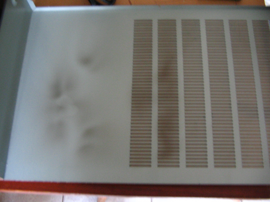

                                      NAD C320BEE - Smoke Signals
                                      I could always plot the smoke residue under this amps cover.

                                        Re: NAD C320BEE - JH Capacitors
                                        Ha - heat
