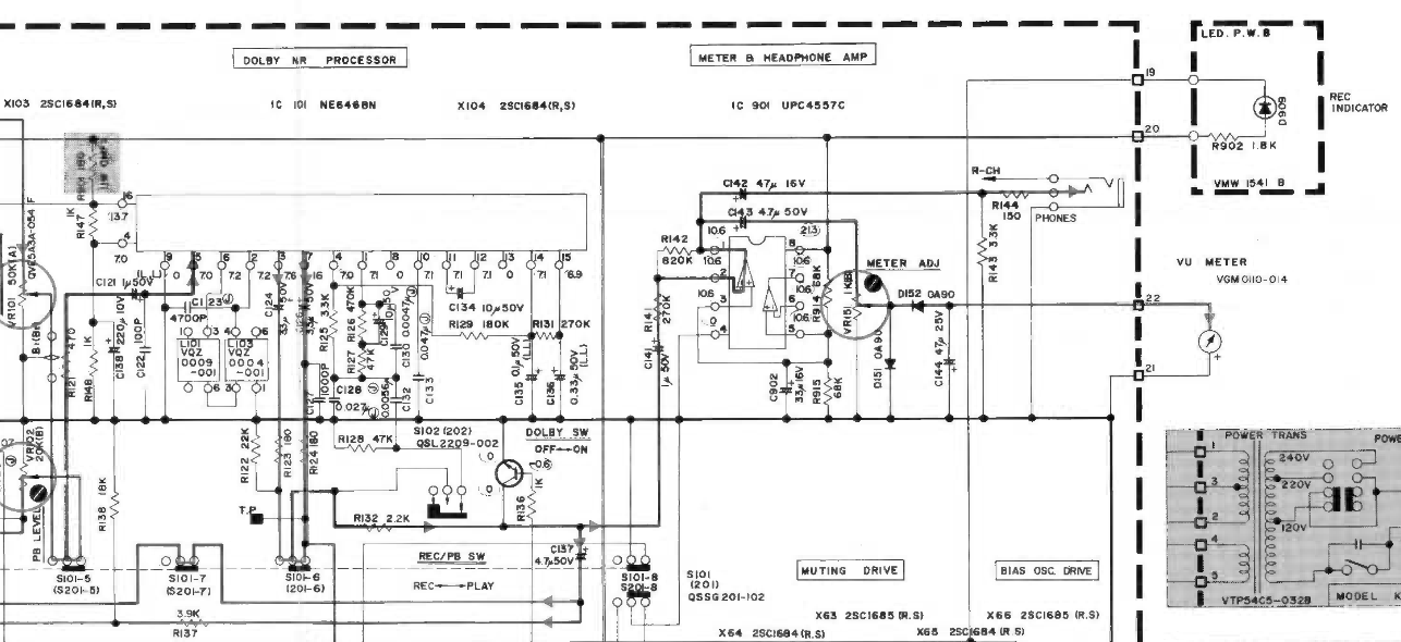

    If I were you , I would check the internal resistance of the VU meter itself ,then try to resolder its pins if on board.Try that first and if it didn't work ,repost .

        the circuit between the VU meter and the UPC4557 is pretty simple. Since you got two channels (left and right), compare them to each other with an oscilloscope...
        Did you check VR151 if it's open? Check if the audio coming out of both channels are equal in volume. You got to figure out is it only the VU meter (circuit) that isn't working correctly or is one channel low in volume causing the VU meter to read low. Read page 11 and 12.

                    I just checked the schematic and the board. The UPC4557 uses one side for one channel and the other side for the other. There are no two separate op amp IC's for each channel. I would look hard at caps in series (DC blocker) like C143. When these go high in ESR in a circuit like this, you loose audio volume. Other than that you could take UPC4557 out, solder in some wires to the board and wire up UPC4557 channels up in a manner that left is right and right is left. If the problem indeed is the one side of the op amp, the problem should be now on the other VU meter.

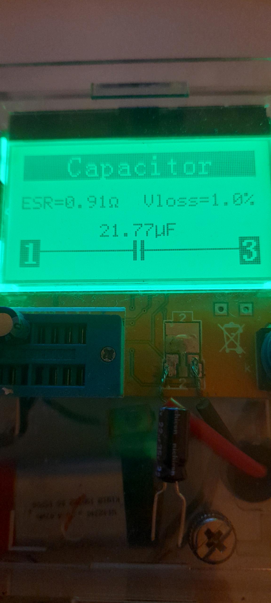

                        Re: Damaged system of the VU indicator in the JVC KD-A11 tape recorder Request for re

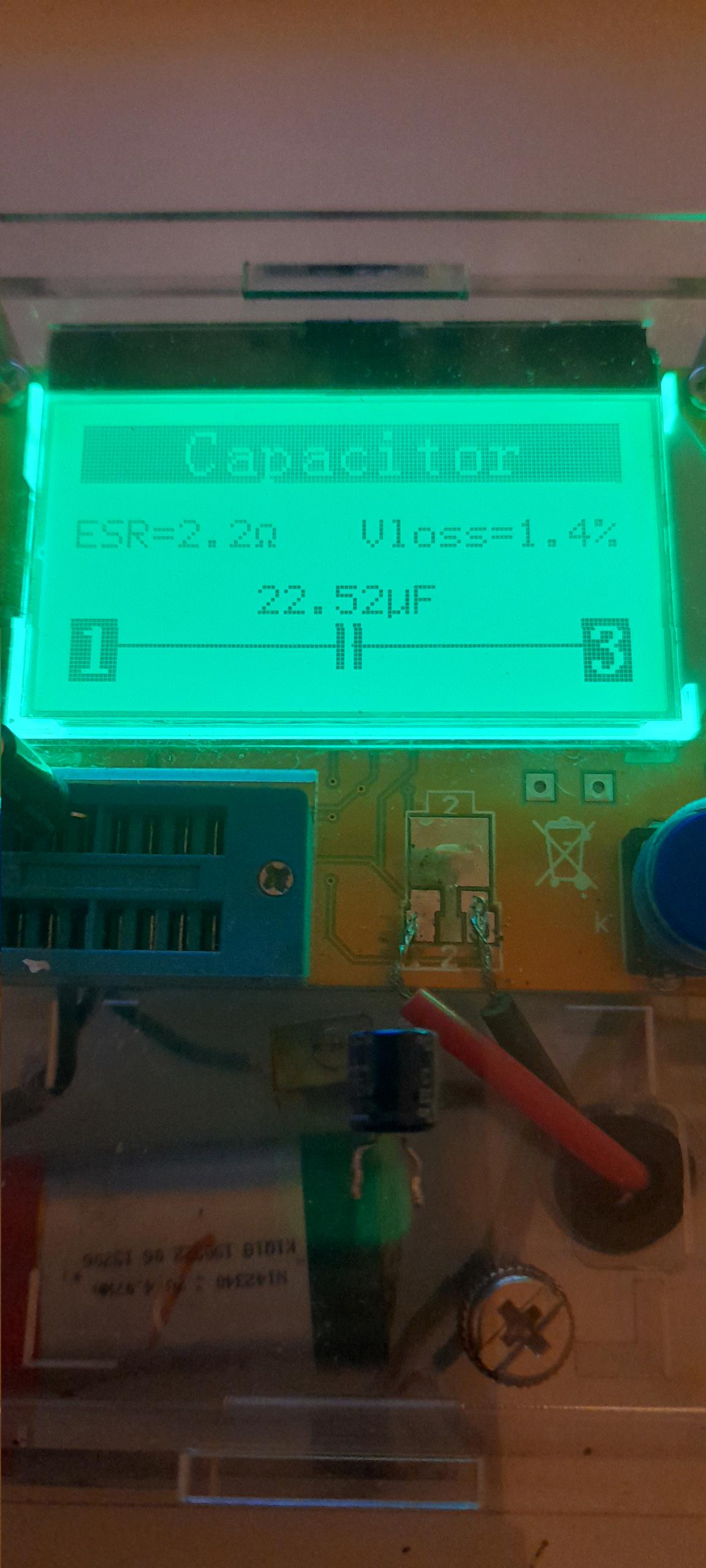

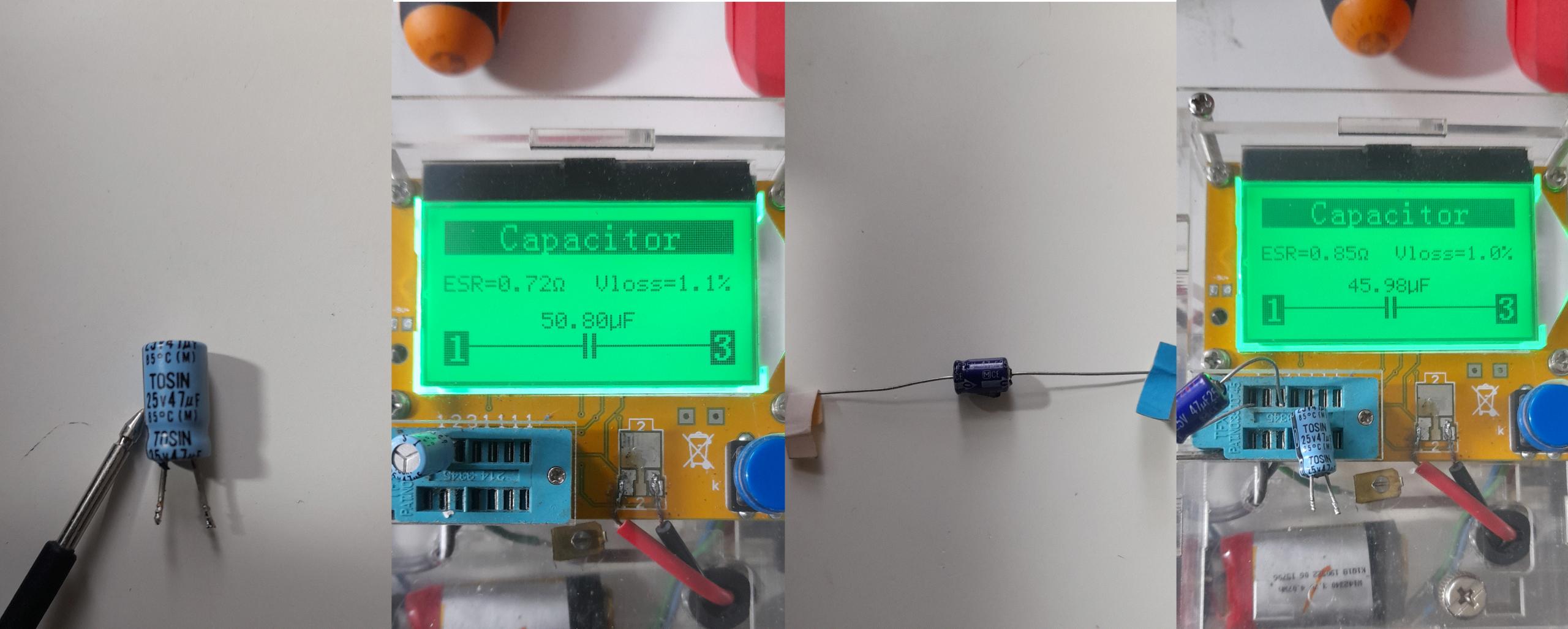

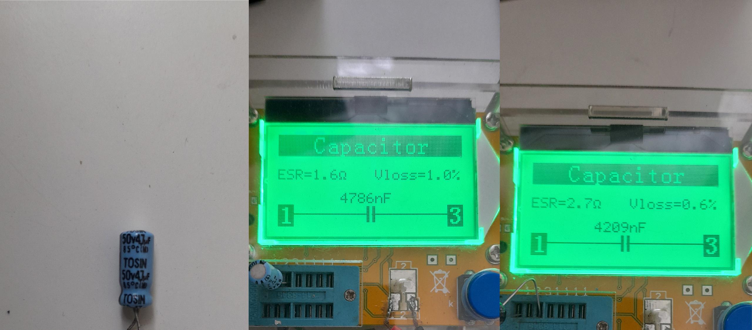

                        In the first photo, the value of the capacitor desoldered from the circuit.
                        The second photo shows a new capacitor.
                        The new ones had higher ESR and Ω
                        Tomorrow I can change them for new ones, or order capacitors with better parameters?
                        Thank you all for your involvement. I will also need tips on how to use the oscilloscope properly.
                          Those seem ok. NOTE: in your impedance check of the inputs to the op amps, your 2/3 measure is the one of concern because that is the input associated with the left channel which you say is not working correctly.

                            The VU meter rectifier diodes D151, D152 are OA90 germanium diodes. So they have a low Vf around 0.34V@1mA on a multimeter.
                            Notice it is a bit strange the meter/cap are reversed polarity, the (+) goes to GND.
                              excellent pickup. That cap is likely bad IF that is what he took out of the system. It appears that the OP was just going by the fact that he got a reading with the meter as opposed to looking at the schematic for what the values actually are... maybe.

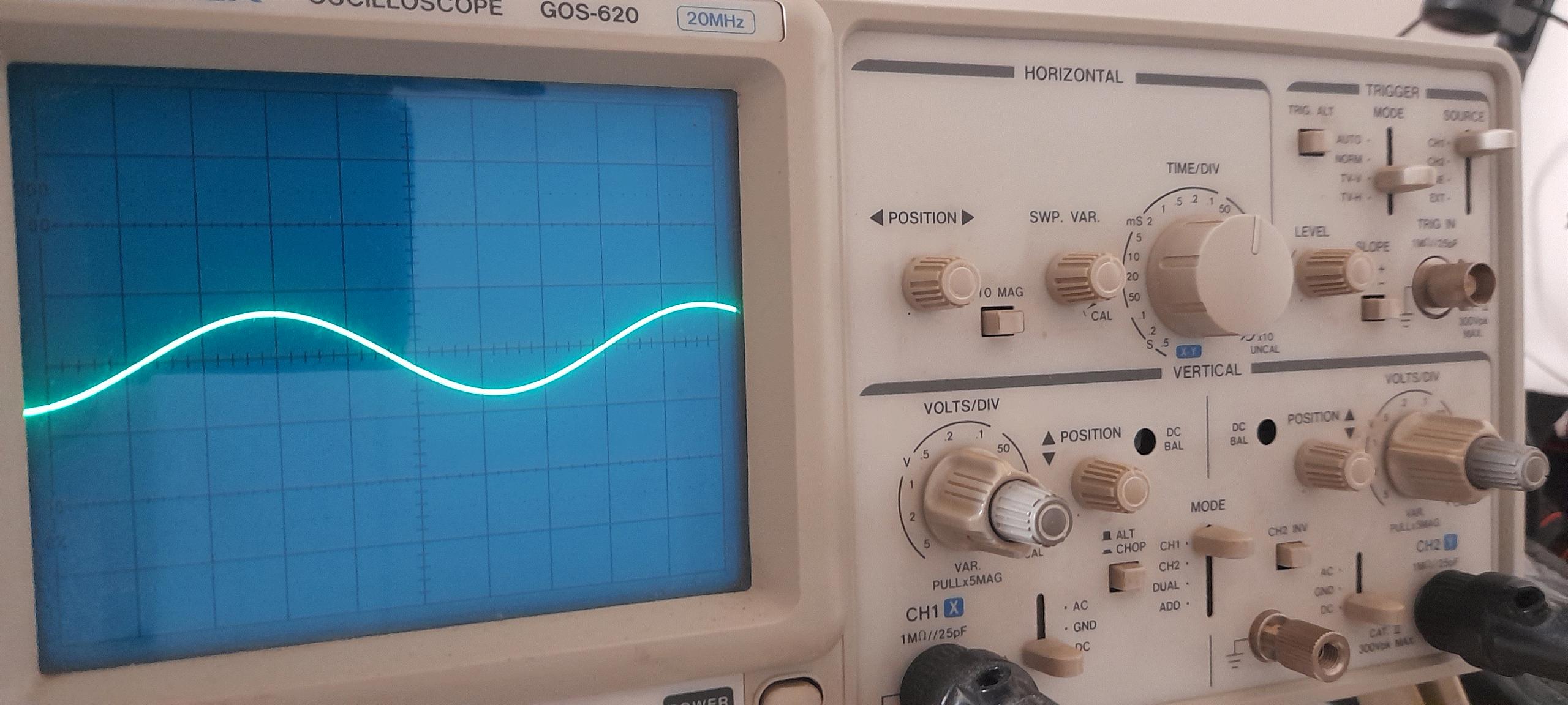

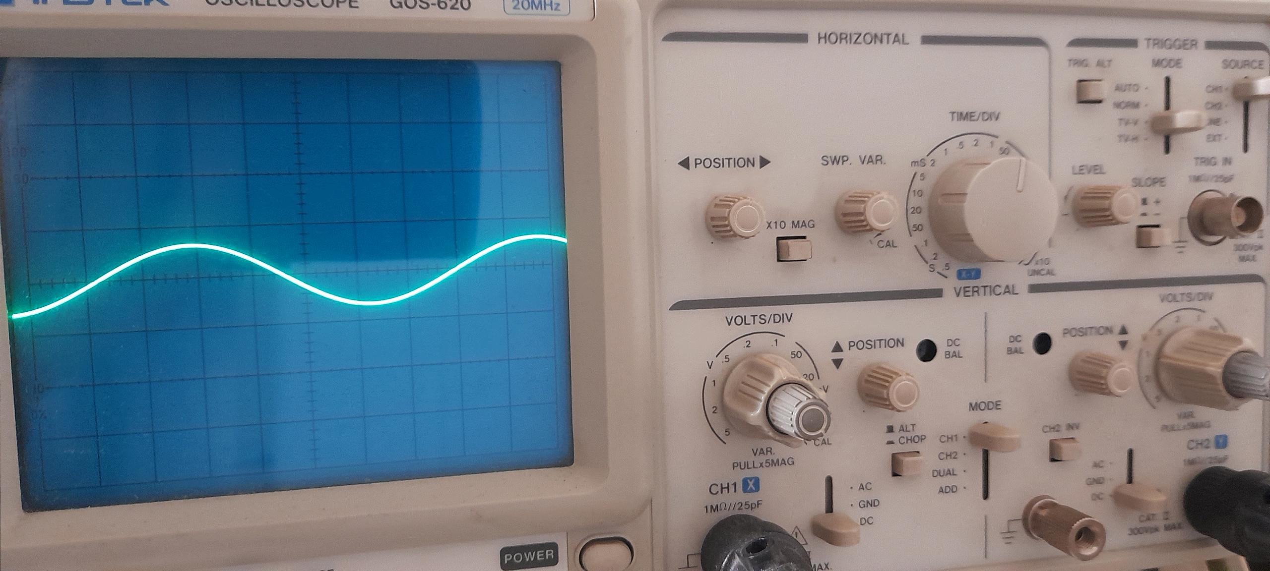

                                The LINE IN inputs a 1kHz Sine signal
                                The oscilloscope connected to the output, the results of Lch and Rch can be seen in the pictures.
                                I only have basic information from his service. I don't have an isolation transformer and the oscilloscope is connected to the same wall as the tape recorder.
                                Volts/Div = 0.2V
                                Time/Div= 0.1ms
                                Probe= X1

                                  good work... just to confirm, are you referring to the outputs of the 4557? You need to check the output just after the caps in question (just after the 4557 outs) to see what is being delivered to the meters.

                                      Only when recording is turned on, I can hear the 1kHz sound from the generator on the output
                                      The right vu meter connected to the oscilloscope when I turn on 1kHz,
                                      The voltage drops by about 120 - 140mV
                                      Left vu meter to the oscilloscope. The voltage drops by only about 5mV
                                      The oscilloscope connected between -, + C143, shows nothing.
                                      same with the C243
                                      Oscilloscope between Vr151- gnd and C143 - negative = 0.5V
                                      Oscilloscope between Vr251- gnd and C243 - negative = 20mV
