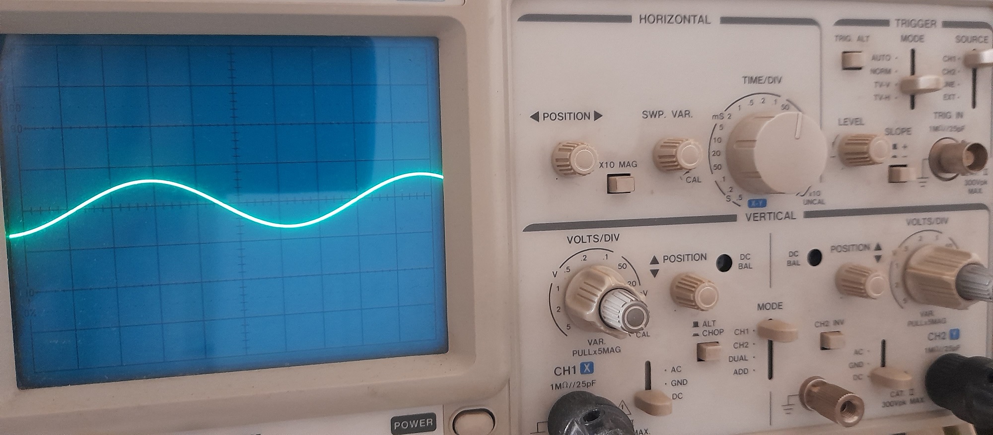

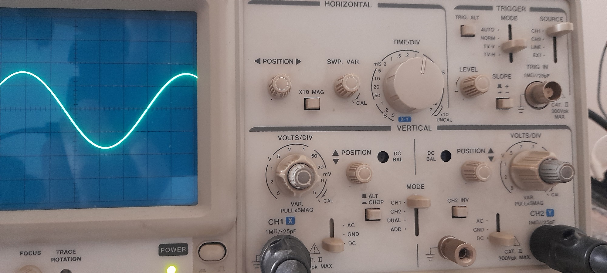

    I assume that the VU meter in the right channel is working properly
    0.2V/DIV
    0.1ms/DIV
    probe for C244
    I got 150mV?
    Way too much on the left channel.

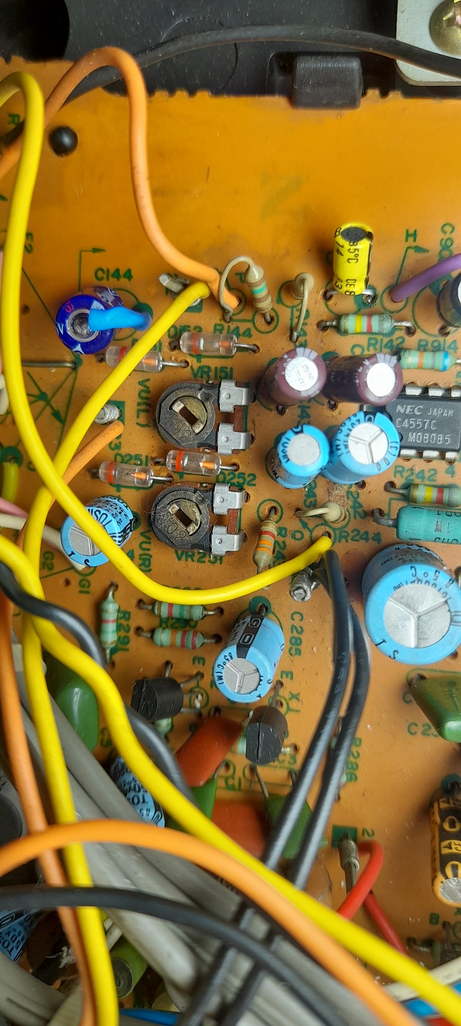

                I measured the resistance of the main pot 2x20k R101 and R201
                pin 1 and 2
                from 19 goes down to 0
                pin 3 and 2
                from 0 goes up to 19.6
                R101,201 seems ok.
                now VR151 and VR251
                VR151
                pin 1 - 2 gnd
                from 0 goes down to 0.9
                pin 2gnd - 3
                all the time 24k!
                VR251
                pin 1 - 2 gnd
                from 0 goes down to 0.8
                pin 2gnd - 3
                from 1.1 goes down to 0

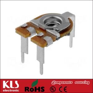

                      well, not sure what to make of that. What kind of variable resistor is it? (picture?) 24K does not align with overall resistance and any "sub section" should change with the adjustment.
                      Also, please indicate which pin number is connected to where in the circuit.
                        #31
                        Re: Damaged system of the VU indicator in the JVC KD-A11 tape recorder Request for re
                        VR151 must be bad, Check across the two outside pins (not the center wiper) it should read 1K. 24k suggests it is almost open.
                        Does it look like this?
                          #32
                          You both have a point. It;s the VR151 that is bad.
                          When I washed the VR151, the resistance dropped to 3K. I've already ordered a new one for replacement.
