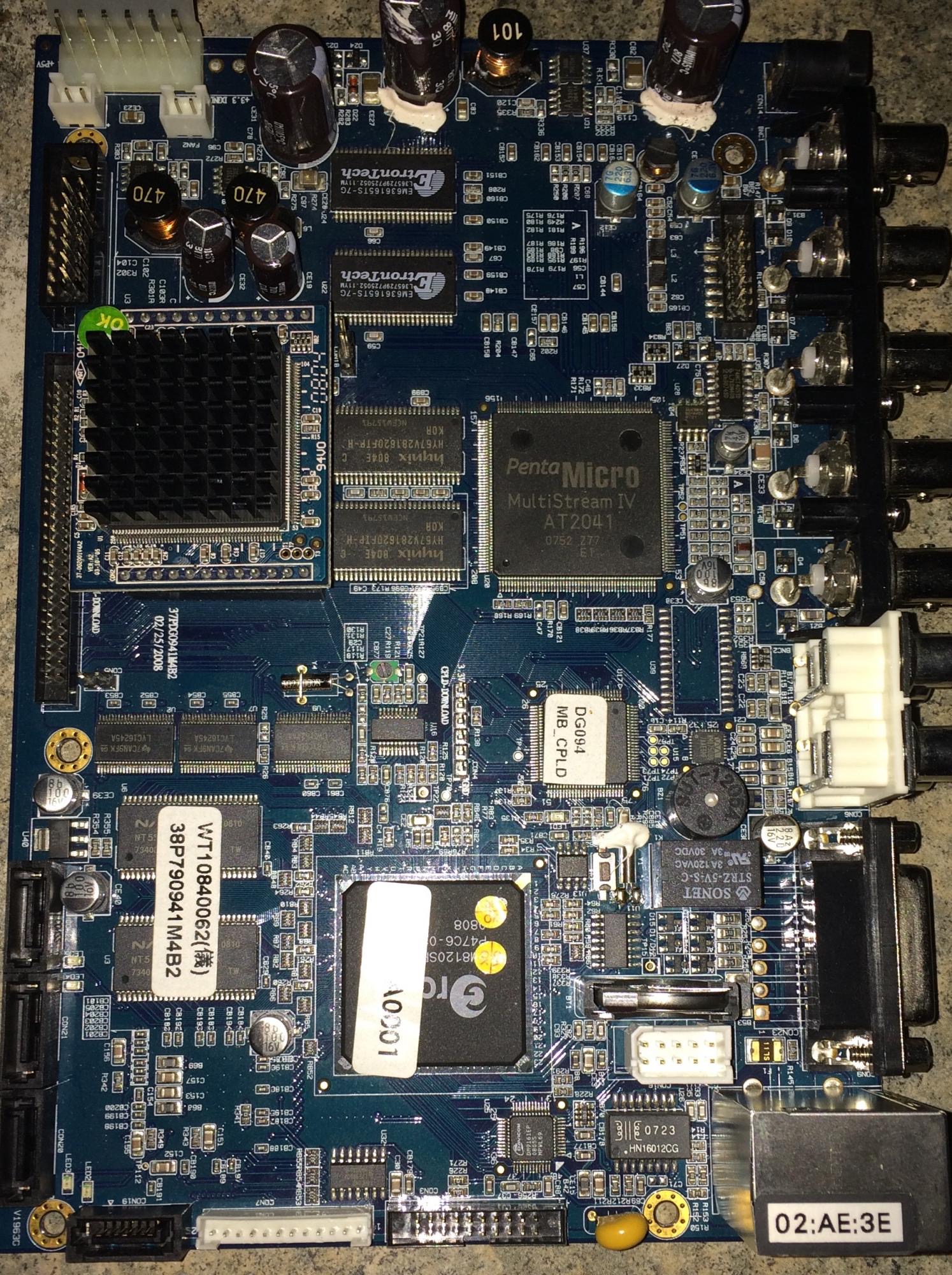

    When I originally started with my DVR recorder it had 4 individual switching switching power supply’s that were sh*t so I bought a 7 amp 12 volt switching power supply and modified the output plug and put a four output power supply cable to match the input power supply cable inputs
    Which worked for over 14 years until a few days ago when the cameras went dark no picture anymore well it turns out now the switching power supply has stopped working altogether now so I have to troubleshoot what has happened to this power supply more later on today what I found

    Here is a photo of the inside of the DVR recorder
    I have another DVR recorder and it shows the right way with no line or anything that not suppose to be there
    I have a question about ordering the surface mount cap on this board I want order them from Digikey what would the part number be for one of them
    They used very good brand KY

    7G ?
    220 uf
    6.3. Volts

    The switching power supply had a major malfunction on the primary side of the power supply not going to be able to repair that is not going to take a majority of my time that I do not have just going to part it out the main filtering capacitor has a severe short circuit issue that I do not want to deal with
    So I just going to buy another switching power supply 4.16 amp outlet current unfortunately I could not find a reasonable price switching power that was 7 amp current output but this power supply was surplus and very reasonable priced at the time and I think was a medical grade even though it does not say that it is

      That top cap by the "101" doesn't look that healthy.
