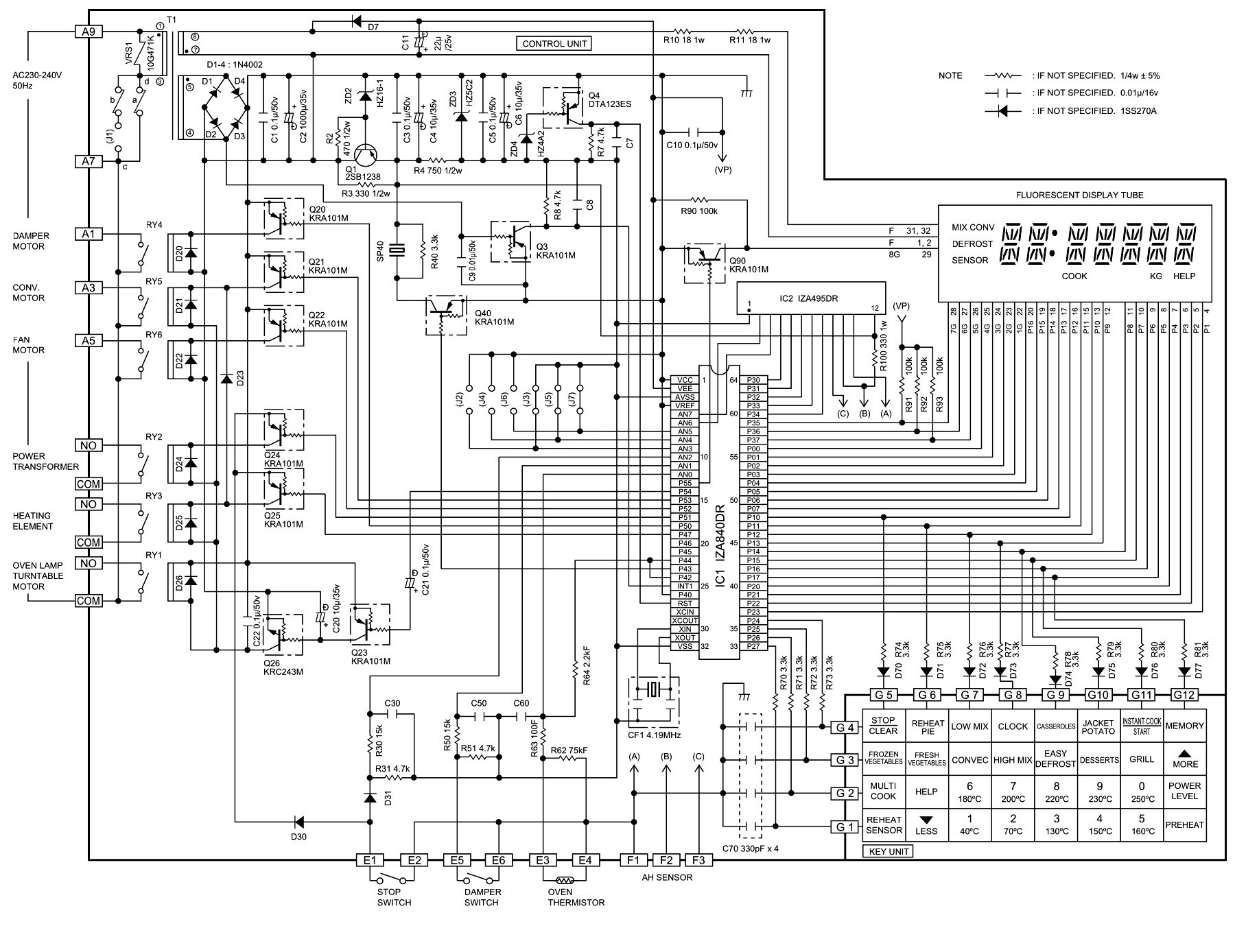

    Hi guys,
    I cleaned the microwave, but now it makes a rapid clicking sound, then smoke appears. I had a look and it appears to be coming from the front touch panel. I have a feeling a little water got into it(I saw very little on the relays but nowhere else), but smoke is not a good sign. I have a video and come pictures.
    I was going to desolder and open the relays but Im not sure if you can. It also appears a couple of resistors and a diode are showing signs of heat/burn.
    Res #1 - 470Ω
    Res #2 - 330Ω
    Zener Diode (unknown value/model)
    Relay (I could only see info for 1x relay. I'll have to desolder the others to check if they're identical. see picture)
    https://youtu.be/TKIxzIIyI1c
    Anyone worked on Microwaves before, particularly the front panel ?

    [update] I desoldered the other relays, they're the same model as the one in the picture above. There was a little surface water on the underside of the relays, but I didn't see any damage/burning on the relay or the PCB.
    I found the data sheet for the relay, though I'm not sure i'm reading it correctly.
    https://pdf1.alldatasheet.com/datash...F-S-118LM.html
    I checked resistance on the relays, they read 588-597Ω. The datasheet shows (under 'coil data', three different values for resistance. Or is that only under load ?
    Readings of the resistors and diode,
    Res #1 - 455Ω
    Res #2 - 320Ω
    Diode - (-) cath .688. (+) cath 1.329
    These were done with components still on board.

      Re: Microwave started making rapid clicking sound and smoke
      different resistances for different voltages . yours will be 18v dc
        What make and model is this?
        ZD2 and the fusible resistor next to it, looks like normal soot buildup from parts running years 24/7 with heat, you can see convection currents form deposits.
        I'd keep looking for the "clicking" and smoke source. There should be 18VDC power available for the relays. And another lower voltage for the MCU. Let the oven dry out too.

                  I found a service manual for this model Microwave. It's got detailed diagrams in it which is pretty cool. It says,
                  (page 36. I'll attach a copy of the service manual)
                  1. (ZD2) Zener Diode, HZ16-1
                  2. (R2) Resistor, 470Ω 1/2w
                  3. (R3) Resistor, 330Ω 1/2w
                  4. (Q1) Transistor, 2SB1238
                  I've tried looking at Mouser and element14 for the Diode, but I can't find anything on HZ16-1 besides a datasheet :/
                    From your pictures of the board where the relay is mounted, I suspect there was a poor solder connection between the relay pin and the board trace, That is likely all that was wrong. RY5 is for the convection motor only. The microwave ovon should operate without RY5 installed but I suspect if you reinstall the relay and it will likely work fine.
                    Post a picture of the trace side of the board where the relay mounts.
                    When the poor connection arced it caused the smoke.
                    If you plug in the mwo do you still have a display? If yes I suspect the board is working
                    Q1,ZD2 are a simple voltage regulator circuit, If you want you can check the DC voltage across C4, it should be around 16V, the voltage then drops across R4 to 5.2 volts (clamped by ZD3)
                        If the zener diode was bad or shorted the display would not have worked. The zener diode is just a 16 volt 1 watt zener. The board is discolored due to heat over the life of the mwo, it is normal and not the problem.
                        The black soot around the pin of RY5 came from a poor connection not from the relay itself. and like that relay operates the convection fan only, nothing else.
                        If the board is dry and the keypad is not damaged, it should be ok to plug in the microwave without it starting up, only the display should be on.

                              Thanks RJ. I had a look at Diode (75) and Diode (76), couldn't see any moisture. I rubbed a bit of IPA over them just incase, and i'll warm the board a little with the hot air gun
                              Question, I have two Resistors on the board that I wanted to test just in case. The service manual says they're both 18Ω 1w,
                              When measuring resistance in-circuit, I get
                              R10 - 13.3Ω
                              R11 - 16.8Ω
                              ... but when I remove them from circuit and test, I get,
                              R10 - 17.9Ω
                              R11 - 36.2Ω
                              Why is this? Should I desolder components first before testing ?

                                They are fine. R11 is marked 360 which = 36Ω. R10 is 18Ω
                                You said the display works... correct? that means the control board is working.
                                the resistors are in series with each other, the filament winding of the transformer and the filament (heater) inside the VFD.
                                So when you check R10 the other one R11 and the filament winding/heater are in parallel with it.
                                This mwo is at least 16 years old, there will be some signs of age, like darkening around components that run warm, and collect dust/cooking grease etc.

                                  Awww we got dumped, OP where's the commitment? https://www.eevblog.com/forum/repair...me-assistance/
                                  I haven't seen any evidence of water damage so far, so 'fess it out and dry it out already.
                                  When doing repairs, you take a hypothesis "I think water got in the front panel" and then go to find evidence for that.
                                  You can unplug the keypad and take resistance measurements or look for the water in the membrane.
                                  The relay RLY5 black spot almost looks like a lightning discharge from a mains transient.
                                  R10, R11 are for the fluorescent display filaments - that circuit is low resistance due to the tube and transformer, so in-circuit measurements would be lower than the part's values. They look fine.

                                    Thanks RJ. The LEDs work, when microwave is turned on, the screen lights up and you can see the numbers. issues I see are,
                                    1. The odd crack sound and burning from the board
                                    2. The LED showing #4 instead of #5, and #9 instead of #0
                                    [QUOTE=redwire;1115015]Awww we got dumped, OP where's the commitment? https://www.eevblog.com/forum/repair...me-assistance/
                                    Haha, sorry :p. I did mention I had a post here too . I usually post questions at multiple sources for a larger audience. Hope you guys are cool with that
                                    Same. I mainly (iirc) saw water (liquid) on the black relays (mainly on the underside). Not a lot, but if liquid got to the pins underneath, could it short all the pins and damage the coil, or even components on the same circuit? I'm warming the board up now with the hot air gun.
                                    Regarding the touch panel, I'm really doubting any liquid made its way in there. I only saw a little on the brown side of the PCB, and it was minimal.
                                    I'm not sure what you mean. I'm wondering if it's possible that little white relay is the source of the clicks and smoke. The video shows the smoke coming from that area, and there's evidence of a burn.
                                    I thought about removing it and seeing if it changes anything, but the schematic looks like it's in series with the other components?
                                    How can I test this particular relay? I switched the meter to cont mode but it just gives me a reading .715, no beeps. I can't find a Datasheet on this one either, only finding 112LM :/. The service manual states its,
                                    Part code: RRLY-A078DRE0
                                    Description: Relay (OJ-SS-118LM)
                                    Thanks again

                                      A bad relay (contacts) can make arcing sounds and smoke.
                                      You could bench test them, apply 18VDC to the coil and see if the contacts close. But ohmmeter readings are not reliable here because of the carbon and soot inside, so it's best to pass some current say 100mA through the relay contacts when testing them. Try 12VDC with car tail light for example as a load.
                                      18VDC coil relays are really oddball. OJ-SS-118 TE connectivity makes as 1461076-3
                                      You can swap relays too, or disconnect various loads to see which one makes the noises.
                                      RY5 is for the convection motor but has logic to turn on along with RY3 heating element.
                                        Thanks Red,
                                        The noise only appears for a splt second after I turn on, but loud enough I can't pinpoint its source :/.
                                        Unfortunately I don't have a bench psu, but I do I have a computer psu with 12v out and a 12v bulb. I'll give your suggestions a try and see what happens. How accurate of a test would this be as the voltage is 12 and not 18 ?
