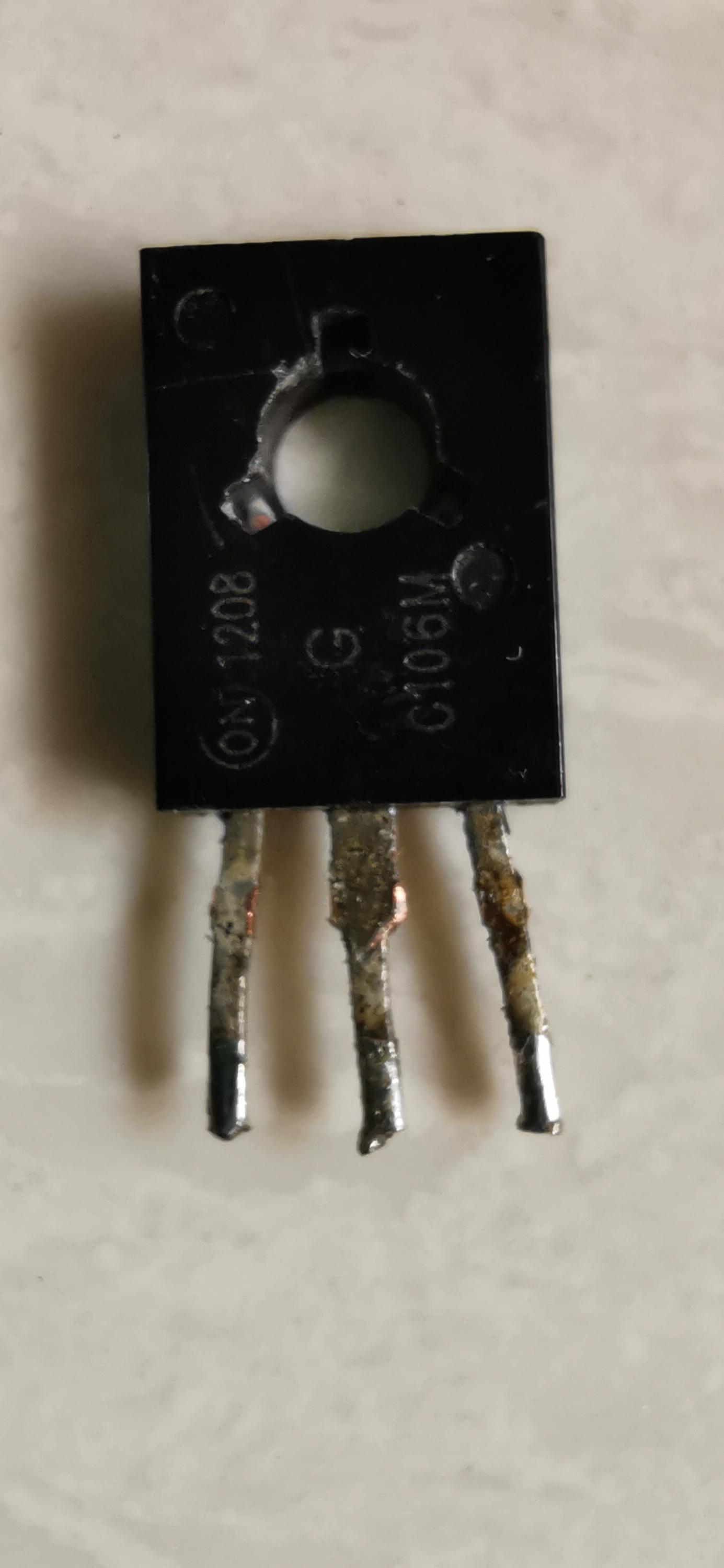

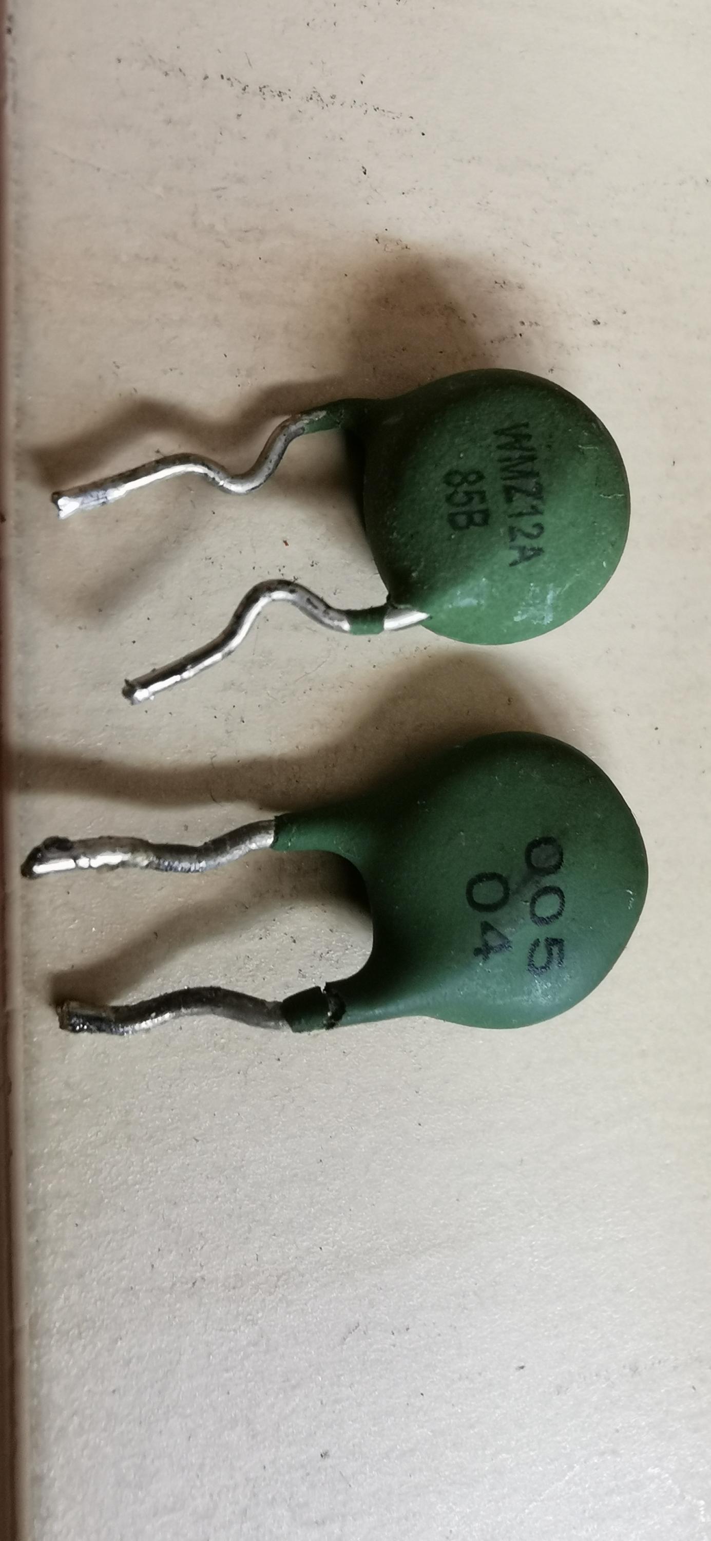

    I am powering up the solenoid directly for the test, so bc337 is not in scope.
    I am thinking the inrush device cut off the power supply when too much current is drawn.. But I will replace it to see what happen.
    So I replaced the PTC with a similar device extracted near incoming live input from another power board. Powered up and immediately a tiny spark is seen, and nothing else happened. Restored the original PTC, does not work already..
    On quick check - the C106M appeared faulty. Pulled this out of circuit - Gate is shorted to Anode and Gate is opened to Cathode. With DMM black probe on Cathode, red probe on Anode, then "shorting" the gate with red probe, nothing happened. So I believe this SCR is already fried..
    Could this SCR been faulty in the first place ??

      Re: EuropAce EWC 3108 Wine Chiller - Seems like no temperature sensor input
      I have a feeling that this might have been the case
        Happy New Year
        Latest update:
        I have replaced the C106M, and it does not have the same "click-on-click-off" sound every 5 seconds anymore. And the incandescent bulb connected in series does not light up on starting up with the load. But then again, it actually does nothing...
        Meaning, it reading 250Vdc across the 2 output pins without load, and read 0Vdc when connected the solenoid... When connected to the incandescent bulb or the DC motor, nothing happen...
        So, I ran out of idea what else to do with it, and decided to give it up... I salvaged some parts are spares, and discarded the chiller..
        Thank you Sam_sam_sam for working with me all along, have a great 20201!
          Where did you buy the “ C106M “ part can you please post a link to it
            The replacement should be C106MG, available from digikey C106MGOS-ND
