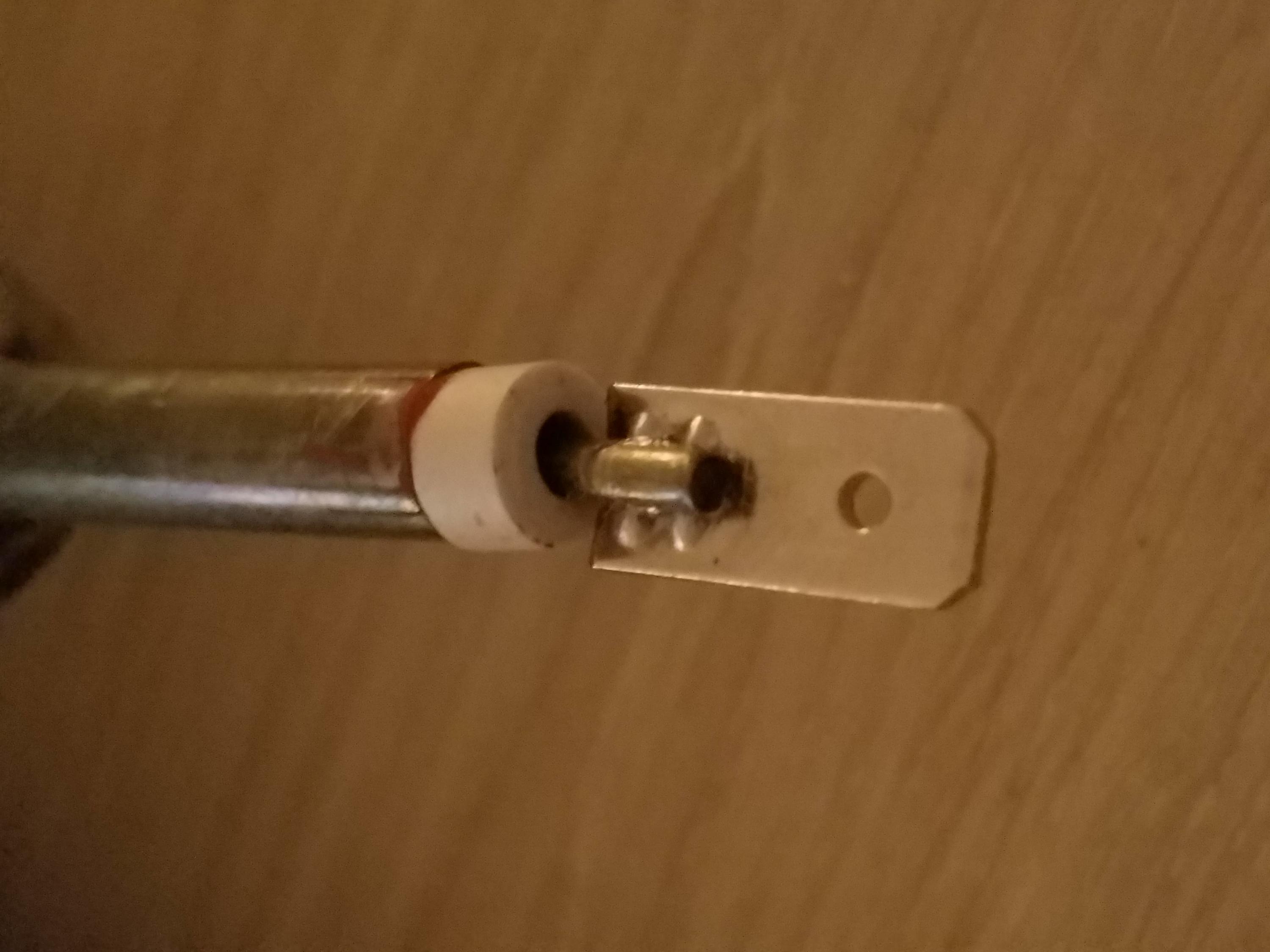

    Hi guys ,
    I "bought" this nice looking Bosch dryer for a 6 pack beer.
    It has the problem that it is not heating anymore. ( Fan is working ).
    I measured the thermostats inside and they are all ok. It has 1 thermo with the fuse that can pop out but its still fine.
    So i got down to the heating element and it has no continuity/endless ohm so i know its bad.
    I got a question , can i make this element work again temporarily? I got continuity on the outer part of the element but not on the pins itself. If i look closely on the pins i notice that there are 2 small pins inside the element. So i guess something on the inside is broken.
    What happens if i solder the pins to the outer part of the element?
    Anyone have experience with this type of dryer?

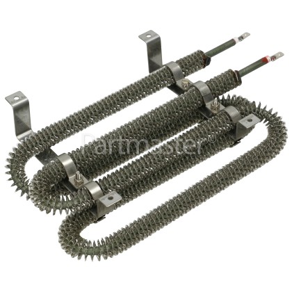

    Re: Bosch WTA100 Dryer repair
    This is the element up close.

      Solder might melt with the hi-temp. Probably get someone to MIG/TIG weld it back and that could probably work temporarily.

        Will the element get so hot that it melts the solder? I think the best thing is to get a new heating element.

          not even silver solder is going to last in this application.

            Ok , thanks for the help! I will get a new element and that will fix the problem. Only $40.
            Little maintenance on the rest of the parts and it will last a few more years!

              you can buy elements in straight lengths and bend to shape .just get correct rating .

                remove the brass core from a terminal-block and clamp it down on the element
                  Sorry STJ i don't understand what you are trying to say.
                  I got the new heating element and cleaned the inside of the dryer. Used a tiny bit of WD40 in the motor area ( for the fan ).
                  Its working perfectly right now!

                      Also make sure that the duct hose that goes to outside of the house is clean otherwise you have this problem again
                      WD40 should not be use to oil the motor you should use motor trubine oil which made for that
                      One note you can fix heating wire with high temperature terminal crimps (crimp the hole terminal end not just in one spot) just cut off the end that you do not need and solder each end of the terminal end
                      I have done this before with about 85% success rate
