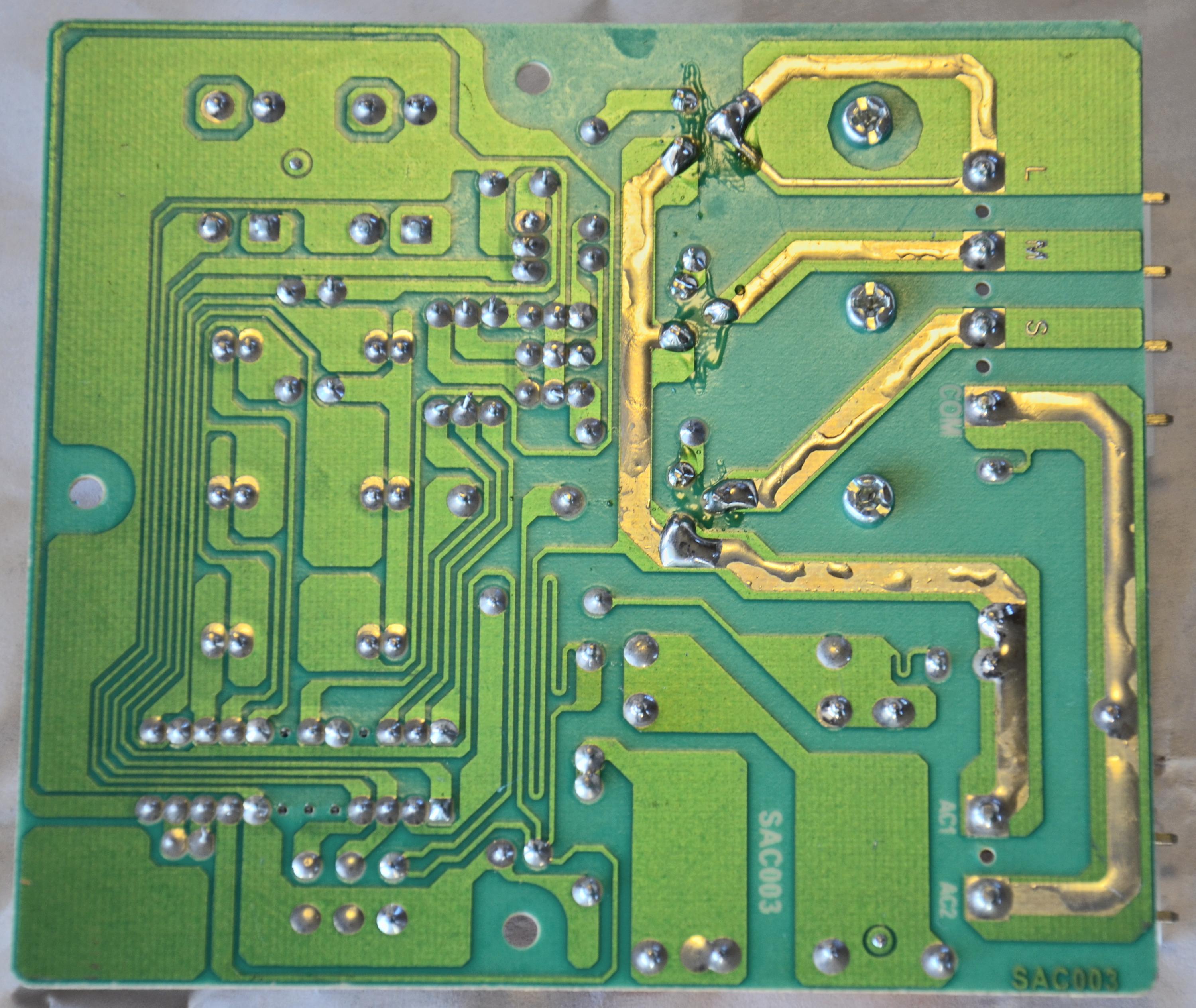

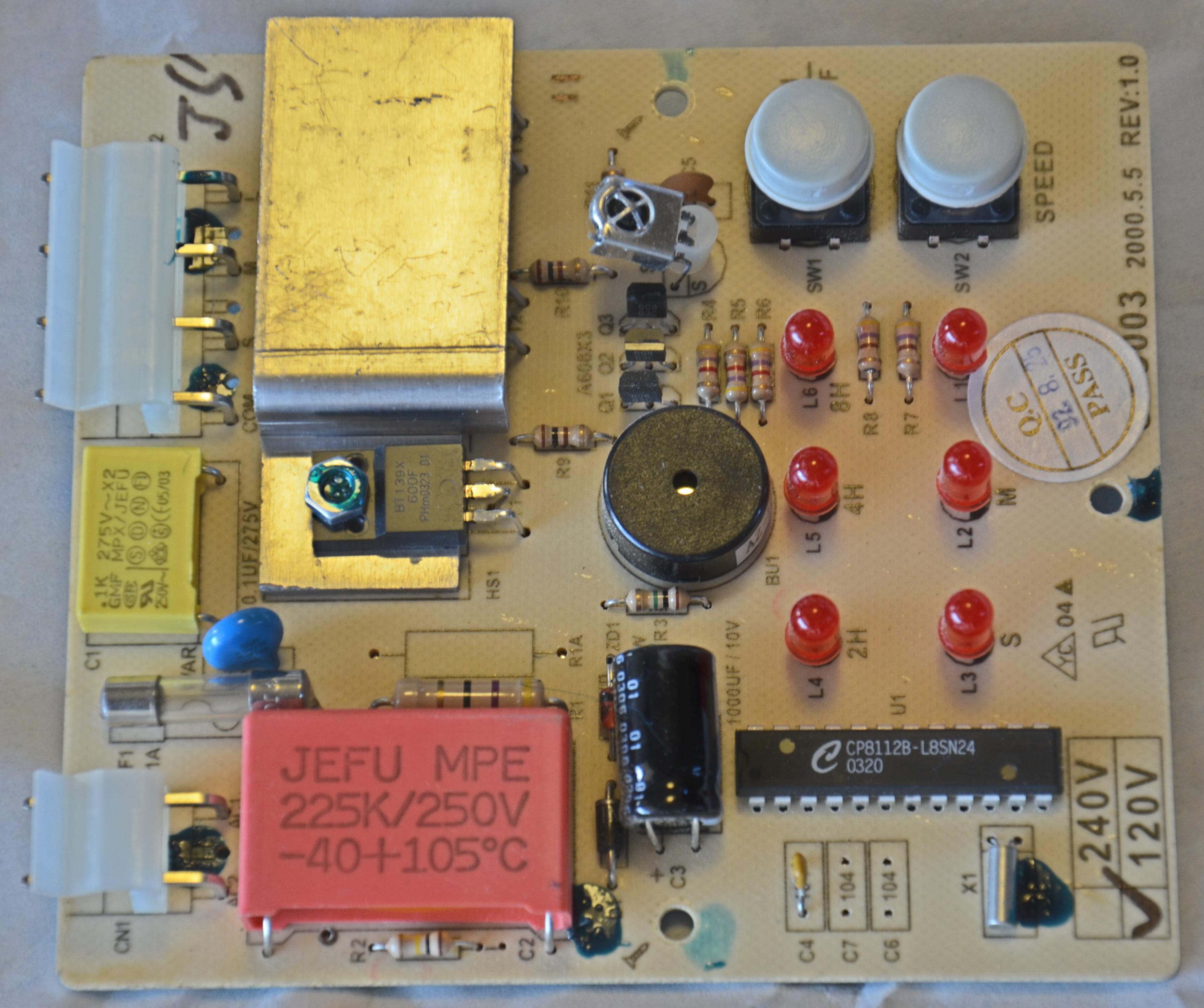

                    Still no pictures of the boards?
                    • elmo
                      • Dec 2014
                      • 21
                      Re: Jet AFS-1000B Air Cleaner
                      Sorry about the photos. I thought I had uploaded then earlier.
                        If C3 is bad/fake/questionable, the micro gets bad power and resets- unit appears to then be "off," since powerup state for micro is to default to fan off.
                        This is a capacitive divider power supply- C2, 2.2u (10%) if decreased in value will cause strange symptoms- things like micro dropping out upon driving triac gates (for instance).
                        I'm suspecting C3- replace with good 105 degree low esr unit, such as for an SMPS. Extreme ripple into that micro will wipe its programming, seen this with cheep "tower" fans and crock pots. Use PW, HE, FR, FC, or equivalent.

                          • 31246
                          the original soldering is a joke, most of it is only touching the pins and not binding to them.
                          it almost looks like they used the wrong type of flux on the production line.
                          specially the large connector.

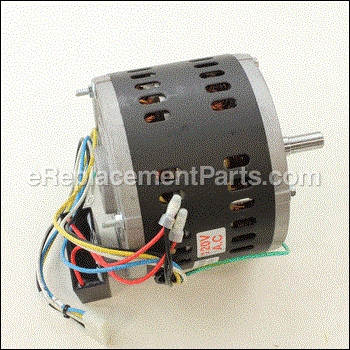

                              Do you have the pictures of the blower motor?
                                Is this the blower motor?
                                http://www.ereplacementparts.com/motor-p-446851.html
                                It has AC caps for the motor.
                                  That's a multispeed PSC motor- exactly the same as a common furnace blower motor. Four wires=three speed taps, plus neutral/common.
                                  If more than one tap is energized at the same time, you get smoke and a dead motor.

                                  • elmo
                                    • Dec 2014
                                    • 21
                                    Thank you all for your suggestions. I can't see the motor, but I presume that is the correct one since it is the replacement part for the AFS-1000B. I think the motor is all right since I ran it for over an hour with the board jumpered out. I just measured the -5V power supply voltage. It does indeed measure 5 volts with about 60 mV of ripple. Of course this is with no load on the board. This may not be surprising since the blower always ran when started. It just does not run for long when powered by the board. I, too, am suspicious of C3 since the top of it is bulged out somewhat. I guess the only thing to do is to replace it and see if that helps. It seems that most of you think Panasonic makes good capacitors but are not Nichicon, Rubycon, Kemet,ans Vishay good brands too?

                                      Other possibilities, taking into consideration all of your observations: the 32 KHz clock crystal used in this circuit is a type widely used in lots of gear. If possible, check the waveform on the osc pins, or if test equipment is unavailable replace it next time you place a parts order (they are very easy to find and inexpensive). Also check the resistor on pin 2 of the controller. This resistor sends zero crossing information to the controller, and it may have changed value. That would upset the firing on the triacs.
                                      As mentioned before, the soldering on your board is terrible. Heat and vibration will create miniature cracks that can hardly be seen. I would run small tinned bus wire along any of the AC traces starting with the board AC connector pins. The points where the connector pins solder to their traces are of special interest. Same goes for the legs of the triacs.
