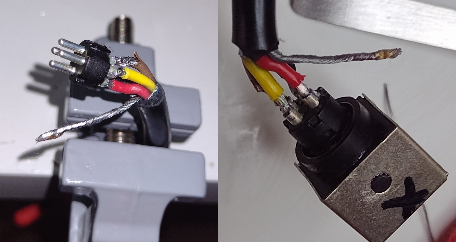

    That black tape rubber like thingy also gets my vote for being heat shrink. Maybe measure it out and see if it is connected to your yellow wire being ground. I wonder if the shield is connected to ground or just sits there floating.
    If I do connectors like that, I put flux inside of each pin in the connector. Strip the wires nicely back in a manner that the rest of the insulation is a bit too long, or the copper wire a bit too short. A little flux on the wire, stick the wire half ways into the pin hole then use 60/40 quality solder and solder the wire to the pin and shove wire all the way in so the insulation touches the pin.
    Most of the time the insulation on the wire shrinks backwards, thus making the copper wire longer. But with this trick it will look like factory.
    Key factors are: flux, quality solder, a good iron with a small tip, wires straight cut with a sharp pair of flush cutters, a sharp wire stripper and a small vice.
    It’s probably hard to do the first time, but believe me… don’t put solder into the pin hole first without the wire being inside. That makes it so much harder and you wish you would have bought the cable with the plug installed or a new PSU.

      Originally posted by m1ch43lzm
      Use flux, add a tiny bit of solder to each solder cup (the "tiny grooves"), tin the tip of each wire, flux again in the solder cups, heat each solder cup, insert wire, done, clean with alcohol
      You don't want to melt the plastic of the connector
      Pinout is mirrored left-right when looking at the solder side, the drawing you made is looking at the finished plug, measure voltages before fully assembling the plug
      Oh yeah, using flux is a no brainer and yes, I was going to tin the cups as well but thank you for the tips!
      I am sure it will go smoothly!
      Yes, my pinout drawing was looking directly at the pins that connect to the socket.
      This video should help, it's a different connector
      https://www.youtube.com/watch?v=K5Zah9qHEGs
      Or this one, another method
      https://www.youtube.com/watch?v=_GLeCt_u3U8
      Thank you for the videos. The ones I found were for the same connector but very lousy with no details and not showing the soldering part at all.
      I love Pace videos and I do remember watching that a while back but clearly I needed a refresher!
      How well those videos were made that even after 40+ years they are still some of the best on soldering!
      The "elecrrical tape rubber thingy" is called heatshrink tubing, that wire according to the label on the PSU it's connected to the metal shell of the connector
      Once you assemble the plug with the metal shell, cover that wire with heatshrink tubing, solder that wire there in a suitable spot, scratch a bit of the metal shell then tin that portion
      So, I will cover the part coming out of the insulated cord but just leave enough of it to solder it onto the metal shell (in the photo)?
      Would the connector still be able to assemble and close properly with it attach to the shell? I will have to play with its positioning to see if I can get it to work.
      Thank you again, sir!

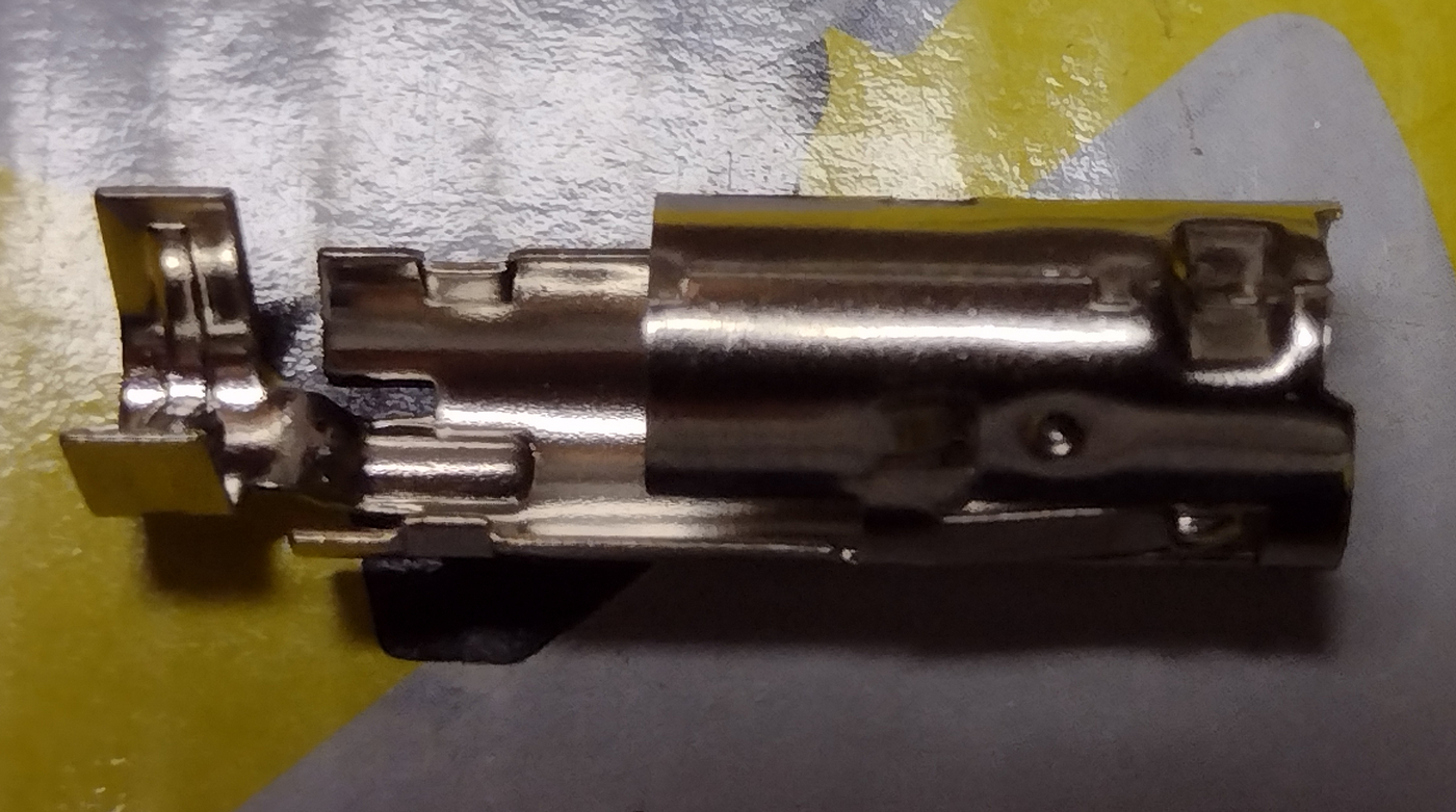

        When I cut the connector in half and split the wiring, I couldn't really understand how it was actually connected to anything but I think Michael is right, since the circular piece inside the round housing where the pins are, that is also ground.
        So, I am guessing I should be able to solder the bare ground wire to it.
        Thanks for the tips as well. Yes, I have been using a tiny vice which works really well in situations like this.
        Will update when done.

          That screw on the back… use it for the shield,

            when soldering din connectors - plug them in first.
            it holds the contacts so they dont move when they heat the plastic!
              There is actually screw on that metal shell? I didn't even see it!
              Yesterday was a busy day plus I was in the Arizona sun for too long yesterday so maybe that is why.
              I am feeling a bit more rested today so I will be tackling this a little later on.
              Thanks!
              Plug them in where? In the socket so the connecting pins are stabilized?
              Much like the pace video, I was going to use a tiny vice to hold it upside down, put a suitable size solder wire in each cup, then heat each one up as I push in the wire.
              Or were you referring to something else?

                yes, plug them into a socket.
                  The light bulb went on a tad late but I figured that is what you meant.
                  Thanks for the tip! I did use the old socket and the vice which made the painful job a bit easier.
                  Gotta admit, not one of my best works but this was quite annoyingly difficult due to how short and small the cups were in relation to the wires and also their proximity to one another.
                  That said, no shorts that I could detect and it is quite strong, I was able to pull it out/in a few times and no issues.
                  The brown wire which I attached the last, was a major pain and the wire shrunk a bit more than the others for some reason despite using good amount of flux and the same heat setting (660) on the HS-01 iron.
                  I am thinking about doing a little liquid tape touchup for the exposed brown wire to minimize cables touching each other. They shouldn't but trying to be safe.
                  Afterwards, I am going to mess with the bare wire next as I start assembling the rest.

                    The brown wire is buggered up. Don’t leave it like that. It just spells trouble.

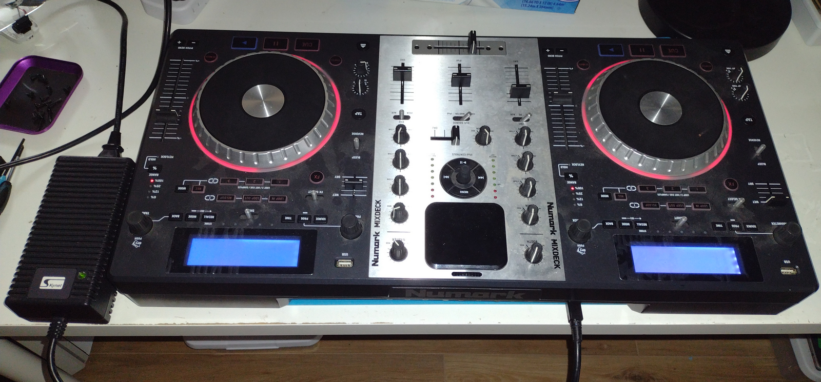

                        I got it powered on but the screens supposed to display "Numark" but they instead show a blank lit screen.
                        I double checked all the cables and they are all connected to where they were supposed to (most of them are actually quite obvious anyhow).
                        So, not sure what the heck is going on.
                        I found a firmware from their site but it is only applicable if the display is actually showing/active which this is not.
                        Would getting a schematic for this help?
                        I'd appreciate any help.
                        TIA

                          Well… could be anything at this point. Open, short, something not running, IC is blown and getting hot, etc. Maybe you find some TTL or something you can hook up to and see what’s happening.

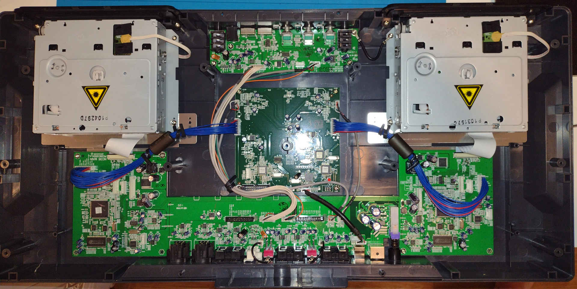

                          Open the mixer up and make pictures of the boards so we can at least see something.
                          • TurcoLoco
                            ocoLocruT
                            • Mar 2025
                            • 66
                            #53
                            Yeah, I know, it could be anything from a simple loose/no connection of a related cable to a burnt chip.

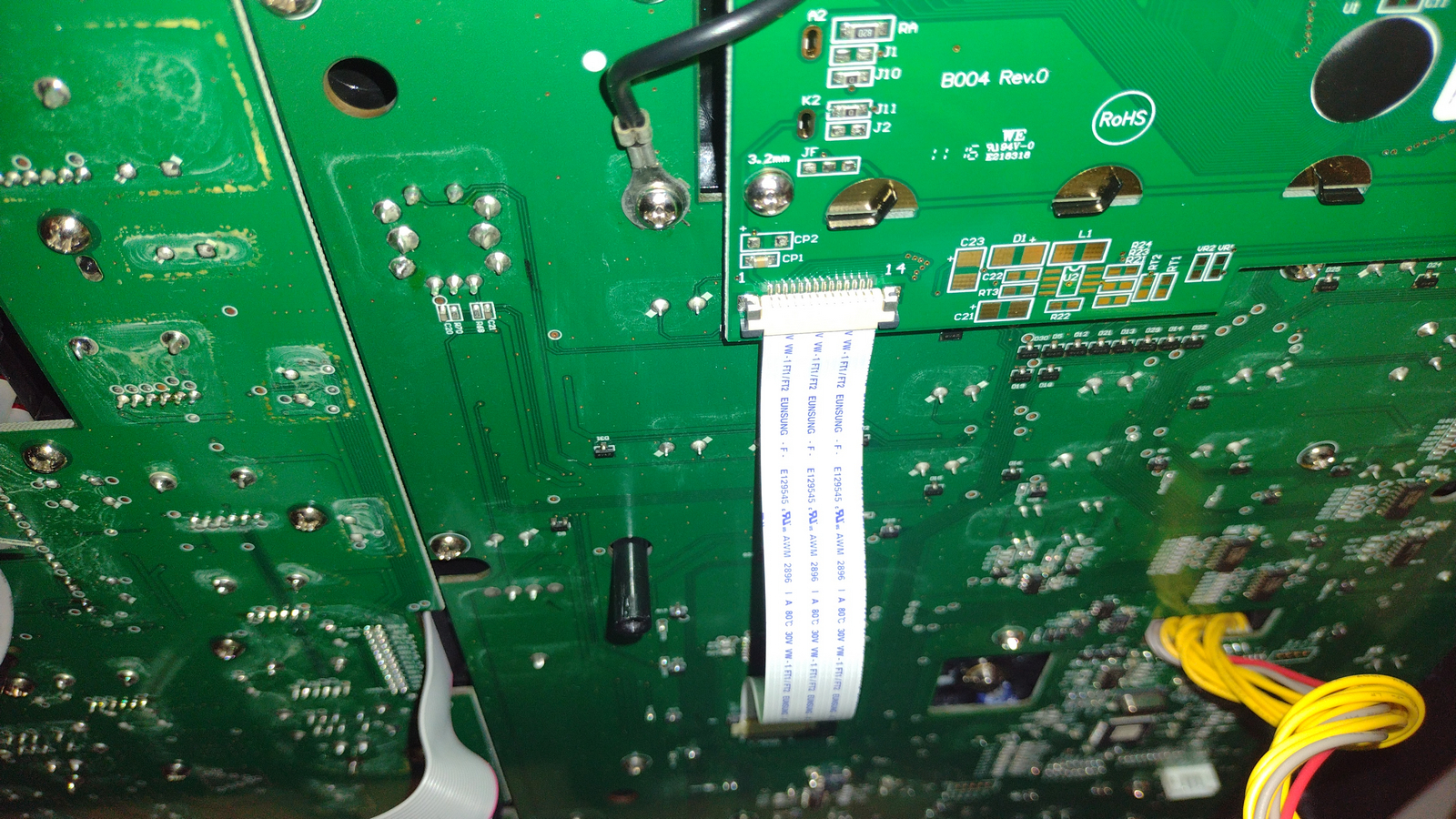

                            Visually, both the top and the bottom part (on the surface) appear very clean with no signs of any visible marks or anything.

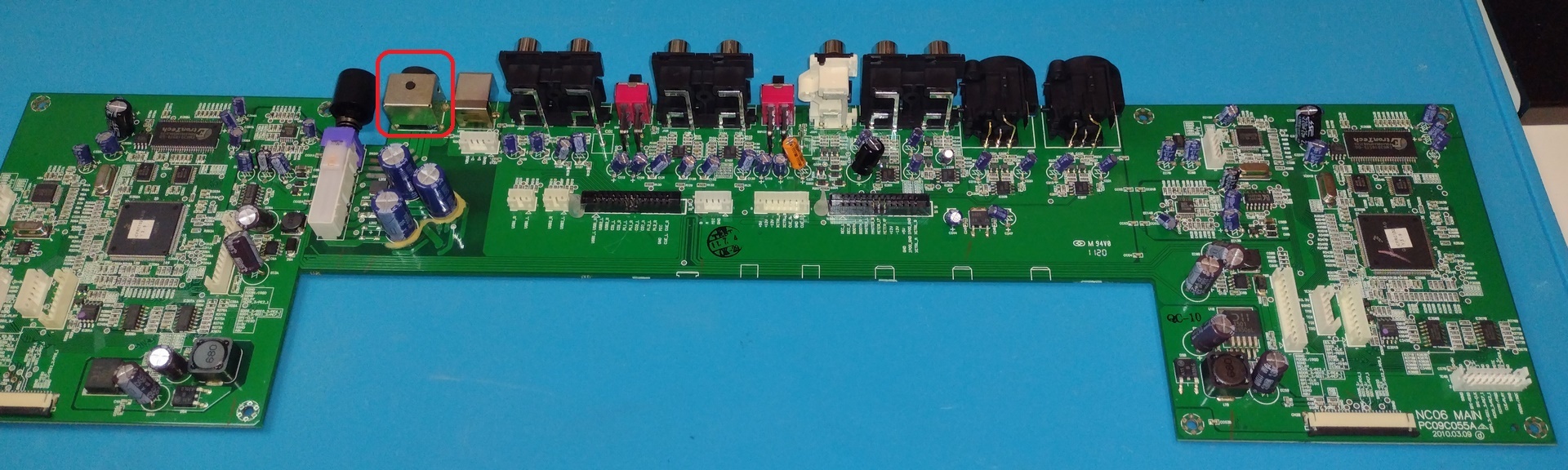

                            The part I worked on is the bigger piece located at the bottom part of the device. I did nothing with the other 2 smaller boards or the top part other than disconnecting/reconnecting the cables.
                            Because a few of the cables only allow a few inches of opening it /is/was not really possible to get a clear picture of it with everything connected or check the board while it is powered on.
                            I could only use a thermal with the main board completely removed but then the rest of the device would not be getting/taking any power either.
                            I sent an email to their support about the problem, asking what might be the issue and also to see if I could get a schematic. Not holding my breath that they will help though.
                            I will re-open and try to check the cables/connections to see if anything came loose while putting it altogether.

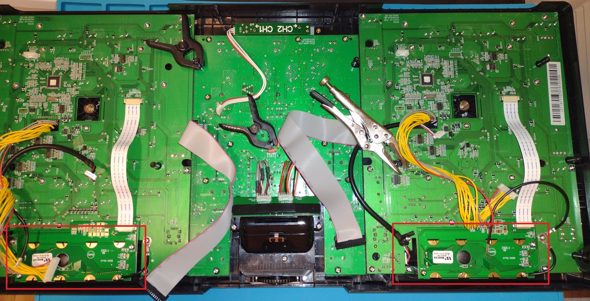

                            The red boxes are where the displays are so even though I didn't disconnect any of the wires that were not connecting to the bottom part, maybe something got loose somehow (hopefully)?
                            Other than that, I wouldn't know where to even begin....

                              I would run the thing under a thermal camera. Then I verify if all voltages are present on the output jacks. There is a legend printed on the board on what pin is doing what for each jack. But I think the board that has the problem is the u shaped board in picture #3.

                                You mean the U shaped board out of the case and by itself just connected to the power?
                                With both top and bottom pieces still connected, I can only get a 3" opening which would prevent me from using the thermal cam I have.
                                I am sorry, what were you referring to as output jacks please? I confirmed all the voltage are coming to the board (at the part where socket sits on the U shaped board).

                                  Yeah. The unit needs be powered up and all boards connected and turned on for the thermal camera trick to work.
                                  on the u shaped board there are cables that connect this board to other boards. Close to it is a legend where it tells you what pin does what. Unfortunately I can’t read it as it is too blurry. But I think most of the important stuff is done by this u shaped board. So somewhere needs to be a chip where the firmware is stored. You could dump the firmware test the chip, look for dataflow, look for a TTL and hook up terminal, see if there is a crystal, etc. The PSU was the easy part. Figuring this new feature out gonna be much harder as you need more test gear, like oscilloscope for example.

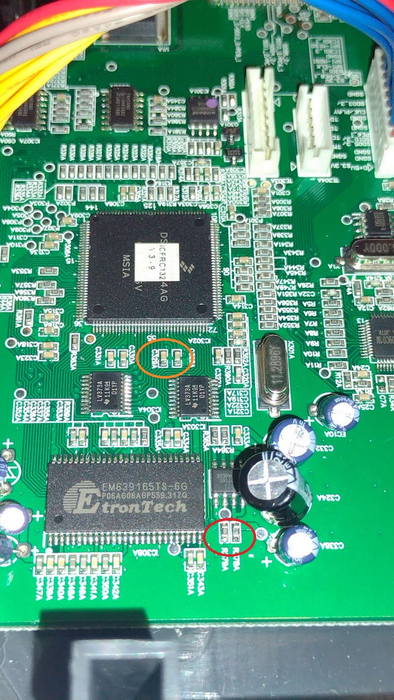

                                    Well, it was very tight but I powered on the unit and my thermal cam and there were only half a dozen spots that even registered, most around 95-100 degrees (F).
                                    With those of them marked in the attached photo; red area with resistors hitting 120 and orange area with caps hitting 106. Is either one considered too hot to be a concern or a short?
                                    Wouldn't a short (other than a related chip/MOSFET) completely kill this device or at least would have more issues than just the displays powering on but not showing anything?
                                    White ribbon cable is what the tech support mention that might be lose or damaged but it is not. It is also on the top part of the device which I didn't even touch.
                                    There was no other cable that is connecting from the bottom portion to the top portion where the displays are.
                                    To my surprise their tech support sent me a service manual with schematics and diagrams in it (but of course I am nowhere near experienced or knowledgeable enough to make much sense of it). =\
                                    I will attach the entire service manual which should be better than any resolution photos I could take.
                                    I am hoping it will help you guide me with the troubleshooting. It may also help someone else with the same device in the future.

                                          Anyway… there are tons of things to check. It’s got a PIC, STM32, an Atmega, SPI, IC2 data, clocking for chips… only with a DMM in hand? Not happening.
                                          All you can do is to check all little buck converters, check the connectors and cables on the individual boards, because some IC’s talk to each other directly on the IC2 bus. Problem is you cannot see any data or anything like that flowing only with a DMM on hand.
                                          Hmmm, so not much can be done, not possible to check the related components for shorts or open or fault?
                                          I believe PIC is the main chip, correct? No idea what STM32, Atmega, SPI or IC2 data, etc. are though.
                                          I do have an OK quality oscilloscope but never really used it.
                                          Could I do any troubleshooting using that?
                                          I also don't see a good way of working on the issue without disassembling the displays to see the connections or have access to the components on the other side.
                                          As I mentioned, there is only a very little opening without disconnecting the most of the wires/cords connecting the top of the board to the bottom part.
                                          I figured it was a bit too complex for me but I was hoping the manual would make enough sense to you guys to give me a few things to check at least.
                                          I am really bummed but anyway thank you, sir!
                                          PS. What is block diagram exactly and what info were you looking for?
