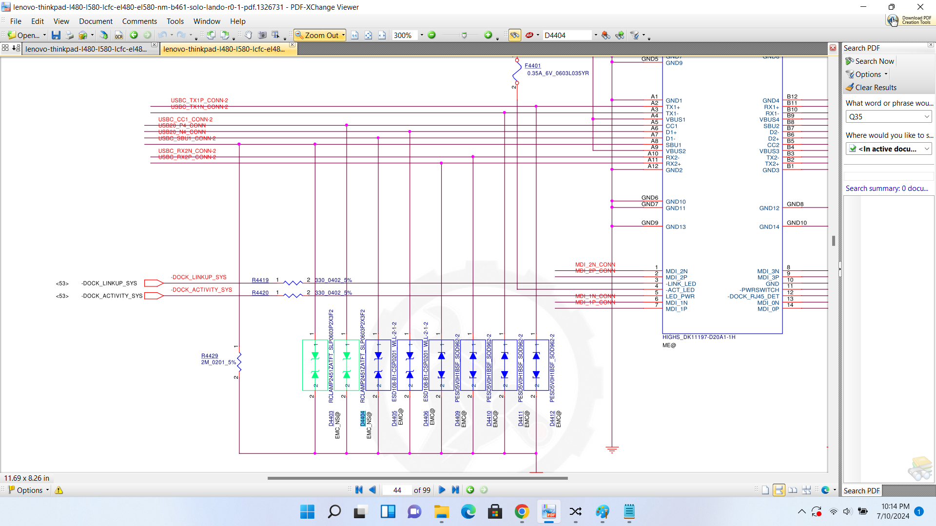

              This line looks to be shorted and very likely linked to the ESD transient device on that line. First confirm if the measurement is the same and then can hunt for the offending part.

                    Sir, in this line D4404 has no components, thank you Click image for larger version

                        Damage to the CCx pins is primarily from cross shorts of this low voltage line against Vbus (20v, etc.).
                        Are there ESD diodes on these shorted lines? If yes, remove them and test again. When inserting or removing these wimpy type C connectors, do so with the adapter power OFF. Once the connectors are mated securely, only then power the external power adapter.
                        If the PD controller + CCx communication is solid and working, then you should see 20V PD contract being negotiated.
                        Be sure to also inspect the USB Type C connector itself on the logic board. Perhaps some debris is on the contacts?
