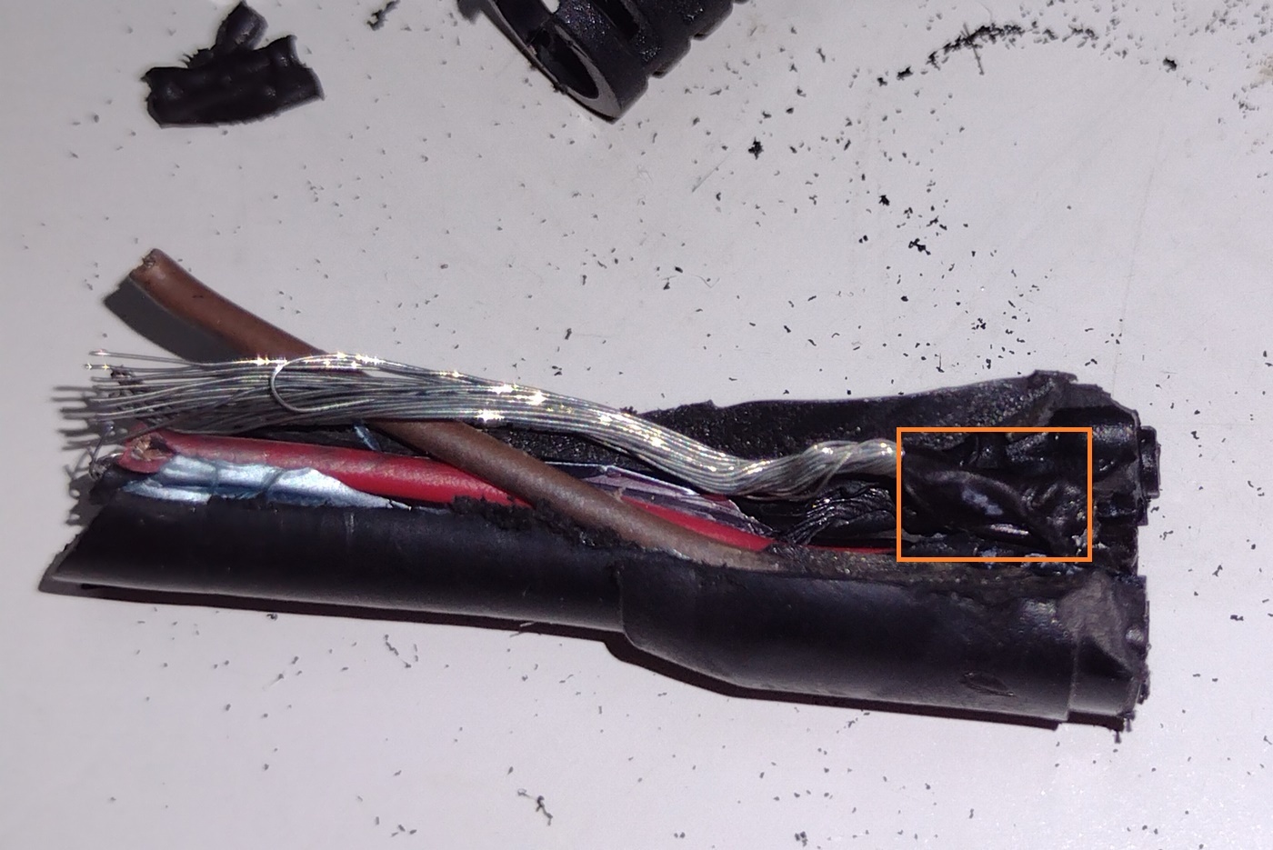

      I also checked it from the top of the PCB just to make sure it is not a cold solder issue and nope, same exact result.
      I believe the brown connection in the back is the second Ground that was in the image at the bottom of the PS so, all checks out.
      Because the owner had to twist the power connector in order to get it to work, leads me to believe the connector might have been the problem and not the socket which I will check on the side.
      Not sure if my leaked solder fried the connector or if it had already gone bad at that point?
      I am thinking about cutting the connector and checking each wire for continuity. That is probably the only way to ascertain whether the cable is good or not.
      Anything else I should do?
      TIA
      • TurcoLoco
        ocoLocruT
        • Mar 2025
        • 66
        Yup, with the connector cut, all wires have continuity so the culprit was the connector.
        I went ahead and ordered the connector Michael linked as well as another socket (just in case the one I got was fried too).
        Fingers crossed this will get it working but I will post an update either way.
        Thank you both!

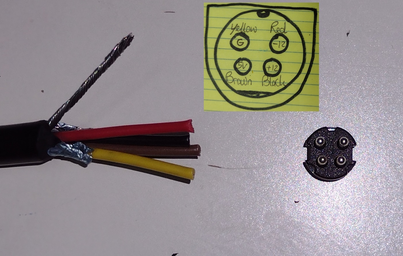

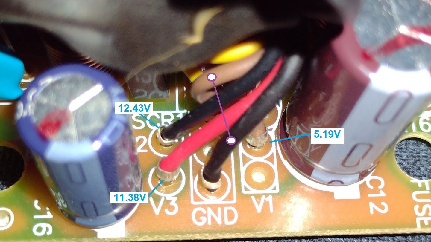

          What's the yellow wire for'? I see 5 wires but the connector only has 4 pins + the metal shell which is connected to the shielding on the cable, and GND
          Double check measurements, GND is marked on the board, then you have V1 V2 V3
          On closer look, the yellow wire is also connected to GND?
          Wiring colors seems to be non standard, as I wouldn't use a yellow wire as GND..., that leads to confusion, or a black wire as a positive voltage
          Assuming
          red is negative -12V (V3) (double check if the - sign appears on multimeter, with black probe on GND)
          black is positive +12V (V2)
          brown +5V (V1)
          yellow GND
          and the other "black" wire (heatshrink?) is the shield/connector shell, also GND

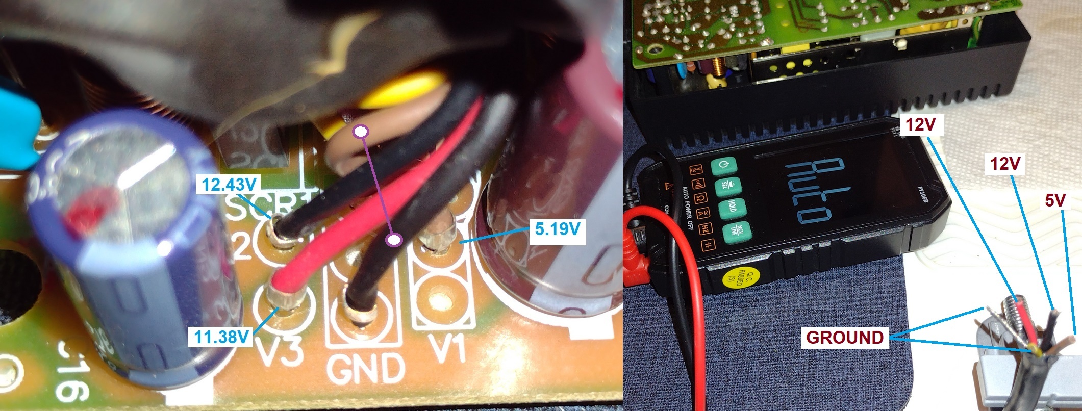

            This switching PS of this type is totally news to me but it does check out with the PCB info:
            There was also a bare strand of wire that and yellow wire (way in the back) are both Ground.
            Black & Red = 12V
            Brown = 5V
            (In the original photo by mistake I marked the brown wire which was actually the 5V).

              Again, double check which one is positive 12v, and negative 12v, no way you have two positive 12v wires...
              Maybe the - sign on your multimeter is very small, keep the black probe on yellow wire, the red probe on black wire, then on red wire, one of those should show a - sign to the left of "1" digit
              You don't want to mistake those when wiring the new plug, or you'll release the magic smoke on the device...

                  Hey man, sorry, yes I did notice you mentioned it in an earlier post but I got sidetracked and forgot to check it so thank you for reminding me.
                  I guess I missed it as the negative sign on my cheapo auto-ranging mm placed it right above the DC indicator for whatever reason. When I doublechecked with my Klein Tools, it was way more noticeable.
                  So, yes, the red wire with 11.38V is negative. <-- Not quite 12V as both MMs showed about this value. Is this OK?
                  On that note, what is the purpose of this negative power line?

                                    notice that the pinout on the label is when looking at the pins side, after soldering the new plug, measure the voltages according to the pinout on the label, you don't want this to happen on the device due to an improperly wired plug
                                    So, in dumb-dumb terms, pinout is same as when I am actually looking at the pins?

                                          Pinout is mirrored left-right when looking at the solder side, the drawing you made is looking at the finished plug, measure voltages before fully assembling the plug
