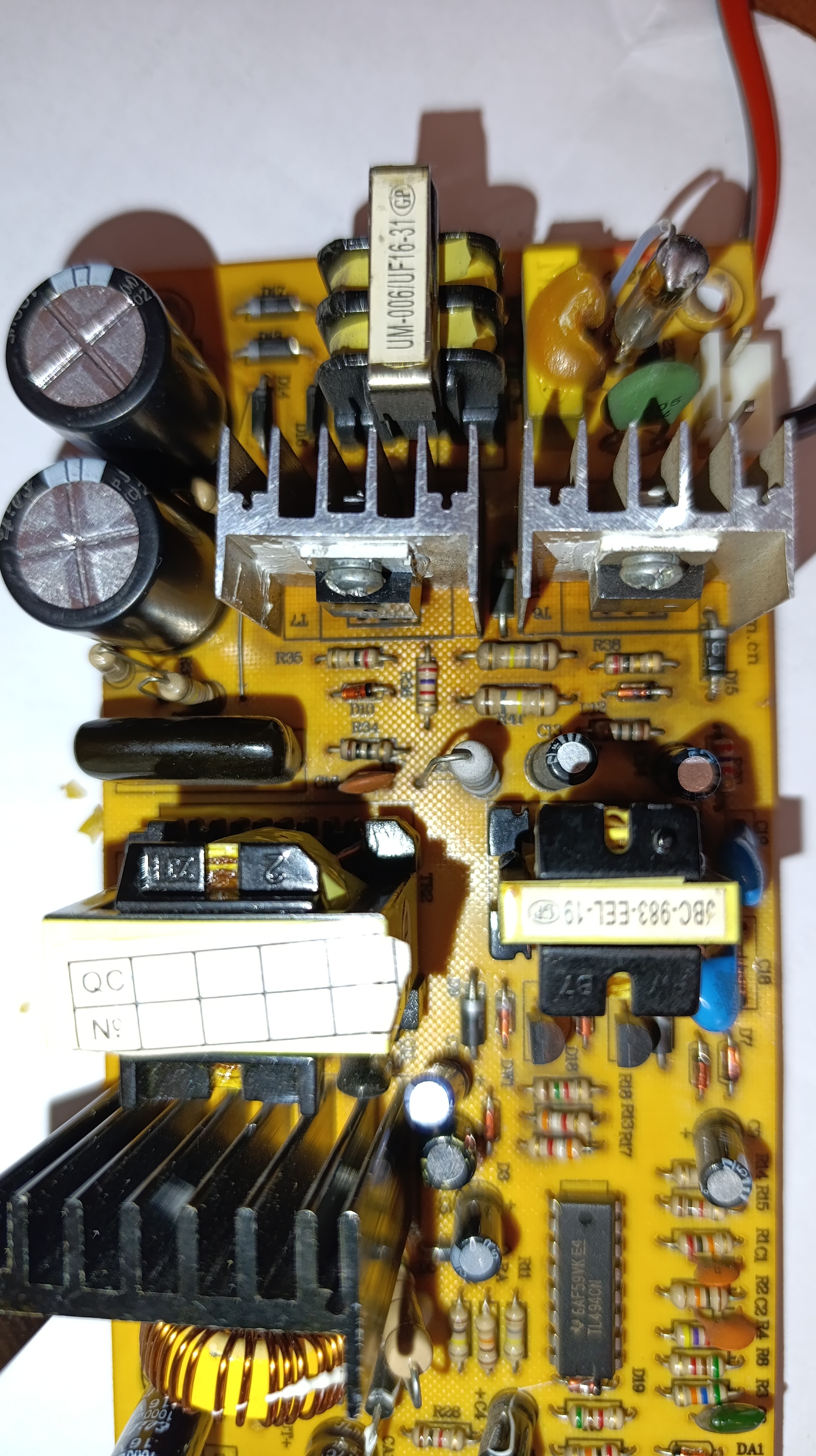

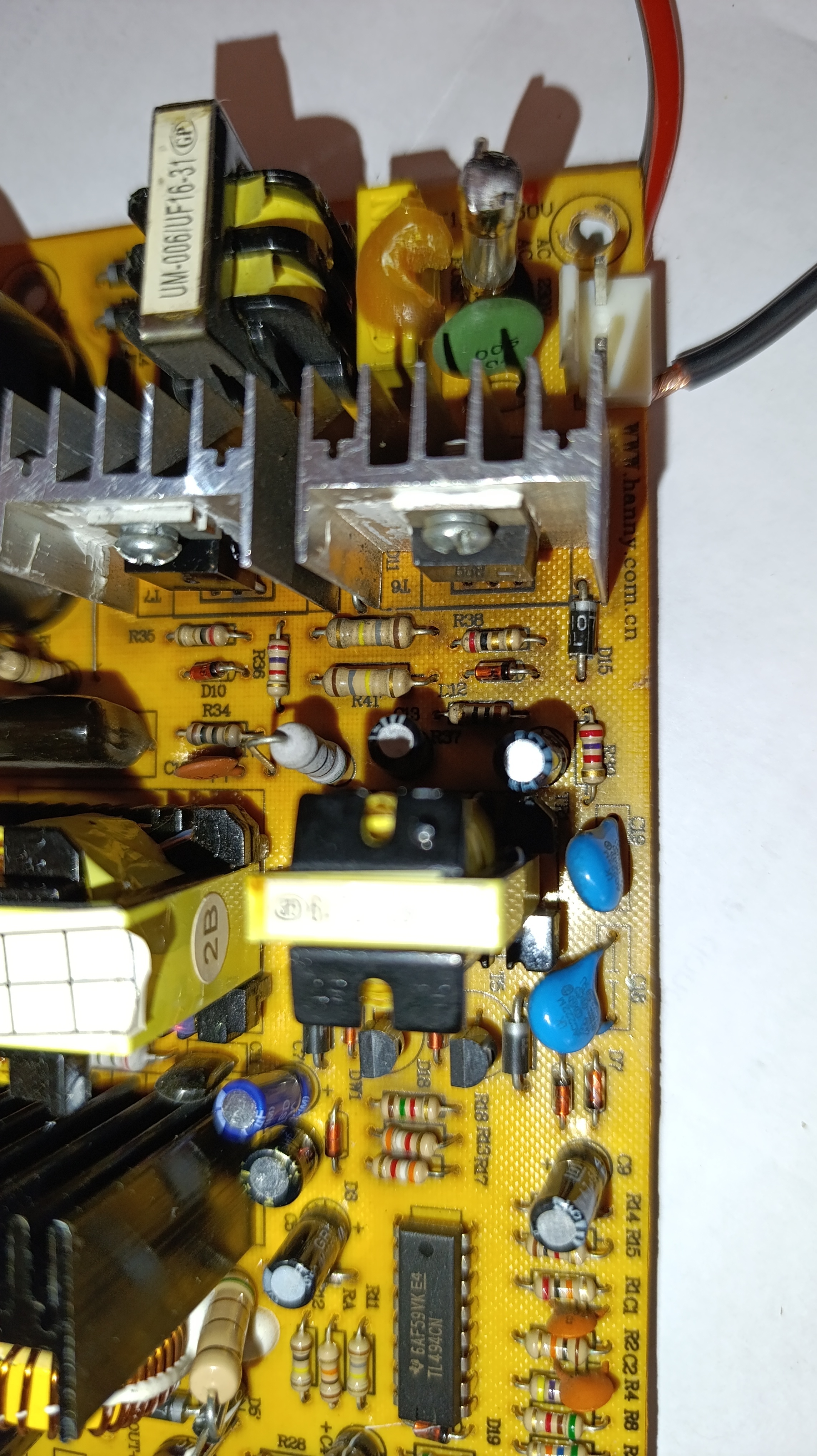

                          Ok Im completly lost at this time... Here's how it went:
                          I found a proper 60W incandescent bulb and a socket
                          I bought all the suspicious capacitors, including the HV pair to make sure they are the same capacitance
                          I went to where I have this board and put all the news caps in, replaced the mosfet, added the bulb in series and powered up
                          Nothing happened not even noise.. Mains current wasn't going too far. The fuse was blown too!
                          Ok replaced with a similar vale and tried again. 0,3v at 12V outputs...Traced from start to end. 160V DC on each HV capacitor, this is good.
                          Close to10v AC at all wires of primary of the larger transformer, nothing at the secontary...
                          While doing all these tests I realize it smells like "hot board", turn it off and as I touched the left trnasofmer heatsink it was burning hot. The right one was not
                          This transformer is the one fed by the mosfet that burned
                          Checking again resistance, I see leads at the RIGHT mosfet (not hot) show a very low ohm...but as there are 0.X resistors around and also they feed a primary coil, I expect a low ohm to be normal.
                          But maybe it's not, as I found another old peltier fridge that used a board which not being exact to this, shows a very equivalent schematic, with 2 mosfet driving 2 transfomers, dual schottly diode, etc.. and there is no shortcut at any mosfet leads...
                          I tested ALL diodes on the board, they are all good.
                          Also reviewing all the process:
                          1) Board has a "blinky" power up for a miunte, then would stay on but would only drive 3v to peltier instead of 12v
                          2) I replaced some caps and at some point one mosfet blew
                          3) I replaced mosfet and most of the caps and now the mosfet I replaced gets really hot.
                          Any idea?
                          Thanks!

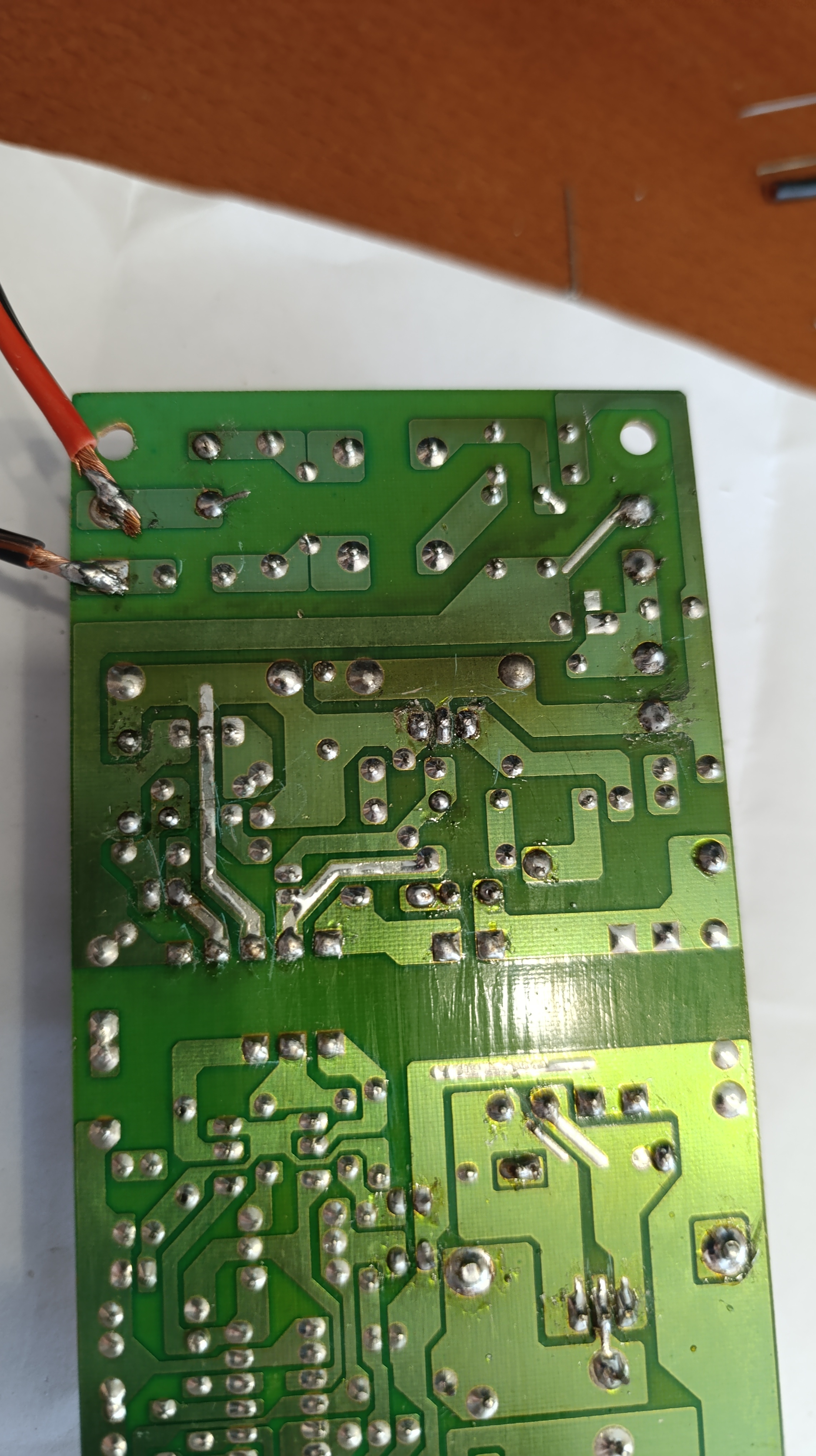

                              #34
                              is this broken ? Click image for larger version
Name:	Screenshot from 2025-03-31 21-19-46.png
                              • edugimeno
                                • May 2017
                                • 581
                                • Spain
                                #35
                                You mean the diode, that looks like it has a thin line across? I think it's just a camera reflection, but I tested it with my MM and it checks good in diode mode 0,5v- infinite on both ways
                                Its got to be something closer to the chopper,,, I believe

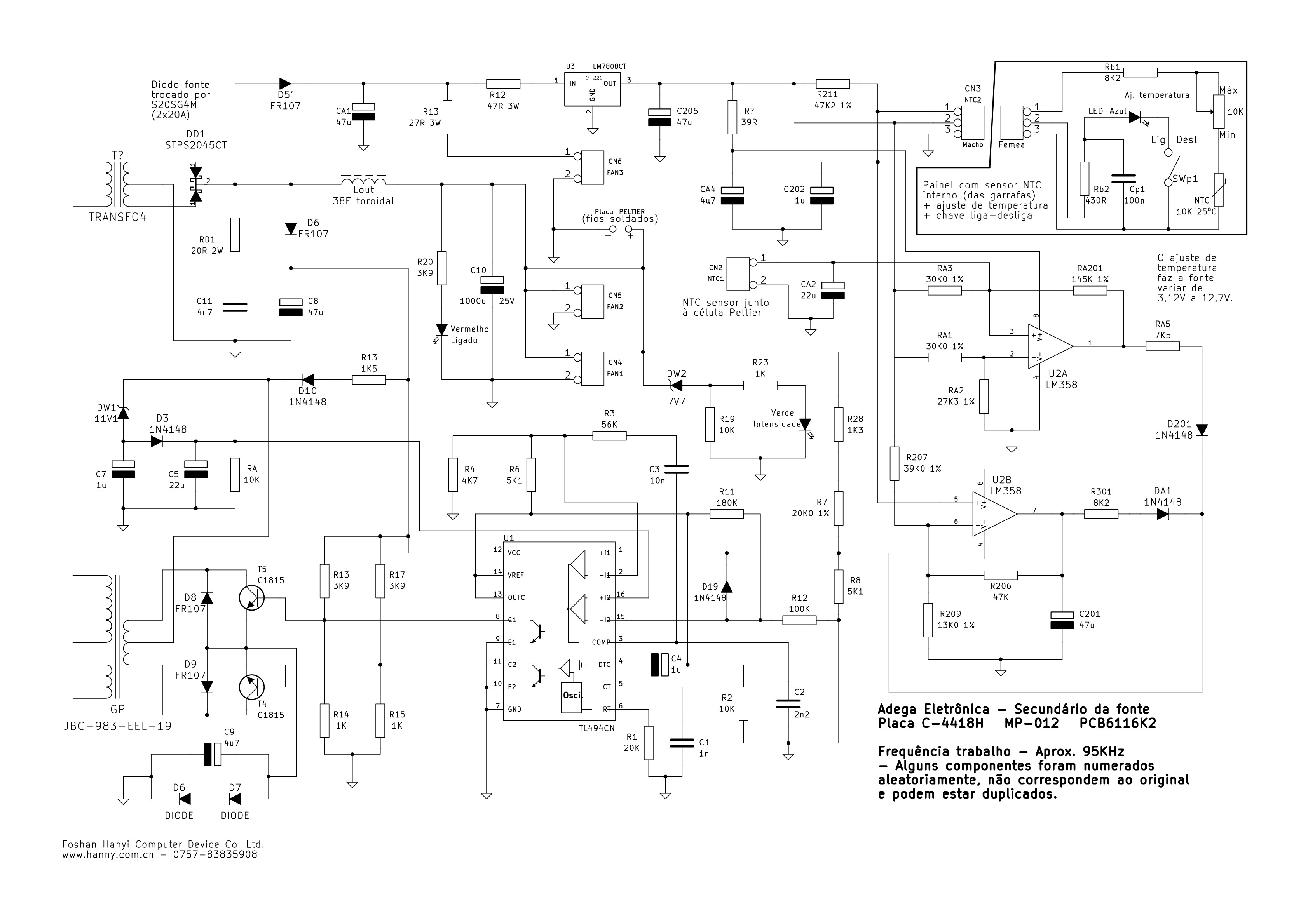

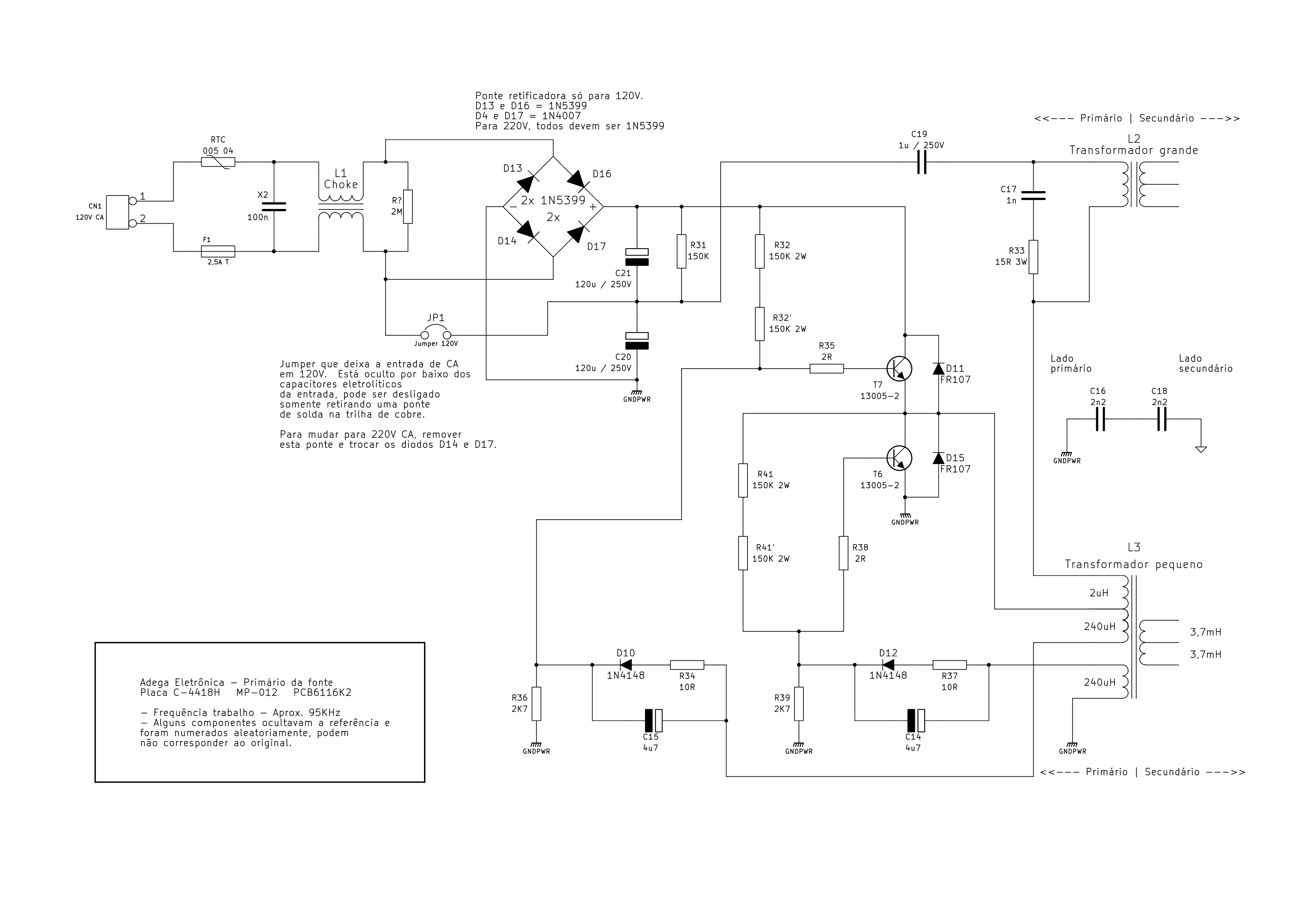

                                  Hi again!
                                  Im still investing some time, not much as Im busy lately... on this project
                                  My first issue, is that I dont' reallly understand how this whole circuit works,.
                                  I've found the schematic, attached as 2 images.
                                  So there are 2 main transformers, small and large. Small has 1 dual winding and another single winding on the primary side. Center tap on dual primary winding seems to be controlled by twin mosfets, 1 drives to Vcc, 1 drives to GND. But then the top winding comes in series with the other transformer, and this is what I don't understand why they get interconnected.
                                  Then on the secondary side (different pictures), the large transformer seems to drive a dual diode to generate 12V DC which is fed directly to the fans, and peltier cell, and also a 8v regulator drives the OPamps and the front panel. Also the OpAmps., which seem to compare the set temperature and the measured temperature , seem to drive a signal to the TL494 IC that drives a dual transistor push-pull block to the small transformer. So is this transformer working in reserve, so the signal driven by these 2 transistors (T4/T5) alter the voltage in the right side (I guess, primary) so this changes the voltage in the left (I guess secondary) side, and this modifies the power applied to the primary of the large transformer to modify the output voltage (0-12v) sent to the fans and peltier?
                                  If so what would be the best procedure to diagnose what's wrong now?
                                  Hopefully someone understands the schematic and can shed some light on it...
                                  Thank you!​
                                    • 31249
                                    #37
                                    strange and cheap design
                                    T6 and 7 can pull the transformer center tap to + or - and should alternate to drive the primary,
                                    they are driven from the lower winding that also provides the feedback so it self oscillates.
                                    problem with such designs is getting them to start up first.
                                    those 4.7uf caps are probably critical to this,
                                    also check the 2ohm gate resistors r35 and r38 arent damaged by the previous mosfets.
                                    the second page makes no sense so i'll assume the schematic is wrong or mismatched - it is driving the output of the transformer as though it was an input.
                                    i think they drew it wrong.
