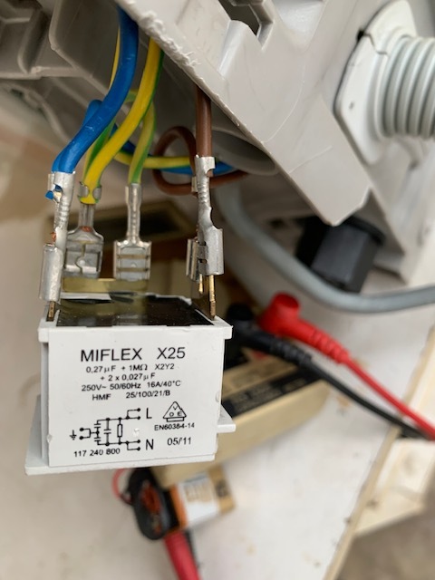

    Dear all
    i have Elecrolux dishwasher with no power light on display. i found on control board R67 and ic burn which i replaced.
    i do not get 230v ac on control board. i removed power in connector and i varified that.
    i started with the main plug and the wire goes to this miflex component. on miflex i do get 230vac. how do i test the output!

    the capacitance reading between L&N is 0.05μf

      Post pictures of both sides of the board,and the miflex component with the part numbers

        This is the component. I will take a picture of board tomorrow.
        thanks
          • 31316
          it's a noise filter - you dont need it to test the machine

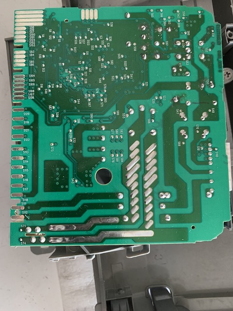

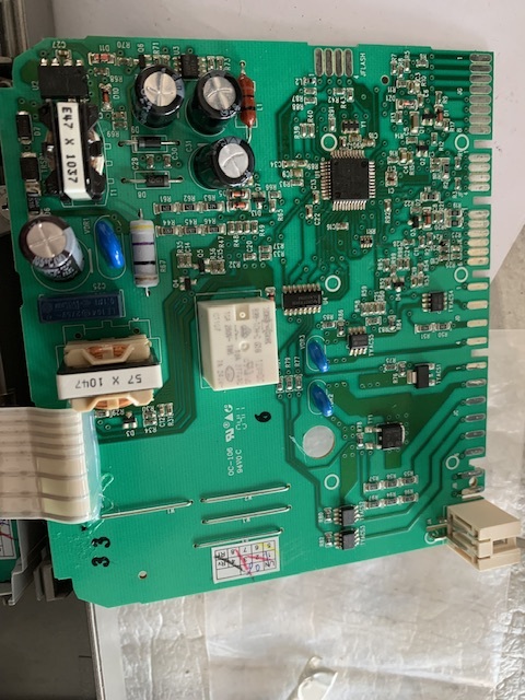

            Picture of control board

              i have noticed that are no fuses on board. can i apply 230v ac directly on board!
              on this board r67 and u2 7 pin ic was burned and replaced.
              what voltage should i get on main capacitor
              thanks

                Further troubleshooting. Since I got 230v on filter capacitor, then I checked Ntc brown component I do have 230v but on L and N on control board only 13v, no display.
                  • 31316
                  whats the numbers on chip U2 ?

                    Was LNK362gn

                      By unplugging connections and connecting back now on unplug connector of control board I get 230v.
                      if I plug connector no display
                        • 31316
                        data sheet
                        https://www.power.com/products/links...gn?langcode=en

                          i already changed the ic but still no display. by checking the components on control board i didn't find anything else wrong.
                            • 31316
                            the datasheet has example schematics
