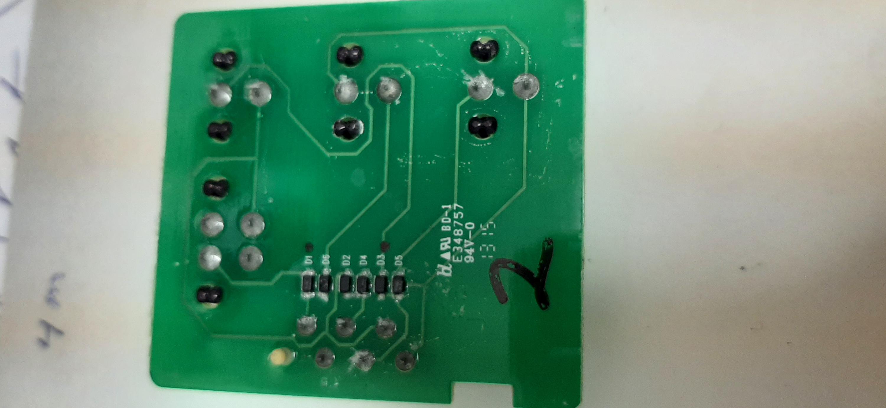

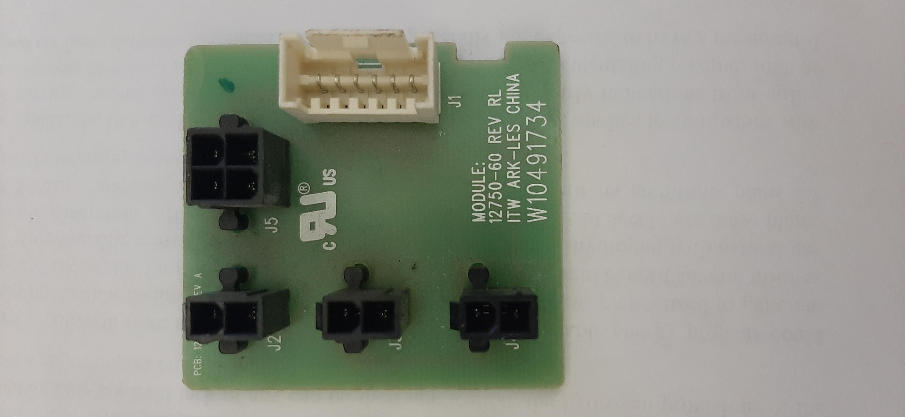

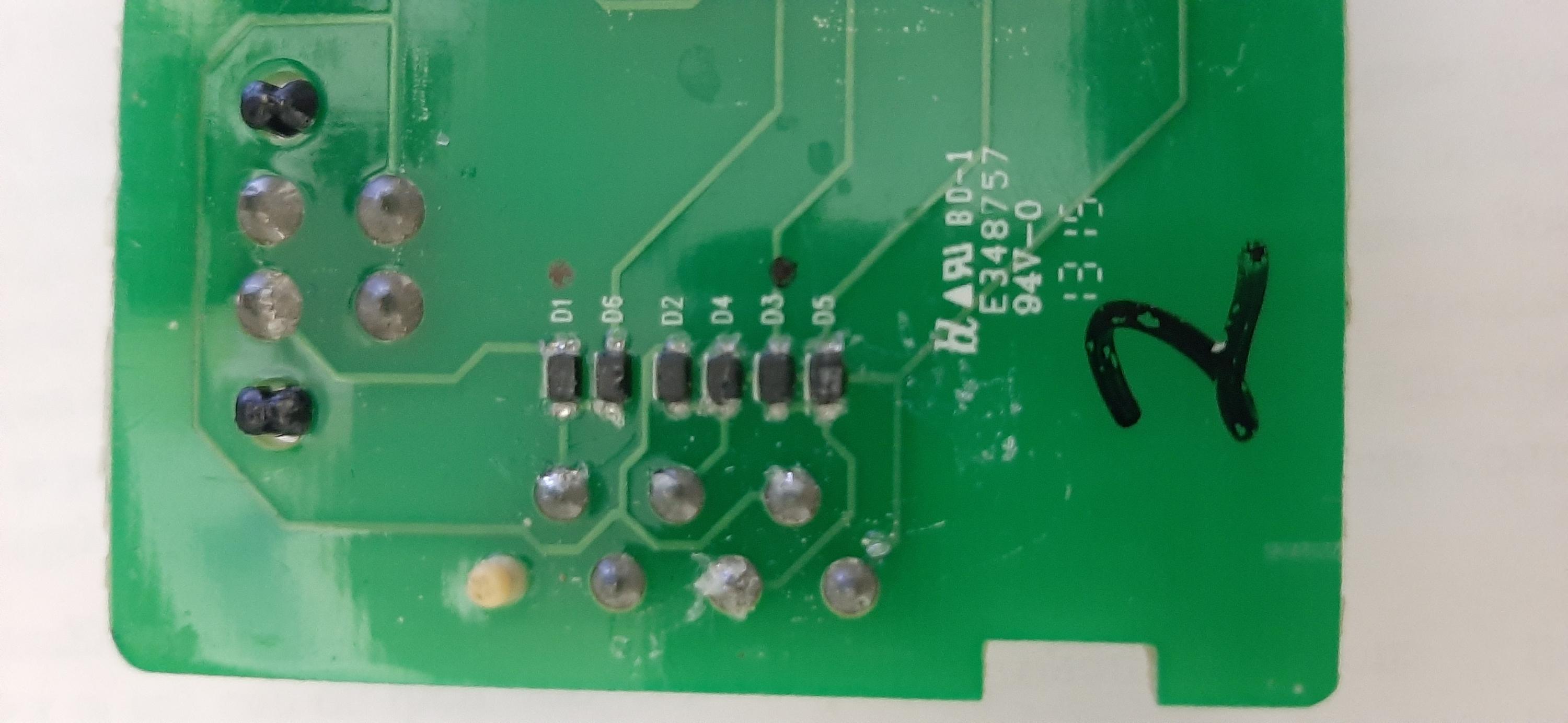

    Have a whirlpool CAE2743BQ0 washer that has this part that has failed. This is called the coin slide interface board. It connects to the main board and coin slide mechanism. I am trying to identify the 6 diodes on this board. A good board the diodes measure 4M ohms. under a microscope the diodes have A2 11 on top. Does anyone know what I can sub for these ? can I just use a 1n4148 ? thanks, John

    It seems You're measuring the six diodes . Measure only one ..

      Re: whirlpool w10491734 diode identification
      measured each one - each one (all 6 of them) measures 4 Mohm in one direction and open in the other
        1N4148 is suitable then ..Just wanted to affirm ..
          thought so - wanted confirmation before working on this garbage board. hard to believe these go bad. thanks

              Aside from measuring the diodes with resistance test, did you also check them under diode test? I.e. they should show around 600 mV of voltage drop in one direction and open in the other. Still not a 100% confidence test, as they could also be leaky... but at least you will know if they are open or not. 4 MOhms is a really high resistance and not necessarily indicative of anything, even if that's on the working board or not.
              If you have once of those transistor tester devices, those are actually fairly decent for identifying bad diodes, because they also show the junction capacitance and reverse current. High reverse current or zero capacitance junction may be indicative of a leaky/dying diode, even if forward voltage is still correct at ~600 mV.

                    It would be rare for these diodes to fail, they must be gutter grade. Hard to test without poking through the conformal coating.
                    I think they are MMBD4148 or 1N4148W in SOD-123 package. They would be for keypad mux so these coin slot switches are likely involved with other pushbuttons. The MCU uses row/column scanning to read them all, and the diodes prevent "ghosting".
                    Don't put the new ones in backwards, take a pic with the stripe showing.
                      stripe is on bottom or to the left of D1-D6. You are correct - they are scanned to the main board to read the users configuration (there are 3 wire jumpers on this board). It also reads the coin slide (vertical 8) switch when the coins are inserted and the slide is pushed in. Main board on this machines are a constant failure - they must also burn the diodes up when the main board fails. Unfortunately this is a whirlpool washer and they are complete junk. These washers are not worth fixing- so many things fail on it. old mechanical washers and dryers are the way to go on (commercial) coin operated appliances.
