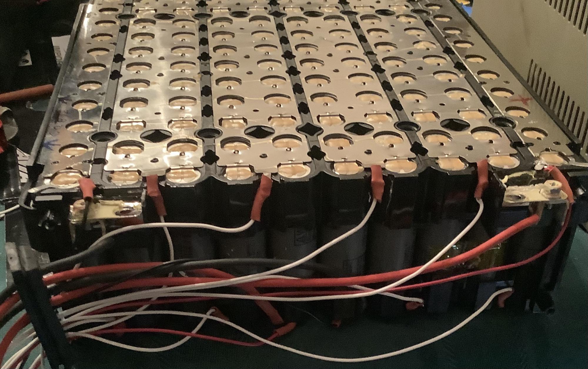

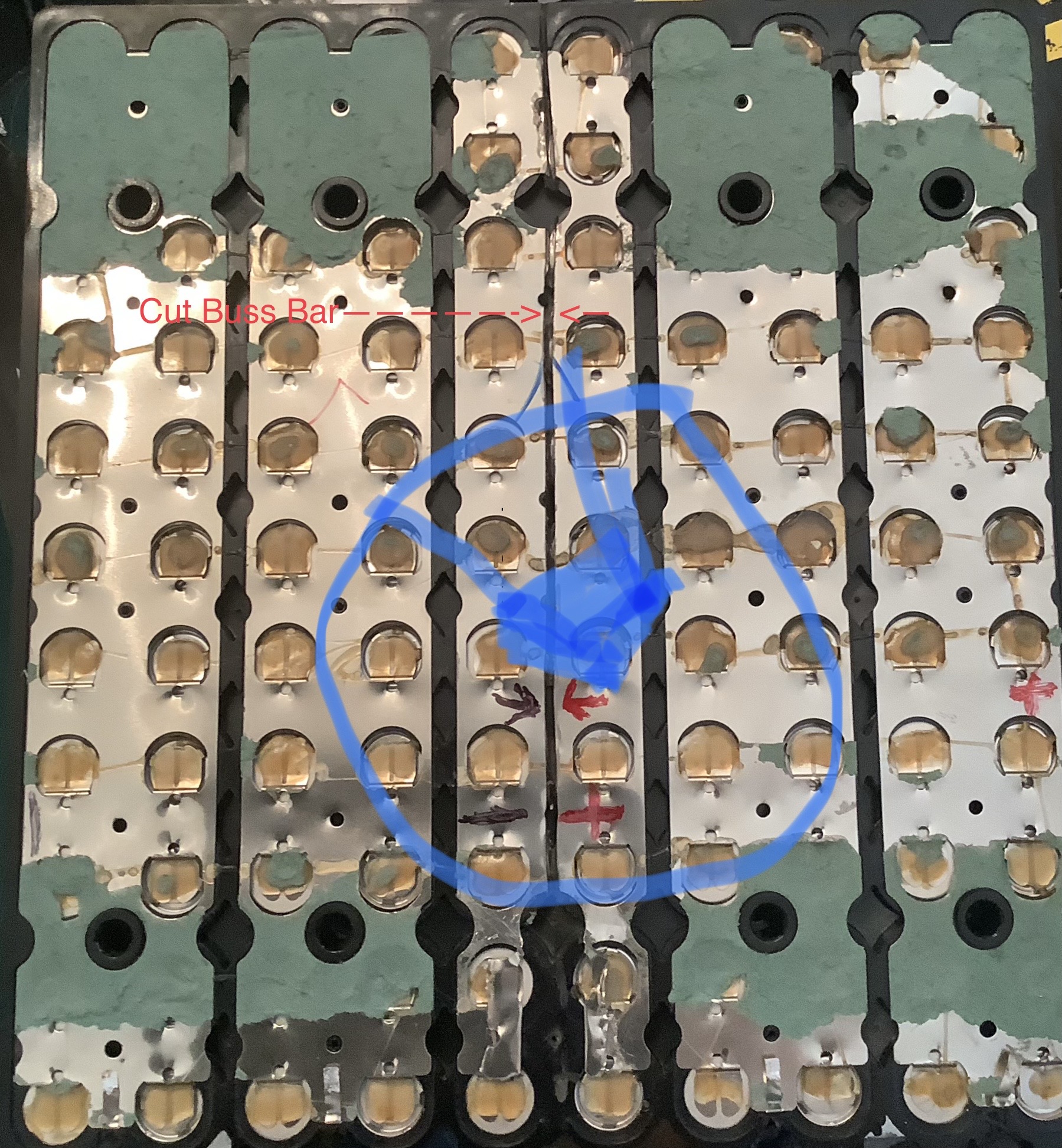

      Re: BAUER 20V Brushless Cordless Air Compressors modifications that I am doing
      I am but because this battery pack was a available and this battery pack has twice the amp hour capacity and I want to see if I could get the buss bar cut with out damaging the tabbing or any of the battery cells
      On this battery packs I not using a tool battery charger because I am using a BMS balancing protection board so I fast charge this battery pack because it was made for it

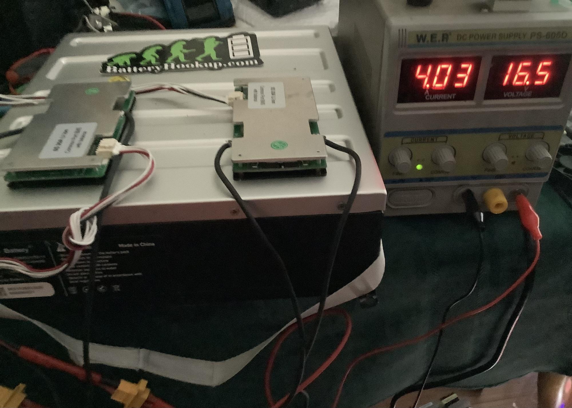

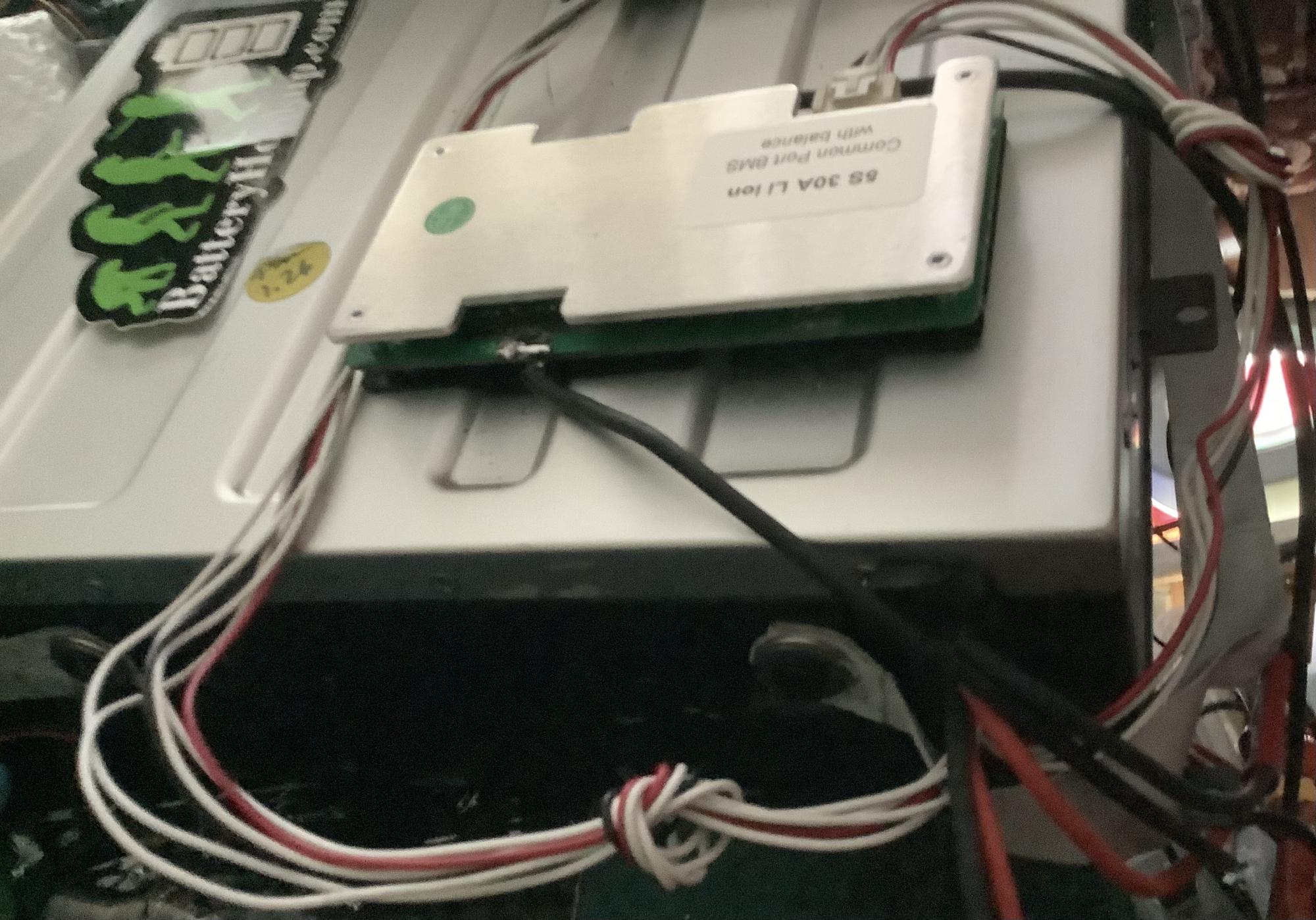

                        #31
                        Well I have made progress on this project I finally put battery packs in the one enclosure and I finally hooked up the BMS balancing protection boards now I have to work on charging system for these two battery packs to charge at the same time which is going to be a real challenge to do and I have not quite figured this part out yet stay tuned for updates in the future
                          • Jul 2011
                          • 6070
                          #32
                          Today I had a chance to run the battery operated air compressor and what a difference a big enough battery pack makes for operating this device it does not take very long for the air pressure to come up and cycle off
                          But I have an issue with one of BMS balancing protection board when you are charging it it becomes very warm at 4 amps and when you run the air compressor it also becomes very warm very quickly the other BMS balancing protection board stays cool when charging and running the air compressor I going to buy two more of them and return the BMS board because of getting warm while charging and discharging it which is what is not suppose to happen
                          I still have to work on the charger system for this battery packs and make the wiring harness for the battery packs I just have it temporarily hooked to see if the concept would work and if was doable and if anything needed to be changed for it to work correctly
