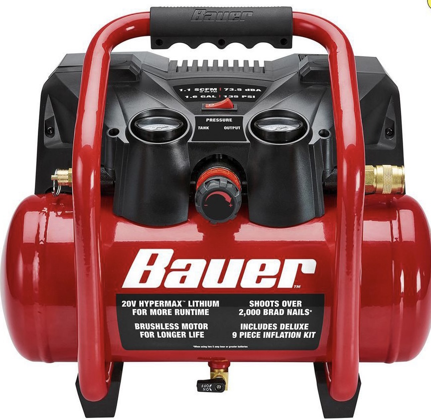

    I had bought one of them about a year ago and the one thing that I do not like about it is that the battery made for dose not have very long running time even though it has two 5 amp hour battery packs which the battery packs do test at 5 amps each it is that this air compressor takes a lot of power to run ( Harbor Freight I will post a website link if anyone is interested in buying one and doing the same thing )

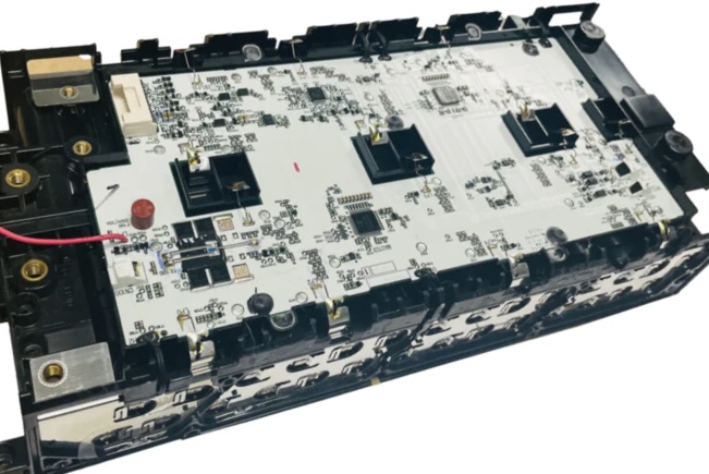

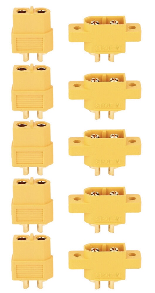

    JX9 Multi Wire VTOL Pro Connector w/ Servo Extension Plug Signal Wire Is the second picture this can be found on EBay if anyone is interested in this connector I will post the website link for them

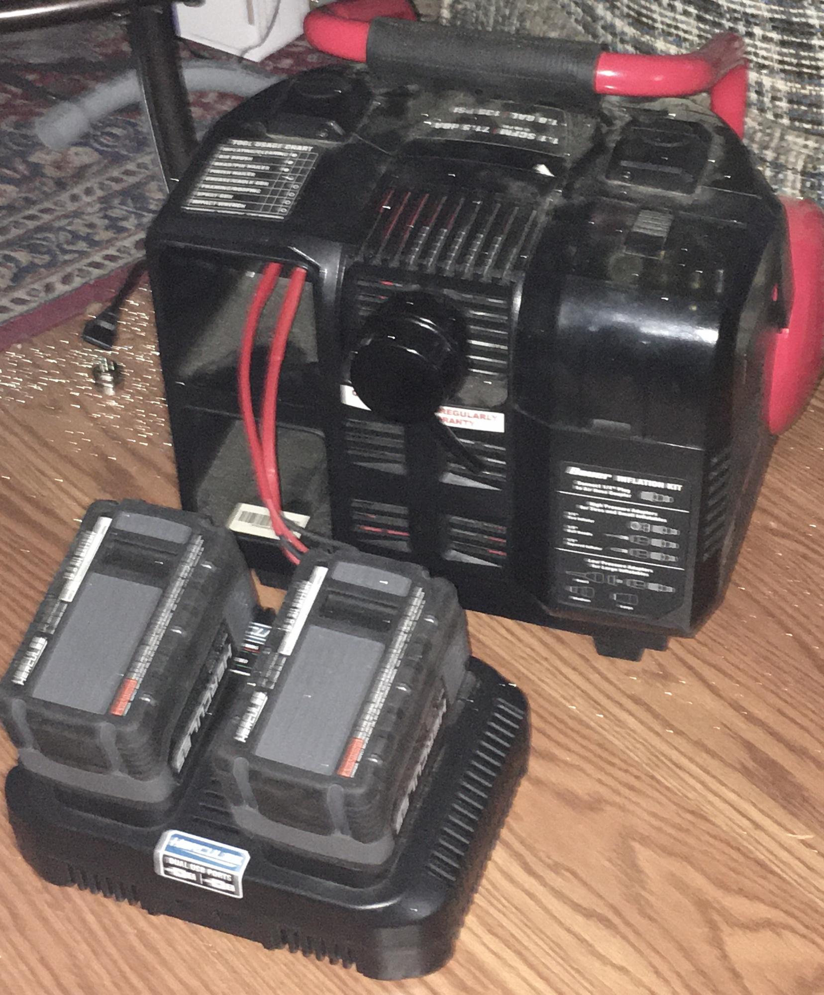

    The third picture is the battery pack and they did come with the enclosure but now Battery Hookup does not sell them that way anymore so I will will not list the website link it but they still sell them however they are in lots of 40 and you have to bid on them ( I have to modify this battery pack from 48 volts to two 20 volt battery banks )

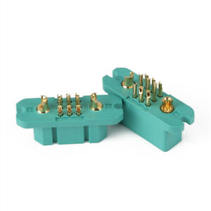

    The four picture is the other battery connector that I going to use from the air compressor to the battery pack ( this item can also be found on EBay as well

                            Update on air compressor battery pack modifications higher amp hours
                            Well I finally found some time put this project together I had bought couple of HERCULES 12 amp hour battery packs when they were on sale and I also bought the new 4 amp battery charger also when it was on sale replace the crape cooling fan it got up graded
                            Now I can use the air compressor and push the fuel gauge while it is running and it still a fully charged battery packs when I have another project that needs a air compressor and no electrical outlet I will see how well it works then
