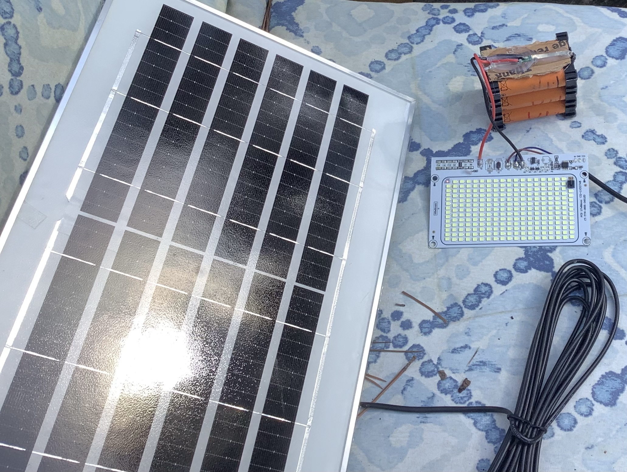

                      • Jul 2011
                      • 6070
                      Here is a picture of the battery pack and the LED light module and the solar panel setup
                      Now I have to work on the light module and get it to fit in an enclosure with the battery pack or use a different LED light bulb module that is also a 3 volt LED light bulb module that is not a remote control unit which is probably what I am going to do if I can get it to work properly if not I use this module instead but we will see what happens when I try to it
                      But I would need to use a PWM controller for the brightness of the LED light module because it is only controlled by an on and off switch and I do not necessarily want 100% brightness all the time
                      The battery pack has the following amp hour batteries The battery pack is configured as follows 1S6P
                      Battery one 1.179
                      Battery two 1.179
                      Battery three 1.178
                      Battery four. 1.178
                      Battery five 1.176
                      Battery six. 1.176
                      The total amount of amp hours is about 7.066 but this is without the BMS protection board being used so the actual amount of amp hours might be a little bit more or less than this
                      One note I would only be using this LED light when I am working in the shed so it not be used as light to light the outside of the shed but I would like to make one that lights up the outside of the shed for maybe for six hours a night and if there are days that there is not enough sunlight and the battery voltage is low enough for it not to come back on unless it nearly fully charged again but this is another project and I think that might use two solar panel with two separate battery packs but only one light module
                      One other note the cost of each battery cell was $0.85 X6 = $5.10 for this battery pack
                      More to come later when I have more of this project completed
                      On a different note I thinking about building a 12 volt battery pack using these battery cells but I would have to get a BMS protection board for these battery cells because I do not have the 3.2 volt version I have the 4.2 volt version for a couple of battery backups that need a new battery pack but the issue I have is to configure a 4S6P but this battery pack is probably going to be bigger than the battery compartment of the battery backup and I really do not want an external battery pack for this modification but we shall see if I can get some other battery cells with more amp hours but less maximum current capacity for the right price from Battery Hookup then this would not be a problem I might even consider using 21700 battery cells but they have to be cheap enough to possibly buy a 100 of them so I can closely better match the amp hours between battery cells for better performance in the battery pack

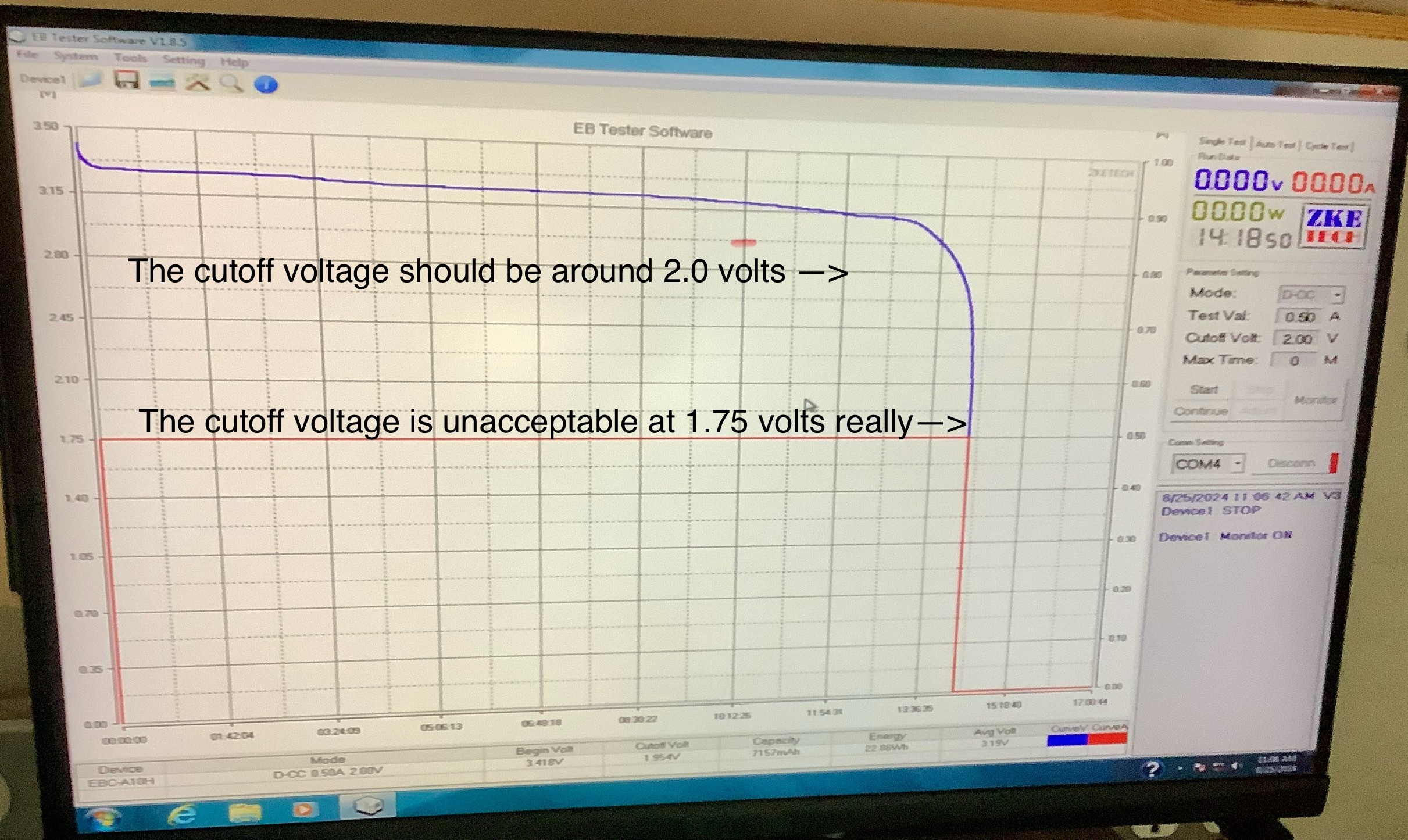

                            I had time yesterday to remove the LED light module from the BMS protection board and put it on the battery testing machine I know I need to stop doing this but right now I do not have a working BMS testing jig setup working properly right now but I need to get busy and get this working properly and stop using the battery testing machine that is not designed for this purpose
                            Here are the discharge test results 7.25 amp hours roughly this is what I expected from the BMS module and the battery cells configuration that I used
                            But I am not trilled with what I saw on the discharge test graph results is that the battery voltage cutoff was was not what I expected to see 1.7 volts really is this crap
                            Here is testing results graph for the discharge test
                            Now I have to jump start the BMS board so I can start the charging process but I going to do it in such a way to see what the cut in voltage is but this is not always easy to do but you can get a rough idea what it is most of the time
                            The cut in voltage is around 2.5 volts which is what I expected it be it might be a little bit lower than this but I do not have my adjustable switching power supply running right now in fact it not on the bench right now I just used a battery cell that I had recently tested to jump start the BMS protection board
                            I set the cutoff voltage on the battery tester to 3.75 volts cutoff voltage yeah I know that this is a little bit higher than it should be but I want to know what the actual cutoff voltage really is so I can determine if I need to use a different BMS protection board or not

                              Well the results of the cutoff voltage when charging is not much better and it appears to be for a regular battery cell voltage of 4.2 volts not for the 3.5 volt version so I have to try it on a 4.2 version battery cell and see what the cutoff voltage really is but I am not impressed with the results that I am getting from this BMS protection board
                              I have seen better BMS protection performance in other boards than this particular one and depending on its cutoff voltage I use it for nicad battery packs protection instead
