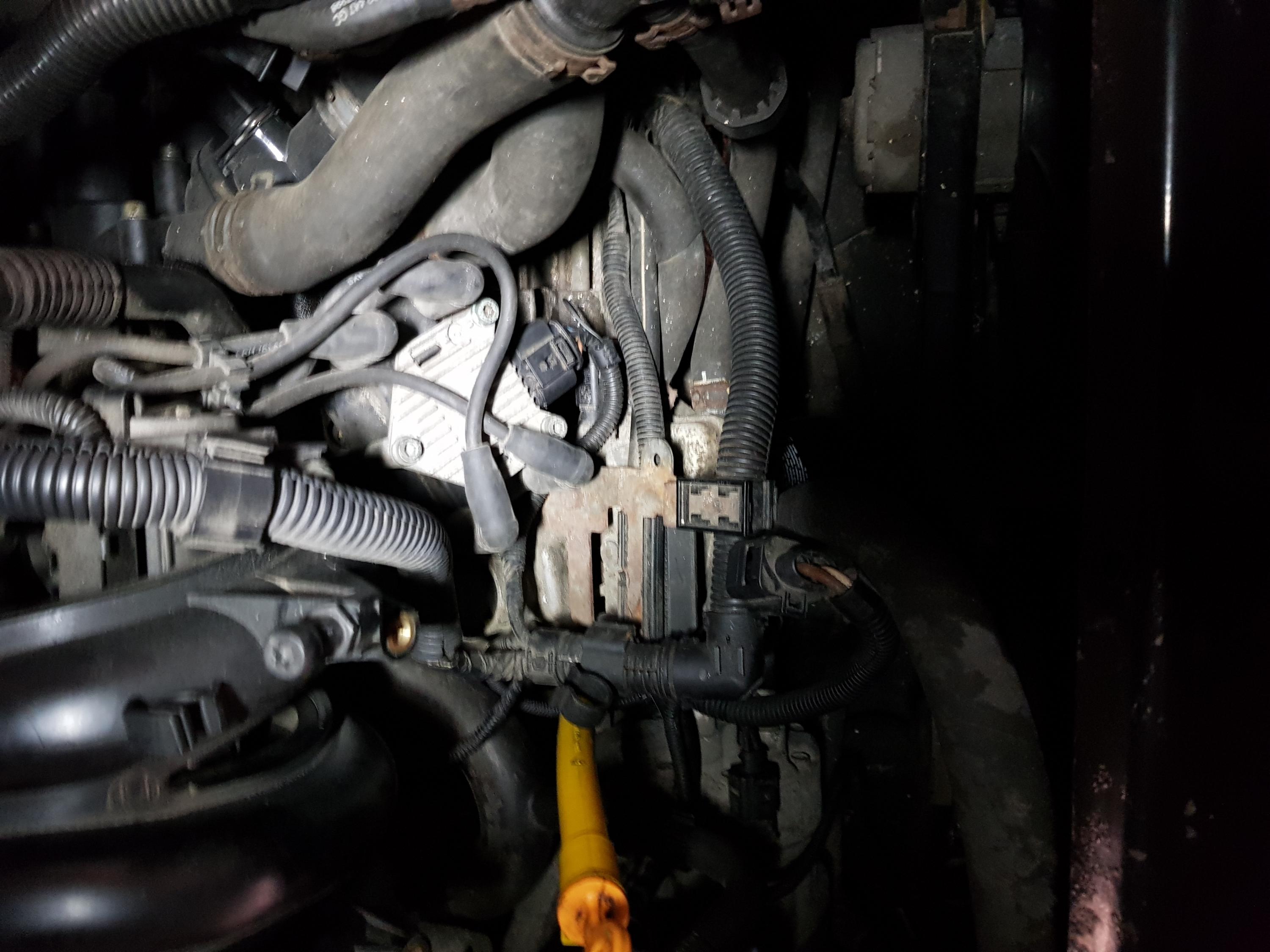

            Check all of the high amp fuses there was a time way back when they used fuse able link instead of a high amp fuse this much hard to find because they can be any where in the car
            • petehall347
              • Jan 2015
              • 4427

              Re: 12v 1uo941243c Relay repairable?
              cant remember if i posted pics of the fuse boxes . .. just starting up the laptop

                  #108
                  yes post 41 there is no 50 amp on it

                    #109
                    engine bay 1 .there are 8 fuses together .its one of those .
                    left side behind the headlight just to right of battery as yo look at it and behind battery
                          ok if you cant find the fuse pull k20 and see if its getting power on one of the large terminals in the socket .
                            Originally posted by bohaboha
                            those are 30 amp and they are ok
                            Three 30A ?, the bigger ones are the metal strips.

                                #115
                                excuse me which socket do you mean ? can i use 2 cement10k ?

                                    #117
                                    just measure the voltage on the large terminals where k20 relay plugs in . one should be 12v . the other is going to be shorted to chassis if the fuses have been replaced that blew first .

                                      #118
                                      you need to find and fix the short before blowing more fuses .

                                        #119
                                        i did it allredy ut there i gott power from 2 pins and the fuses are replaced here somes pics. the car have an cautomatic gearbox
