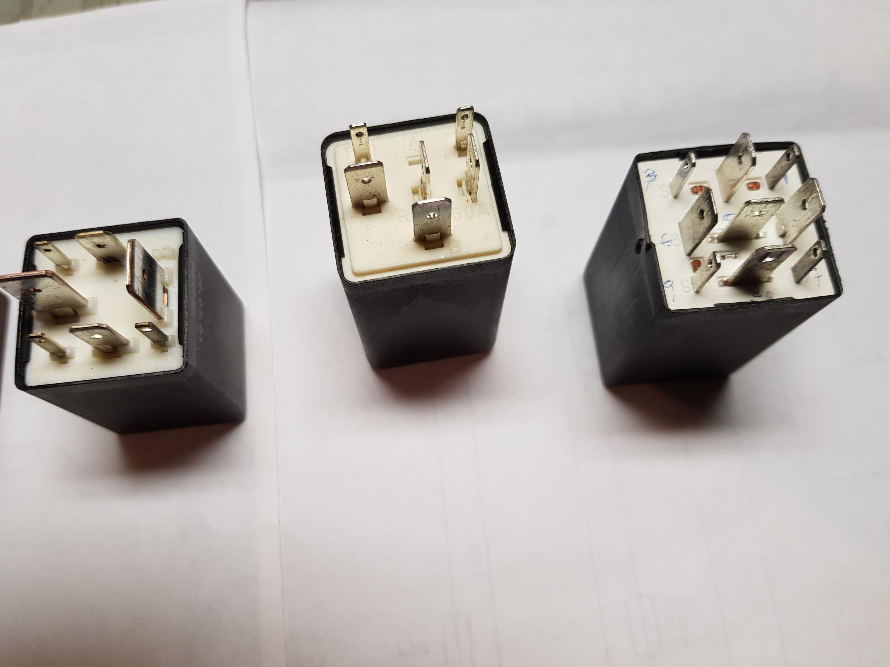

12v 1uo941243c Relay repairable?

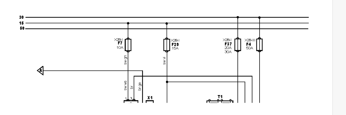

                            fuse that destroys all the time it is no: 29 on the fuse plate and I do not know to which relay it belongs the schematic on post 47 that you posted differs a little from my plate.

                                #75
                                Re: 12v 1uo941243c Relay repairable?
                                f29 powers A52 Ignition amplifier. unplug it to test if short gone .
                                its right there on the diagram ,
                                that manual is on google ..its a skoda factory one
                                https://letmegooglethat.com/?q=skoda...cal+pdf+manual

                                  Hi I find no F29 or A52 on the Diagram but you said "f29 powers A52 Ignition amplifier. Pull out the plug to test if there is a short circuit.
                                  It is right there on the diagram, can you point to what you are saying please

                                    #77
                                    everything is marked on the wiring diagram . there is also a list of everything you can search the pdf .

                                      #78
                                      Thanks these were not with the others in your last post.I'm trying to put them together so I can understand what it looks like.
                                      Sorry now i see they are here
