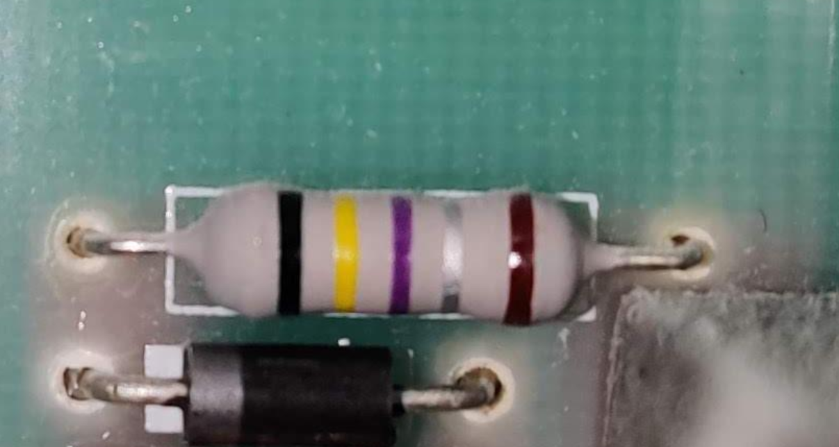

            Originally posted by jssamp
            Those are standard values. The left resistor if it is read the other way would be 1MΩ 2%.
            Hints: The first band is never black, gold or silver;
            Gold and silver only the last 2 bands.
            The first band CAN be Black, as in this resistor 0.47Ω 1% Often used in power supplies.

              Re: Reading resistor value by color band
              I've never run across one of those. Thanks for teaching me something today!
              • eccerr0r
                Solder Sloth
                • Nov 2012
                • 8707
                Any idea what brand that resistor is... that resistor is not following convention and still does not depict 0.470, which is more precise than 0.47 . Yes, it does allow lower resistor ratings for 1% but that's really cheating.
                Sort of annoying when I saw brown-black-black-red = 10K... which is what it should be, though it kind of annoyed me as brown-black-orange was the 5% / 10% indication of 10K.

                • JenneDezaeger
                  5-band resistor starting with black?
                  by JenneDezaeger
                  Can anyone tell me how it's possible for a 5-band resistor to start with black?
                  If it really was a zero-ohm resistor it probably wouldn't have burned.
                  So if there are any ideas on the value of this resistor and how to read it, please let me know.
                  Greetings,
                  Jenne...
