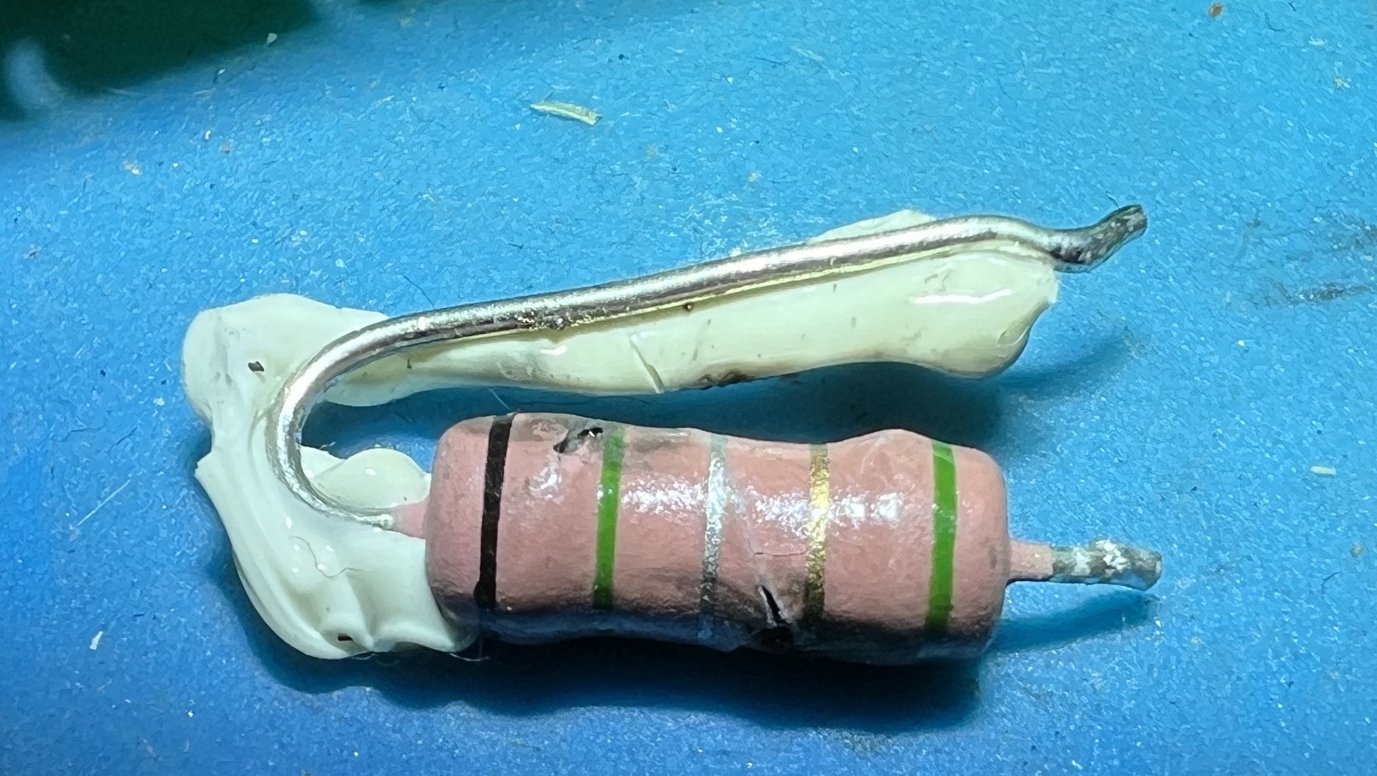

    Can anyone tell me how it's possible for a 5-band resistor to start with black?
    If it really was a zero-ohm resistor it probably wouldn't have burned.
    So if there are any ideas on the value of this resistor and how to read it, please let me know.

    Re: 5-band resistor starting with black?
    0.05 Om 5%
    • JenneDezaeger
      • Feb 2021
      • 18
      • Belgium
      How did you get to that?
      • lotas
        • Jan 2016
        • 4708
        • Russia
        Black - 0.
        Green -5.
        Silver - multiplier (0.01).
        Golden - tolerance (5%).
        5x0.01=0.05.
            These are fusible safety metal-film resistors and the last color they have can be the pinout, heat resistance, and more, whatever.

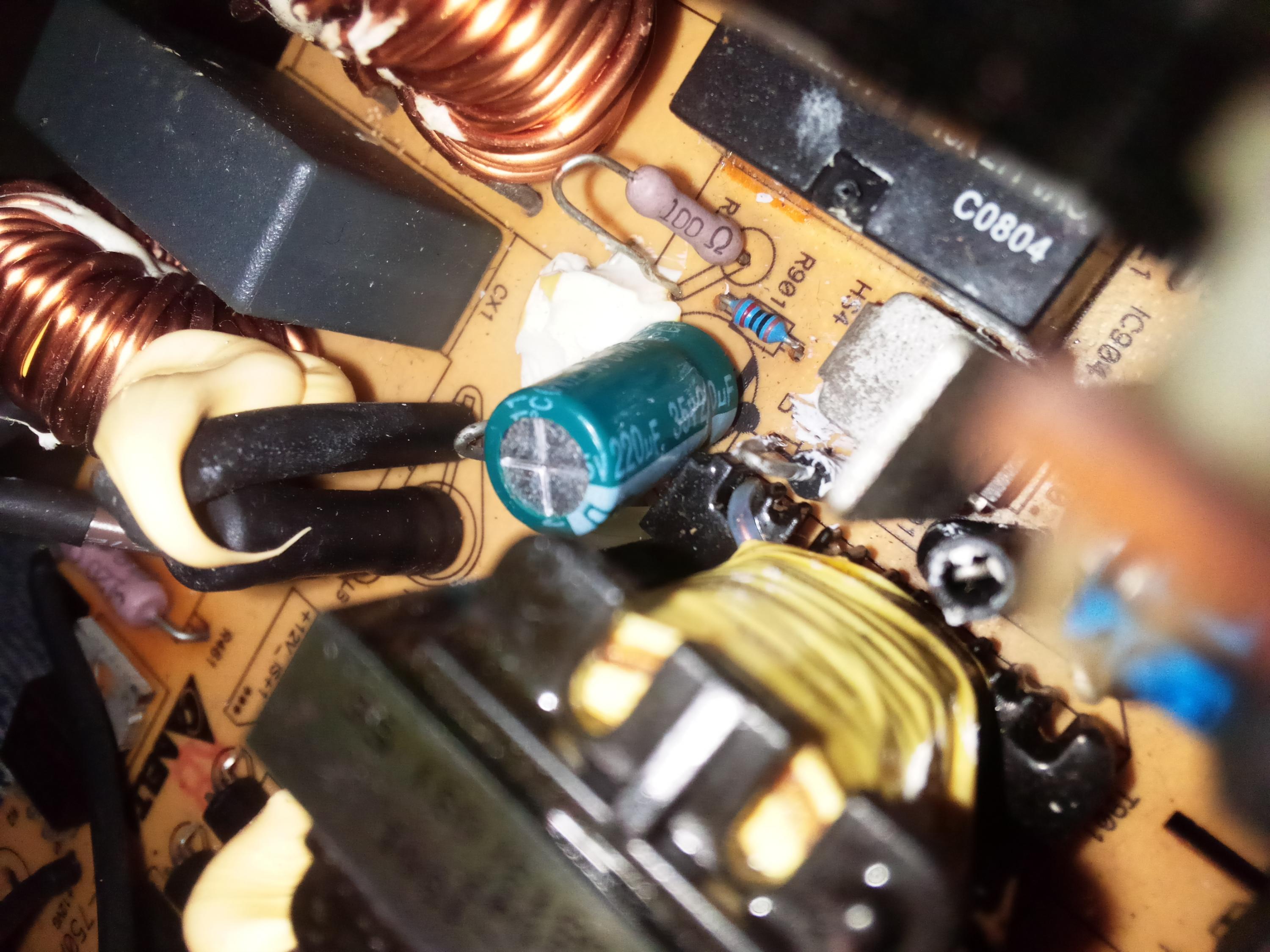

                what is the value of this axial resistor
                • PeteS in CA
                  • Aug 2005
                  • 3581
                  • USA, Unsure of Planet
                  If you are referring to R901, 10K, 1%.
