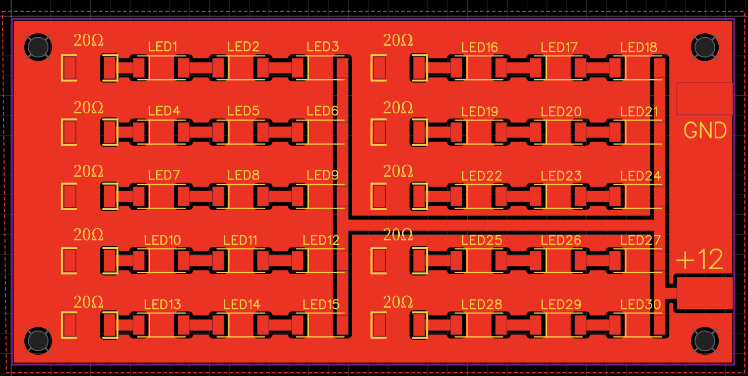

                • EasyGoing1
                  Shock Therapist
                  • Sep 2016
                  • 977
                  #48
                  Re: LED Resistor Calculations ...
                  Originally posted by eccerr0r
                  Aluminum PCB just means the backing is aluminum, of course, this will not function as a regular PCB, so there's a layer of dielectric on the aluminum. Then there's another layer of copper over the dielectric which gets etched. Heat transfer still needs to go through the thin dielectric layer, so it's not as good as being soldered straight to the aluminum but it's better than FR-4.
                  So I did some re-design on the panel, and I also made a 12-volt version ... everything on one layer without any center pins on the LED at all on the board, and I had originally had some through-hole components but when I had PCBWay quote them, they wanted over $300 ... so I made everything surface without any through-hole components and am waiting for that quote... apparently, when you spec aluminum for the board, it takes longer to get it quoted, but if the quote remains at the price it was when I put it in the cart, then ill order them up and should end up with a better panel that I have now.

                              You want the whole of the front to heat up evenly, remove those traces and have the + and - pads the full width of the board.

                                #55
                                You mean like this?
                                The copper layer which is all on the GND net, is underneath each LEDs heat dissipation node without any exposed copper so it will heat the entire copper plane that is GND electrically then presumably that will pass to the aluminum for dissipation...
                                sigpic
                                • diif
                                  • Feb 2014
                                  • 6978
                                  • England
                                  #56
                                  No not like that, I still see traces, the heat is trapped under the LEDs and can't go sideways.
                                  Draw thick lines from almost the top to the bottom that is your + pad the a tiny gap then another for the - and so on. The only thin trace will be the - round the edge going pack to the - input.
                                  With LEDs you're routing heat as well as electricity, heat is your primary concern.
                                      And still the NC pad are all connected together? Or are you using a different chip now?
                                      note: depending on soldermask insulation is not a good idea...
                                      OK, I colored the copper layer which is all electrically GROUND in yellow. Everywhere you see an X. the center pin of the LED is pressed against the SOLDERMASK on the board... the center pins are NOT soldered to the board. THEN, the back of the board is aluminum...
                                      Tell me how to dissipate heat better than this?

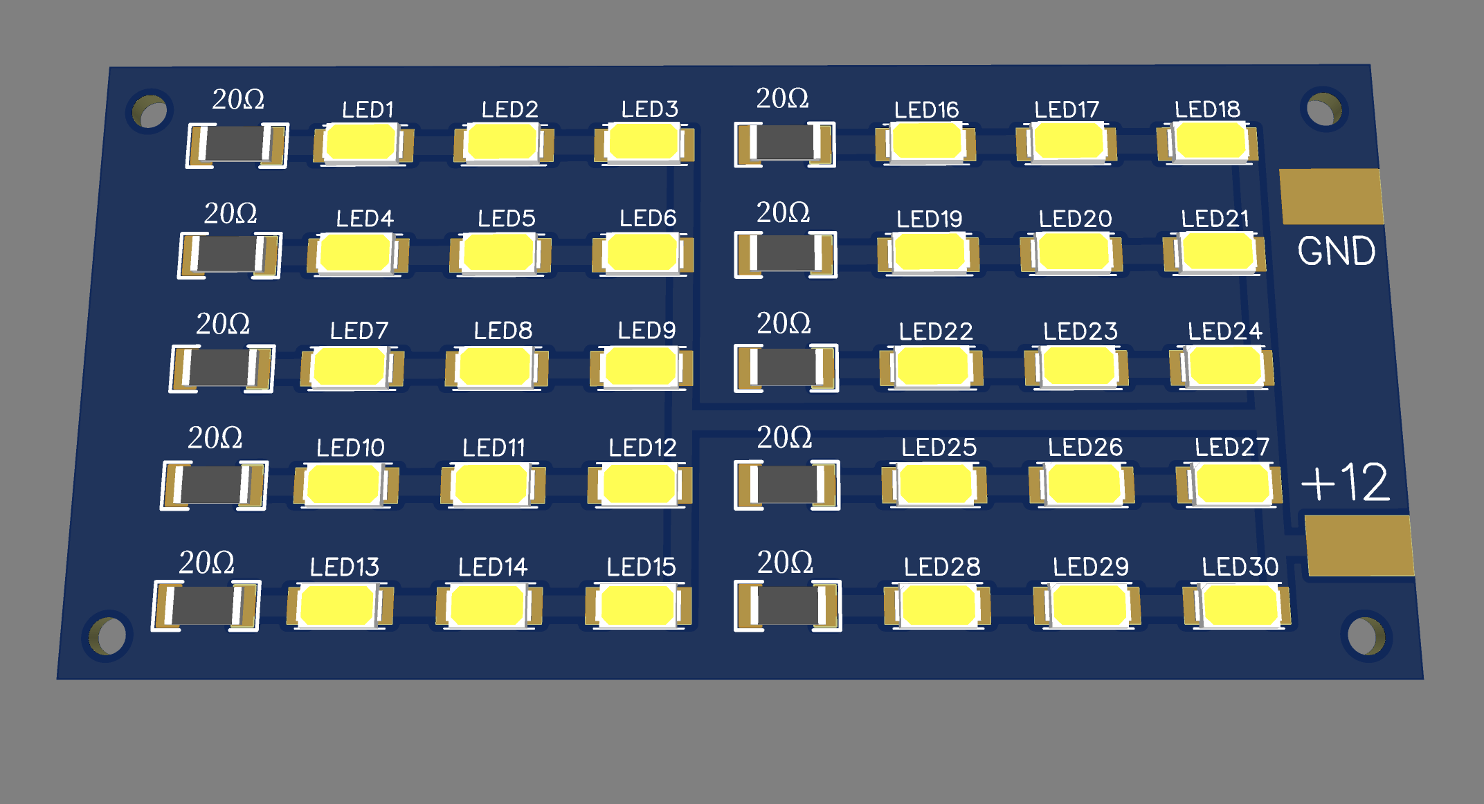

                                        #59
                                        I'm not sure why you're capitalising certain words but this photo should help explain.
                                        The thin bit you see is the only part of the board apart from near the edge there is no used copper, when i say used, I mean used for dissipating heat, power is coming top to bottom. The anodes and cathodes are all joined in big wide copper strips.
                                        The centre pad on your LED should be soldered it's connected to the anode.

                                          #60
                                          "The anodes and cathodes are all joined in big wide copper strips" - so in my design, this is a problem ...
                                          Here is the schematic for my LED panel... as you can see, if I just connected all of the anodes and cathodes ... it would not work at all.
                                          Also, the center pin does NOT need to be soldered for the LED to work. The two ends of the LED are all that are necessary for the things to light up.
