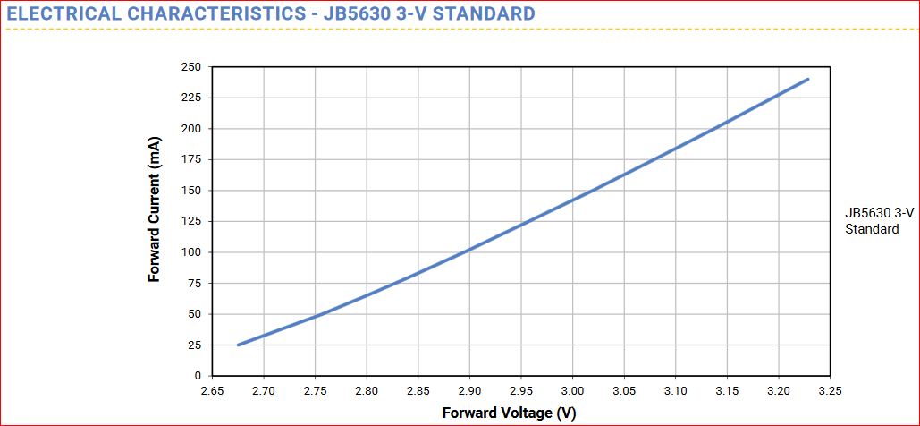

            Re: LED Resistor Calculations ...
            Cree JB5630 0.2W class around 2.8V 65mA, 3.0V hot at 150mA. Should be similar. Surprised to see the Vf is lower than rule of thumb, I thought 3.0V or more at low currents under 50mA but nope.
            OP because your string voltage will be close to the PSU voltage, you get a very steep I vs V curve.
            For 19V PSU, 3.0V LED's and 6.67ohm resistor say it's 150mA per string you get, or 750mA total.
            If the LED's heat up to 3.05V then you get 105mA per string with the same 6.67ohm resistor.
            If the LED's are cool at 2.95V then you get 195mA per string with the same 6.67ohm resistor.
            If the PSU is a bit high at 19.3V then you get 195mA per string with the same 6.67ohm resistor and 3.0V Vf.
                                https://www.badcaps.net/forum/attach...7&d=1618853318
                                Look at that graph,
                                @2.65V applied to the LED, the current is Zero, as you increase the Voltage on the LED, it will start conducting current. You will see similar graph for Diode. it will a good learning tool if you have Curve Tracer, just search for how to make Curve Tracer, for example: https://circuitcellar.com/research-d...-curve-tracer/
                                Semiconductor will not conduct current until the Vf is high enough to start conducting current.
                                Learn about dynamic resistance.
                                https://cdn.badcaps-static.com/pdfs/...5dcb4a7018.pdf
