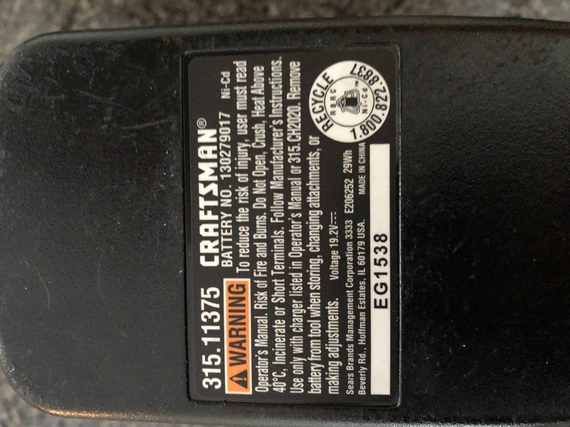

    So I found my old Craftsman 19.2v C3 battery for a 1/2” impact driver.
    When this was “new” it performed terribly. Barely able to get more than 4 lug nuts off before dying. I always attributed it to the battery itself.
    Now they have lithium ion equivalent replacements with 5-6Ah capacities. This made me curious about the capacity of the nicd.
    Couldn't find any specs on this battery and the ones I do find are rated at 3.6Ah but the sticker on the battery says 29Wh. Doing the math (29/19.2) gives only 1.5Ah.
    So am I missing something here or are the specs online misleading? The 1.5Ah would make sense why the tool barely performed

    NiCd cells are notorious and famous for their memory effect and low capacities.
    Typical NiCd cells have capacity of about 600-700mAh. Or less.
    My first cordless drill was cheaper one and came with NiCd battery.
    I don't even need to tell you how much better performed my second drill with LiIon battery. 10x better.
    NiCd batteries are huge, while their actual capacity is miserable. Only most cheaper tools come with NiCd.
    Or extremely old ones. You can either get rid of the NiCd and replace them with NiMh or LiIon, complemented with controller
    You also cant just use any batteries. Power tools need batteries with high peak discharge rate.

      1.3Ah NiCd cells are common for battery packs (sub-C-sized). I've seen 5AH "D" sized NiCd cells (used in old laptops).
