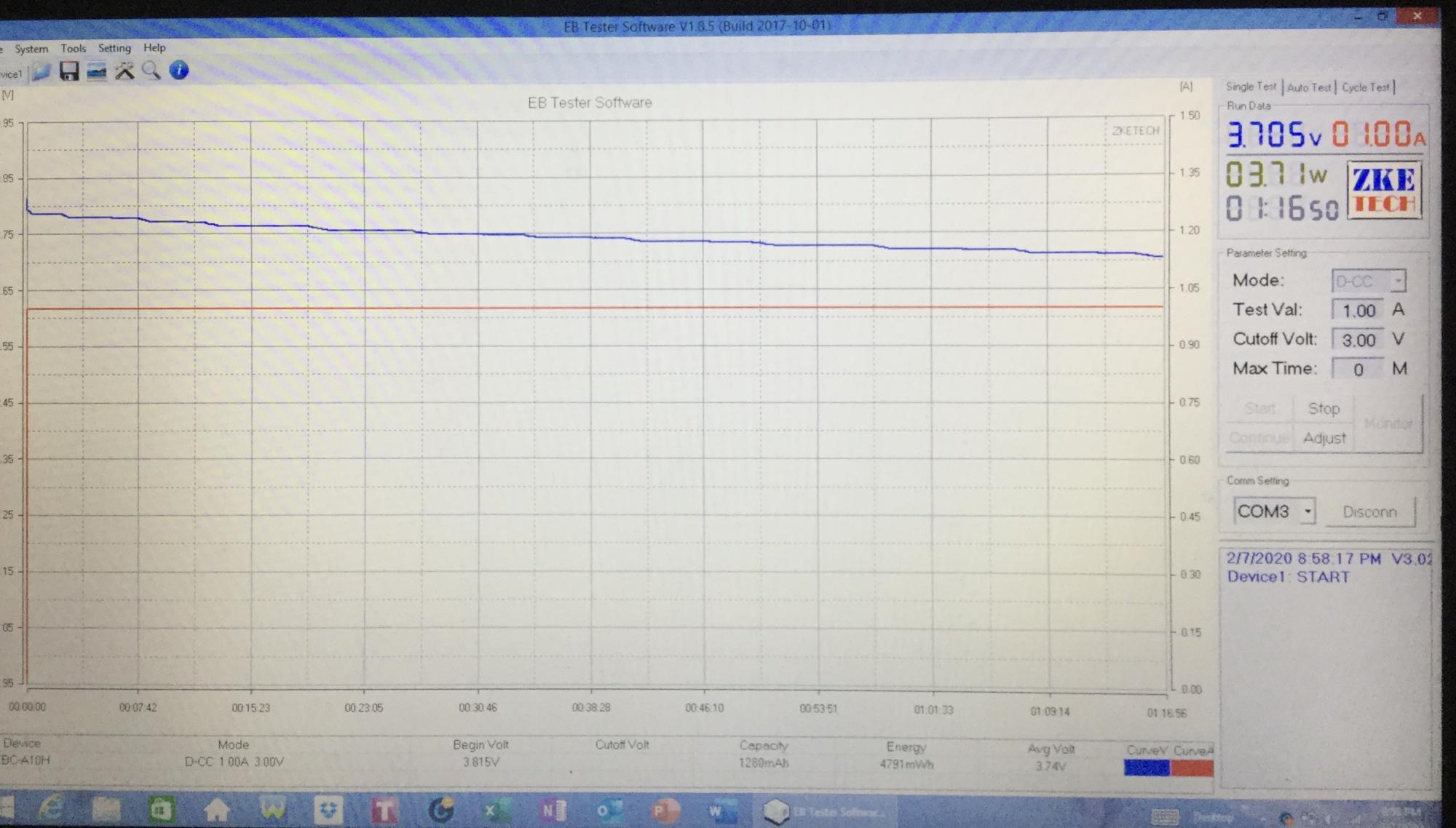

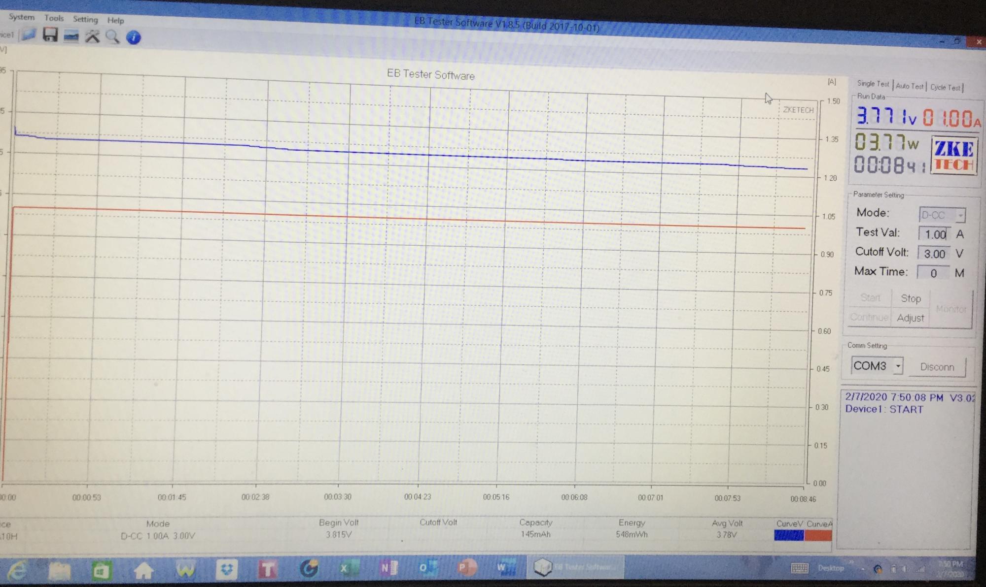

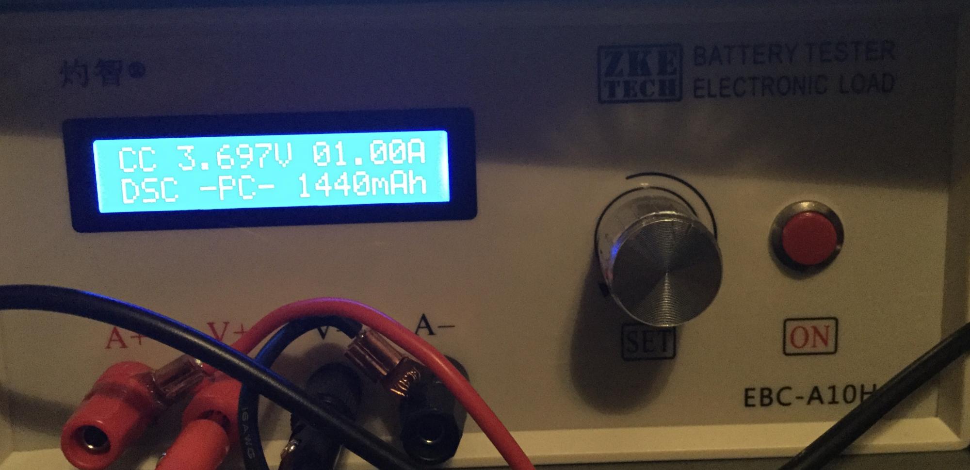

                                      I have the battery tester it came in the mail today
                                      One note about this test the battery was not fully charged
                                      The first picture was when I started the second picture was 1 hour and 20 minutes later
                                      There is an eBay / Alibaba.com / AliExpress seller or one of them that sells Varta batteries that will only use this battery tester to warranty batteries and I can see why
                                      I can not find the seller right now
                                      I have a concern about this charger and that is you can only really charge or discharge one 18650 cell at a time this does not have a way to monitor more than one cell at a time
                                      But what I wanted to do was to bench testing batteries and this will do that

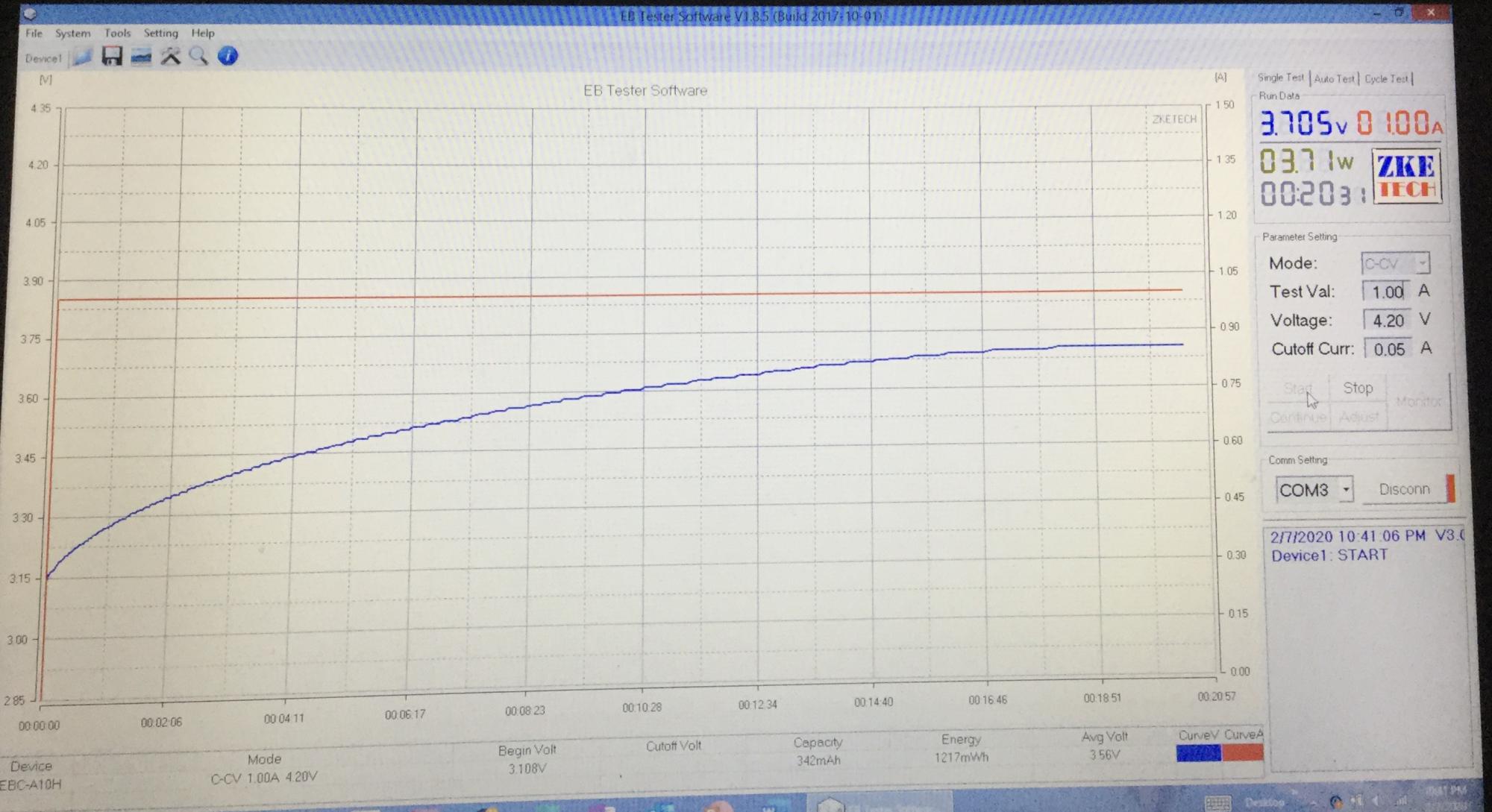

                                        Here is something I find interesting about when the battery is on charge
                                        Is that the ramp up curve level out at 20 minuets into the charge cycle
