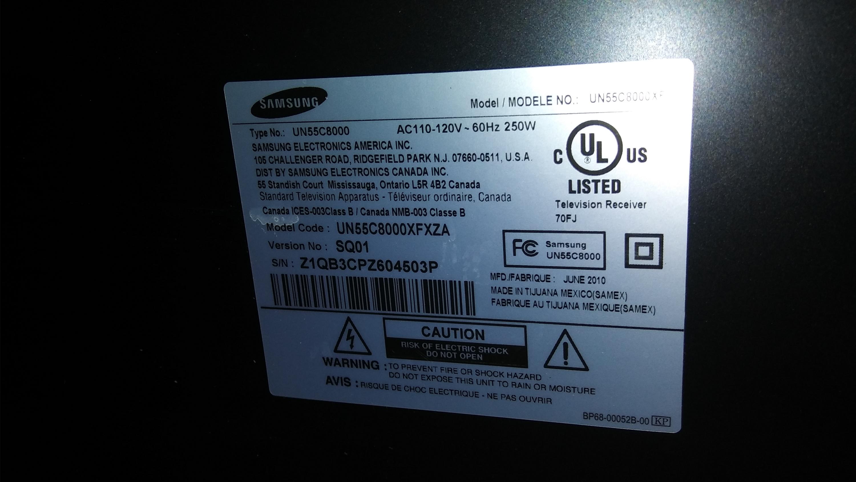

    The TV is from outside of the United States different systems will work on the ATSC system? the HDMI should be the same all over the world? but the customer said nothing works on this TV? is that right?

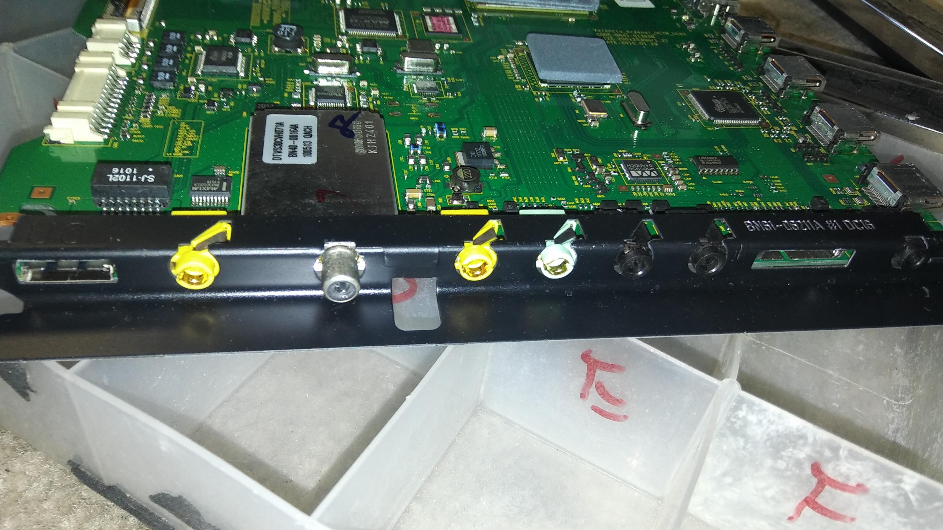

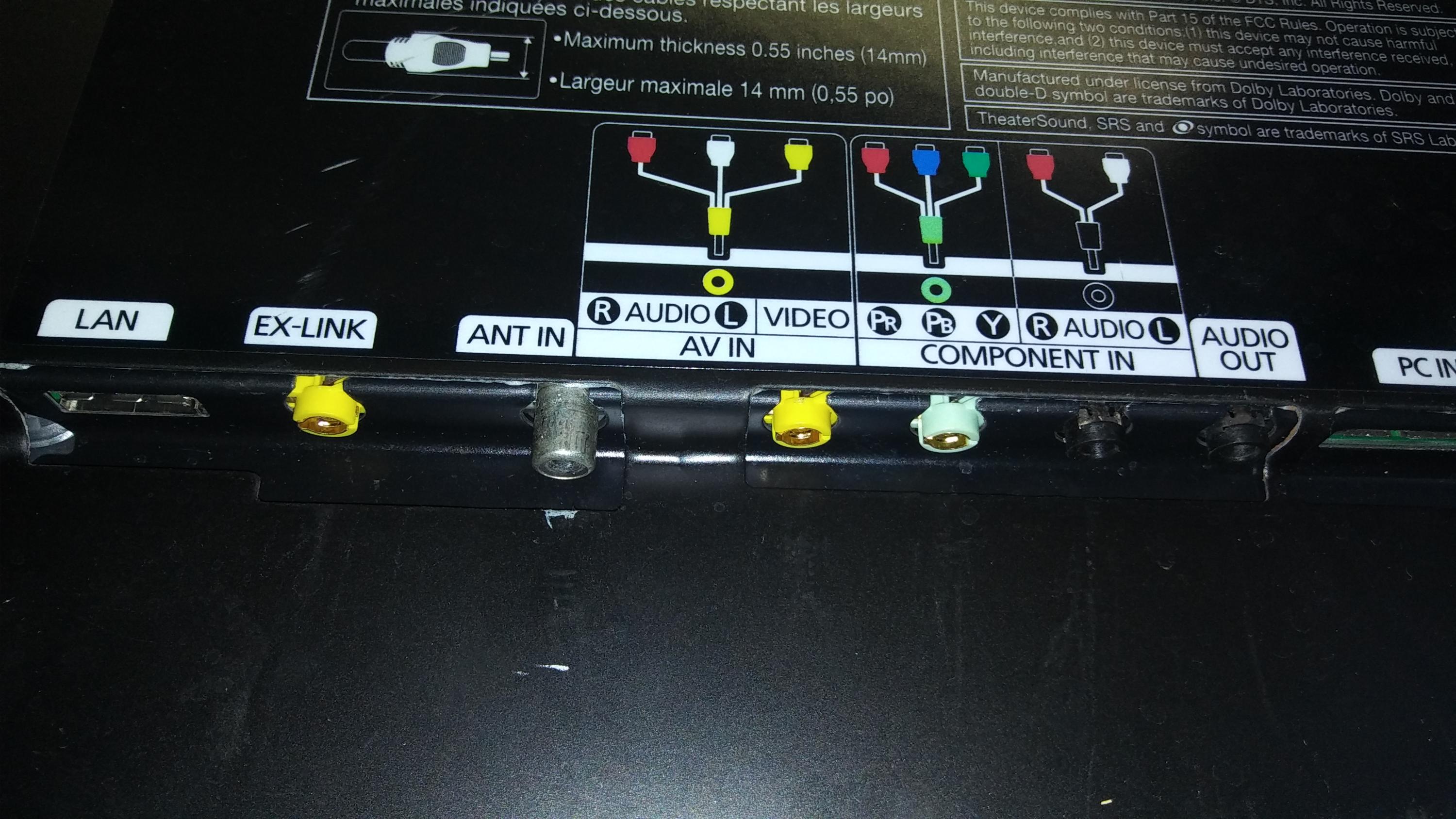

    I checked on tuner it is NTSC system because of the connector I thought was PAL system.
    Samsung BN40-00164A Tuner-Dtvs30Cvh071A, Ntsc
    Is that missing an adapter?

      Re: Will different systems will work on ATSC?
      pal does not use a phono socket, it uses a belling-lee usually.
      that tuner would have had an adapter on it - probably to an F socket.
        UNxxc8000: N = North America.
        You need one of this adapter: http://www.samsungparts.com/Products...UN55C8000XFXZA

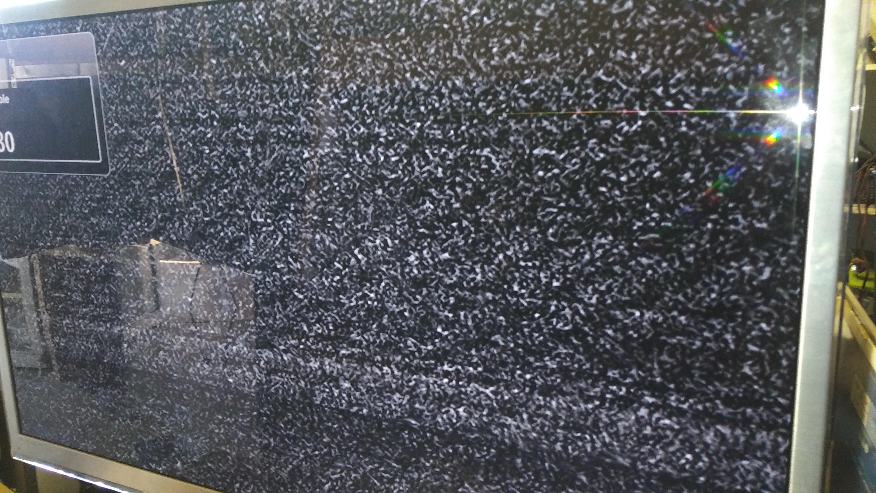

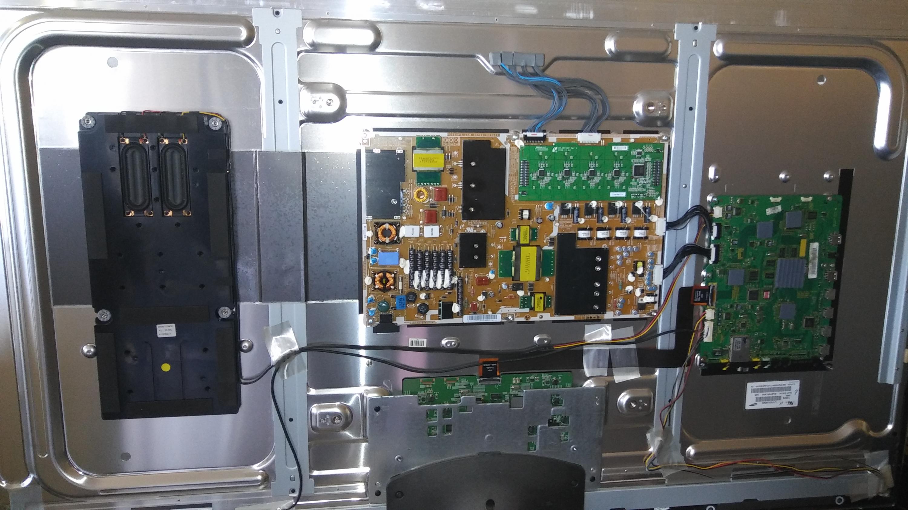

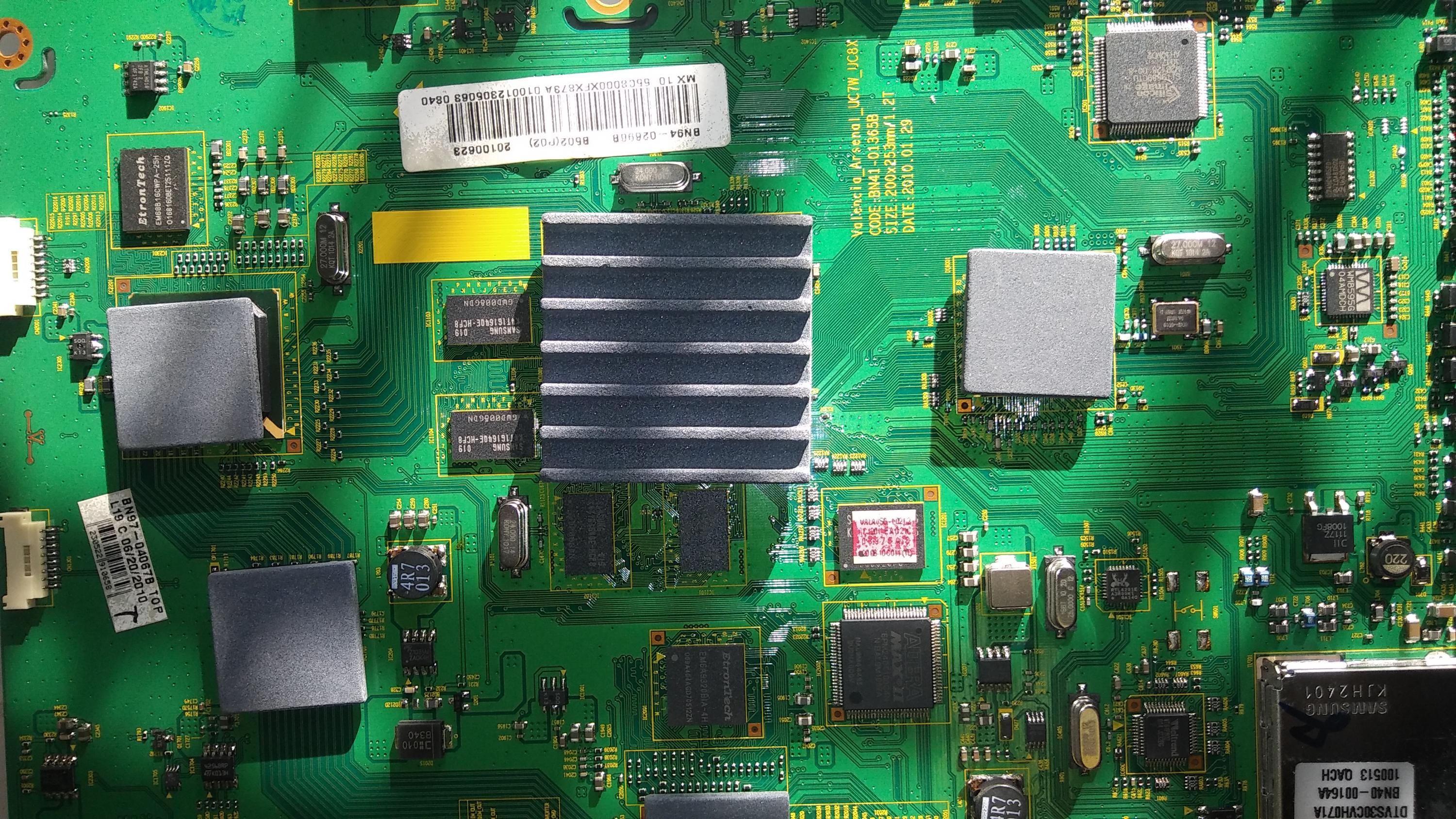

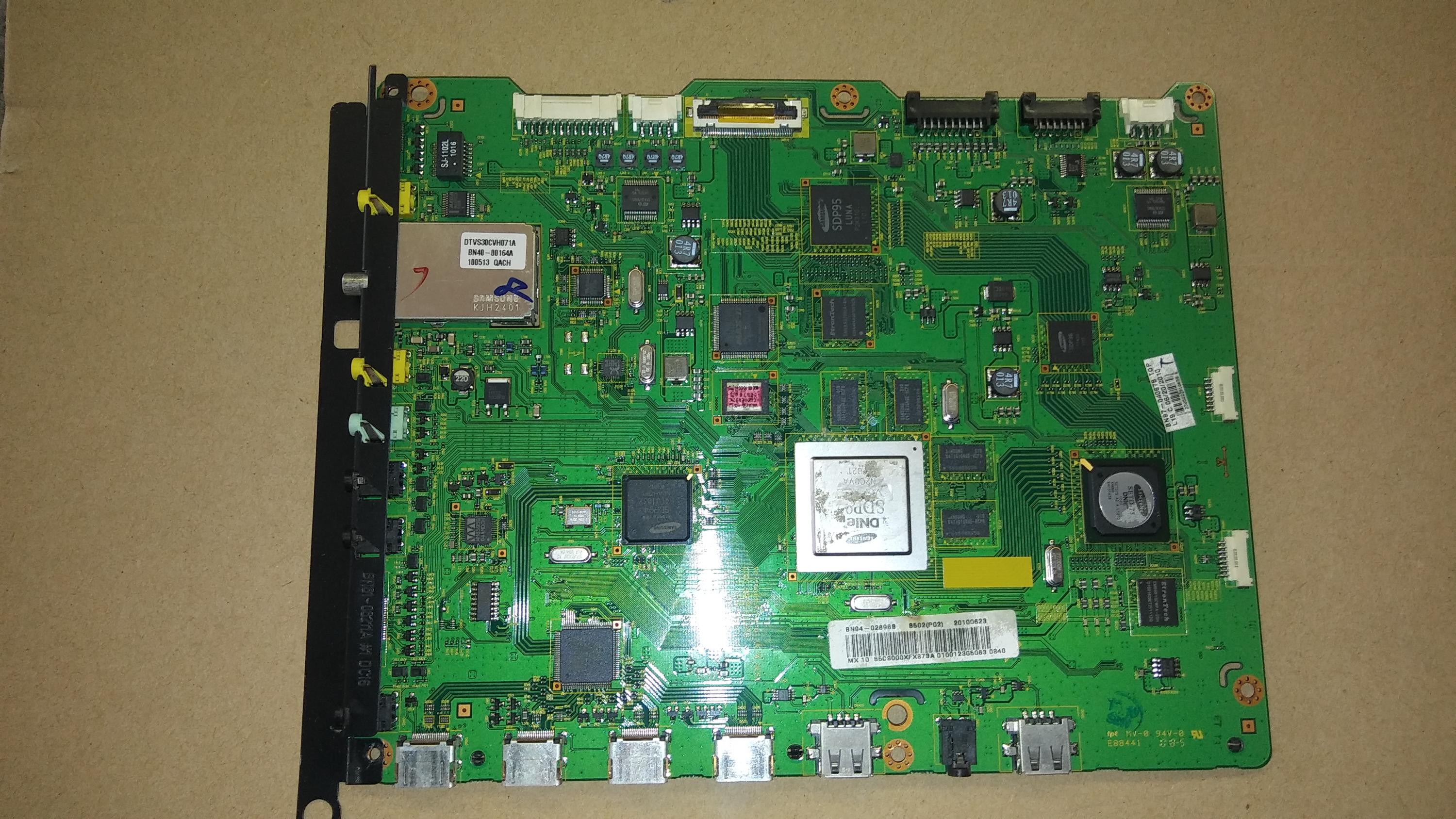

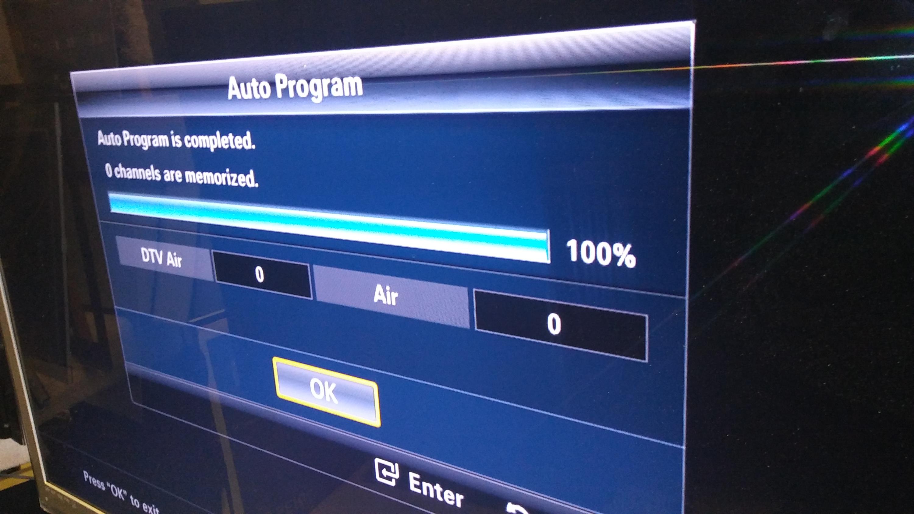

            Okay, then tv problem is no input works.
            How can I know which IC has a problem? Pic (1) and what are those useless porcelain heat sinks for? I threw in the garbage, right away. (2)

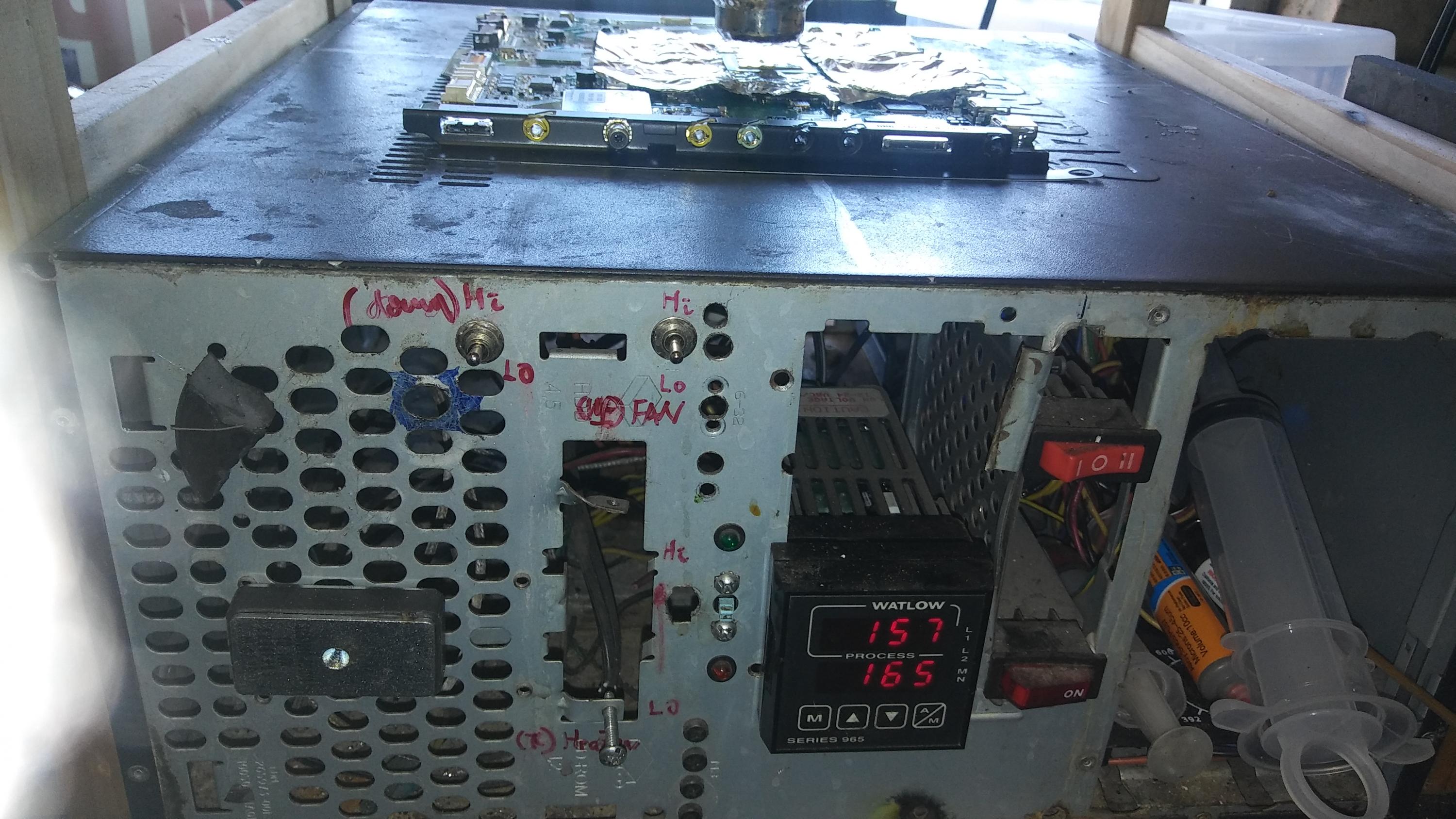

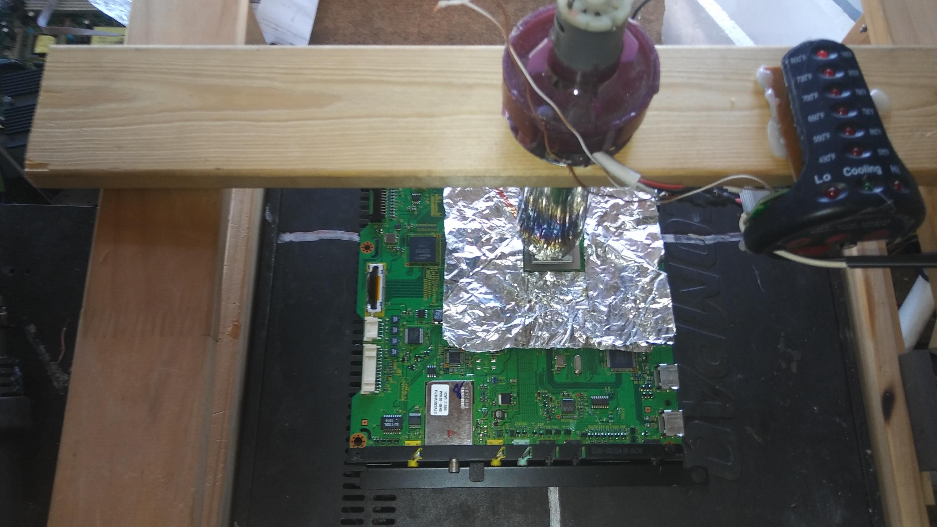

            I'm going to guessing is the metal one. Bag reflow begin.
              After (1,2) tv still no input. do I need to use oven bake?
                check your menu's first - make sure it's set for the right region or it will scan the wrong frequency range.

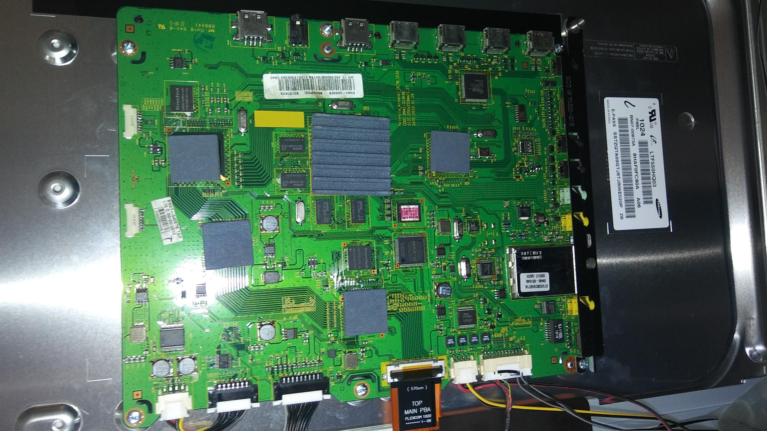

                      Originally posted by budm
                      Do other TV's you have in the shop able to pick up anything? How about hooking it up to other video source that has ch 3 or ch 4 RF out?
                      The HDMI inputs are OK, correct?
                      The strange situation, all the input sources are not working and TV will take a long time to turn on the screen.
                        OK, then it is just not tuner problem then.
