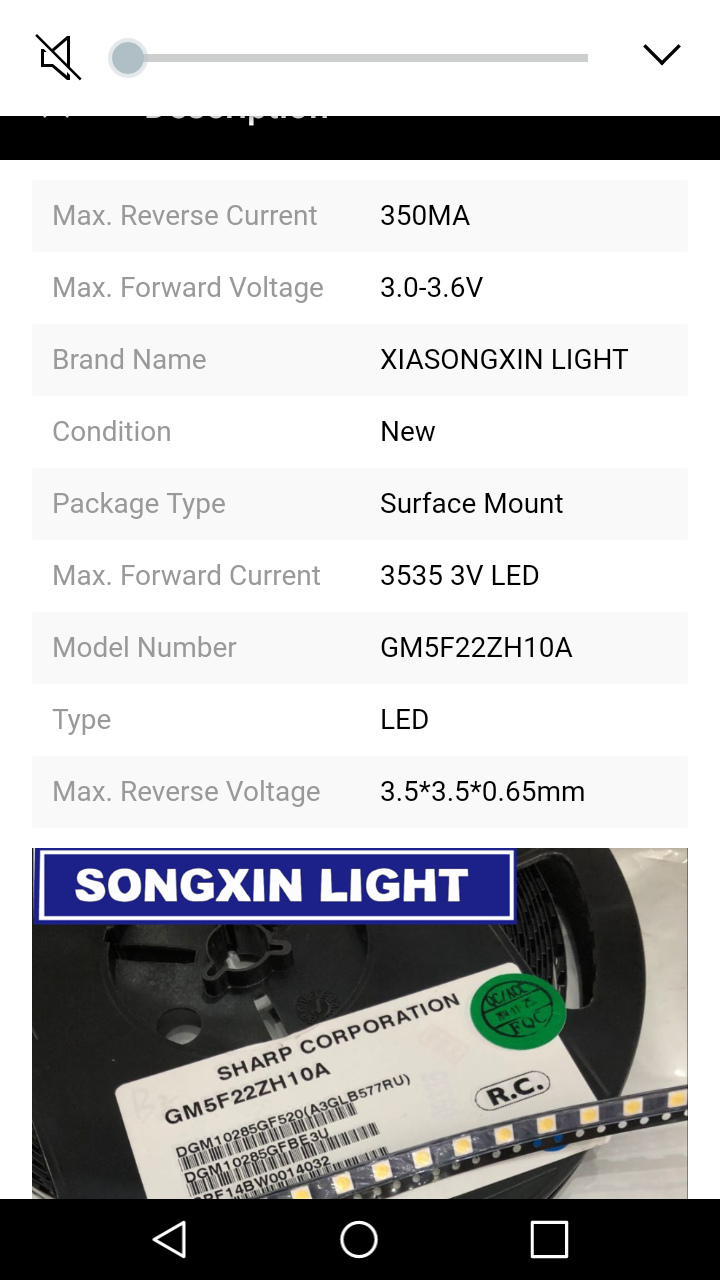

      Yes...Max. Reverse Current 350MA but how can I test it?
      this is for my next project is for an unknown LED I can test the maximum forward current and luminance then sorting and reclaim used leds.
      Maybe I can use my own standards. I put 100 mA to the LED see how much luminance come out and use this to sort all the LEDs.

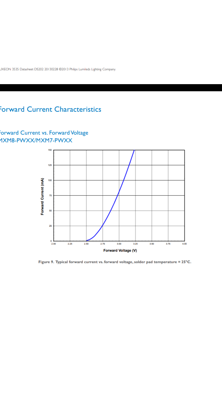

        Do you have full spec sheet?
        I.E. see page 4. https://cdn.badcaps-static.com/pdfs/...ae1f01f265.pdf

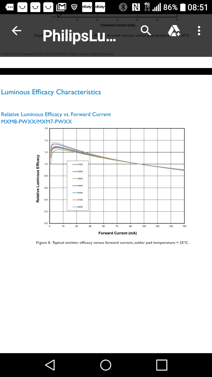

          the manufacturer used 100 mA current to test leds.
          the beamwidth (beam divergence) 2θ, which is the angle of the cone of light emitted, we can do an approximate calculation
          In fact, my next question is how to test leds with diffusion lens? It is already written in the article and taught me how to calculate luminance.

            it's all about disipating the heat - like any semiconductor.
            however, there is little point taking the piss with it because the current to lumens curve levels off fast near the top.
            doubling the current may only give you an extra 20% lumens - the rest is more heat.
