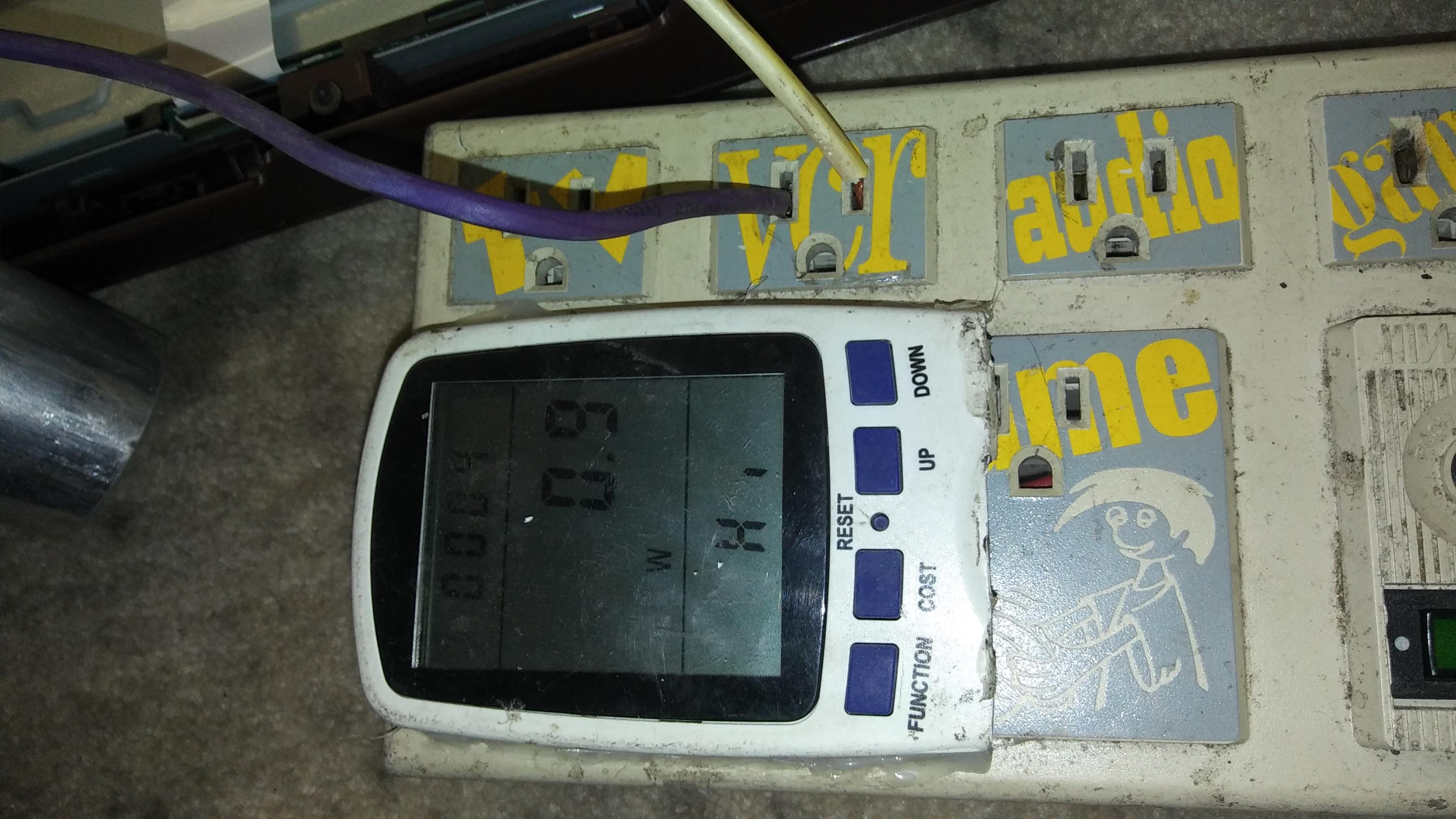

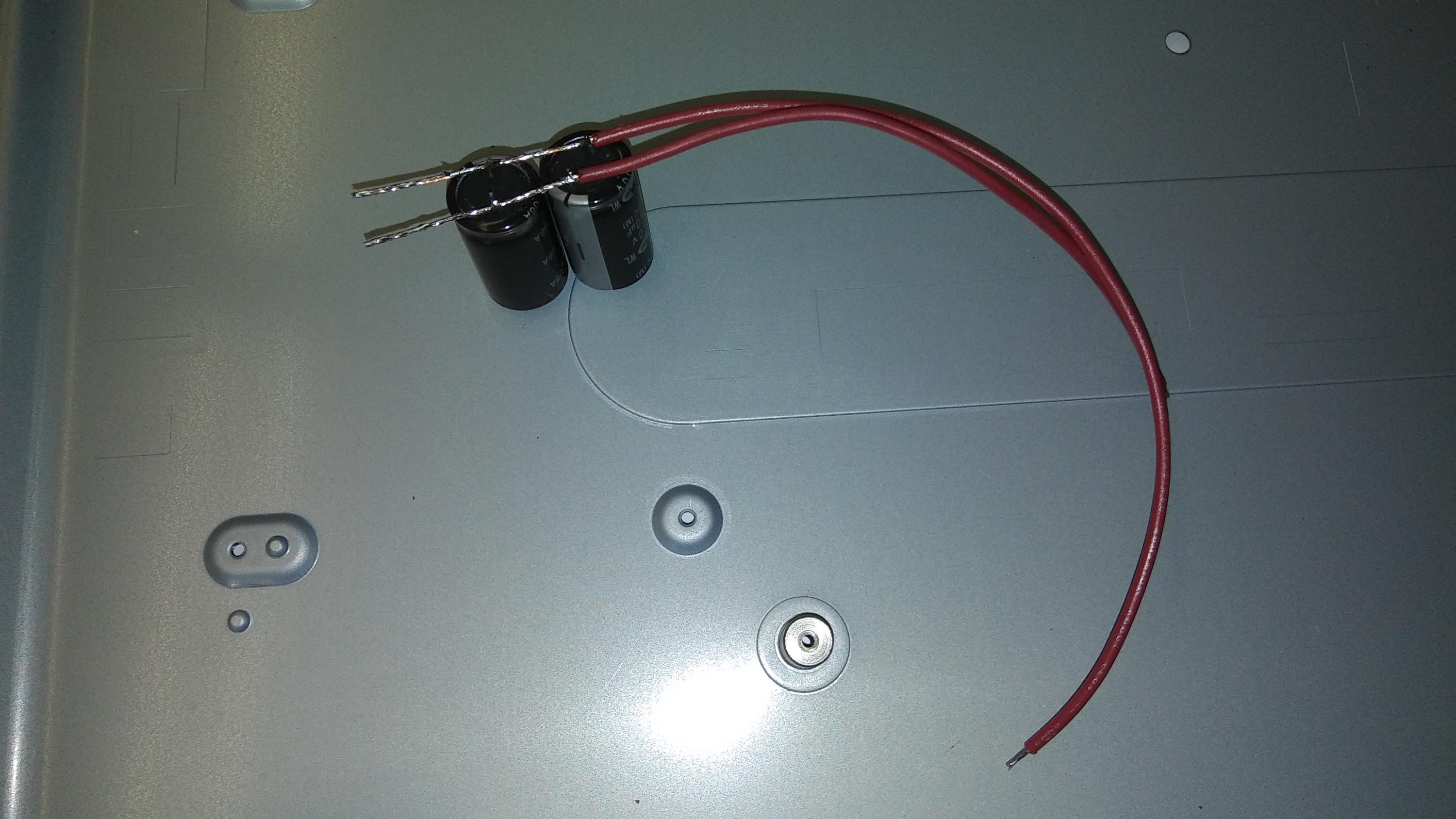

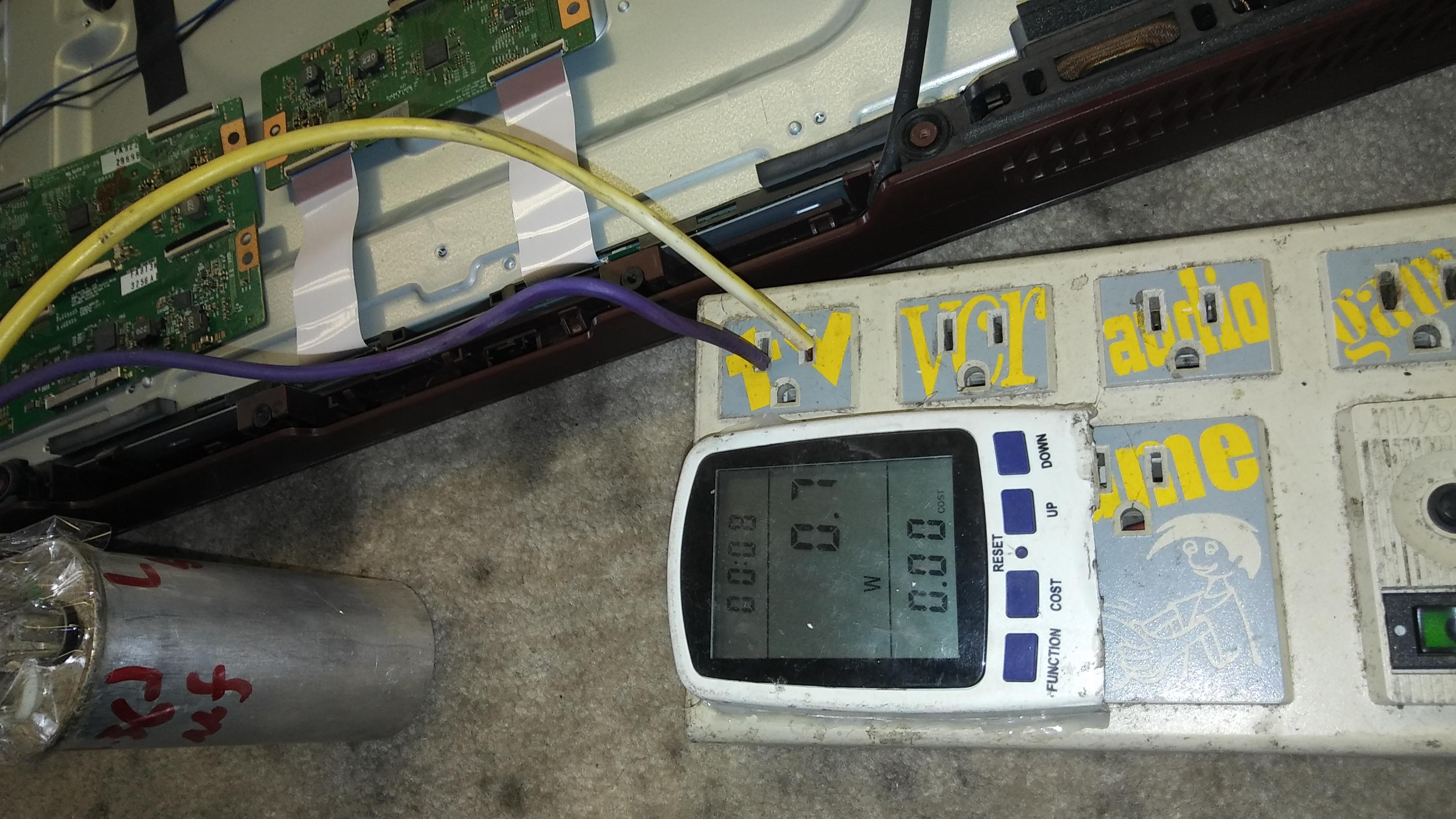

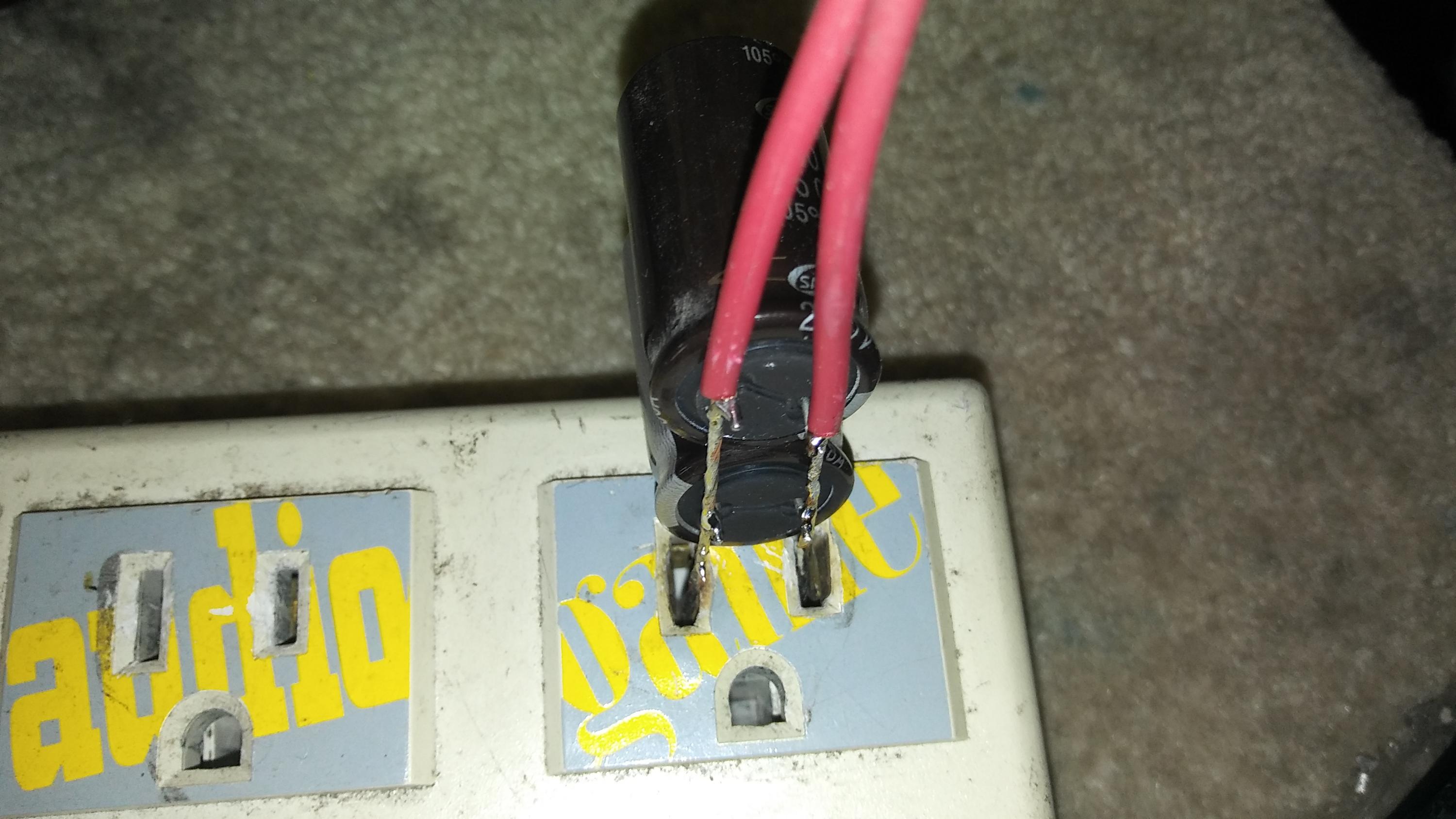

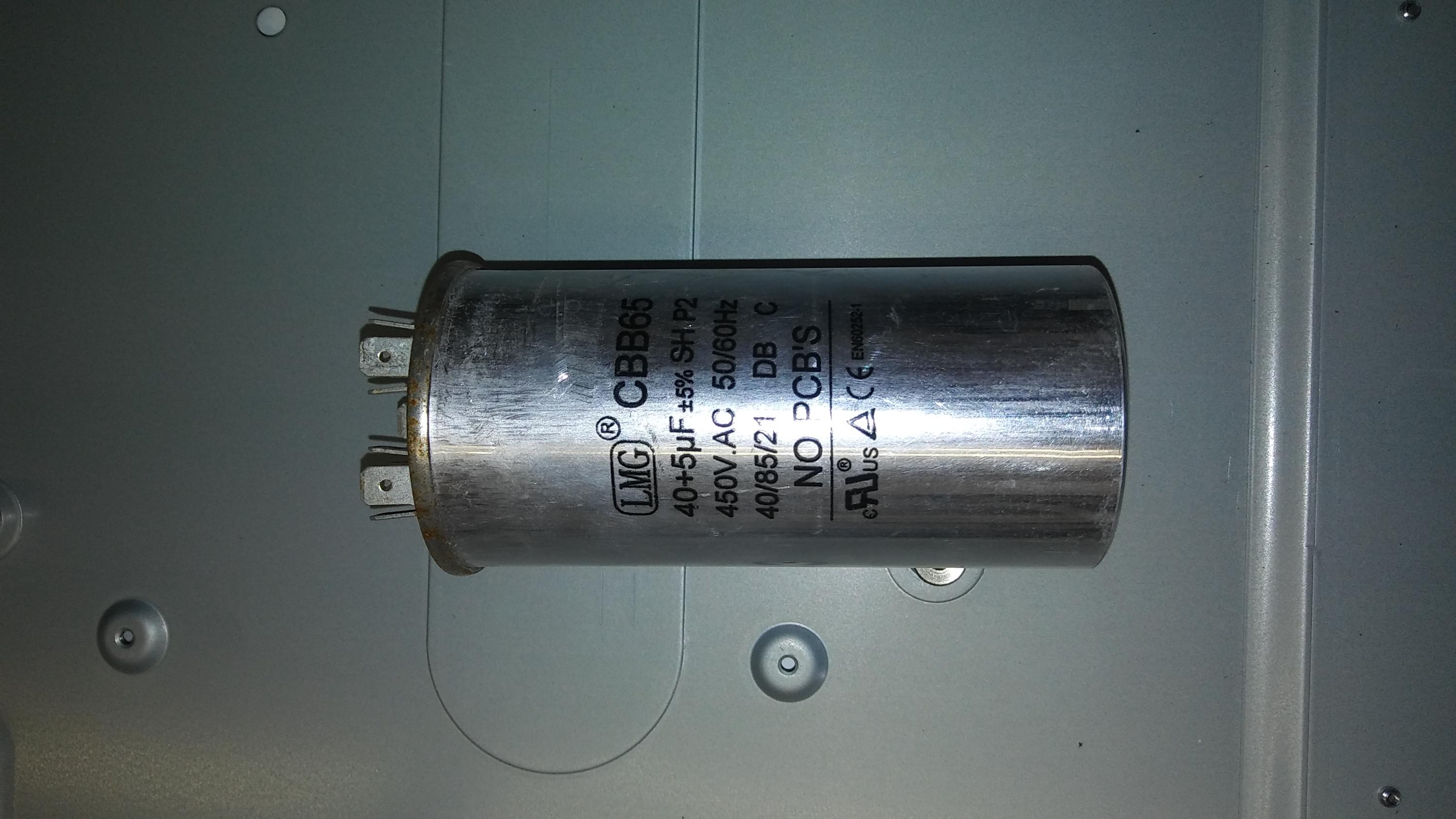

      I am so blessed by the God. unlike the video he used 240v and we're in the US only 120v.
      I connected two capacitors polarized reverse together I thought I've made an AC capacitor but the fact was I only make a nonpolar DC capacitor. So it blow out with white smoke.
      Does anybody know who make the decision USA uses 120v I need to say thank you to that person.
      I going to use real AC capacitor from HVAC unit.....to be continued...

        you should wire capacitors in series so you end up with 2 negatives or 2 positives .
        • R_J
          • Jun 2012
          • 9535
          Re: How to make a spot welder.
          Petehall347, I just looked at the first picture that is NOT the way to make a bi-polar cap. they must be connected like you said, in series (+2+ or-2-) Those caps also likely won't handle the current.

            I've seen 1F capacitor discharge at ~4V, so to not need a 1F capacitor,
            1F * 4^2 = 440uF * x^2
            x=191V
            So yeah looks about right, need those high voltage in order to not need those low ESR 1F caps...
            Note that you can just rectify the line voltage and not deal with bipolar capacitors. And yes the capacitor needs to be low ESR...

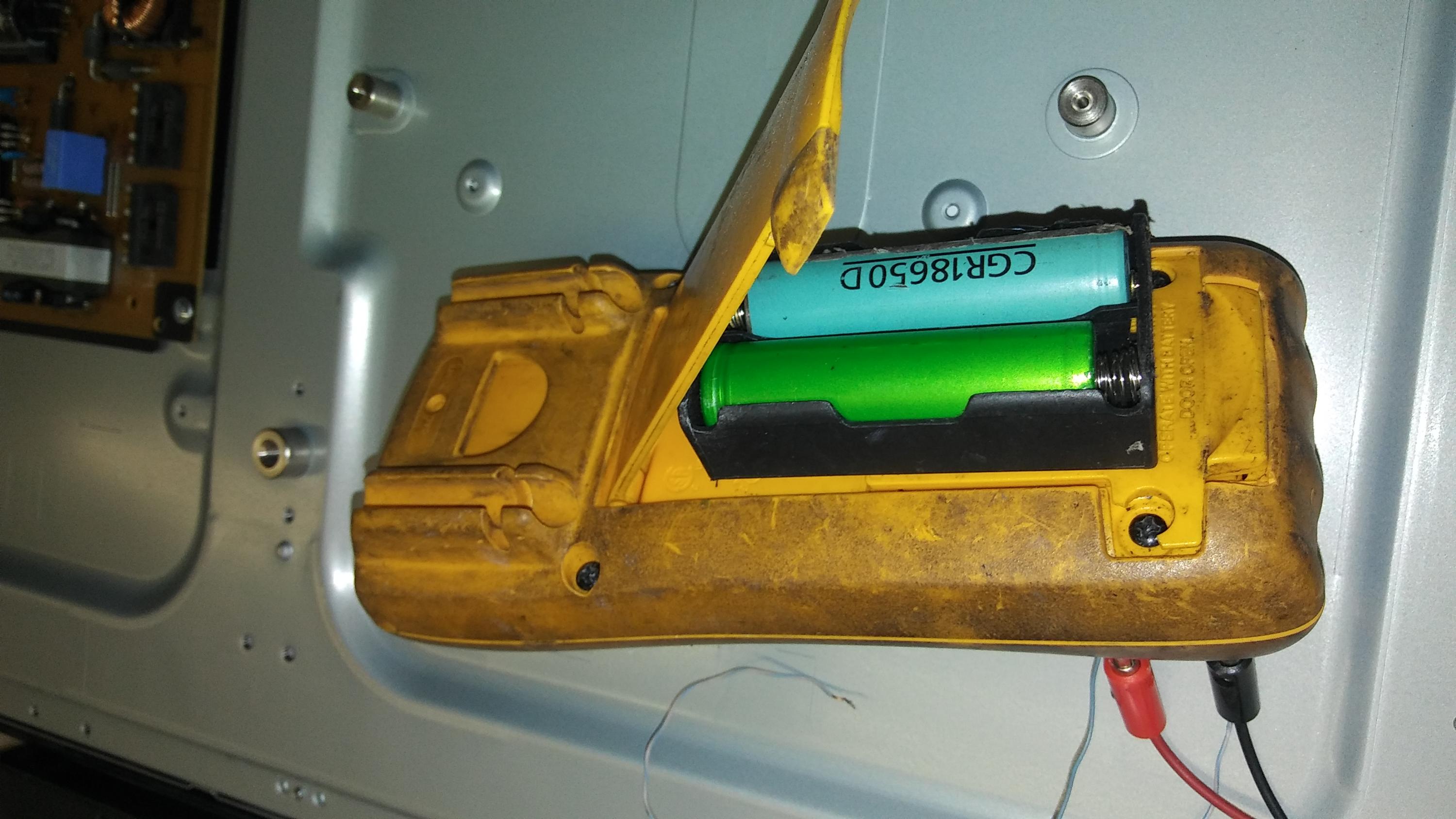

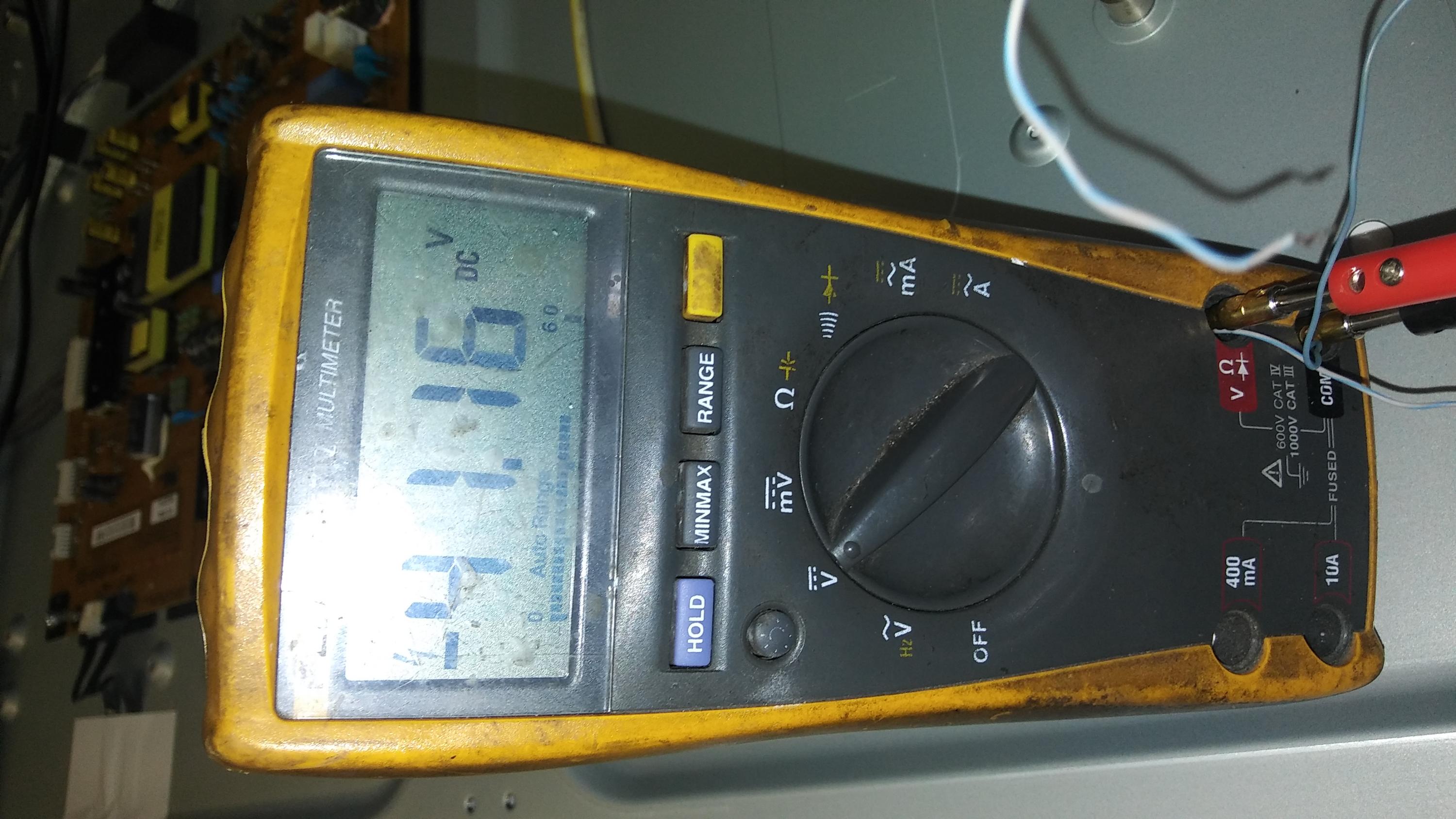

                      yes, AC capacitor was worked good but not enough energy. i need to add more capacity or raise up the voltage.
                      One thing very strange is i measured charged capacitor which has no AC output only has DC around 80v then slowly drop down the voltage? why?
                      Does the capacitor has the same rectification function as rectifier diode?
                      PS: I haven't changed battery for this meter about two years. picture 4.

                        There's no such thing as an "AC" capacitor, just a capacitor that won't blow up with AC due to polarization. The rectifier diode is used to convert the AC to DC, and the capacitor will charge from the proper DC.
                        These low capacity capacitors are easily discharged with a typical 1MΩ-10MΩ input impedance of a multimeter so yes they will drop down in voltage as you keep it connected (plus any leakage resistance within the capacitor, which is also a sign of a bad capacitor). Estimate with the RC time constant and you'll see why it drops visibly, quickly.

                          [QUOTE=capwizard;877277]yes, AC capacitor was worked good but not enough energy. i need to add more capacity or raise up the voltage.[/QUIOTE]
                          Or, arrange for it to be disconnected from the line closer to the peak of the mains voltage.
                          One thing very strange is i measure charged capacitor which has no AC output only has DC around 80v then slowly drop down the voltage?
                          A capacitor only stores DC. An "AC" capacitor can store DC of either polarity. I.e., some times you may find "lead #1" is positive wrt "lead #2" while at other times lead #2 will be positive. It all depends on the polarity of the charge inside the capacitor when it was disconnected from the (AC) voltage source.
                          (in theory, half of the time it will be disconnected while the mains voltage is "positive" compared to neutral and the other half of the time it will be disconnected while the mains voltage is negative. Do the experiment an infinite number of times -- for an ideal capacitor -- and the results will be 50:50)
                          No. It's just CAPTURING the charge in one direction -- or the other -- depending on the instantaneous polarity of the AC mains signal feeding it at that instant.
                          If, instead, you take eccer0r's (?) suggestion and rectify the mains before connecting the rectified signal to the cap, you could use a DC (or AC) cap and always be assured that the lead that is connected to the positive output of the rectifier would always be more positive than the other lead.
                          Additionally, because the rectifier isolates the cap from the AC line WHENEVER THE INSTANTANEOUS MAINS VOLTAGE IS LESS THAN THE VOLTAGE STORED ON THE CAP, the cap will tend to stay at the peak AC mains voltage, regardless of when you disconnect it from the mains.
                          (the voltage will gradually decay, over time, but at a much slower rate, based on the cap's leakage characteristics)
                          A friendlier circuit would include a "ballast" to limit the rate at which charge can flow into the capacitor when charging it up (yet not be present in the "discharge path" as you want maximum current flow, then)

                            Incidentally I love my Fluke 77, I got a cheap 50¢ PP3/6F22 battery in there and it's lasted YEARS so far... I think I've gotten its life out of that carbon zinc battery even if knocking on wood fails and dies a minute from now, but suspect it may still keep on working...
                            My other PP3/6F22 multimeters eat their batteries and I have to replace them biannually at best, but usually much worse, depending on how much I use it.
