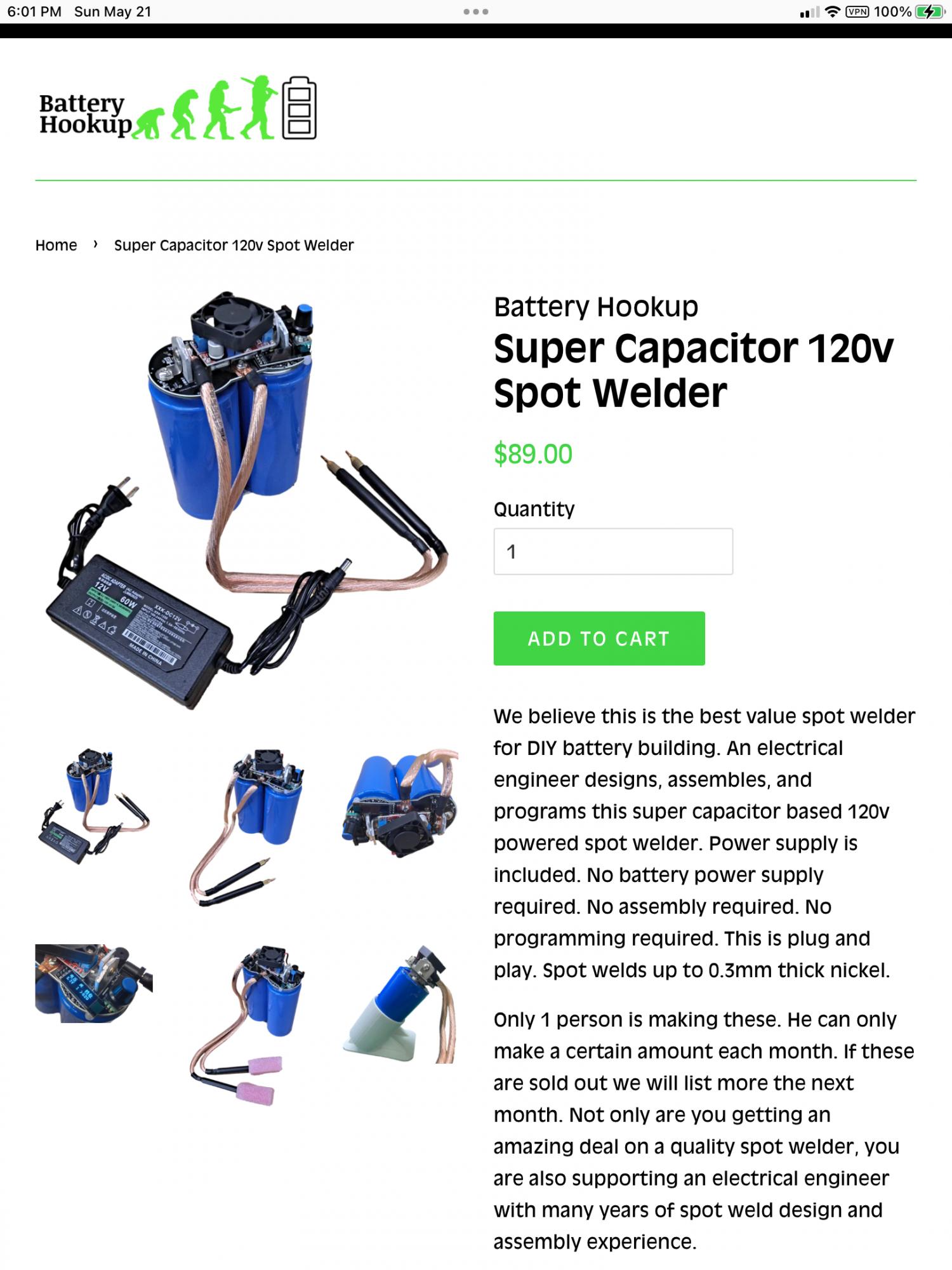

    This is a new item at Battery Hookup that I bought I have always wanted to buy a good capacitor battery stud welder but they are to expensive for my budget that I want to spend on one this was surprisingly moderate price for what it can
    It came by FedEx today so I decided to try it out on some tabbing that my battery stud welder has a little issue making constantly welded with out having to redo some because it would not get hot enough to do it properly
    Well right out the box when the super capacitor charges up with the setting as follows does a very good job the first time
    Power level set to ten the range is one to 80 however the it goes up to 120
    Time before the unit turns on to weld when the tip probes are on the tabbing is as follows
    1=0.5 seconds
    2=1.0 seconds
    3=1.5 seconds
    4 =2.0 seconds which is what I have it set on
    5=2.5 seconds
    6=3.0 seconds
    7=3.5 seconds
    8=4.5 seconds
    9=5.0 seconds
    So far I only done tabbing on two different types of tabbing that I normally use and I have not so far done a battery pack yet one note the battery cells were cleaned from the old tabbing with a grinding stone
    Here is the website link to it
    https://batteryhookup.com/products/s...0v-spot-welder

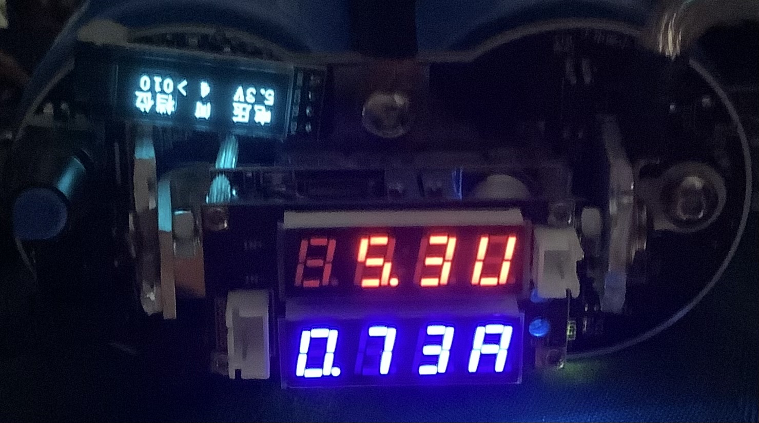

                        Update I just had to modify capacitor tab welder could not get over the fact that the mosfet was getting extremely hot and I wanted to see the charge rate for my self and the need for a fan is not necessary for the charging up the capacitor but will be needed for welding function however so fan will be mounted on the bottom of unit and it will be a temperature controlled fan unit senses i already have some of these type of fans just have to modify it as well so more to come later
                        With the current set to one amp it gets very warm I have not re-hooked up the original buck converter to see what it was set to when I re-hook it up I posted the results
                        I will have to wait until I have the cooling fan hooked up before I really start using it
                        Of course it takes about twice as long to get full charged but I am not necessarily in a big hurry anyway so this might not matter but we will see if it can keep up with how fast I want to be able tab and how well the welds come out
                        The way the person put the fan it would really only cool the buck converter ic chip and very little on the heat sink on the negative power rail I already have a small heat sink on the buck ic chip anyway

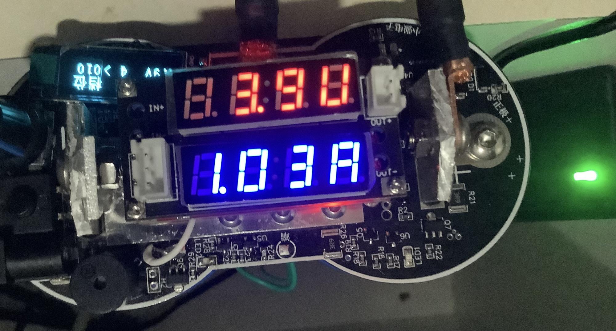

                            I finally had time to find out what the current on the buck converter was set to and it was 500 milliamperes so I am going to set it considerable lower than this so I do not have to worry about the mosfet from over heating or screw a heat sink with fins on it for better cooling ( this is the aluminum bar that runs under the current meter on the capacitor board )
                            Now I have to decide on how I am going to make the holder for the capacitors and the welding cables and tilt the capacitors so it is easier to read the very small screen that has the voltage/time in seconds/current setting yes the voltage/current meter on the buck converter is upside down to battery tab welder controller but there is nothing that I can do about it unless I want to totally redesign it and that is to much trouble to do this modification and this is not that important to me that it is upside down I can read it upside down anyway
                            I really did not need two voltage meter but it would be more trouble to disable either one so that will be the way it is
                            One note that when the voltage gets to 5.3 volts two green LED lights up to let you know that it is ready to go
                            With the buck converter it has two red LED lights one is the power LED the other one is the current LED light indicator
                            The buck converter that this person used only has one LED light that is for power it does not seem to have the current one
                            Until I solve the over heating issue on the mosfets I not going to use it because this is used to charge the capacitors and when you are doing the welding function
                            I personally think that it would have worked better if a through hole device was used instead of a surface mount device especially since it used the hole time the device is turned ON and the device was mounted on the heat sink bar instead of just next to them

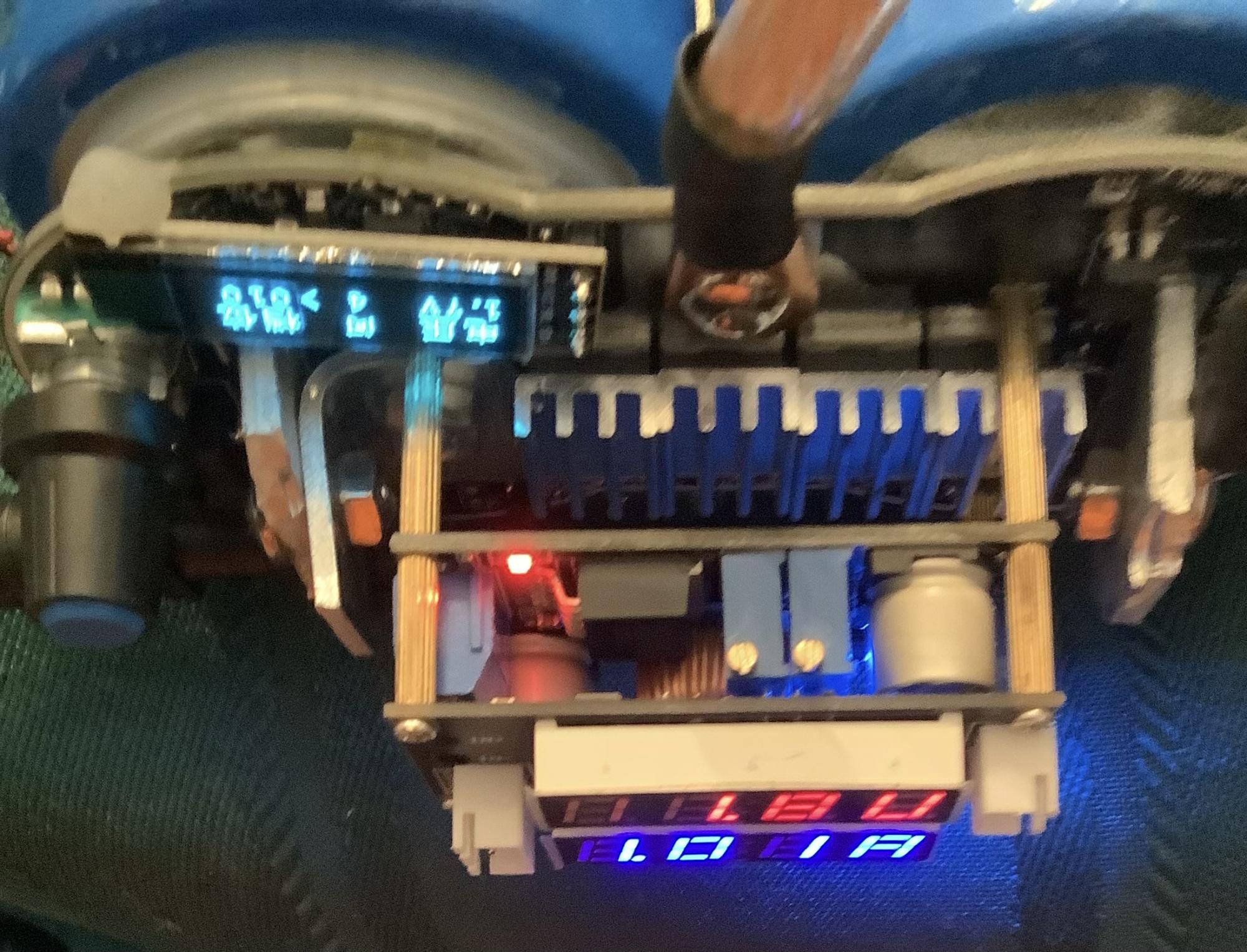

                              Update
                              As you can see in the picture I installed some tape style heat sinks on the mosfets array and this took care of the heating issue that it was having while changing the capacitors in the circuit
                              Which I am pleased with I have cranked up the current from 500 milliamperes to 1000 milliamperes and now I going to fine tune the voltage so when it reaches 5.3 volts and the green LEDs light up tell you that it is ready to use that the current goes down to almost nothing because I know my self well enough that I will probably have it on for hours at a time so that is the reason for being picky about how the voltage/current is setup

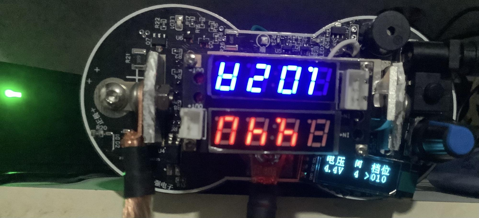

                                  There still seems to be an issue with the power supply rail when the voltage goes above a center voltage which is unknown at this point I still have a heating issue just not as bad
                                    • Jul 2011
                                    • 6023
                                    Re: New Super Capacitor 5v DC Battery Spot Welder with a 12 volt power supply
                                    The mysteries is solved to why the power rail was heating up and the two green LED lights on the board if you have green LED lights on you are bleeding excess voltage as heat to keep the capacitors from over voltage conditions and how I realized that is because I have some of exact same type of capacitors that I bought surplus a couple of years ago when I was thinking about building a capacitor tab welder the maximum voltage 2.7 volts so if you multiply that 2 you get 5.4 volts well sure enough that is what is going I was pushing to much voltage to the capacitors because the current had come down to around 700 milliamperes from 1000 that I had it set to the power supply rail was very warm but not only that the capacitors were also a little warm also this is how I put 2 plus 2 equals 4 yea I know I should have realized that earlier but did not but you would have thought that the engineer would have known this as well so I have it set to 5.2something and a current of about 40 milliamperes which just makes the two green LED lights are not on and the bleed resistor or resistors are just a little warm and if you put a incandescent light bulb on the capacitors of about 200 milliamperes the current slowly goes up to value if you leave on there long enough so I finally have it where I want it now if the capacitors get a little warm again running all night long like I did last night I will back the voltage down a little bit more so I have the voltage as high as I can with out generating heat which is just a waste of energy which is not what I am looking for I looking for fairly fast recovery from doing a weld and then doing the next weld and you have one end of the battery cell completely done and while you are going to the next battery cell you have recovered most if not all the charge that you originally had when you first started welding the first battery cell well at least that is the plan let see if this pans out or not
