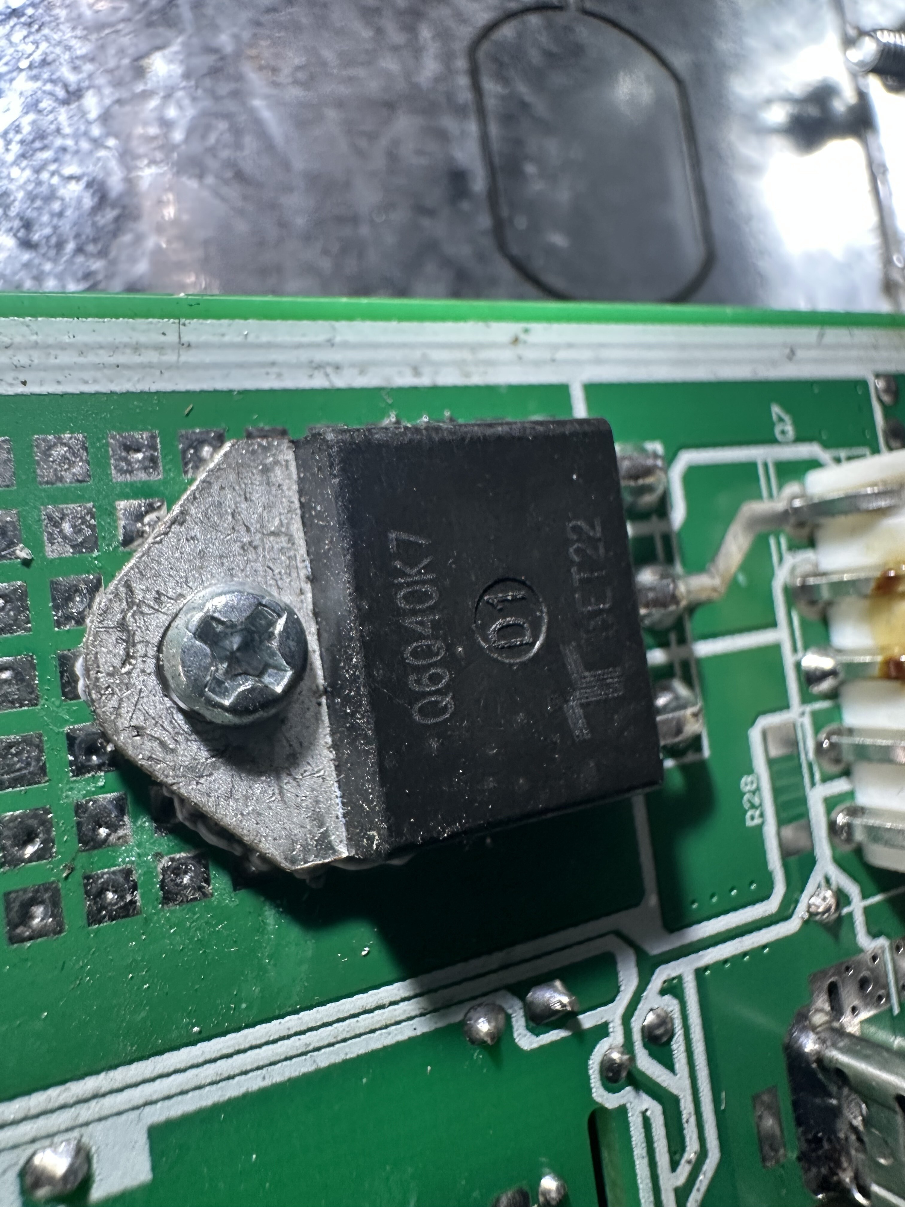

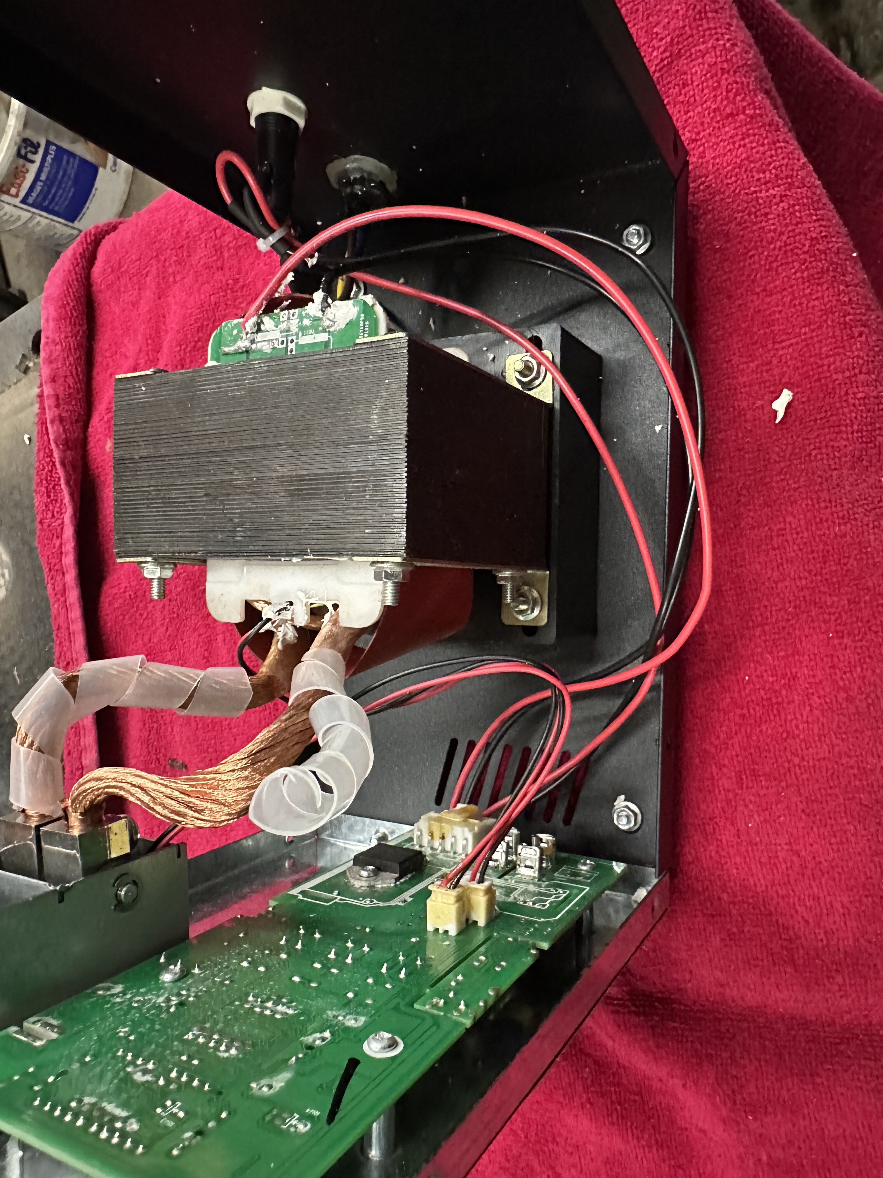

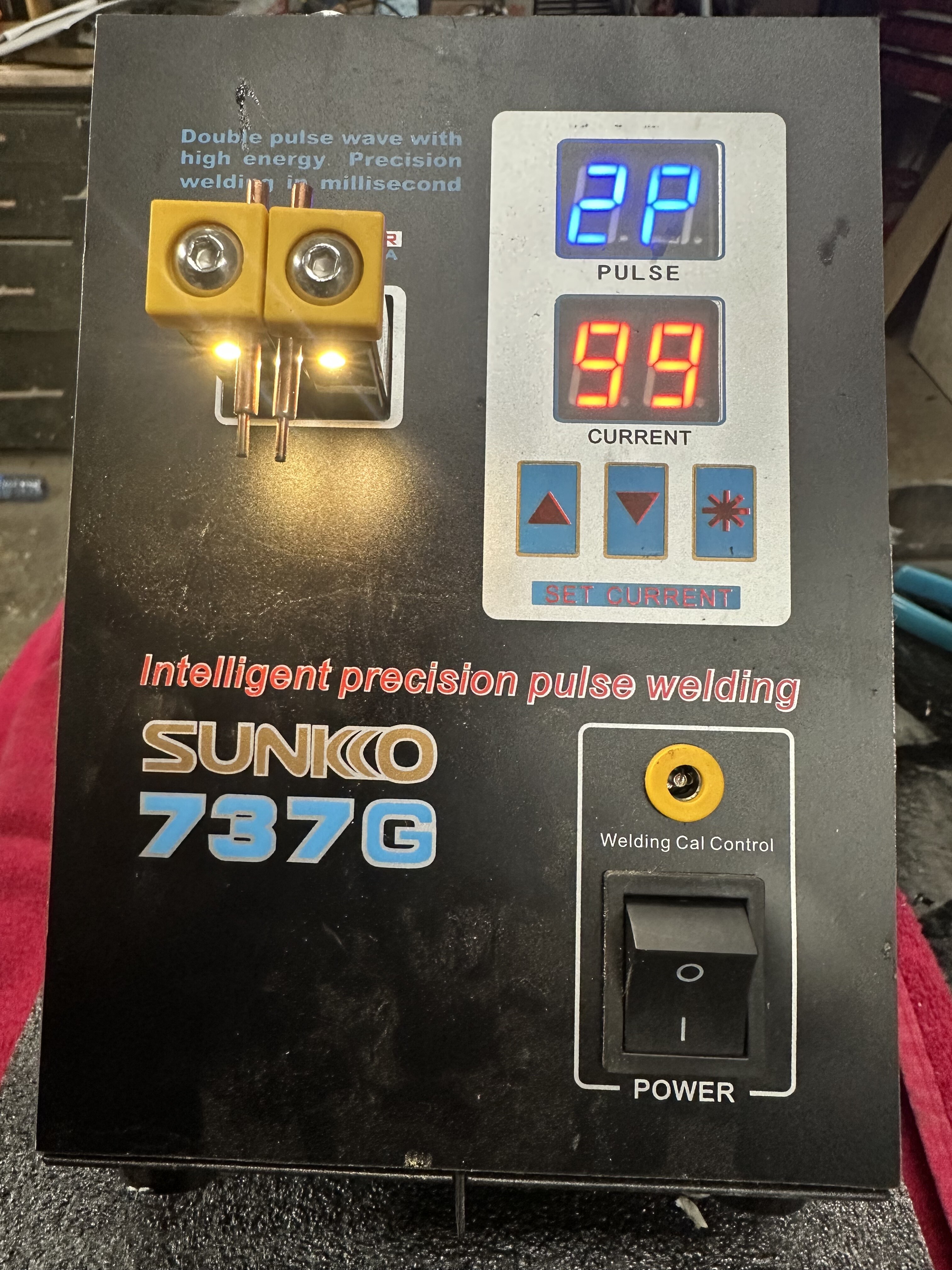

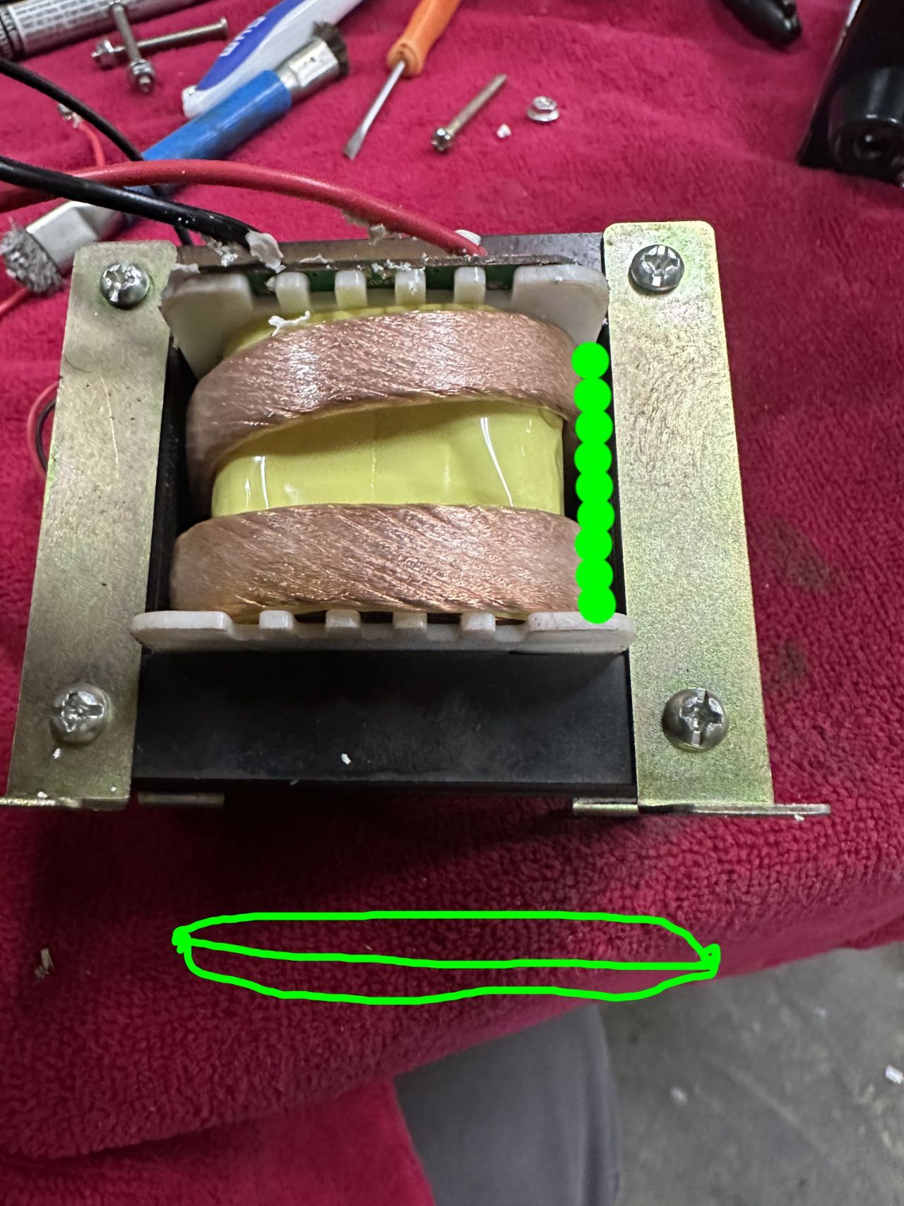

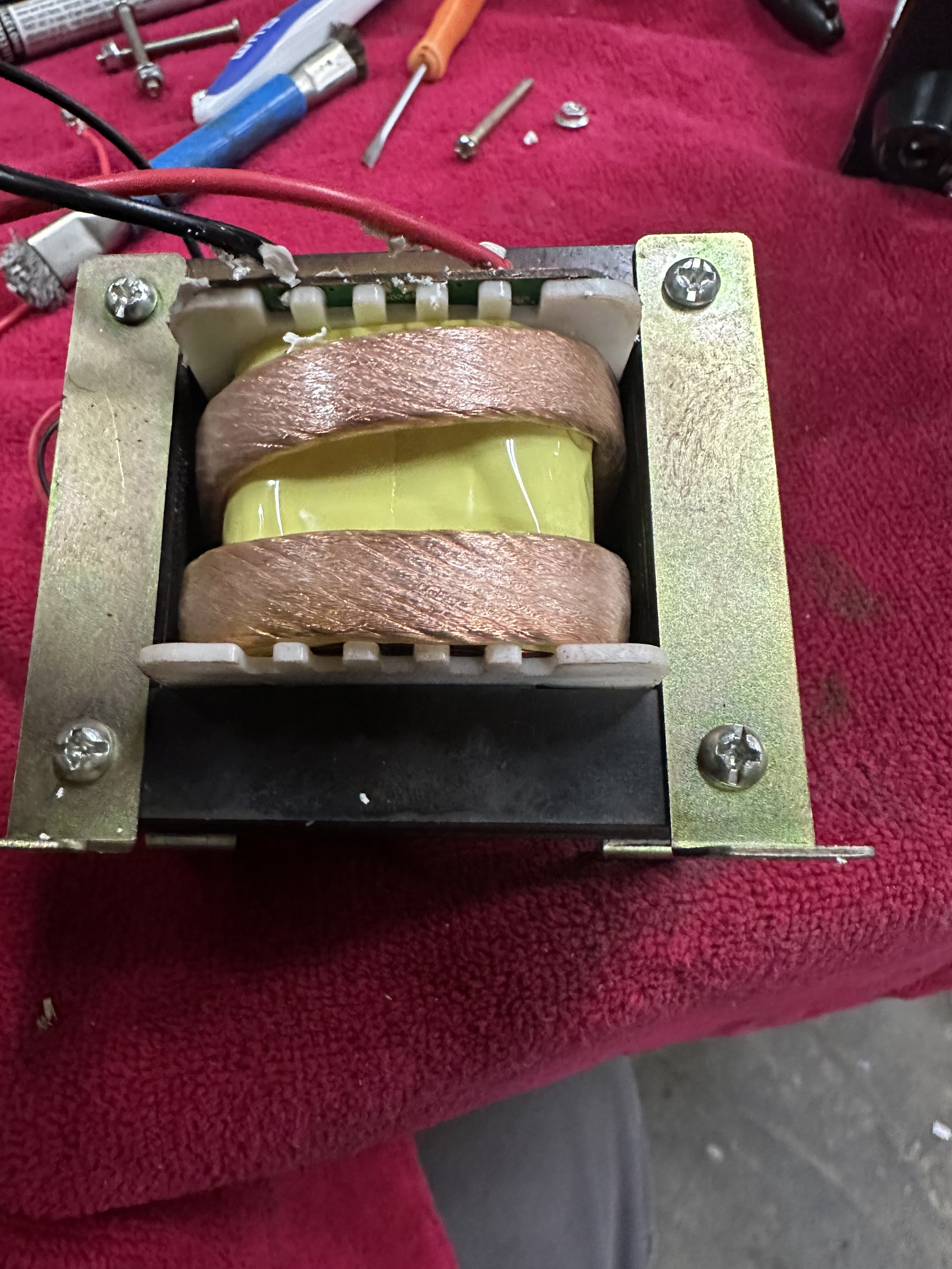

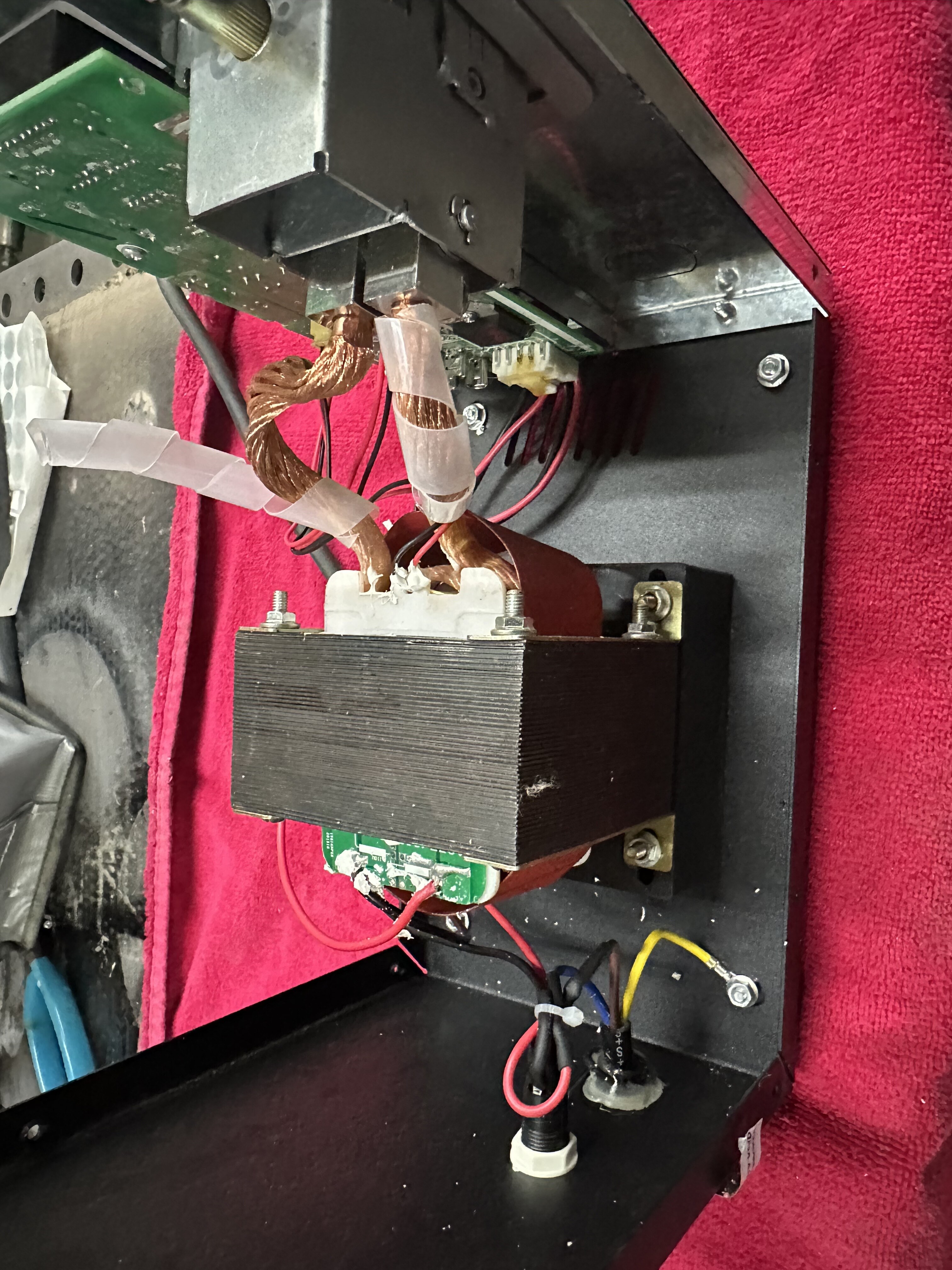

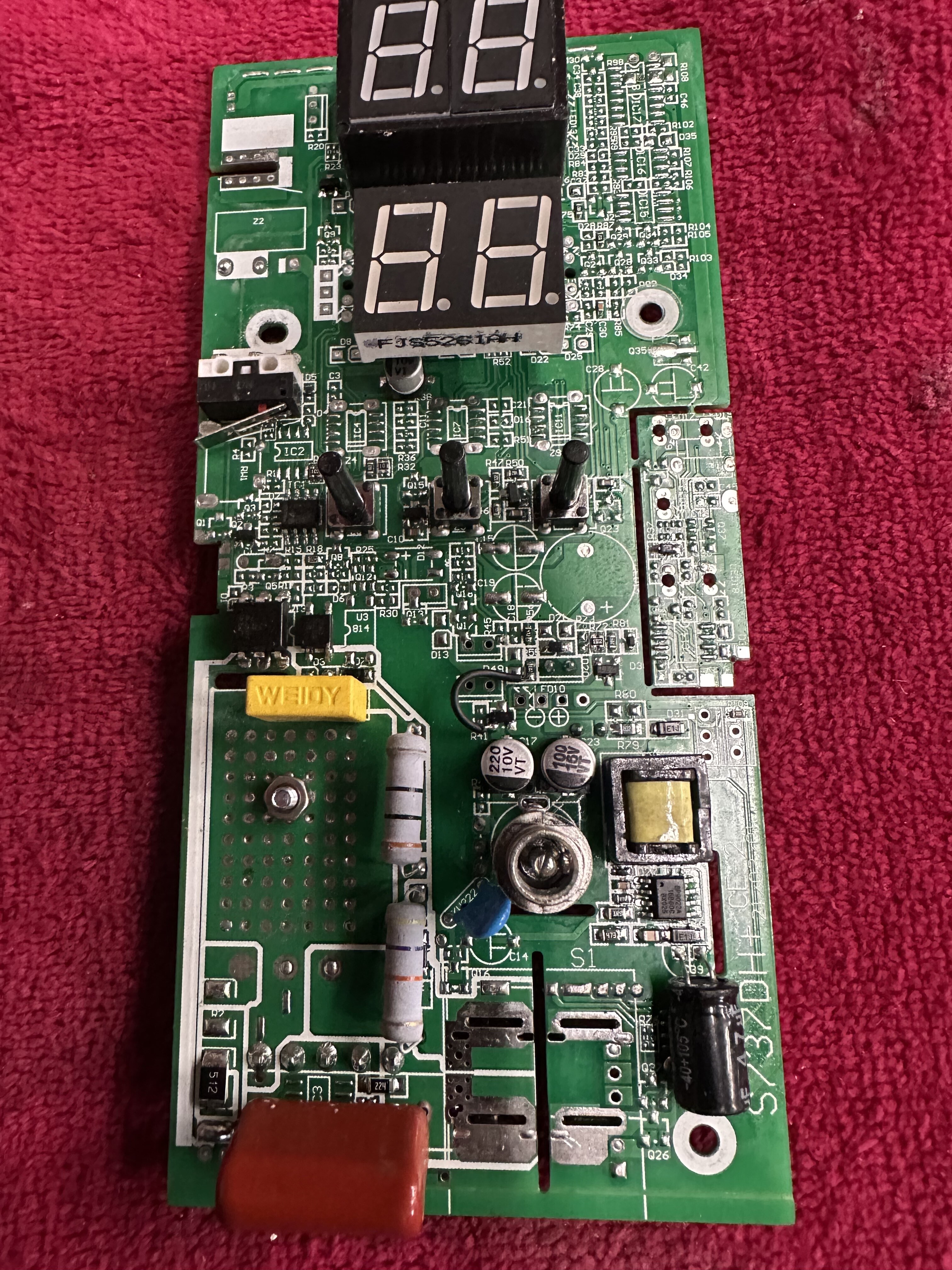

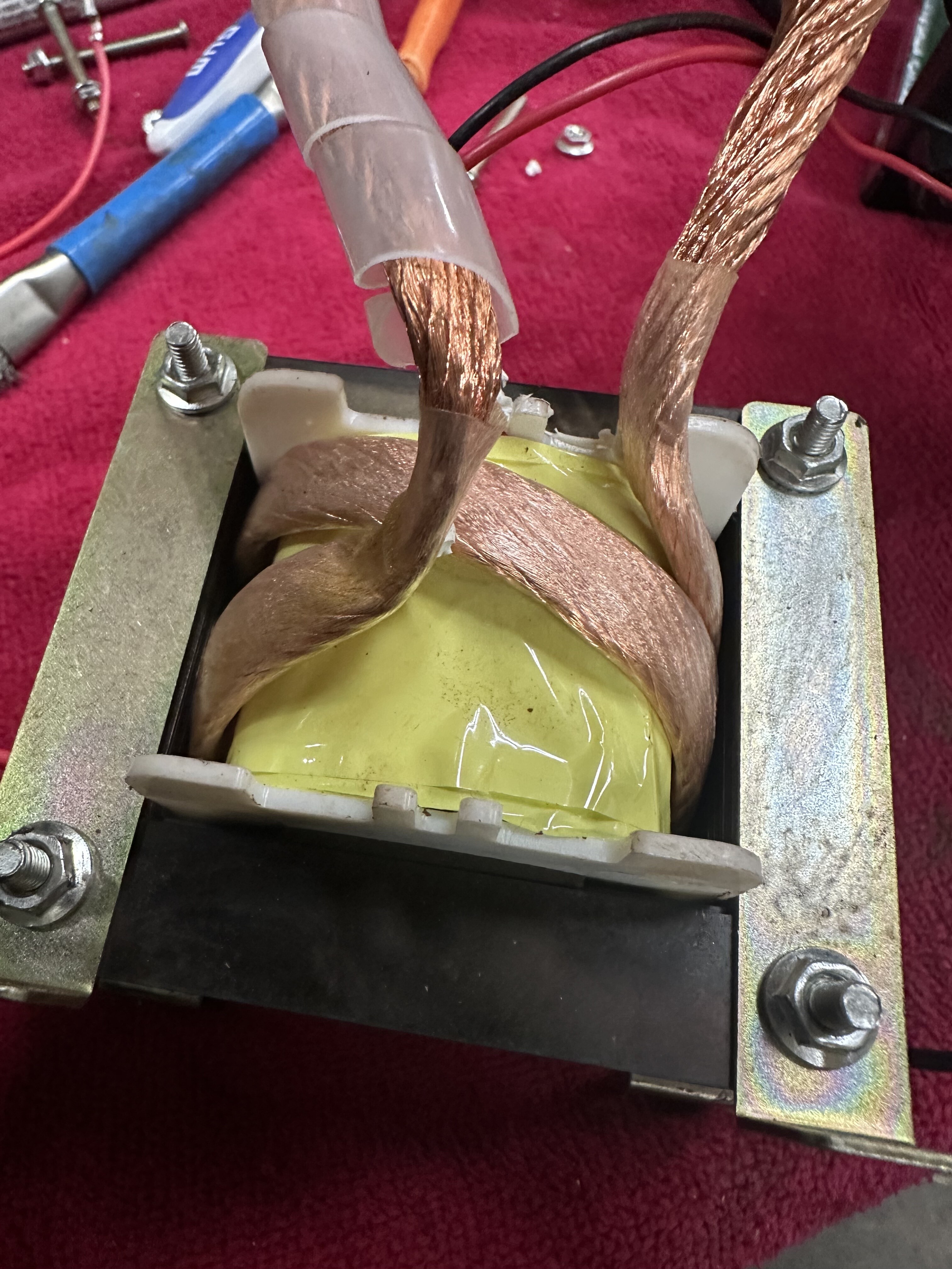

ID:	3761460 Click image for larger version  Name:	IMG_0272.jpg Views:	0 Size:	2.24 MB ID:	3761458 I bought this welder to spot weld some 1.5mm tabs onto batteries , which kinda worked , now I'm given some batteries that have 4.2 mm tabs that are found in Makita , dewalt and snap on battery packs . Can I modify it to do this ? The triac is a Q6040K7 which shows 6.3 vac and 36 amps output and don't know if it is accurate due to the short on time when foot pedal is triggered .

    the current is limited by the transformer.
    using a bigger fet probably wont change anything.
    • harp
      • Jun 2022
      • 647
      • Planet Earth
      Maybe if you can achieve a third wrap arround transformer, or change transformer to bigger. DiodeGoneWild (yt) has in detail explain this problem, 2 windings vs 3, voltage drop and power ratio in spot welder.
