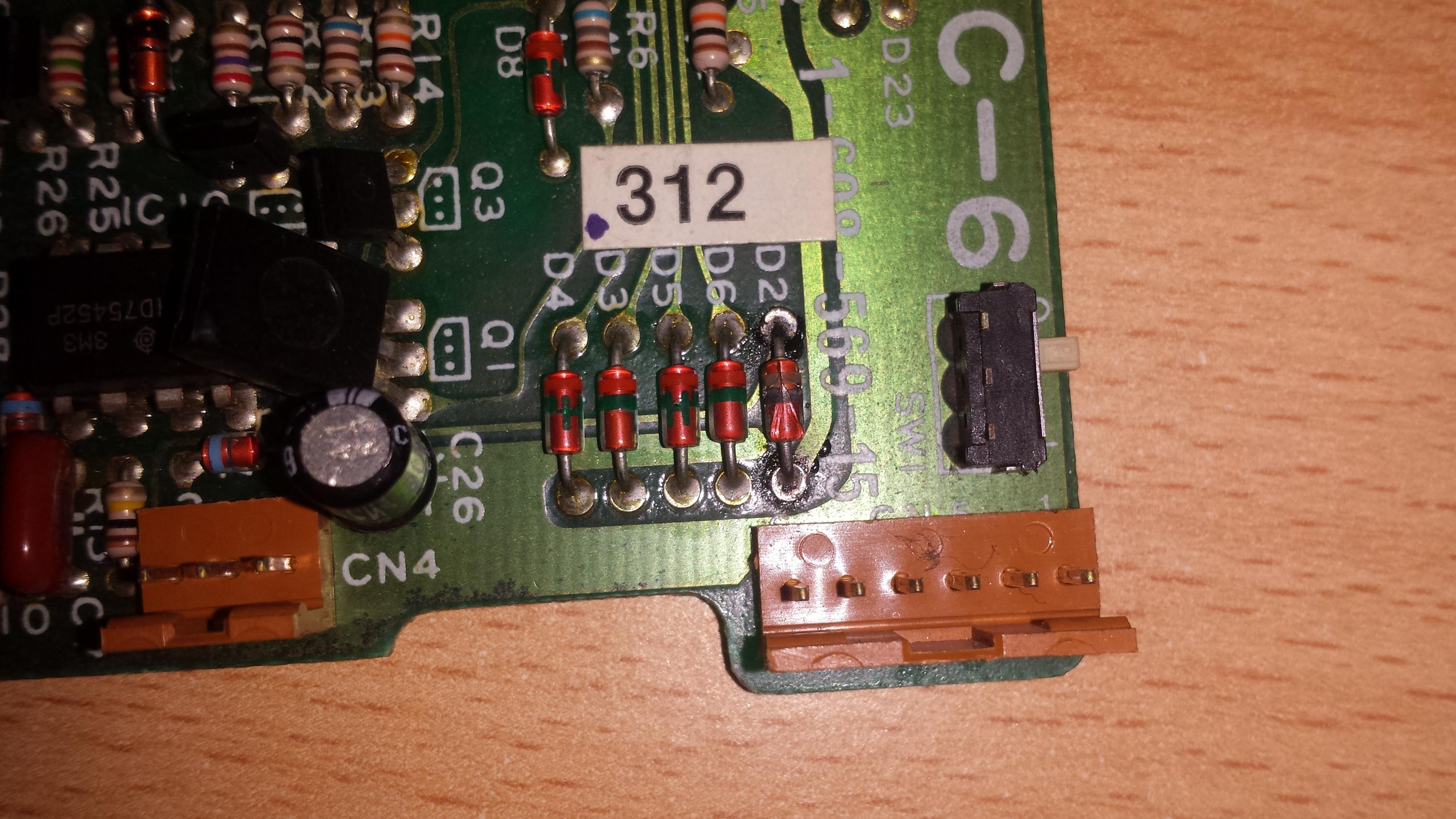

    What kind of diode is this?

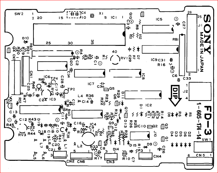

    I have a diode to replace on a computer disk drive. I had just removed the pcb to allpw access to clean out the masses of dust build up and general cleaning and read errors.
    When i put the pcb back in and powered it up I got a feint burning smell and pulled the power. After removing it again I noticed one of the wires (red) on the power connector had come out (badly crimped) and I dont know what happened but it was the only thing I could see that could have caused this (maybe it touched something).
    Anyway I could only see signs of a track getting hot and a diode discoloured. It connets to CN4 power input 12v or 5v.
    I dont know if any other damage is done but I must replace this diode now but I am not sure what type this is. It looks like a zener but knowing how many there like a avalanche etc can someone tell me please? and any advice would be welcome.

      No its actually a sony single sided 3.5" drive out of a vintage Apricot.
      These look a bit differnt to most other zener diodes so I better check. I cant see any identification markings.

          if one side of it goes to ground it is most likely a zener .

            You'd have to trace each end of it, where it goes. SN75492 or connector.
            The PCB traces are thicker than the nearby small-signal diodes.
            I would guess a zener diode probably to lower 12V to less
            A model number would help.

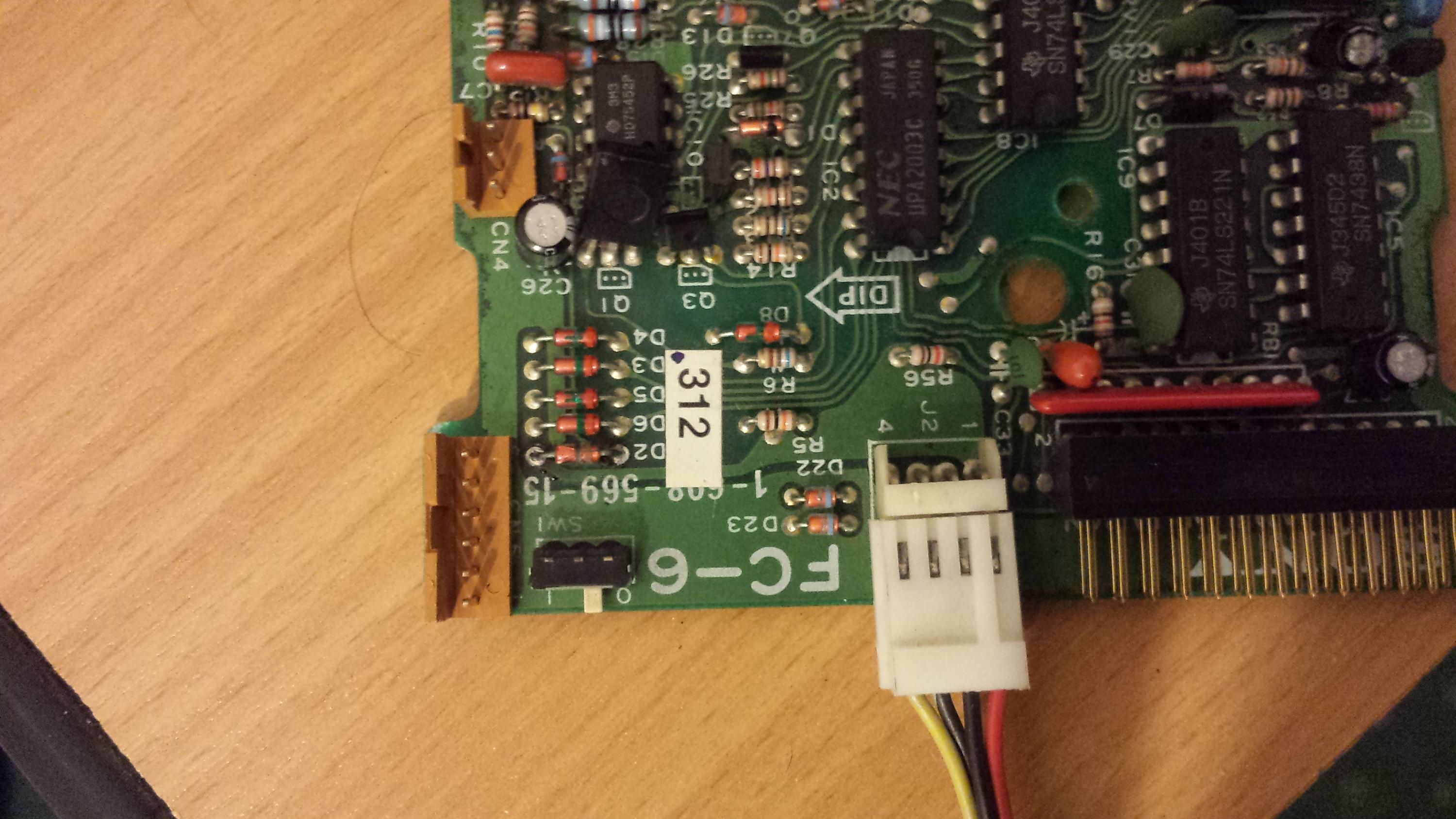

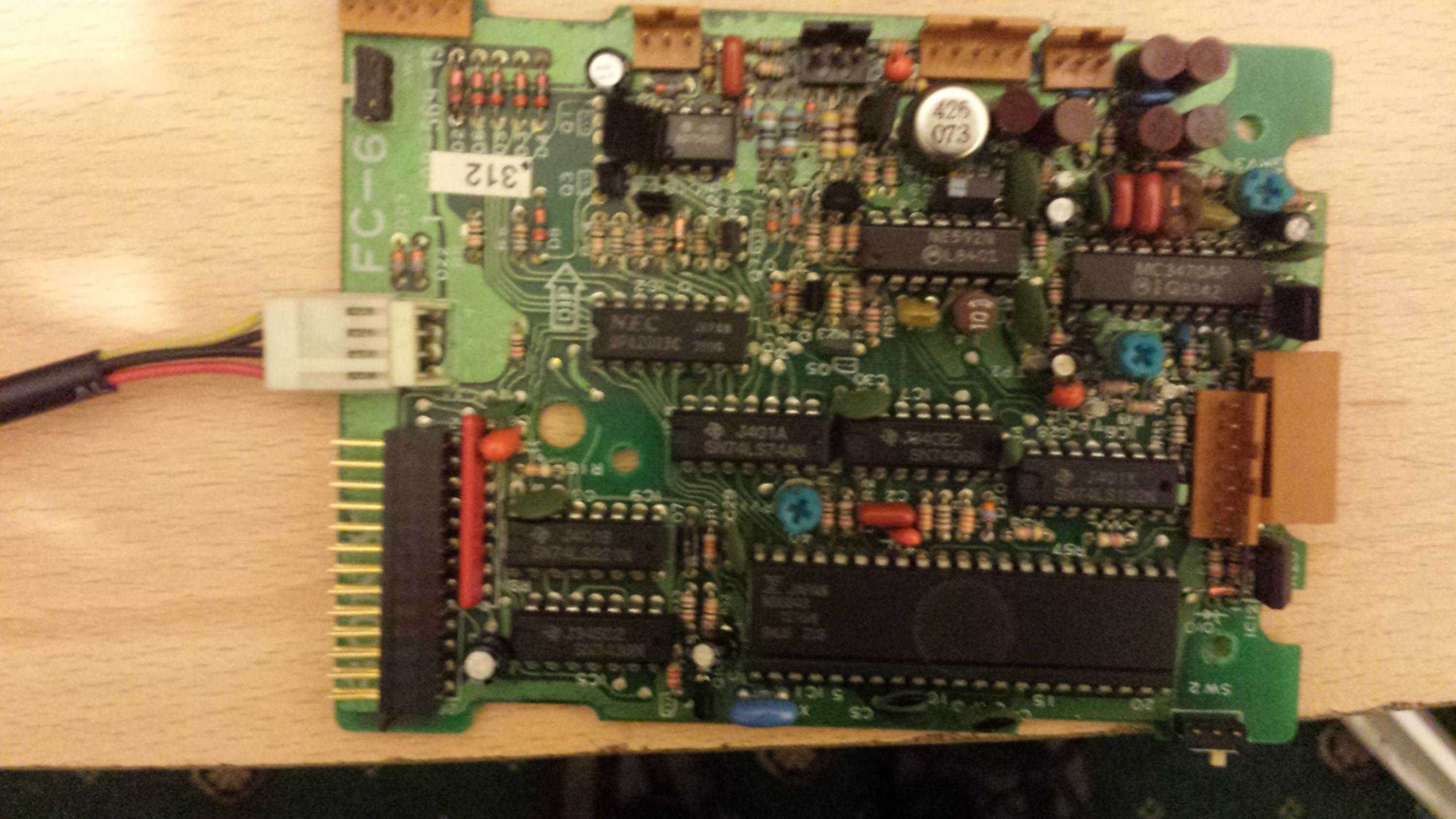

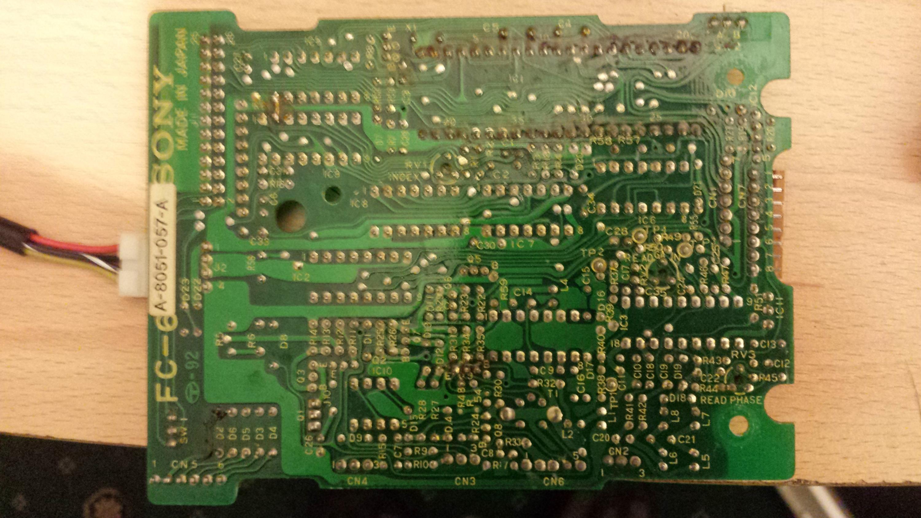

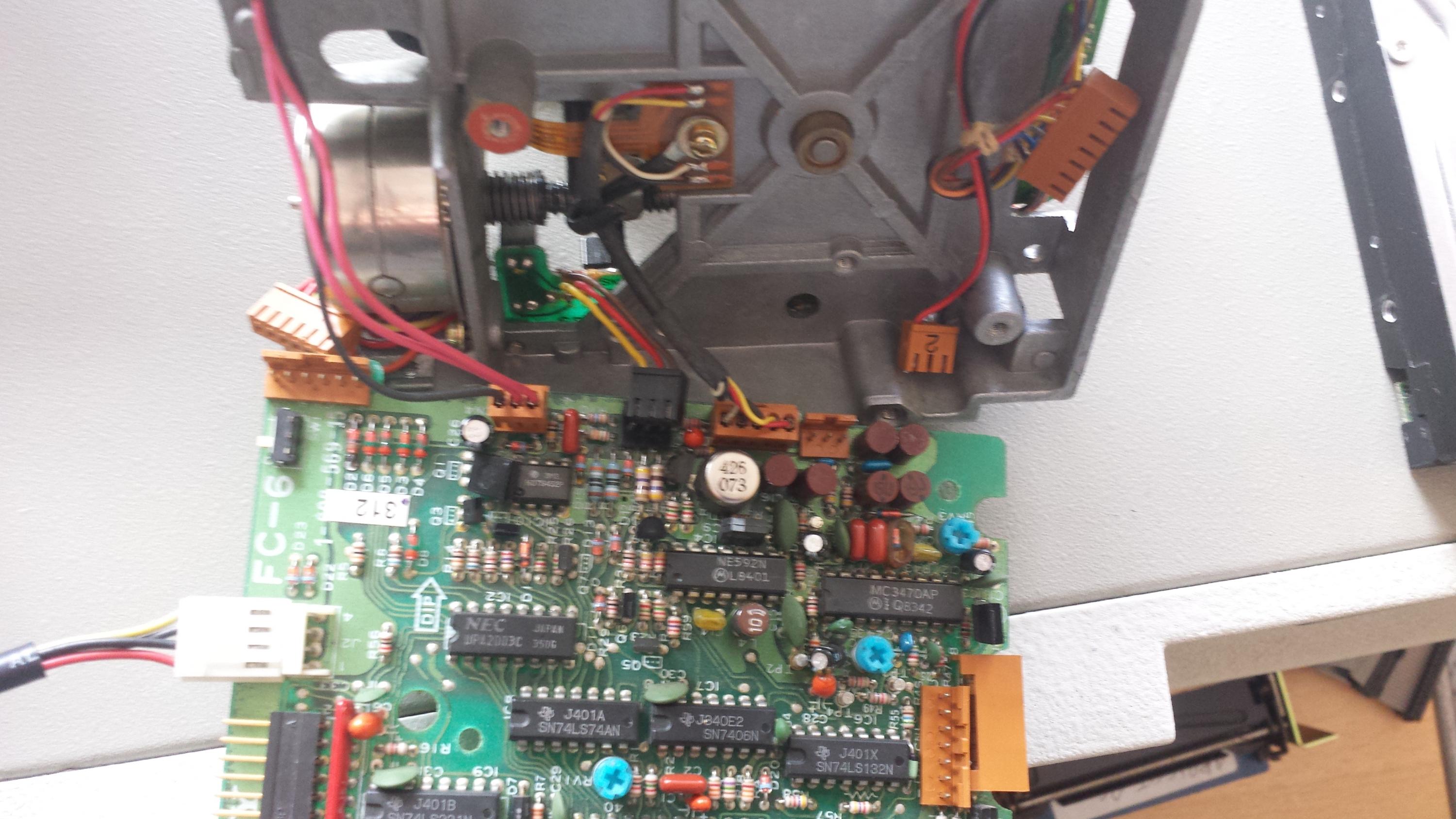

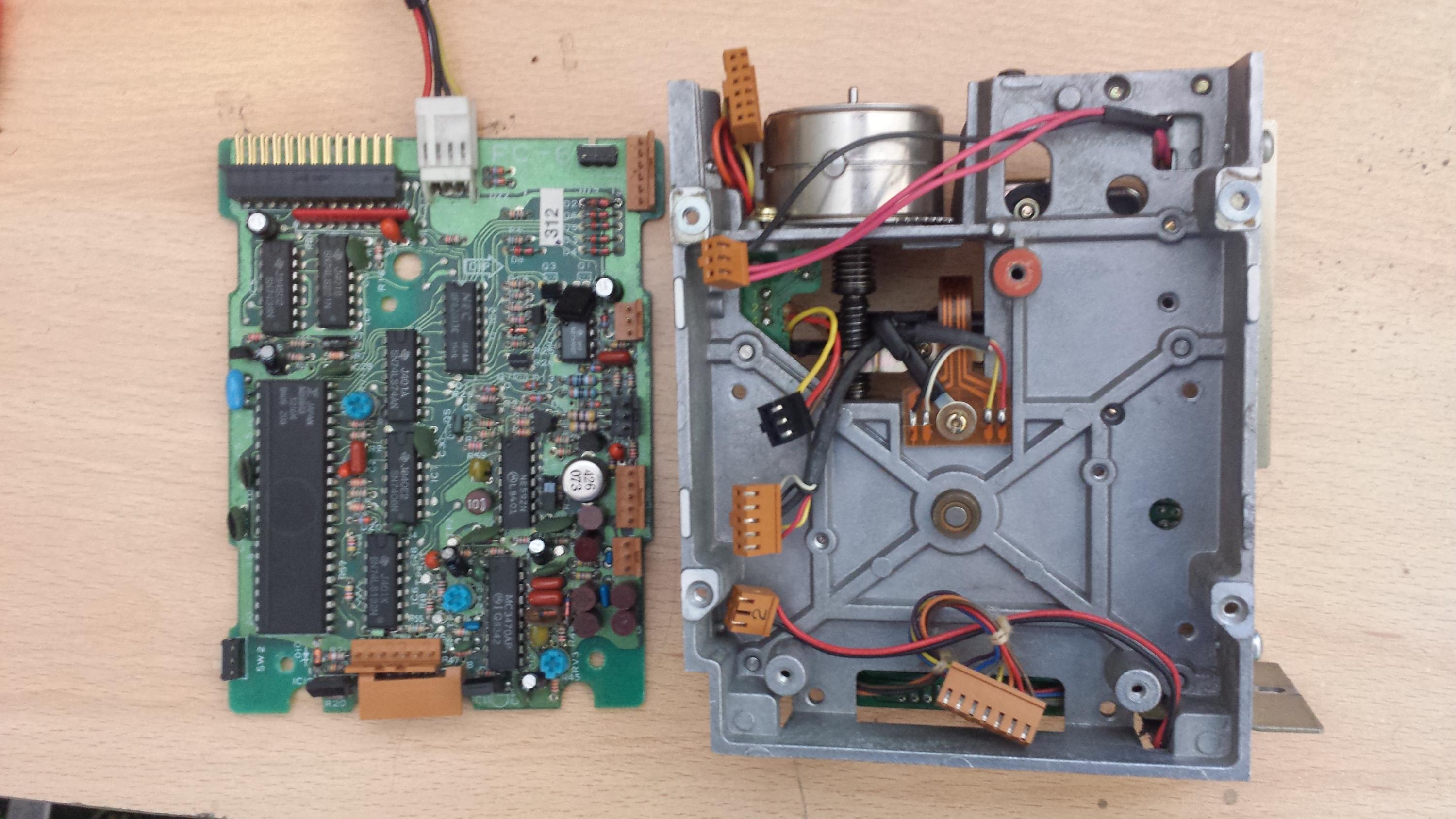

                            Here are 2 puctures of the pcb both sides to make it easier
                            Sam_sam_sam ive repaired the connector and soldered the wires to the pins (not crimped).

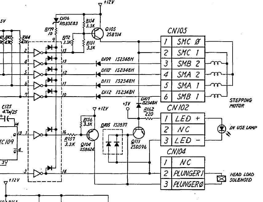

                              Is CN5 connected to the stepping motor? if it is the diode could be a D107 1S2348H as seen on page 69 of the manual

                                The drive looks like a Sony OA-D30V circa 1981, the original 3.5" drive. Used on Apple and Apricots. You have to manually slide the metal disk guard over before plopping the disk in.
                                I cannot find a service manual or schematic for it, to see what D2 does.
                                Sony OA-D30V OEM Manual
                                I notice the FD-3 PCB silkscreen shows a zener symbol for zeners like D1, D10 but D2 is an ordinary diode symbol. One end connects to CN5-2 and CN5 seems to be internal connecting to 12V head stepper motor.
                                On the OA-D32W schematic, assuming a similar circuit, it would be D107 (1S2348H 65V 0.75A high-speed switching diode) on CN105, so the diode there goes between +12V_switched and +5V.
                                To smoke this diode... CN5 pin 1 or 2 shorted to GND, stepper motor cable pinched?

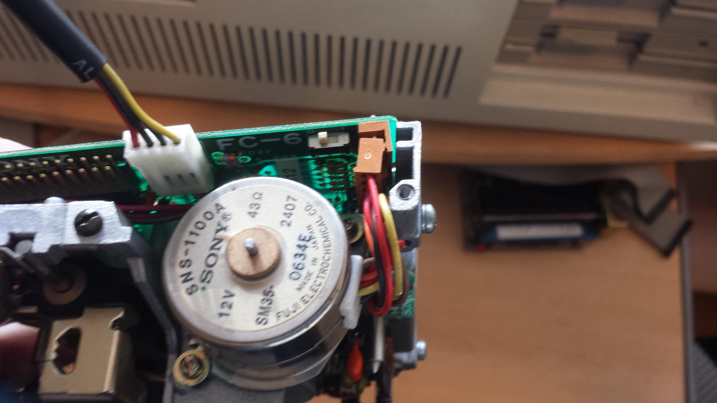

                                  Thanks i will check that although all the wires were routed and secured in a way that shouldnt be possible but recently ive seen many impossibilities happen.

                                    I found the diode and ive ordered some. I stll cant understand how it got pinched. Look at pictures and you will see what mean. The connector is keyed so its nit like it could have been one pin out of line. Another mystery.

                                      Maybe someone pressed CN5 too hard and physically broke the glass of the diode. Upon powerup, it shorted and burned ?

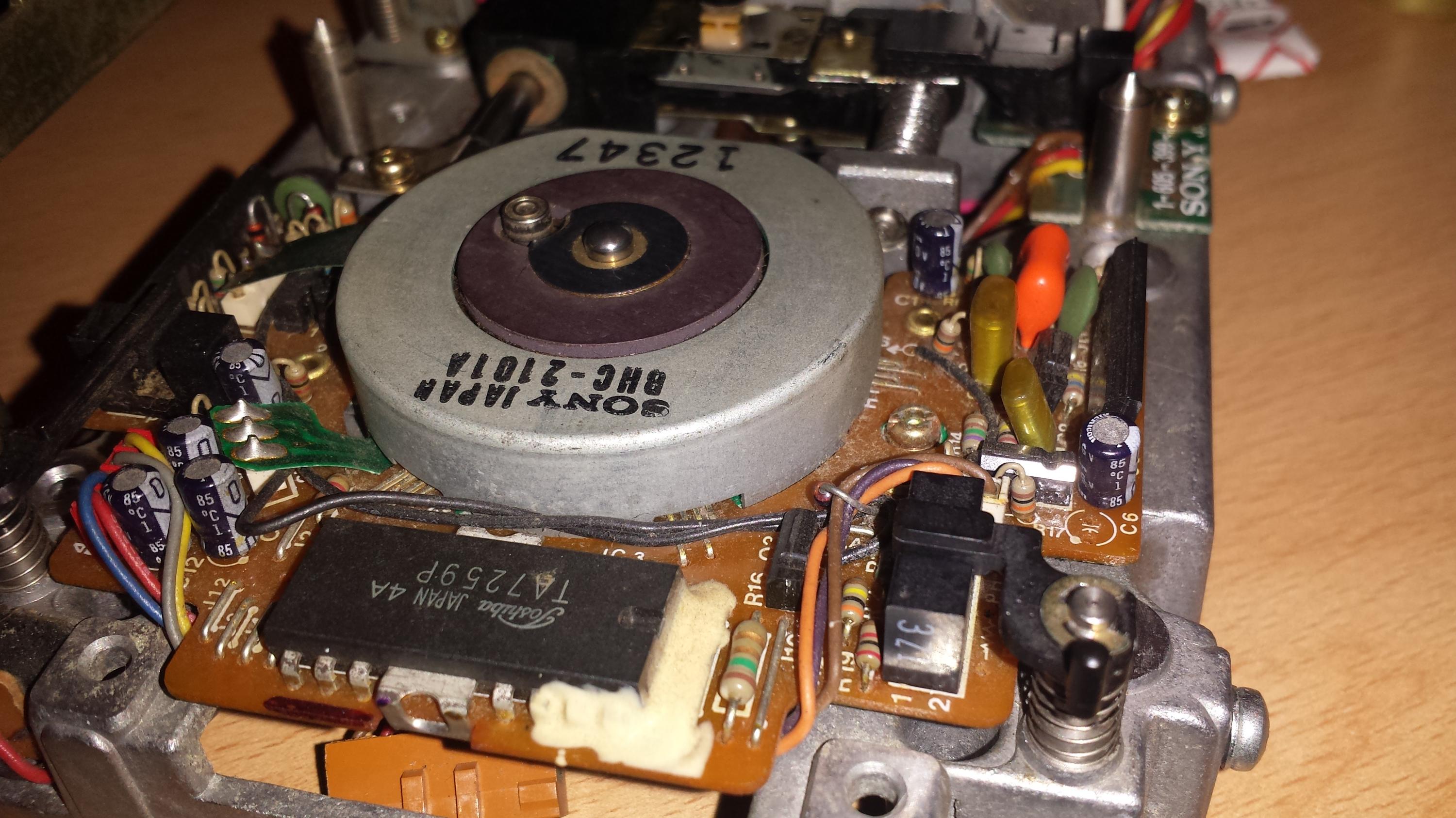

                                        I am still waiting on some of those diodes coming but I noticed another problem with tthese disk drives that I will need to ask your advice about. I have 4 drives in total and when i restored this vintage computer originaly I could only get one car drive to read and boot a disk. Since Ive had the drives apart ive noticed that when the computer boots up and moves the heads to read the disk it also switches the power on to the drives motor (one that spins the disk) but some are not moving. One of them is but only if I give it a nuge to get it moving and it will keep spinning until I remove the power. These are brushless motors and if they are little a/c motors, dont htey need a capacitor to start them spinning? )lioke a a/c induntion motor).
                                        There are some really tiny caps on the circuit board near the motor but not sure if maybe I need to replace them and where I would even start to look for capacitors that small. Whayt do you think? here is a picture.
