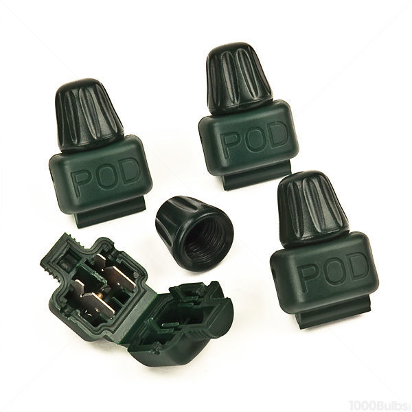

    I'm watching this video on something called the LED Keeper: https://www.ledkeeper.com/4-minute-d...ration-videos/
    At around minute mark 1:24, they show how the LED Keeper can power an unlit section of a string, once a bad bulb is found.
    You plug the string into the LED keeper instead of the AC receptacle. You find the wire leaving the bulb and put the LED Keeper on that string. You pull the trigger and it punctures the wire, lighting the rest of the string.
    Does anyone know how this works in theory? I was under the impression strings are usually wired in series. If you're by-passing any bulbs, essentially removing them from the circuit, wouldn't that increase the voltage drop across each bulb and wouldn't you risk burning them out?
    Thanks!

      All it is is a led tester, it will locate the defective lamp so you can either replace the bad lamp or replace the bad socket (PODS) it does not bypass the circuit.
      It is similar to those led testers for backlight led testing

        yeah pretty simple constant current source and insulation piercing solution, should only work with LEDs as it can't source enough current for incandescent bulbs.
        It looks like it uses those "pods" to short out (or rather use a 33 ohm resistor) opened sockets/LED bulbs. They could have gone one step further and "pod"ded another LED there, but chances are it'd look different and people would rather a dark spot than some weird looking LED?
        I was hoping it was doing some inductive/RF method to find breaks in the circuit, but nonesuch luck, vampire testing through insulation is unacceptable to me...
          I was wrong

            Those pods don't look like LED replacement sockets to me. I think eccerr0r is correct, and it's just a "dummy" load with no LED.
            I'm more interested in how the device works when it powers a previously unlit section of the strong. It pierces the wire after you find a bad LED, but let's say there's 4 LEDs before the pierce on that series. To me, it seems like it's changing the circuit, by removing the lights before the pierce from the string from the circuit.
            Is that not what's happening?

              that's what it looks like what it's doing, just generating a, say, fixed 1mA current source and the pierce will complete the circuit when the original LED could not, breaking the circuit, because its die bond or socket broke.
              Pretty primitive I think. I just wonder how many volts max it will generate to light strings of LEDs, that's the trick...

                  I guess I was wrong, they are just resistors not replacement sockets. I'm sure they could have made a socket that clips on the same way.
