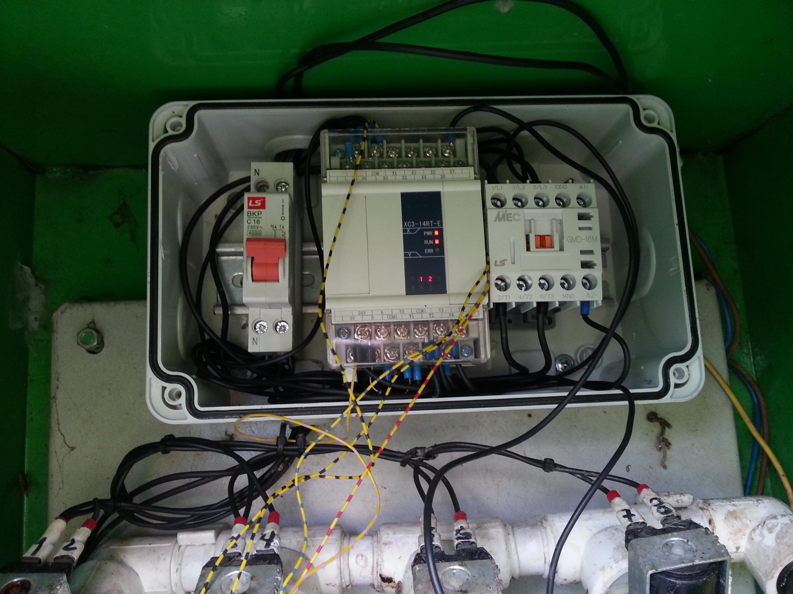

      The pump motor looks wired as Wye (star) because there are two Neutral wires leaving the terminal block. It's just one speed.

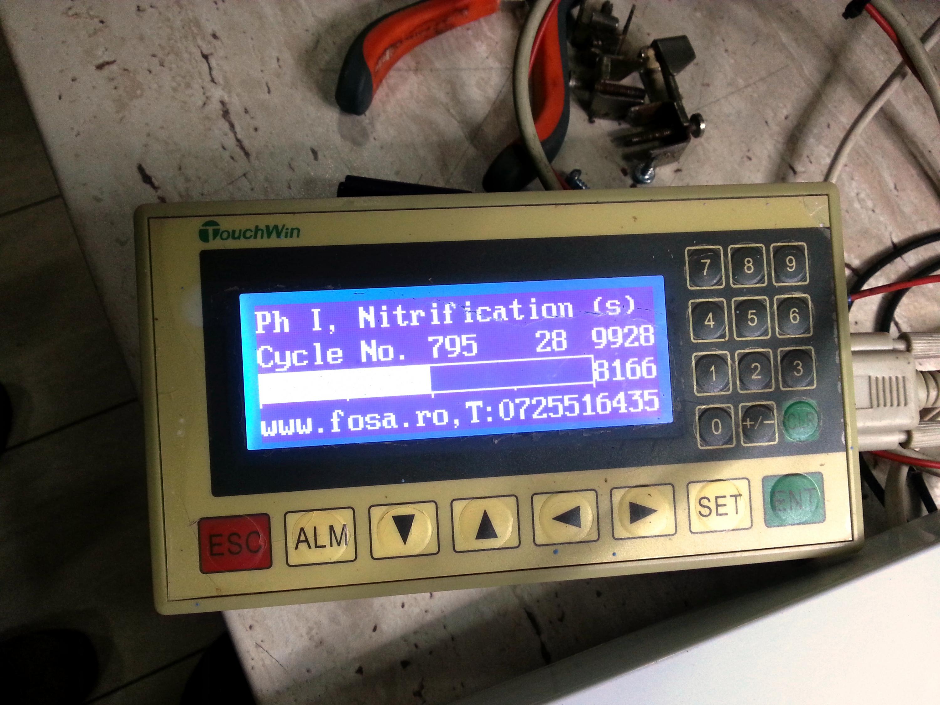

                        Ok guys, believe it or not, after almost a year, this PLC project was rebooted: Big Boss obtained the much sought-after maintenance contract for these water treatment systems I wrote about in the first post, so I was once again appointed the unofficial automation "engineer" for them, with my job being to inspect the PLCs and related electronic components and ensure they function as they should, as well as to analyze their working principle in detail and decipher all their functions.
                        Somewhere in the last week, we managed to visit all of the filter stations covered by this contract, which are scattered around the county in several key points along the canal, and we pulled the control boxes housing the PLC and contactor out of two of them which upon first glance appeared totally dead. Thankfully, out of the 11-12 total stations listed in the contract, only 3 or 4 are "smart" ones and have some form of automation, while the rest are "dumb" ones, manually controlled by a couple of MCBs in place of a PLC - no electronics whatsoever.
                        We brought the two PLCs and keypads back to the shop to clean them and work on them, which is the only way it could be done, because when dealing with a lot of unknowns like this, the only sensible way to work is in a shop, on the bench, with a reasonable amount of tools and equipment readily available, because if you're literally out in the middle of nowhere under the hot blazing sun with only a laptop trying to diagnose some random piece of equipment you've NEVER seen before that's sat outside for the past 4-5 years and appears dead, you'd have quite an unpleasant challenge on your hands...anyway.
                        Short-ish version so as not to bore the more eager of you how might not be willing to read through my walls of text before getting to the actual issues I've encountered, so: I was not able to connect to the PLCs using a CH341 USB to Serial adapter, neither with a PL2303 adapter. I had hoped it would be a simple matter of connecting the TX/RX pins correctly between the two and the "XCP PRO" software would connect to the PLC just as it would via an on-board COM port, but it didn't, even after hours of trying. While the COM port corresponding to the serial adapter did show up as COM X in XCP PRO, it couldn't connect to the PLC and Putty showed no activity either. The same held true for the other adapter, which has an actual DB9 connector at the end. The only way I was finally able to connect to it was by connecting it to the onboard COM port directly and only then did XCP Pro managed to connect.....all seemed fine and dandy except there was one huge issue which put a stop to the whole show: the PLC is locked with a password Fail....so that was that. It's currently on hold till we either manage to get hold of this password somehow, which is borderline impossible after all these years since these have been deployed and have gone out of warranty, or program a new PLC from scratch, "blindly", based on our own ideas of how it should work based only on what we can see on the functional one. What could be causing this ? Are there various "types" of RS-232 ? The only difference I can see is the different voltage levels: an on-board COM port can swing anywhere between -10v and +10v, whereas an USB adapter cannot do that. It can only go as high as 5v/3.3v...
                        More details:
                        Both PLCs power on and do something, when I say "do something" I mean there's some LEDs that come on to indicate the status of the relay outputs and the external contactor clacks on/off at seemingly random intervals. One of the keypads is dead and powers on with only the backlight and a blank display, while the other is fine. When hooked up to the PLC with the serial data cable we also extracted from the site, THIS is what showed up. Obviously some parameters pertaining to the water down in those tanks I talked about, like the current operation being "nitrification" (maybe mixing some compound with the water), some countdown and other stuff. It's all academical really, because all I care about at this point is the PLC system working - the chemistry and physics behind it all is of no concern to me, plus we weren't provided with any in-depth documentation anyway, so we have no way of determining what all those values represent or what they should be. Pressing the UP and DOWN arrow keys on the keypad cycles through a few more screens with even more stats, mostly counters like how many times the wells have been purged and then refilled, how many minutes the air bubbler was on, etc. how much time has elapsed since the last cycle and so on (again, not interesting at this stage). One screen in particular though was very useful in working out at least some of the details of this system, since it allows you to actually send various commands to the outputs by pressing certain buttons on the numeric keypad on the right which turn on/off corresponding outputs. What should happen at the other end of these outputs is still unknown - maybe there's some valves/solenoids/pumps that come on but we won't know for sure until we put it all back together and see what happens in the field....that's it for now. Will keep you posted.

                            Makes sense from a logical perspective, but even I find some familiar memory IC inside, which is unlikely but never mind, it's even more unlikely to find something "unlocked" to write back to it, unless maybe I copy it from an identical PLC. Our supplies department or whoever is in charge has already ordered a couple of replacement and backup PLCs and keypads for this project. It's a tall order, since with no way to pull the code from the original ones, it's going to be a long and tedious process to create my own version from scratch, like I said in my last post. It's doable, but takes a heck of a long time. The only thing that comes remotely close to hacking into the existing ones is physically removing whatever IC MIGHT store the pass key ("MIGHT" being the key word here) from a new PLC which comes unlocked from the factory, copy that and then plop it onto the locked ones, which is a bit of a rabbit hole since there are a lot of unknowns here, like what this IC is, whether or not it's readable by any of the common programmers like the CH341, or whether it lives through this whole operation and I don't end up killing the brand new PLC as well, which might be an expensive lesson.
                            As a curiosity, I did briefly remove the top cover on one of them because there's some thin wires coming out of one of the vent holes on the side of the PLC which go to a seemingly random male DB9 port on the front of plastic box that houses the PLC, MCB and contactor (see below). I could kinda suss out what these were for just by looking, but I wanted to take a peek inside nonetheless: in order to steer clear of the less common 9-pin mini DIN connector normally used to program these PLCs (hidden away under a plastic flap on the left), whoever installed them initially opened them up and ran these wires straight onto the board onto the solder points of the DIN connector to adapt to a more easily accessible and common "outboard" DB9 serial port. The construction of the PLC is pretty modular from what I could briefly see in there: the boards are stacked and interconnected with male-female headers rather than flex cables, which makes putting back together less of a hassle and less risky, though I didn't dig too deep into it to see what memory it might use and IF it's doable at all, though the idea sounds tempting nonetheless. There were plenty of chips in there, but who knows how or where the password is stored. The make and model are not a common thing to come across either, so there's little to no resources whatsoever. The only resources are pretty badly translated manuals for the PLCs and XCP Pro software, but that's about it....
                            The keypads are the worse part by far: the software used to program them is not the same that's used for the PLCs (called "XCP Pro") and after taking a brief look at it, it doesn't appear to have an option to download existing code from a keypad after you upload it, so I'll have to improvise my own to sort-of do the same things as the functional ones. The same as with an Arduino, it's "ready only" after you upload code to it, or at least I think so....

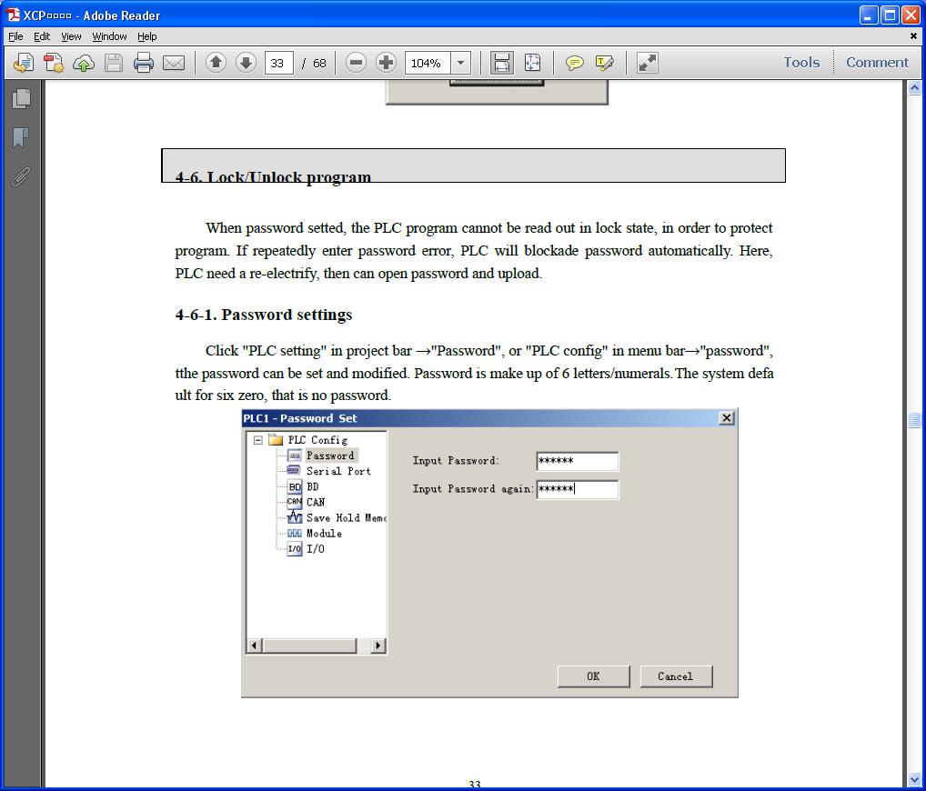

                              Did you try the default password to get into the plc (six zeros)

                                Hmmmm. I did try a couple of common default passwords, but I wasn't sure A) what length the password even has or B)what the default password is for this particular case. I can't remember if I specifically tried six zeroes, but now that you mention it, I'll try it again just to rule it out.
                                There's also a confusing menu going on on the keypad itself: if you hit the "right" arrow key on the keypad (connected to the PLC of course), it takes you to a screen where you've got "Open password" and "Close password". That sounds pretty confusing to me, as I'm not sure what exactly "opens" and "closes" here. Selecting "open password" takes you to another screen which requires you to actually input an 8-character password. The default is 8 zeroes, but upon hitting "set", it just says invalid password, so I'm not sure what that does or if it's related to the programming password XPC Pro asks for. The "close password" option does something else but can't remember for the life of me what - it just displays a message like "password closed. Press ESC to exit" and that's it. Initially I thought this locks/unlocks the keypad so you can't alter those commands, but it doesn't - the panel is always unlocked and I doubt this has anything to do with the software anyway.....
                                It actually makes sense for the previous company who installed these to set passwords and I was kinda expecting to hit a snag like this, though I kept some hope in the bottom of my heart. It makes sense to make the lives of subsequent contractors like us miserable and as hard as possible, though when handing over a project like this, IMO, it should be mandatory, by contract if anything, to also provide full unrestricted access to all of the systems which are now outside your control and ownership...in other words, don't troll those who come after you >_>

                                  The password I was refering to is for the connecting with the PLC using XCP software, It's password length is 6 charactors

                                    From what I saw by playing with the software, there's two places where you can type a password: in the menu you're showing which apparently SETS the password, but also there's a message box which pops out whenever you hit "download program from PLC", which you can't see because you haven't got the actual hardware. Without it, it refuses to download anything.
                                    There's also the matter of that "secret upload" option. Reading through the manual, as far as I could make out, it's some sort of "write-once" option, possibly separate from the whole password deal entirely, so it's like the ultimate lockdown feature which prevents any subsequent operations on that particular PLC....the broken English makes it quite difficult to understand.

                                      I see the broken English is hard to understand also. I just thought if you tried to upload the software from the plc to the pc, it is possible they left the default password, I'm not sure about the decryption setting
                                      I see there is also a password for the op series display, These will likely be different.

                                          That's right: the display unit ITSELF may be password protected, though there's no way to retrieve the programming from it anyway, so it's not too critical ATM. The PLC is the business end.
