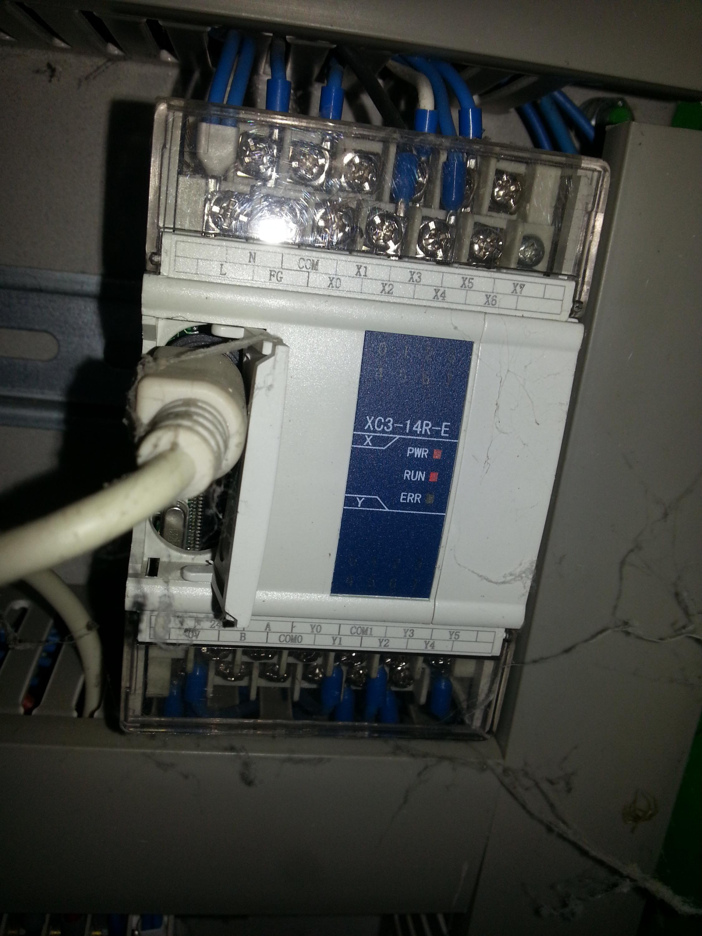

                  ATM I'm trying to focus strictly on the task at hand, which is deciphering this exact hardware and how it's programmed, because there's still a lot of stuff going on beyond that seemingly simple user interface. Not having any experience in the programming field (remember, I'm a translator by trade, technically speaking ) it's a very steep learning curve, bits and bytes and junk and stuff....the relatively broken English (though I've seen worse), doesn't do us any favours here either, but now I'm being picky and blaming others for my own incompetence....

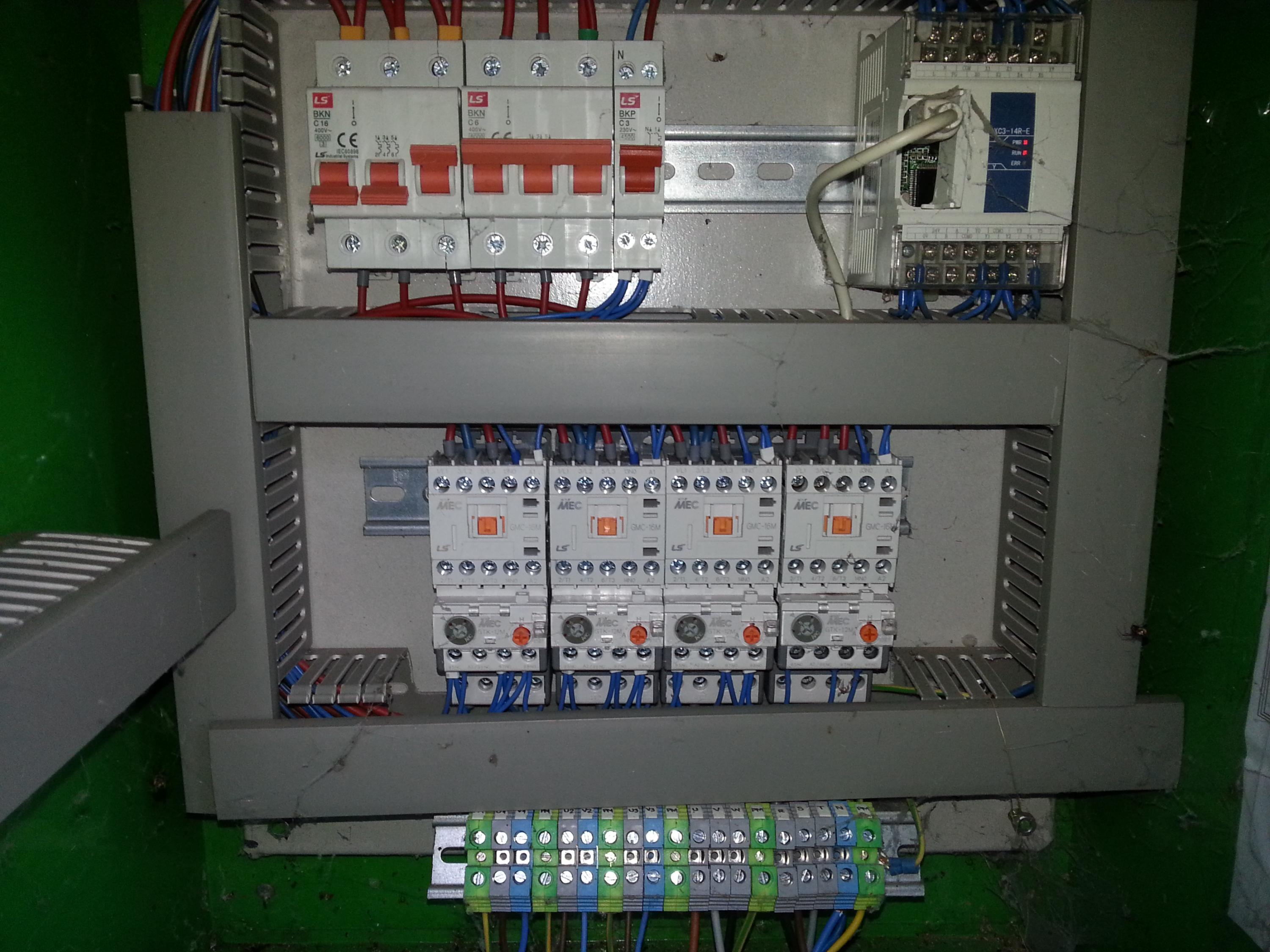

                            Originally posted by Dannyx
                            You can also see in the upper left hand corner two of the MCBs for the three phases had tripped from an unknown cause, even though I could hear the compressor placed directly below the box pictured still whirring away somehow
                            A couple of things to check one is the over loads working correctly check each leg on the contactor to make sure that the amperage are very close if they are not very close look at contacts of the contactor and make sure that they are not pitted
                            One last thing is to use a mega-ohmer to see if motor winding are not shorted or leaking voltage to ground if the reading are not in the good to very good this can cause all kinds of problems
                            One last thing is if the controller is shutting down the motor can also happen
                            Or is the controller particularly bypassed which is maybe why you hearing it run

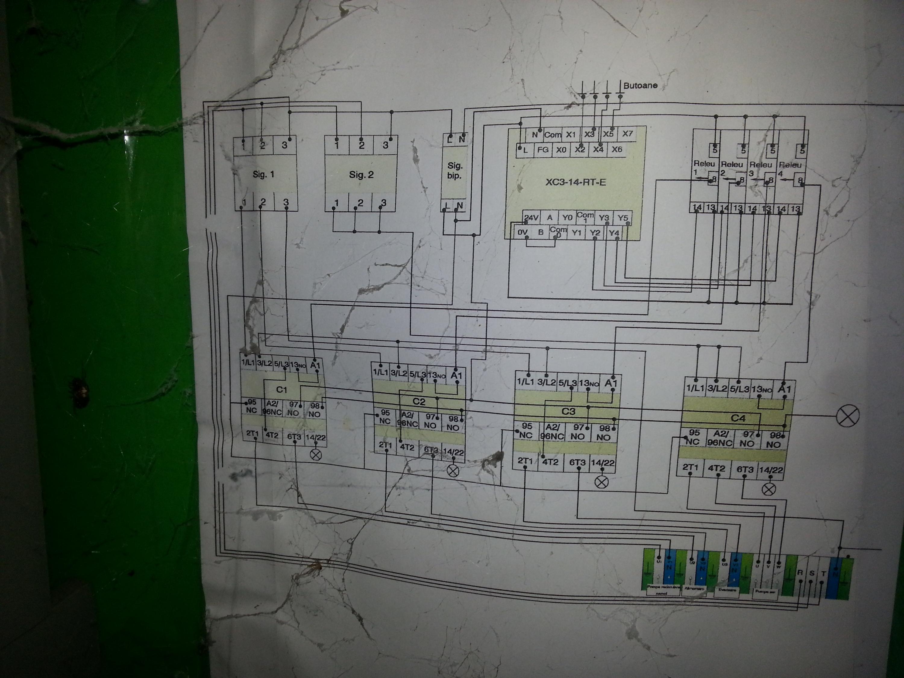

                              Re: Getting into PLCs
                              The only way for the PLC to shut off the motor would be by turning off its contactor, which I think wouldn't trip a breaker because a circuit is being OPENED, not closed (to say it's got inrush problems or something). Still, can't quite figure out why the motor was still running, unless it was running on one phase which would certainly not be possible, or at least not in this configuration....
                              Could be that MCB is for something different entirely and the schematic on the side wall of the box which I snapped a picture of but haven't posted till now (I did now) doesn't correspond to the physical layout of the devices in the box. Have a look. Not particularly great quality, but if you zoom in enough you can make things out pretty clearly. Not sure how those 4 contactors at bottom operate. I figure things like that out by testing them i.e. playing with the contactor on the bench and doing continuity measurements. It instantly becomes clear, rather than relying on random codes like A1, A2 etc, which mean nothing to me...
                              "SIG" here refers to "breaker" in case you couldn't figure it out, as that's the only word in there that differs grossly from the English "MCB", whereas the others are close enough that you can suss them out, such as "butoane" or "releu" which mean "buttons" and "relay" respectively....no trouble there...

                                • Jul 2011
                                • 6070
                                Who makes these contactors because there numbering is pretty standard but there is some parts that are not standard like ( 22 )
                                A1/A2 is the coil for the contactor
                                What is the reason for them not to show the connection to A2
                                It also in not showing the control transformer/ power supply for the contact-ors or am I missing something because I do not see it
                                I have not a configuration setup like this
                                Do you whether or not this motor is more than one speed if this motor is more than one speed it will not be a good idea to play with the contactors you will burn up the motor
                                I go back to work on Monday I will show you a wiring diagram that shows things a lot better and easier to read

                                  The PLC wiring looks straightforward.
                                  Four output relays drive the Meta-MEC GMC-16M's which are a contactor and bimetallic overload relay built into one.
                                  One for the 3-phase pump motor, set to 5A trip.
                                  Three for some 1-phase loads, set to 0.5A trip, with oddball L2-4T2-L3 connection to fool it to thinking it's 3-phase or something.
                                  All contactor's auxiliary switches 97, 98 are all in parallel to one indicator light.
                                  If a pump is staying running then there is a ghost to get rid of.
                                    • Jul 2011
                                    • 6070
                                    Redwire
                                    Thanks for explaining that to me I have not seen a setup with the contactors setup that way
                                    Or a wiring diagram showing the overload and contactors as one unit all wiring diagram that I have seen they show them separate

                                        This is some kind of shitty Chinese PLC. Based on everything you have said here on this forum thread and your background my advice to you would be not to waste your time and the customers time. Move on.
