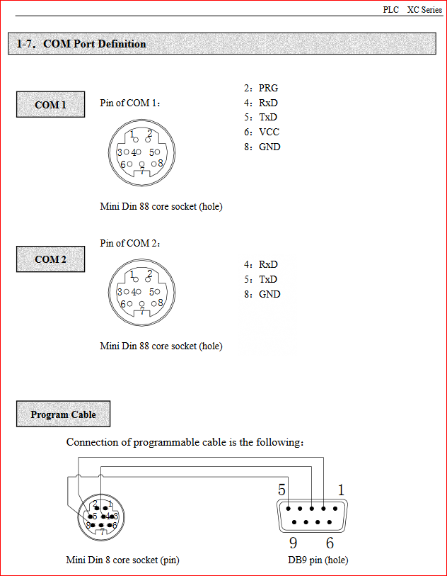

        Re: Getting into PLCs
        PLC's usually have oddball serial cables. It's to keep the cable a $200 "special" part. I'm not sure what the "program" pin needs.
        9600,E,8,1 your parity might be wrong. It's even parity.
          that's not oddball, it was used by Apple and SGI on a lot of machines to save space (and probably money)

            #45
            THIS chap here shows a similar, larger PLC. Unfortunately I don't speak russian to understand whether that mini-DIN cable is something he wired himself as per the schematic in the manual you showed, or it's an "official" cable. If someone can help with that, it would be wonderful. His cable looks homemade to me, so the only difference between me and him is the USB-serial adapter. I tried it with the CH341 of my programmer, while he used one which actual terminates in a COM port and has a "lump" on the cable which presumably houses some more intelligent hardware than my single chip.

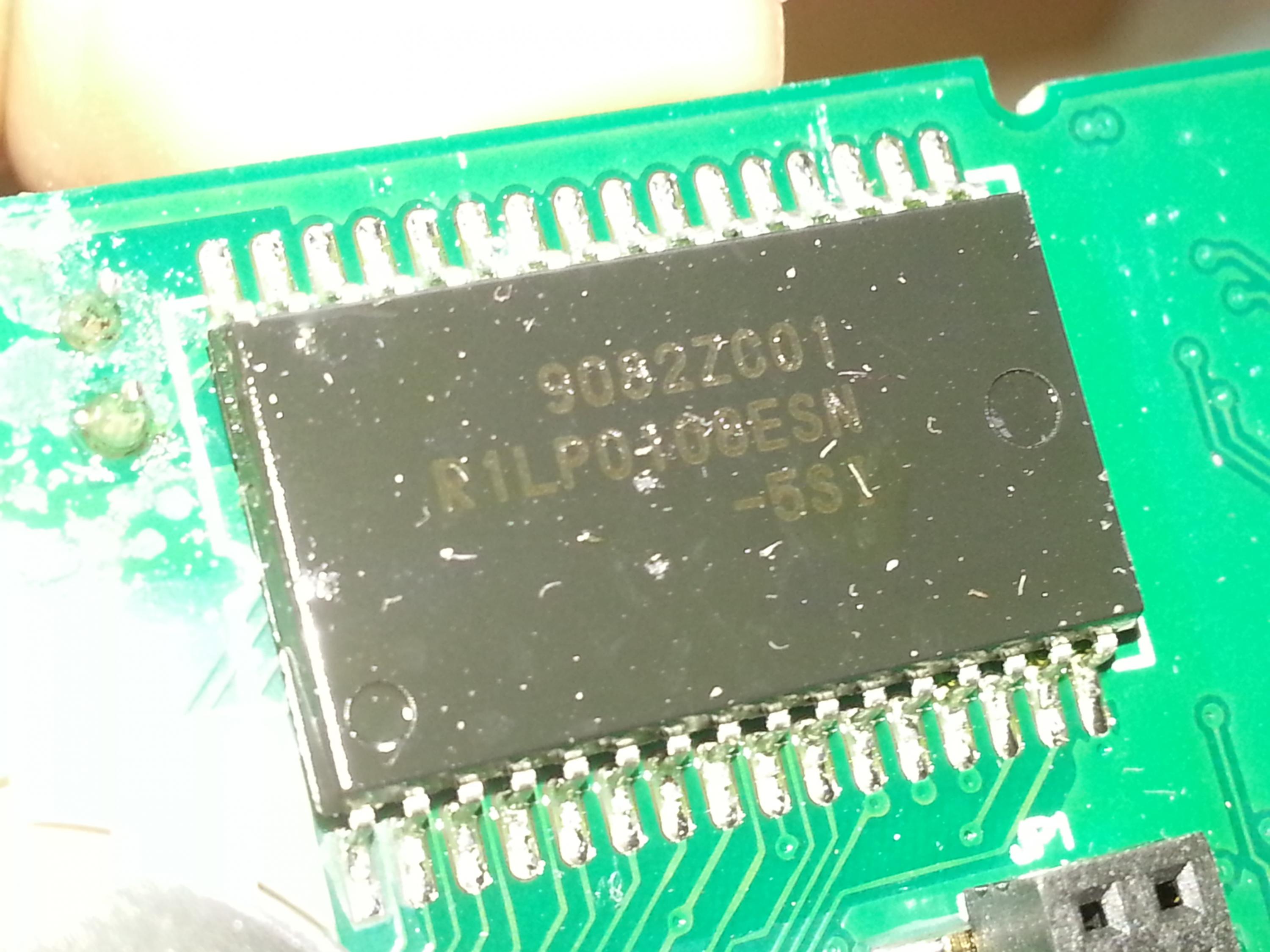

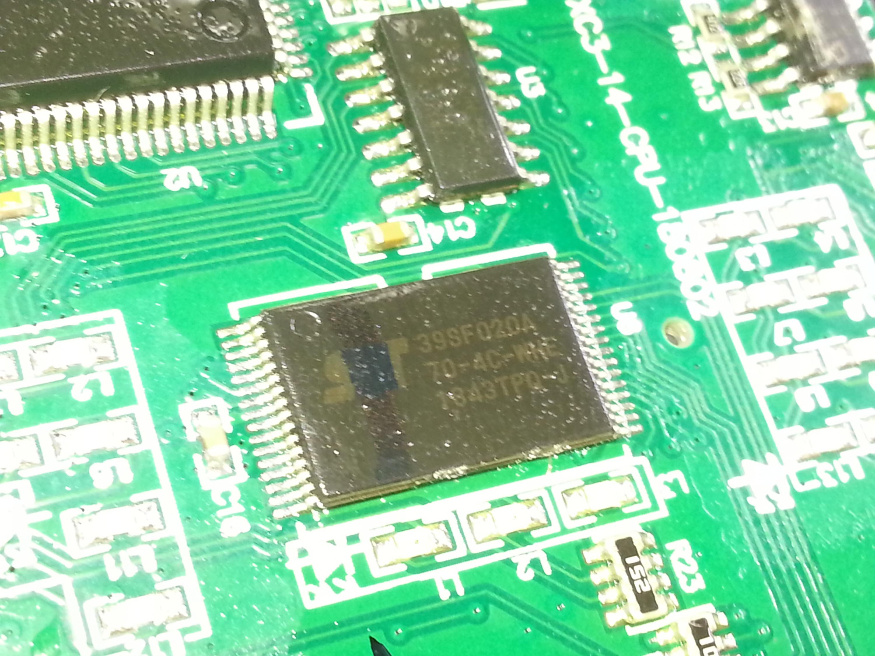

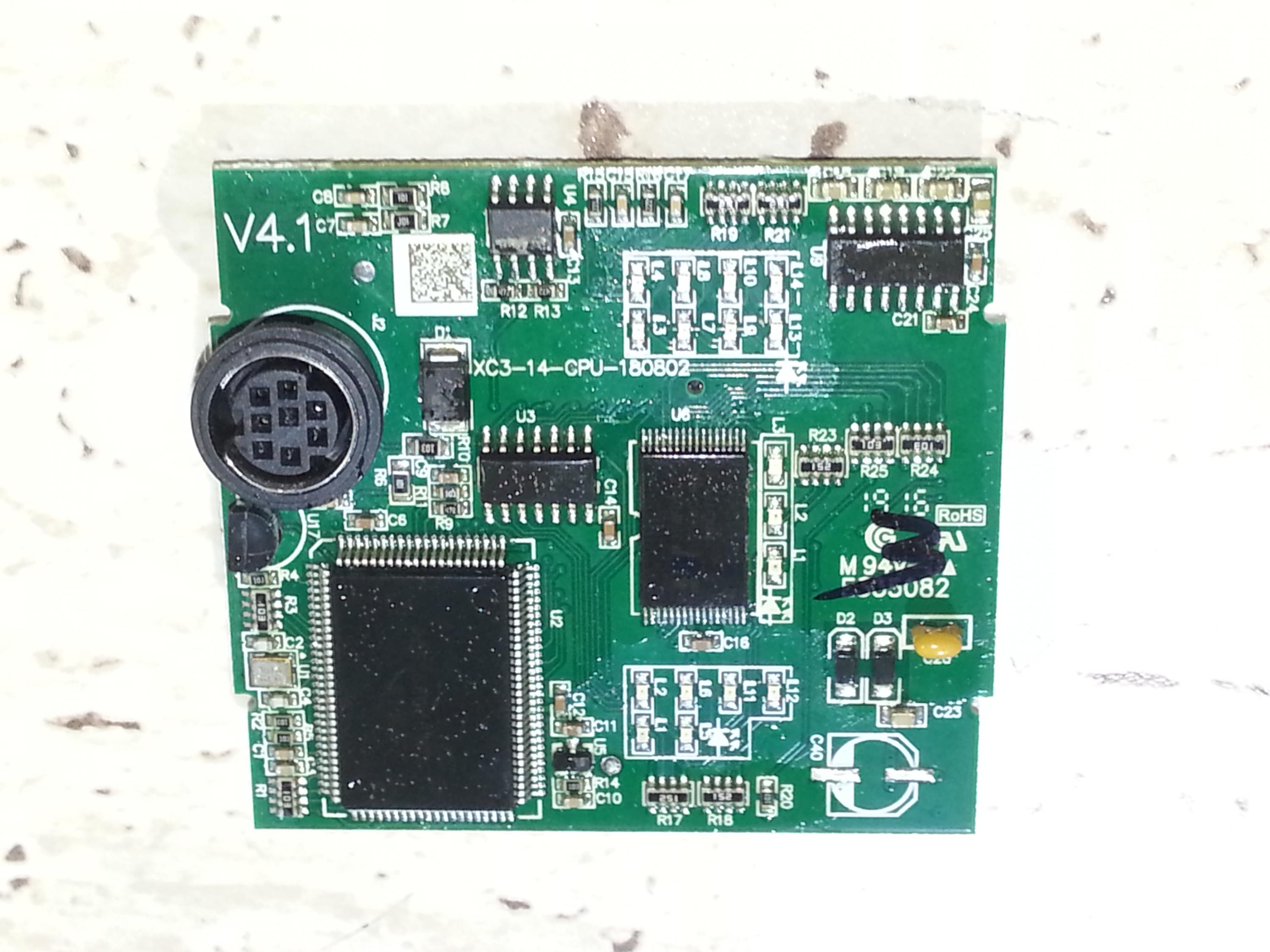

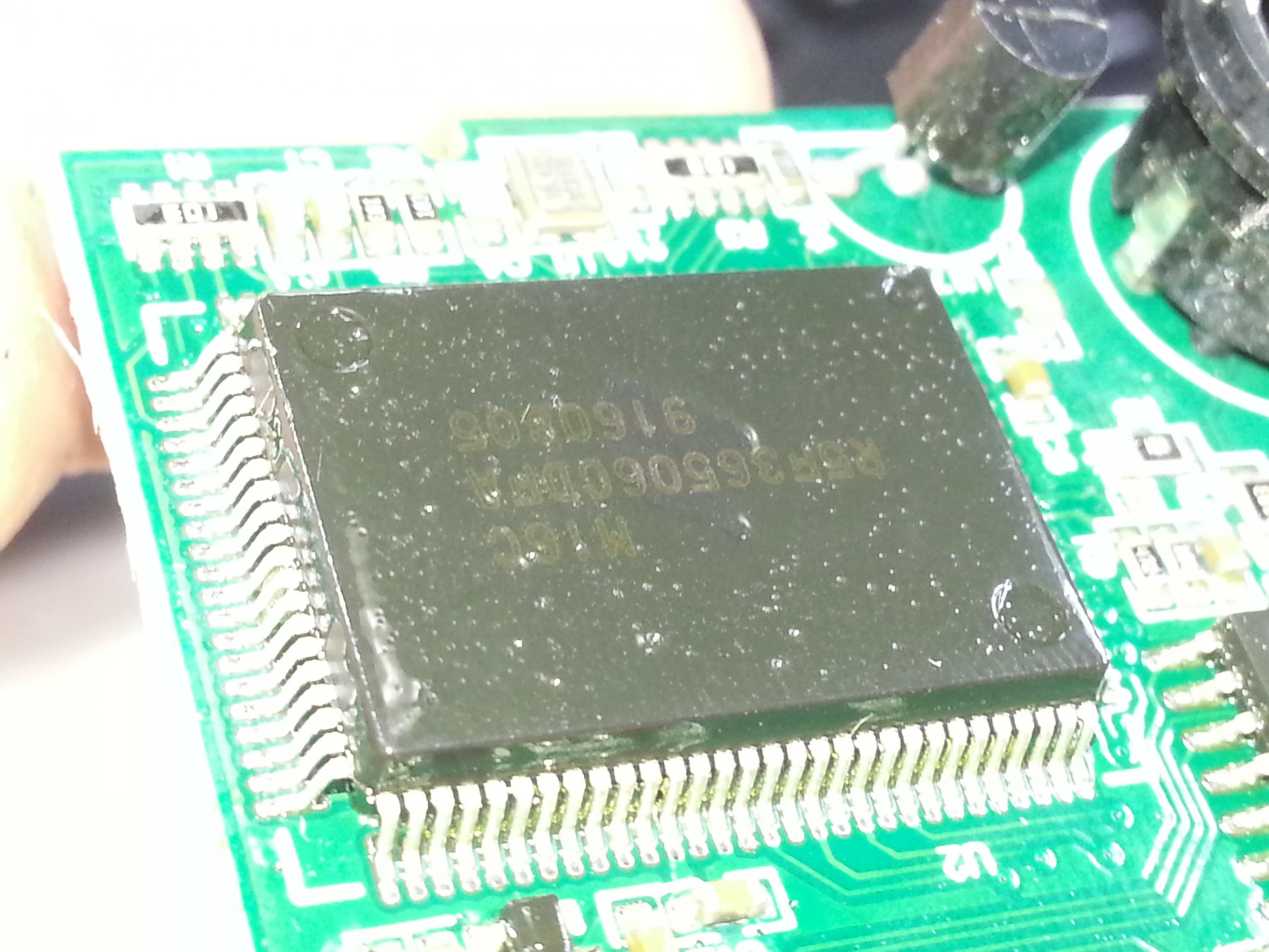

                                  Ok guys, here's where I stand: today I managed to connect and interact with both the display and the PLC itself. I mostly played with the PLC because I might have to create my own program based on how I think these water basins should work (or at the very most by observing a functional one), because I there's no way I'll be able to unlock a programmed PLC to obtain the code.
                                  Here's some shots of what's on the inside: as you can see, there's a flash memory on there but that's about it. And no, that 8 pin IC is a DAC - nothing of interest there, I looked it up. The "bulk", including lock codes and other stuff, is most likely stored on this one flash, making recovering anything impossible, both due to hardware constraints and possibly electronic ones as well, so there is that...unless of course someone pro enough goes "oh, that's a XYZ chip - you can crack those easily by doing this" sort-of deal
                                  As far as creating my own program goes, today I put together something which loosely mimics what the "good" PLC should do: it steps through 4 of its outputs (representing air valves which open and close) one at a time at a set interval, so I created that with a short 3 second interval just for a proof of concept test and I got it working after an entire day of work. I even included a "power failure guard" which allows the PLC to continue where it left off in case it loses power and reboots. I'm still getting the hang of it. For instance, I still haven't tried relaying info from the PLC to show up on the display, like the status of its outputs, the countdown time, etc. The poor translation of the manual doesn't do me any favours here either, because I'm having a hard time understanding what some of those functions do....
                                  Wattevah...
                                    • 31283
                                    #57
                                    the flash is 28pin tsop package,
                                    i could just lift it and throw it into my adapter and read it out with my programmer.
                                    if i was not me but somebody lesser, i could still lift it and put it onto an adapter pcb for a $ from ebay and then read it with a breadboard and arduino.
                                    • Dannyx
