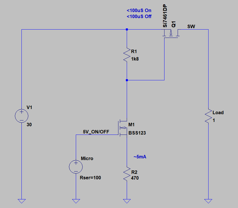

    I need to switch a 30Amp resistive DC load from a 5V microcontoller pin. This isn't PWM just occasional on/off.
    I'm familiar with the design considerations for high speed switching - rapidly getting charge in and out of the gate to minimise time spent in the linear region but in this application I'm pretty sure I can safely simplify the design a great deal because it's only used as a discrete on/off control.
    What I've come up with does seem uncomfortably slow so I thought I'd ask around in case I'm missing something!

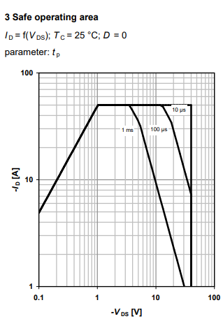

    Q1 would actually be IPD50P04P413ATMA1 a 12mOhm P-Channel MOSFET, 50 A, 40 V. The total gate charge is less than 50nC so charging/discharging at around 5mA should take no more than 50nS x 1/0.005 = 10uS
    This keeps it in the top right corner of the safe operating area:
    The DC input could be as high as 30V so to limit the gate voltage low swing, the 470R source resistor makes M1 act like a constant current sink (its threshold being around 2.5V). R1 maintains around 10V across it until the supply drops below 12V

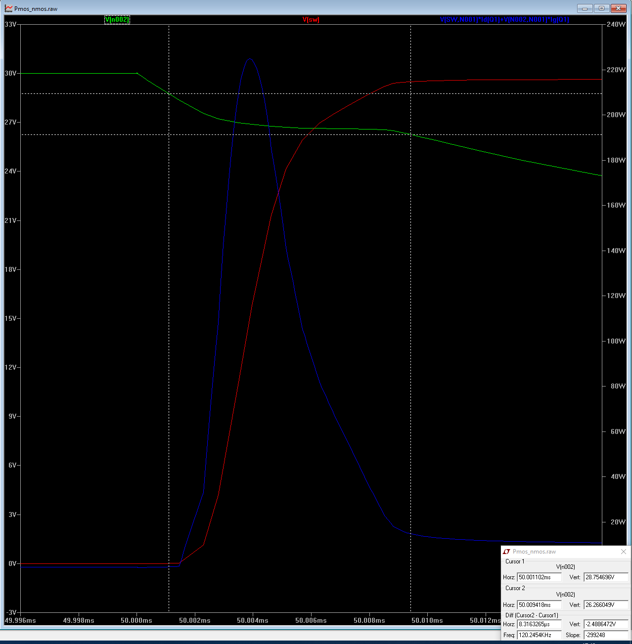

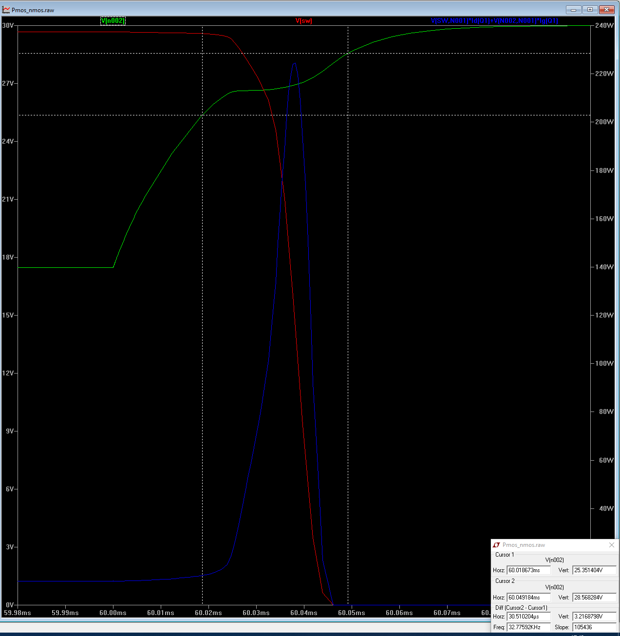

    LTspice sim of ~30uS switch-off for part with even higher gate charge (120nC) seems OK:
    Green is gate voltage, red ouptut voltage and blue power dissipation in Mosfet. Switch-on should be a bit sharper and it is at <10uS:

    Anyway I don't understand R2 other than perhaps setting up a voltage divider. Having that there will kill performance of both transistors as it would limit how fast you can get the charge off of their gates.
    But do worry that the voltage divider is somewhat necessary due to exceeding the maximum gate voltage of Q1. Perhaps just moving R2 to the drain side of M1 will speed up performance and still maintain gate voltage limits.

      1) Since M1 control the ON/OFF switch for Q1. How fast is M1 switching?
      2) "R1 maintains around 10V across it until the supply drops below 12V" If M1 switch is OFF, then I cannot see how you can maintain 10V across it.
      3) When M1 is OFF then the Q1 Gate will be discharged through R1so if you want to discharge it faster the put diode in parallel with R1, Anode on top end of R1.
      4) BTW, are you loading the SIM library with the actual spec of the component?

        OP's circuit, R2 is silly as it is limiting to 5mA and R1 is too low and a P-ch mosfet? not sure how the circuit even starts, it's prob. the substrate diode always on
        I always put in a gate zener, because you need to overdrive the gate to get good speed.

          Original circuit is fine with the P-channel with source to V+, that's how it's normally implemented, problem is that M1 won't saturate due to R2 - at first when the gate voltage is turned on, it works fine, but once it's on it will shut off because source voltage will increase... This is actually horrible and no wonder why it's working so poorly. So: short out R2, and if you don't want to dissipate as much power, put R2 on the drain lead so it will also reduce gate voltage of Q1 (though I've not looked at the data sheet for its maximum Vgs.)

            Yep, R2 should be on the Drain of M1.
              Re: High side Mosfet swich design
              Okay, finally looked at data sheet but I shouldn't have bothered: Not only that R2 needs to be on the Drain of M1, it needs to be increased to 1KΩ if V1 is really 30V.

                if you use a single "logic level" fet with a 2v gate voltage, the microcontroller can hard shift the gatepin from 5v to gnd - that will switch the fet much faster than using a pullup resistor or a current limiting resistor to ground.

                      The Gate Voltage of the P-CH has to be < the Source Voltage = to the Vth for full turn on of the MOSFET but it cannot be higher than the G-S breakdown Voltage. It is P-CH so we are pulling the Gate down not pulling up.
