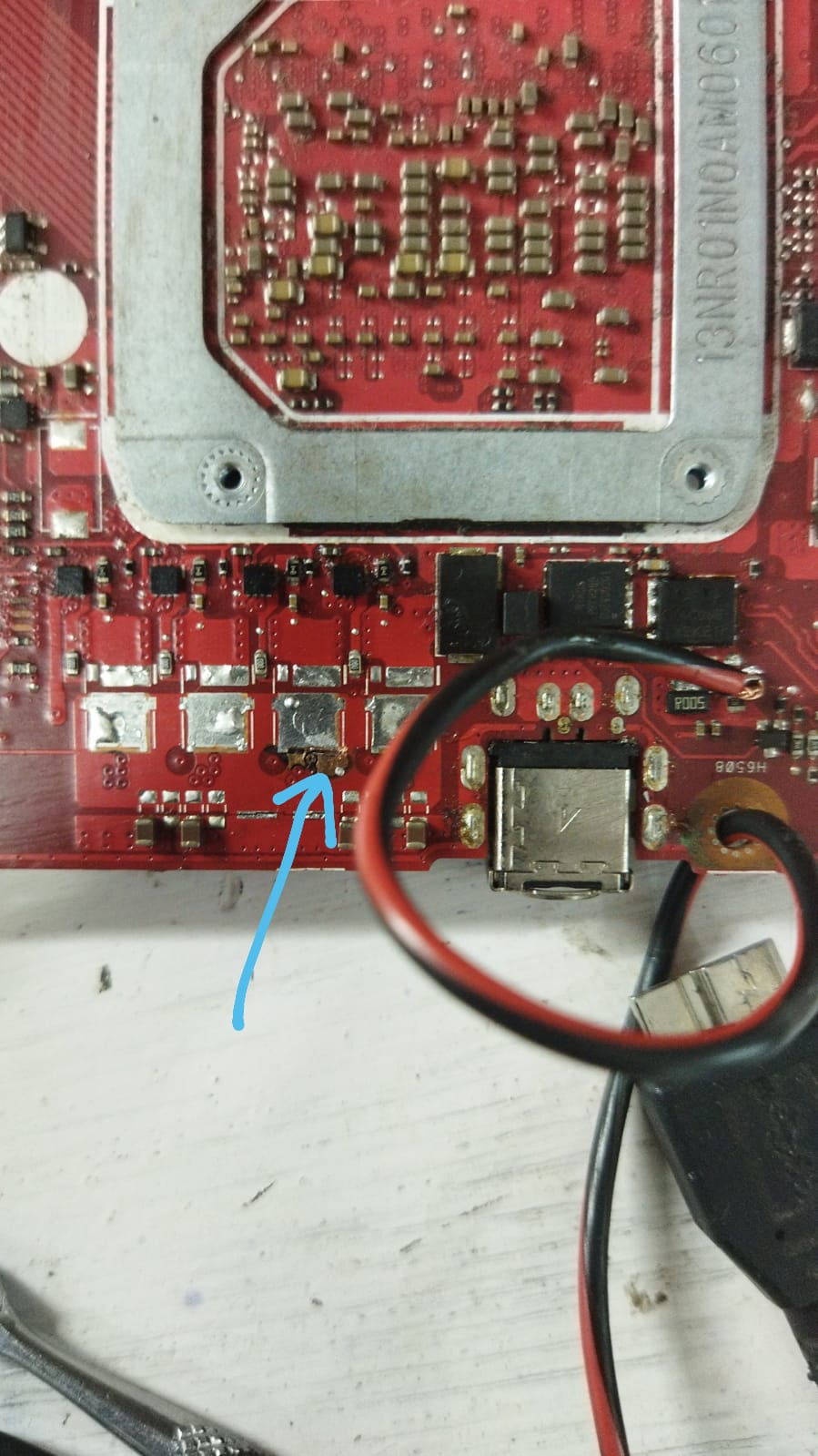

Asus GT531GT VCORE high side mosfet pad burnt
  • IamPritesh
    • Aug 2017
    • 354
    • India

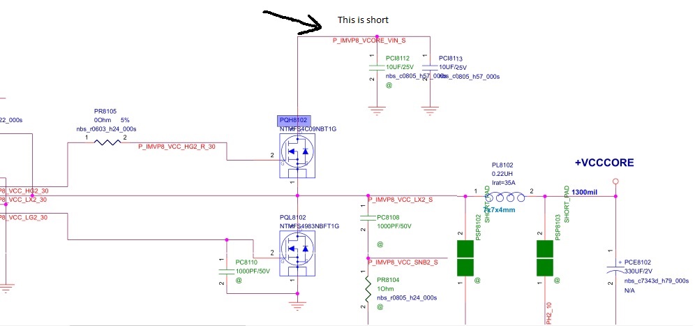

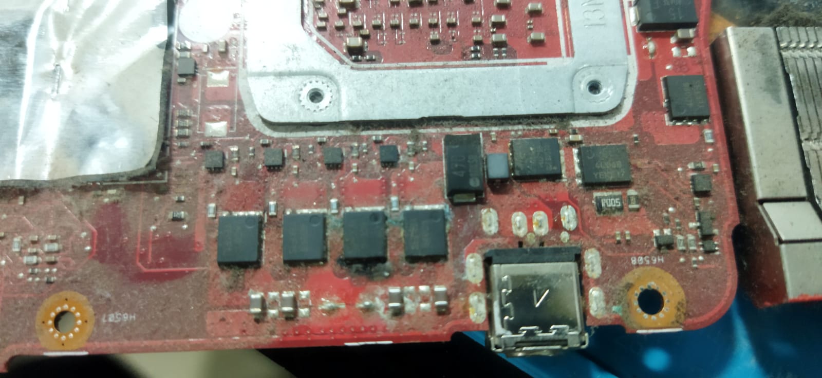

    So I have this Asus GT531GT whose pad is burnt and it shows short to ground 0.8 even after removing all the connected mosfets and capacitors.
    Image attached . The mosfet where the pad is burnt is PQH8102

    Re: Asus GT531GT VCORE high side mosfet pad burnt
    0.8 Ohms at Vcore is very likely normal for this board.
    • IamPritesh
      • Aug 2017
      • 354
      • India
      It's on the high side ( Connected to AC_BAT+ 19V rail though jumper) I have removed all the capacitors on this line and also all the mosfets just to rule out any leaking components and the remove the solder joints of the jumper.
      • IamPritesh
        • Aug 2017
        • 354
        • India
        Any suggestion experts ?
