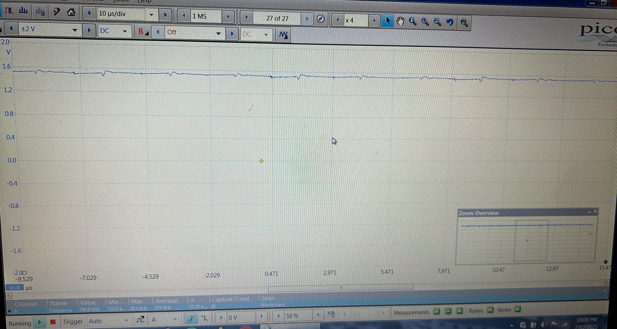

    I am unclear if the Vcore ripple I see when in Bios screen is normal or not. I have no other similar generation mobo to measure Vcore for comparison.

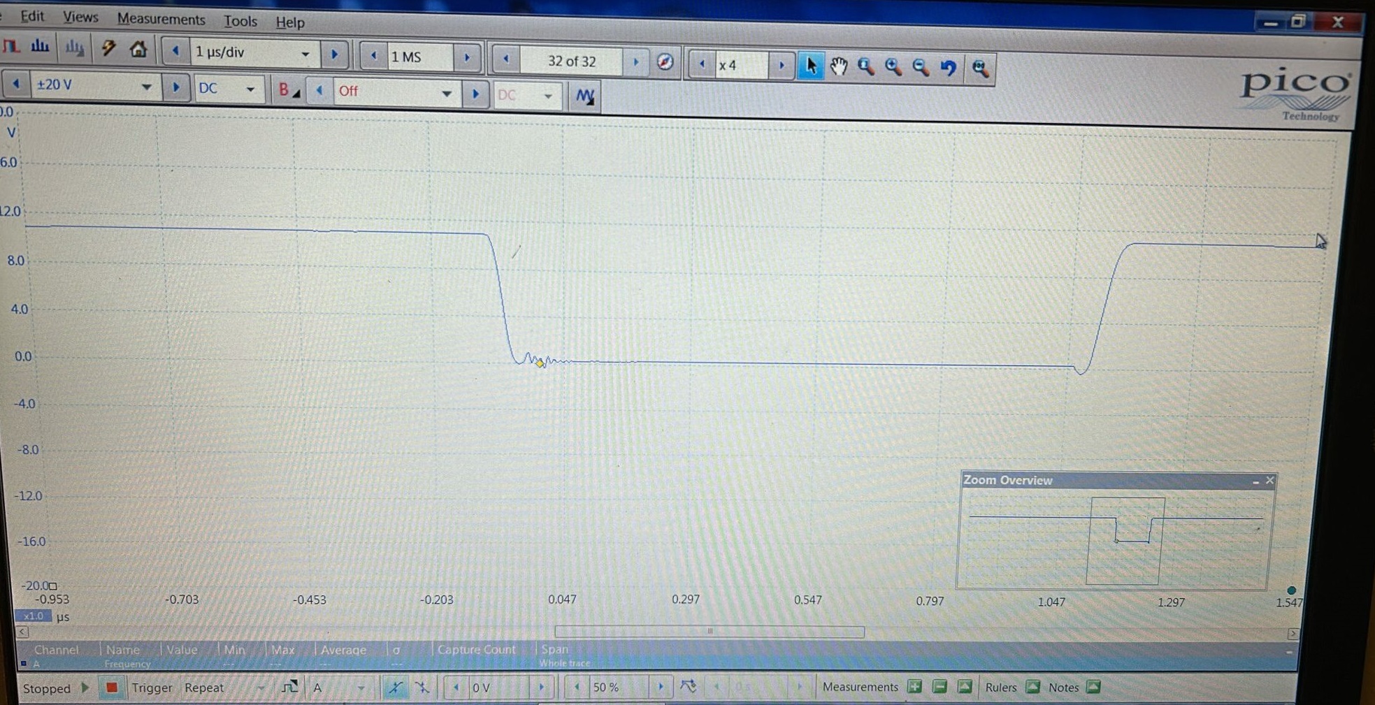

    Waveforms look normal at the Mosfet driver ICs input and all three high side mosfets.
    I see a bit of ringing on the Vgs of all three low side Mosfets - I am not sure if this is normal wonder if this can cause the possible extra heating.
    Is the Vcore ripple when in Bios screen looking ok on the waveform pic?
    Is the ringing on the Vgs of all three low side Mosfets normal? Or can this cause extra heat dissipation?
    Waveform pics are quick screen photos hope they are clear enough.

      Screens look good, the ringing is normal. Pls be more specific, "quite warm" is not a very exact information. Measure the temperatures, test the vrm under full load. This is also a quite old construction, so vrm efficiency (thermal losses) might be not as good as today. The heat might come also from the coils resistance. Have you checked if the replacement mosftes have lower Rdson (this is crucial for thermal lossess) ?

        Thank you for the very good suggestions. Did not know about the Panasonic design guide. This is the first VRM I repaired (I usually repair 230V SMPS) and was not sure about the small ringing on the waveform.
