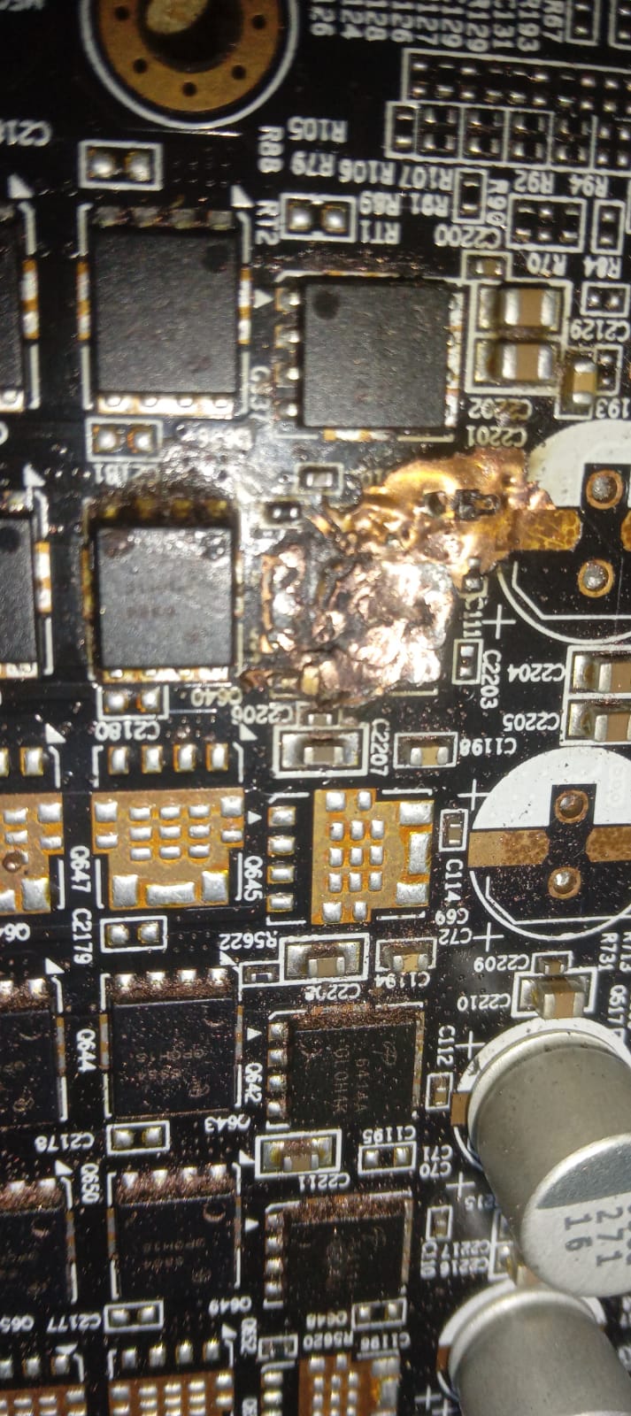

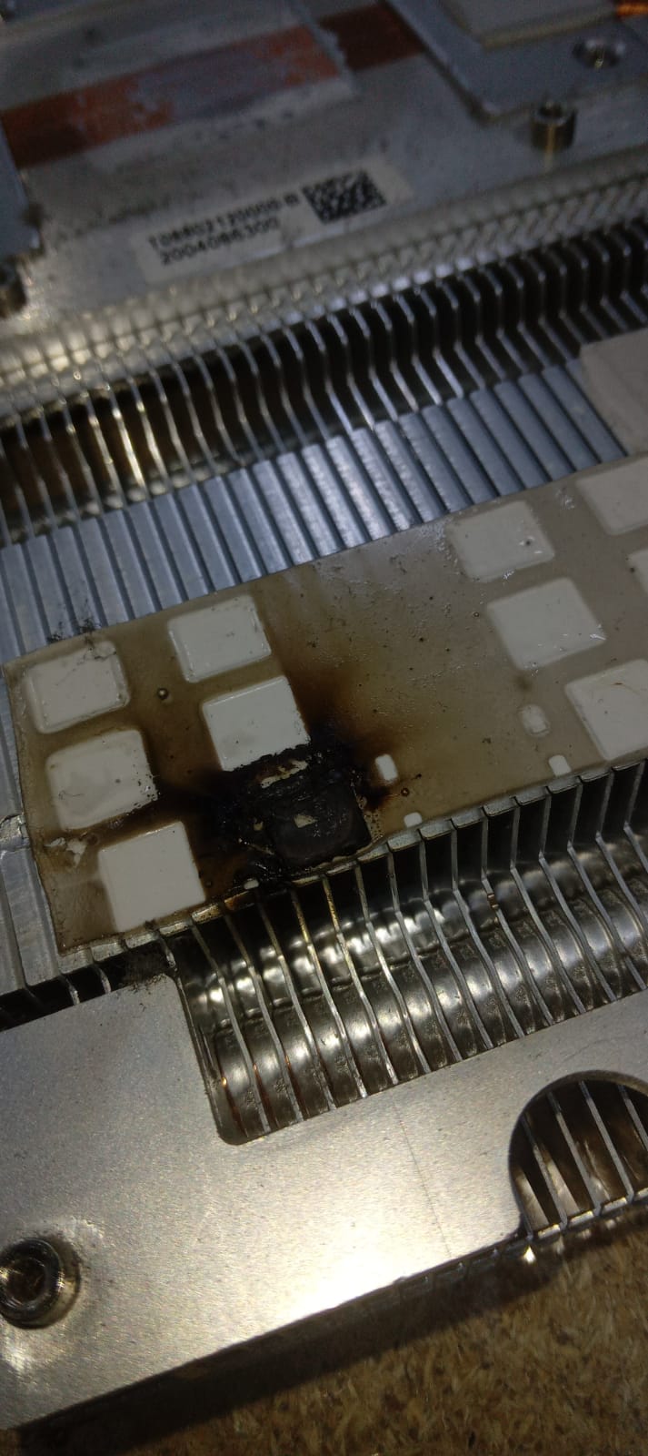

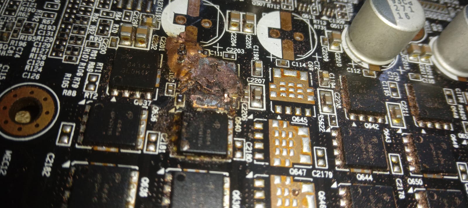

    Hello. They brought a personal computer for repair in which the video card was GeForce RTX ™ 2060 WINDFORCE OC 6G (rev. 1.0). Graphics core power mosfet burned out.

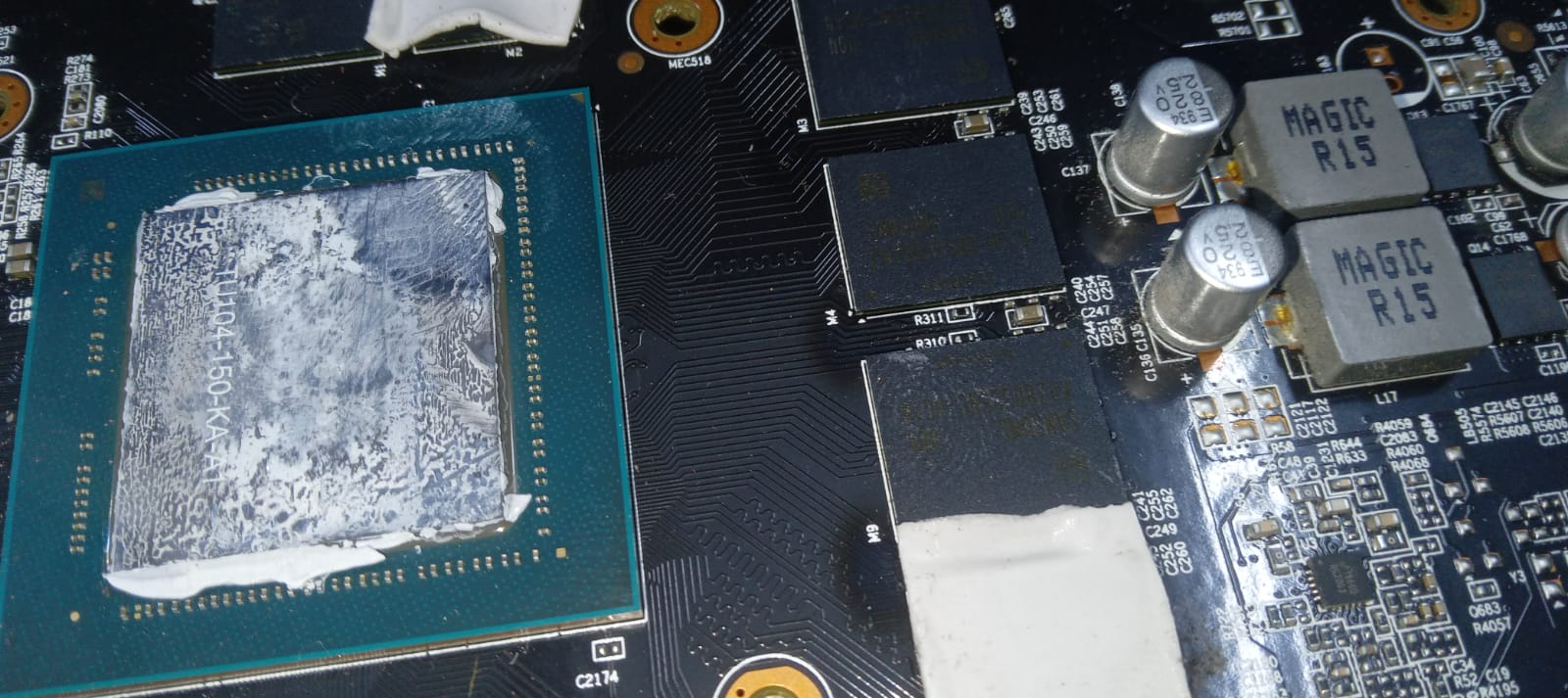

    Is there a chance to restore the site where the mosfet was? I started to grind the mosfet substrate with a dremel, which stuck to the board, but for now I stopped and decided to ask you for advice. I also noticed dark spots on the PCB near the video memory chips. Does this mean that the video memory is out of order? I cleaned the place where there was a burnout, a short circuit of 12 V was removed. On the coils on the power supply of the chip 1 ohm, on the power supply of the memory 36 ohms. Are these resistances normal? I have not encountered video cards, so I ask you for help.

    Re: High side mosfet of the power supply of the RTX2060 graphic chip burned out
    as u see u have MANY free phases. just move mosfets and few components to free phase
    just grind until u dont have short on main 12V phase
      Thanks! I'm trying to do it. I will write the result of the work.
